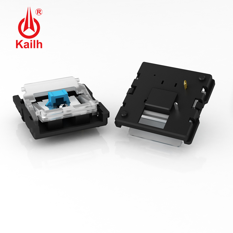

The structure of X switch breaks the present traditional keyboard switch design style,which is more thin and better feel.

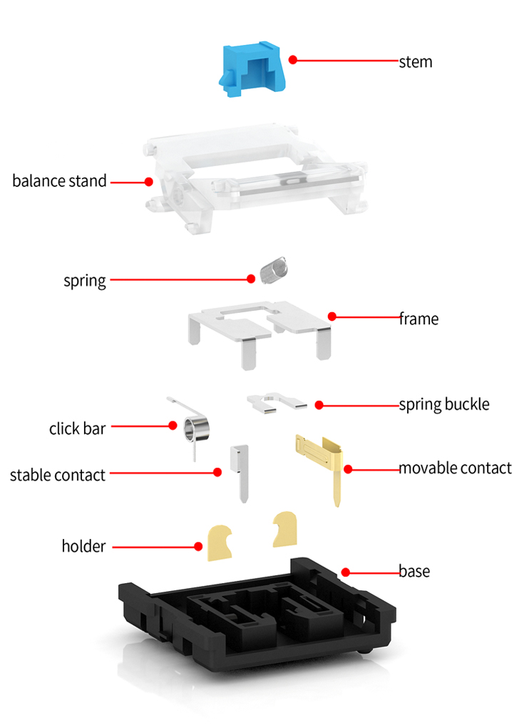

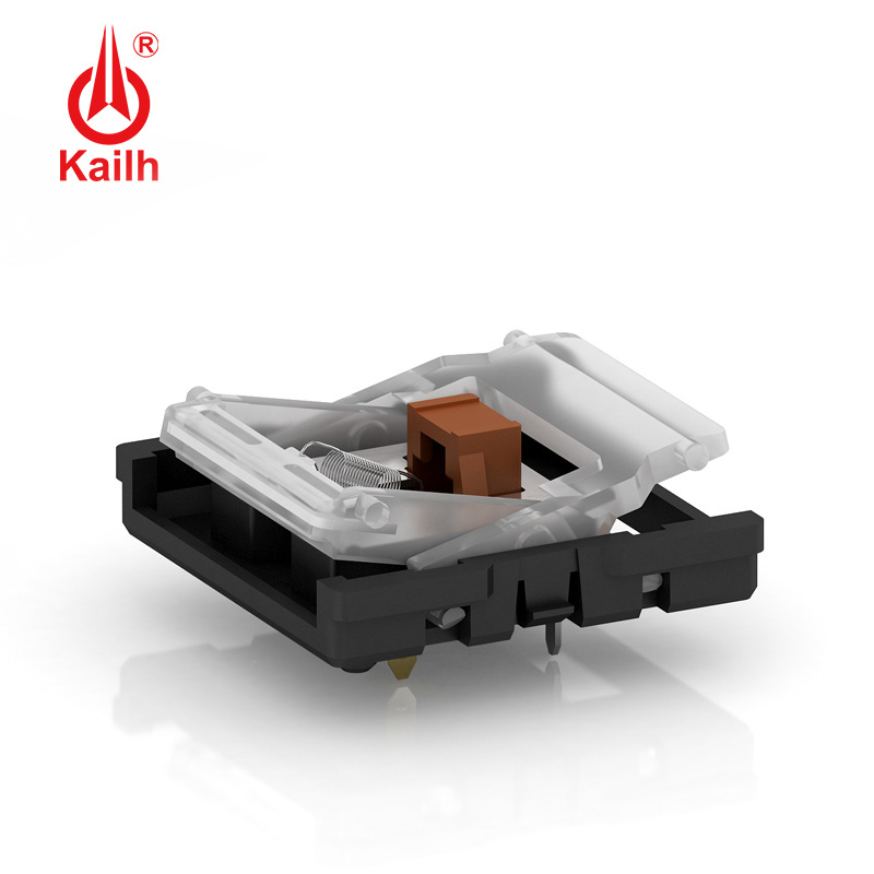

The key switch technology is rather precise, you need to use the knife to open it so that see the final structure!Once you open it,you’ll be surprised at the tiny and complex design. We’ve counted that it has 13pcs parts at least,which differs from the traditional keyswitch. Clicky and tactile two type feels are available.
The highlights of the switch structure

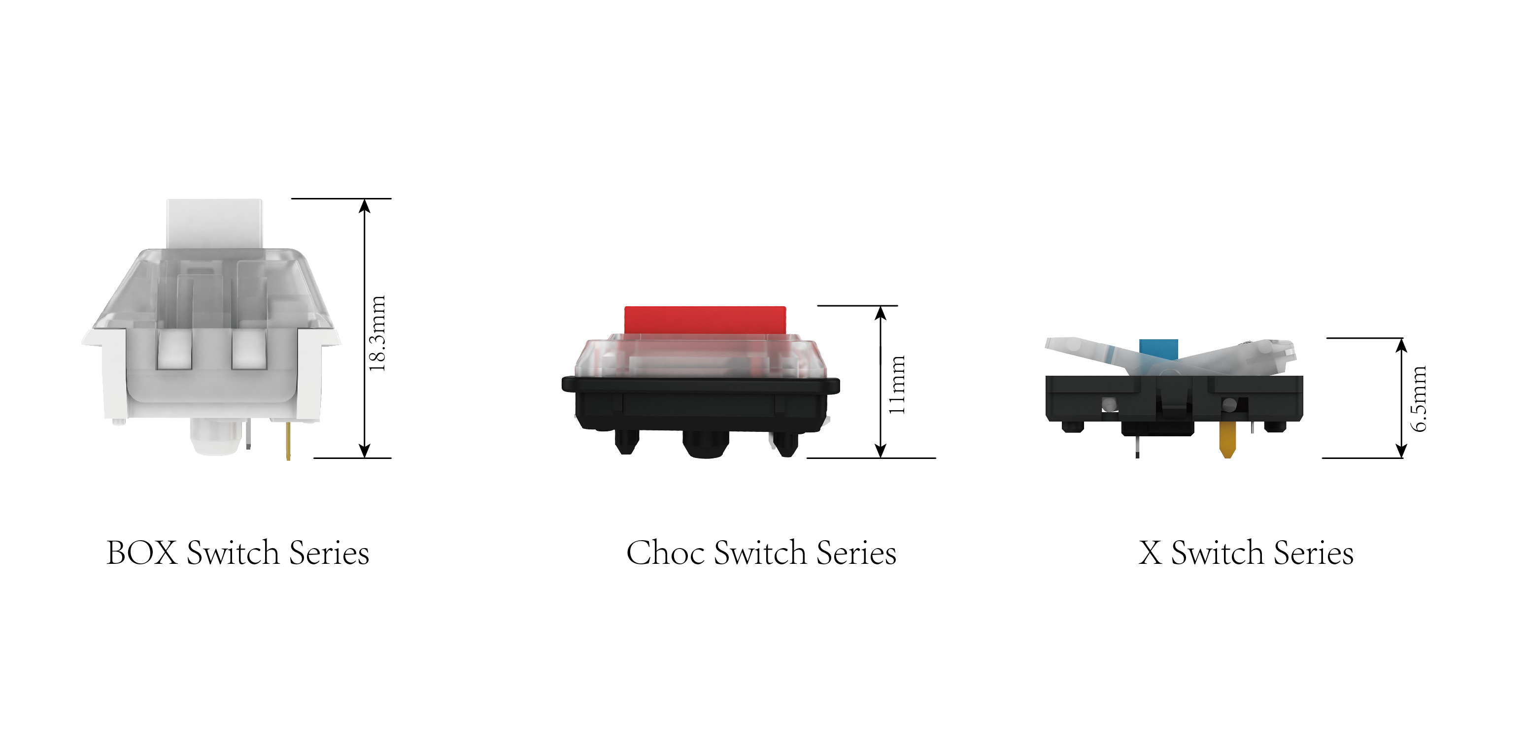

As the name implies,the “X ” is alike scissor X shape,the most highlight is actuation module made of the stem and balance stand, “X” shape balance stand makes the most of the space to assure the mechanical feel and enough short travel,wow.the X Switch the most important tip is the PG142501D03 also has the click bar structure inside ,total height only 6.5mm.

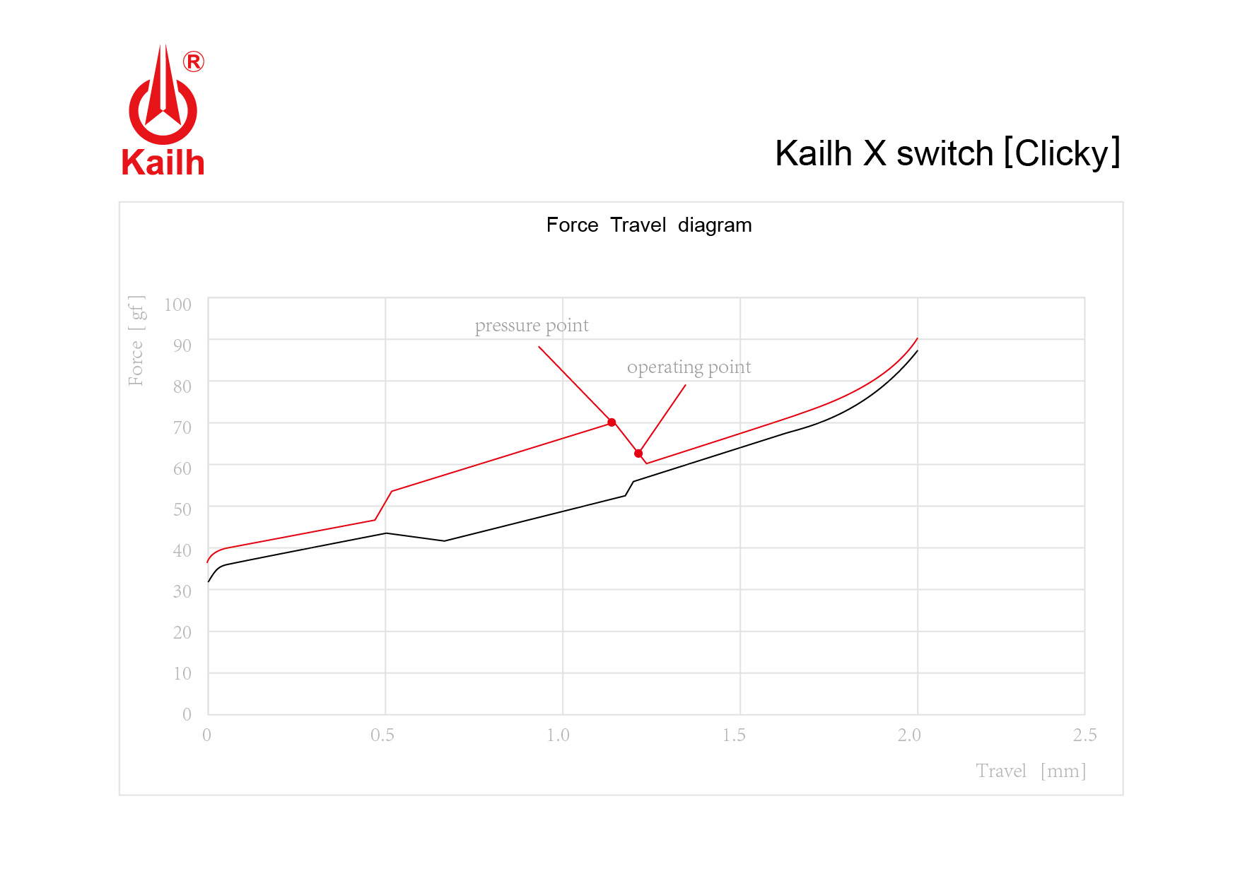

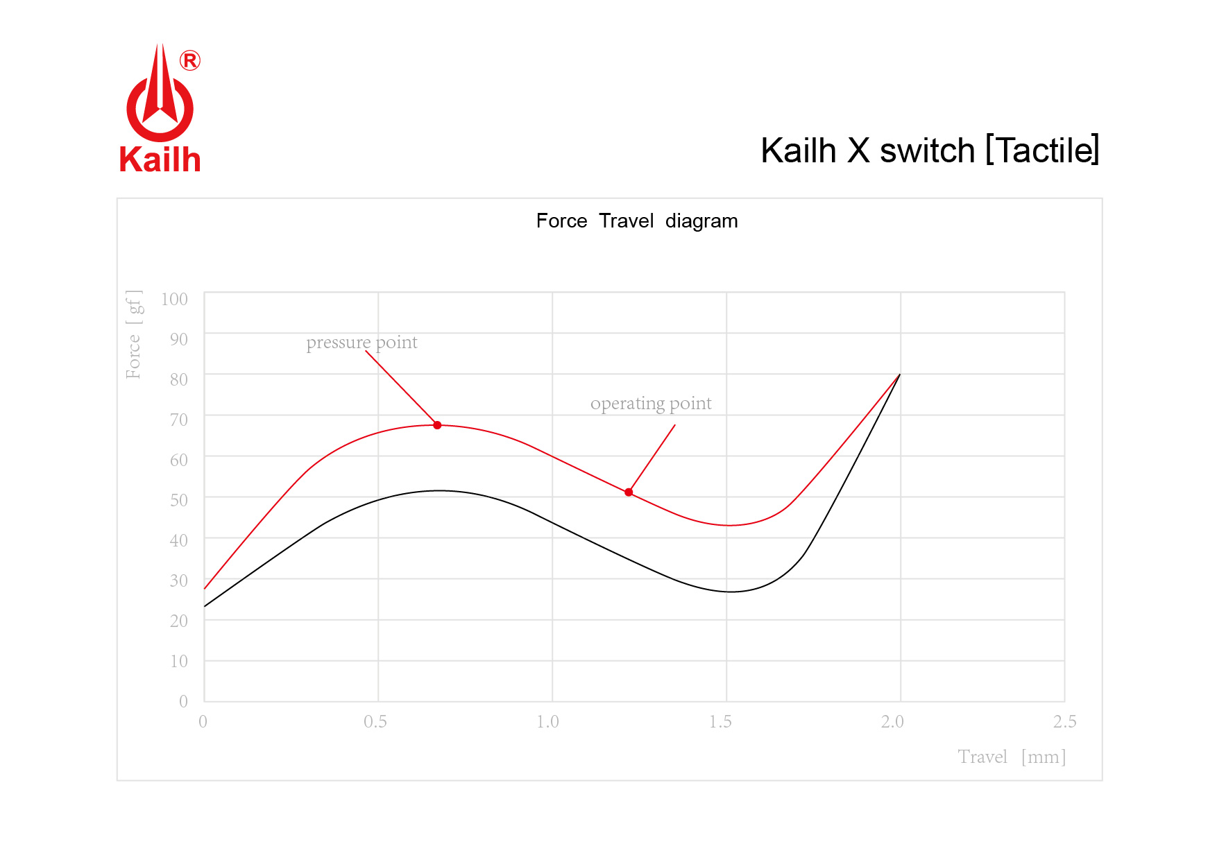

Although X Switch has rather thin body but the total travel is 2.5mm,the actuation travel 1.2mm,more fast actuation and feeling.it means that the mechanical notebook no more big only choose Kailh X Switch,then you’ll experience the advantage of feeling and volume. 20M cycles lifespans and 50gf actuation force,Kaihua makes a revolutionary transformation for the structure and volume.

The really hard part will be convincing mainstream brands to sell laptops that are thicker, heavier and noisier! (Eyeball and ruler test of a Sunrex laptop keyboard gives me a thickness of around 4 mm without keycaps, versus 6.5 for X-Switch.)
I've felt for a while now that, seeing how small the parts are inside Apple laptops (tiny motherboard, thin batteries), we could return to thicker laptops and use the extra space inside for a better keyboard. X Switch would certainly work towards that compromise.

The tactile switch looks very much like it has the force curve of a rubber dome switch. How does the Kailh X tactile switch compare to a standard chiclet switch?

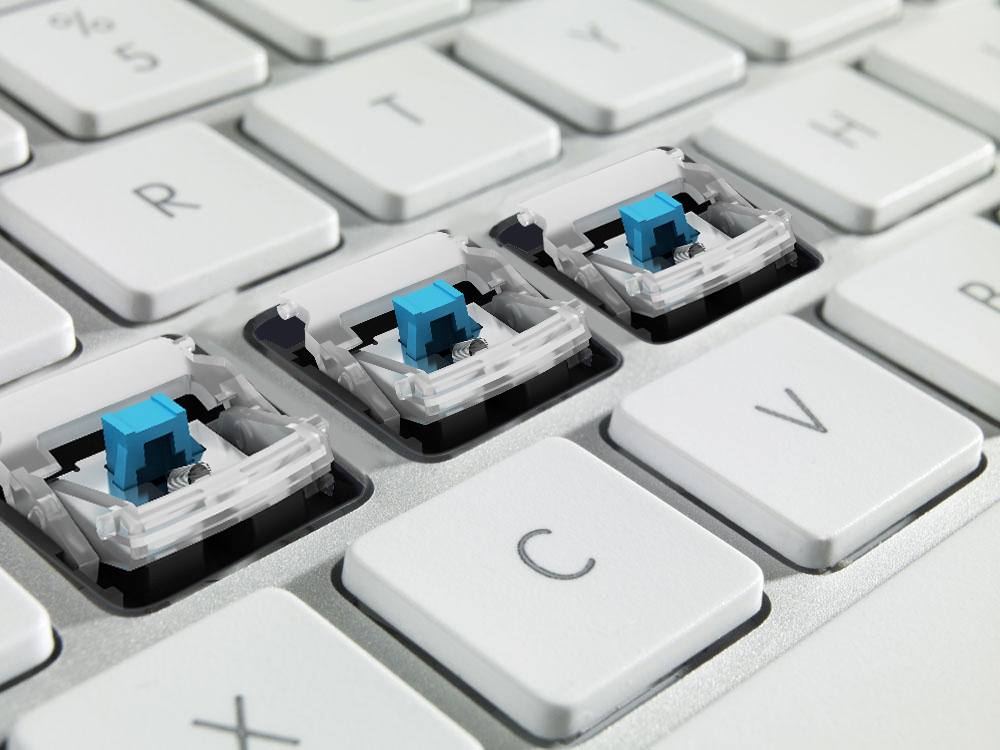

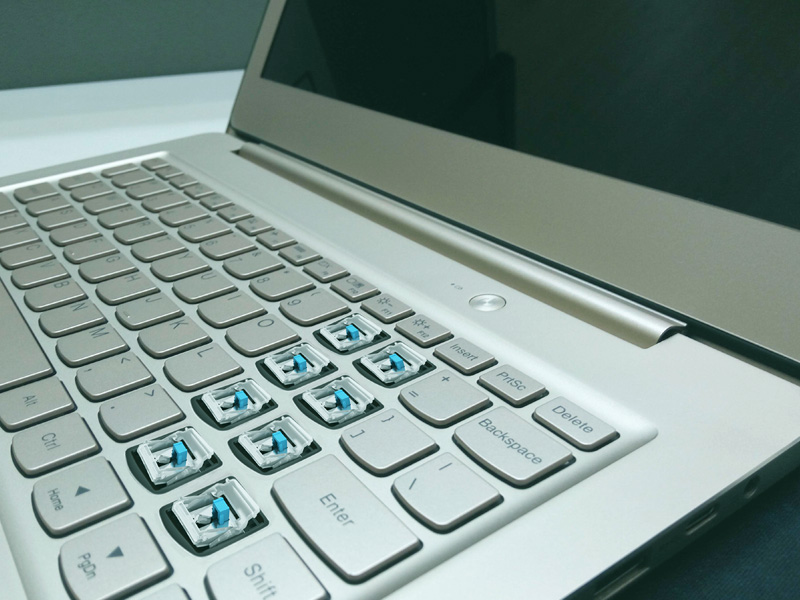

I didn't get time to comment on this earlier. Let's take this photo again:
Look at the keycaps for C and V: the bottom of each keycap is level with the top surface of the keyboard.
Now look at the expose switches, and where the scissor arms are when the key is released.
Keys C and V (and all the others) are being shown in their pressed state. In reality, each keycap would sit higher up with a gap under it like on a traditional (non-island) keyboard. To get that flush look, you would have to put that surface panel higher up.

10 Mar 2018, 10:47
I wonder if the exposed switches are higher than they would be with the cap snapped in place.

15 Mar 2018, 09:06
Kurplop wrote: I wonder if the exposed switches are higher than they would be with the cap snapped in place.
NO
