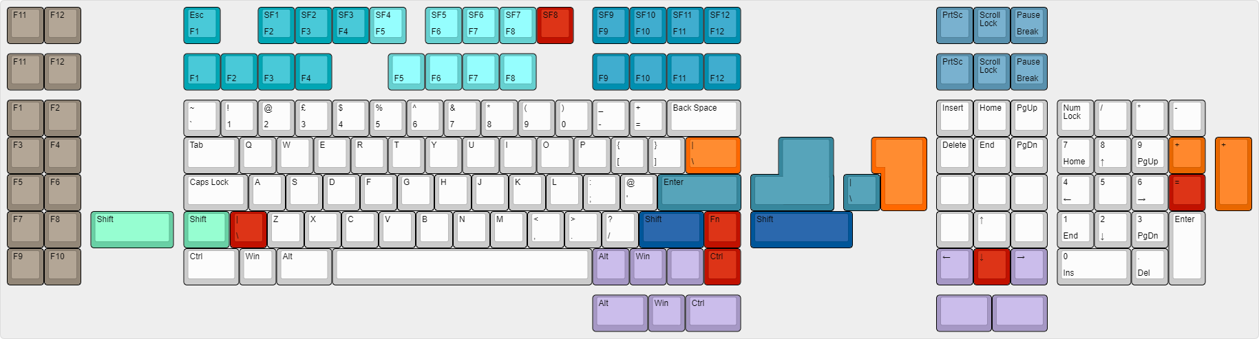

This started out checking to see if people wanted a replacement PCB for the Omnikey lineup, and later it grew to include ANSI and ISO support. On top of all of this, I also designed a plate for all the layouts(single DXF file, as there are 360+ different layouts!!) so you can make a custom fullsize or larger board using a sandwhich case, or if you wanted, even an all aluminum one.
PCB Render:
Sorry for the bad render, I don't have any better way to render PCBs.

Yeah I knew I was forgetting something about the layouts. This is going to be a bit harder than I was initially thinking, haven't seen a Ultra in a while (have an Ultra T) and forgot about the different spacing on the top row.... Oddly enough I thought the Ultra T and Ultra used the same pcb as the Ultra T even has places to put the missing nav keys on the pcb and switch plate, but both top row layouts are not supported on the original pcbs. But it seems to be a super easy layout to run as it isn't complicated or even overlapping.
Support for:
  • • Ultra T
    • Ultra (need to check, hard part is the bottom of the nav cluster being two 1.5u instead of 3 1u, and SF row spacing)
    • Plus (same issue as above minus SF row, but will work)
    • 102
As well I will need to jump up to the Teensy++ as it is not possible to support the matrix size needed to support these layouts as I will be just over the limit for the Teensy 2.0.
Posted: 16 Feb 2018, 00:24
by BlindAssassin111

Polecat, from your pictures I can see that the set of boards with the top row closer to the alpha cluster, never have an esc key on the top row, just the function keys, correct? I want to check my assumption, as I am trying to figure out how many switches will need to be supported on the PCB.
Are the LEDs all at the same height above the numpad or are there 2 different heights?
And what is the spacing of the Gen1/Gen2 top row to the alpha cluster? I know the later ones have a 1U gap between the top row and alphas, but can't tell if it is 0.5U or 0.75U.

I believe that's correct on the Gen1/Gen2 models having the escape key in the alpha cluster, and the Gen3/Gen4 models having it in the top row. I don't know of any exceptions to that, but I can't prove there are none.
The LEDs moved up with the top row by 1/4 inch on the Gen3/Gen4 boards.
I gave the spacing above in inches, with the Gen1/2 boards measuring 1-1/4 inches center to center between the top row and the upper alpha row, and the Gen3/4 measuring 1-1/2 inches. Putting that in keycap units the Gen3/4 have 1U spacing in that gap. That would make for 2U center to center, with 2U equaling 1-1/2 inches, so that would make the Gen1/2 spacing 1-1/4 divided by 1-1/2 times 2 units, or 1-2/3 units. Subtract 1 unit and you have a space for a 2/3U cap in the gap. Now my head hurts. Pop, fizz, aaaaaahhhhh, that's better.
edit: it would probably be helpful to list the known models for each generation. So far my list shows:
Gen1 - 102
Gen2 - 102, Plus, Ultra, 101I, OmniMacUltra
Gen3 - 102, Ultra, Ultra-T, 101
Gen4 - 102P, Ultra-T, 101P, Avant Prime, Avant Stellar

Polecat wrote: 2/3U cap in the gap.
Are you sure it isn't a 0.75U spacing, seems more logical to me than 2/3U spacing. EDIT: Actually now thinking about it 2/3U makes more sense, as it evenly divides the 0.75" per Unit better...Good thing I asked as I would have messed up a part of the board thinking it was 0.75U rather than 0.667U
I have the board mostly laid out for switch locations, and trying to finalize the spacing everywhere to make sure it is correct.
Posted: 24 Feb 2018, 06:25
by Polecat
Please double check my thinking. On the Gen3/4 with 1-1/2 inches center to center (with 1U=3/4 inch) that gives 2U center to center. Subtract 1/2U from the upper row and 1/2U from the lower row and you get 1U (3/4 inch) between rows. On the Gen1/2 at 1-1/4 inches center to center, subtracting 2 X 1/2U (3/4 inch) from 1-1/4 inches you get 1/2 inch between rows, or 2/3U. As en engineer who has laid out PC boards in the past I tend to think in inches, and spacings center to center, but naturally the keycap units are important for fitting to the case.
Posted: 24 Feb 2018, 07:15
by BlindAssassin111
I am also an engineer, but I tend to prefer mm, but for keyboards it is a bitch using 19.05mm for spacing, so I have to use inches...
You are correct about the spacing, but I was thinking because keycaps go in increments of 0.25U, the spacing would also follow that, which is true for most boards, this is the first exception I have seen. So it was unexpected, but it does make sense when you think about the spacing in inches instead of units. Center to center makes sense, but for layout it is easier to see a spacing than a center to center measurement when just laying out the blocks. I use both but each one has its' pros and cons.
The switches are laid out now, so I just need the locations of the screw holes in relation to the center of some switch...as the board edge is not going to be a reliable thing to measure from. Just use the same switch for each to make my life easier, or don't...if you hate me, lol.

Okay, PCB is fully laid out minus the LEDs and still need the locations of the screw cutouts to finalize the PCB.
I made it so the left function block can be broken off for smaller boards. I may change how it is done to make it stronger than it currently is. So all variants should be supported.
Does anyone know how QMK/TMK works with LED indicators? Does it ground them out or power them? Need to know so I don't mess it up, I wasn't able to find anything when searching the wiki.
Posted: 25 Feb 2018, 06:59
by BlindAssassin111
Hak Foo wrote: I could see getting one even though I don't have an Omnikey. Get a plate and sandwich case laser-ut...
Yeah I thought about making a plate for this, but it would have to be a specific layout, as alps switches have to have a certain width cutout, so I would have to make a plate for every single possible layout, which is way beyond what I can do right now.
If you want to make your own plate and case, you are welcome to, just let me know what you would need from me.
Posted: 25 Feb 2018, 09:10
by Hak Foo
It might be possible to build a plate using Swill's Plate Builder. If the board can be designed inside keyboard-layou- editor potential users can swap around variations easily and export the layout to Swill's Plate Builder, and end up with files they can send to Big Blue Saw, etc.
The only big deal is knowing the spacing between blocks in key units.
Posted: 25 Feb 2018, 18:38
by BlindAssassin111
Hak Foo wrote: It might be possible to build a plate using Swill's Plate Builder. If the board can be designed inside keyboard-layou- editor potential users can swap around variations easily and export the layout to Swill's Plate Builder, and end up with files they can send to Big Blue Saw, etc.
Forgot about Skill's builder, I can easily do that then, just give me until the GB opens, and I will have them ready.
