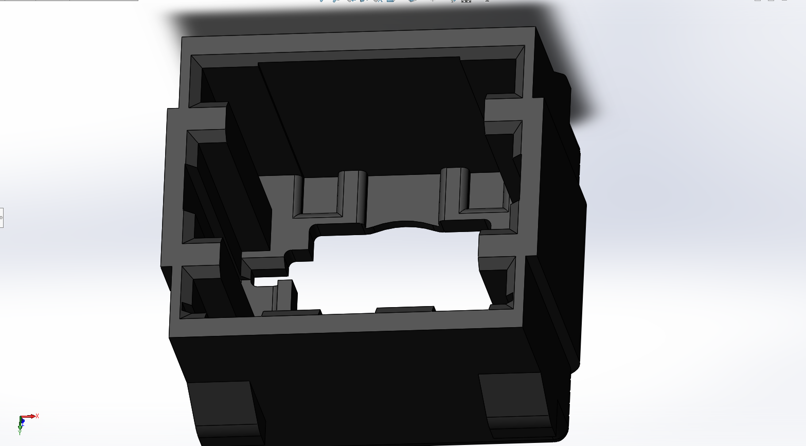

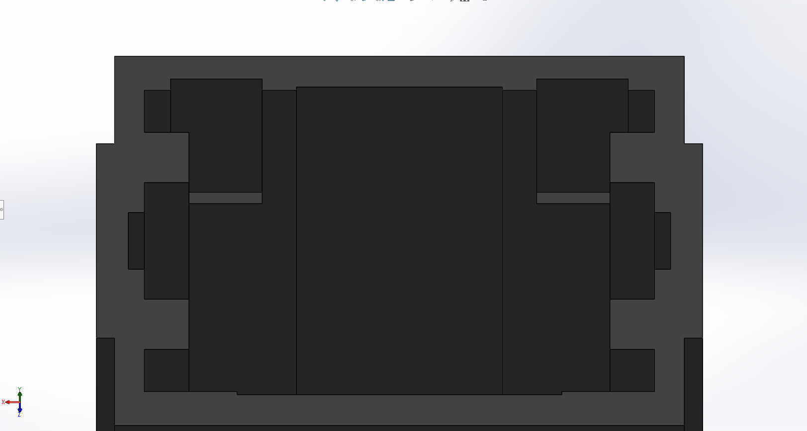

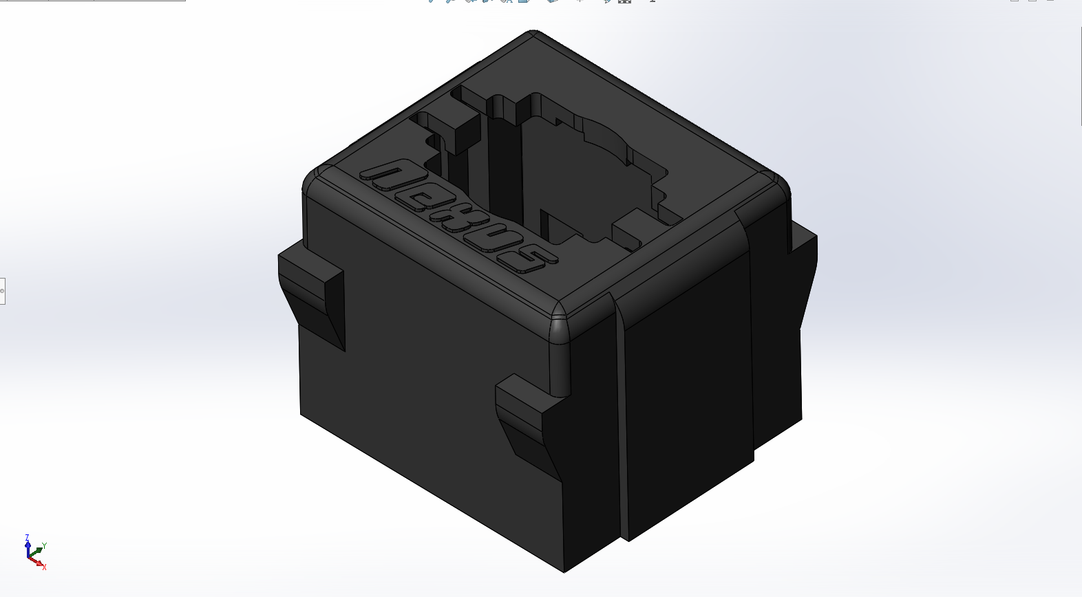

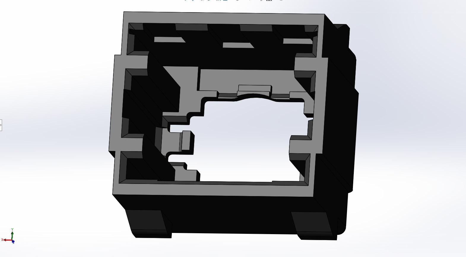

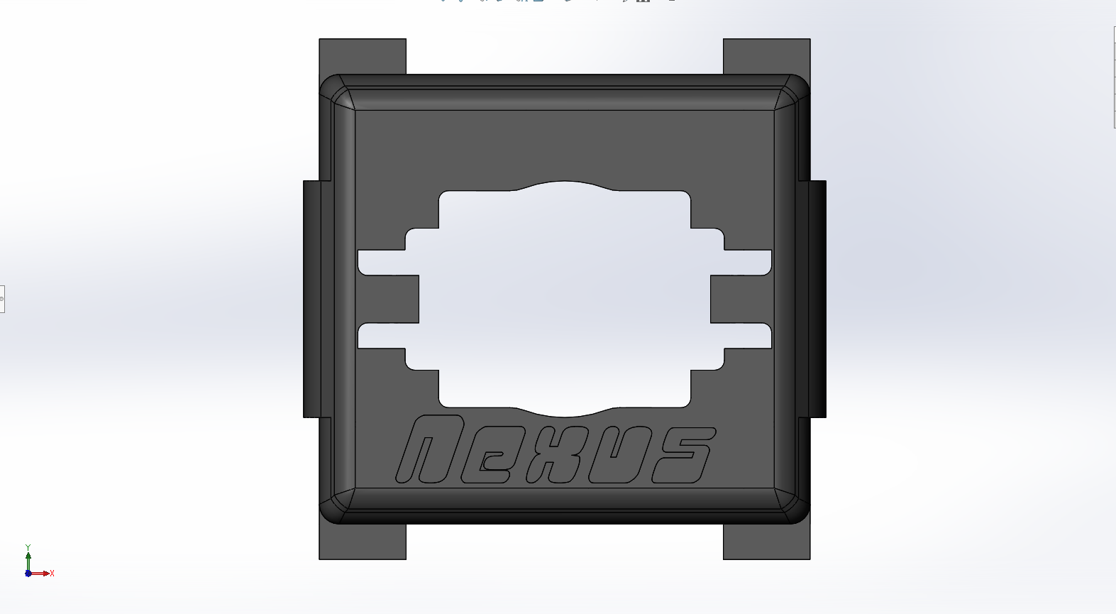

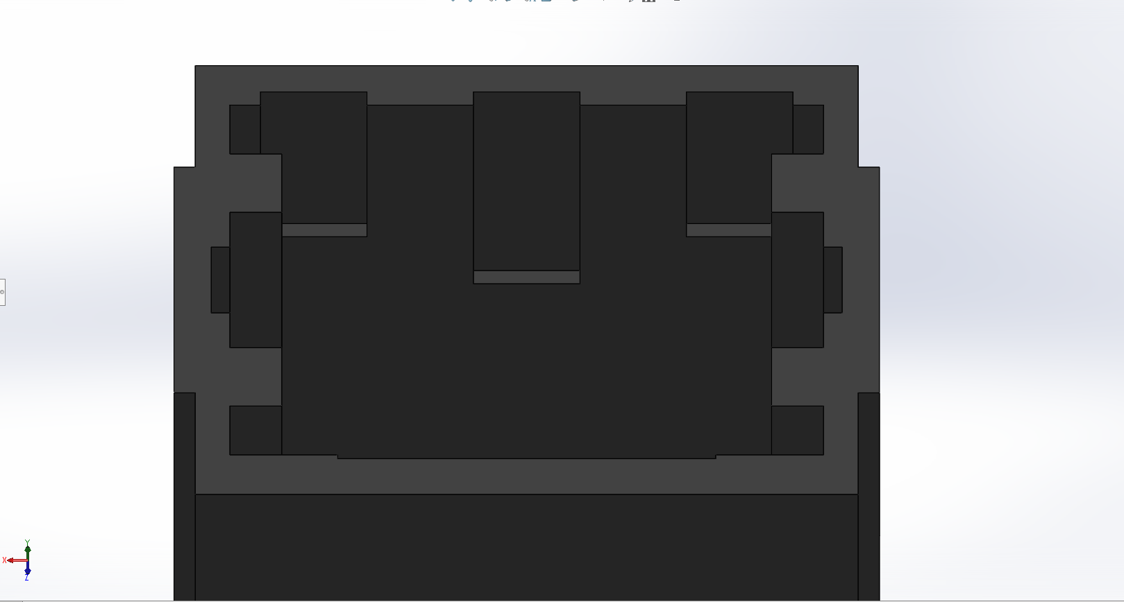

Something that I noticed while modeling the housing is that SKCM Black alps used a different mold than any other SKCM (pine or bamboo) I don't know why this was done but it was, so the housing will fit on pine or bamboo alps, not sure about SKCM Brown as I don't know if the housing was different to accommodate the different style click leaf/plate. If it is physically the same width and depth slot in the top housing as any other SKCM switch, then it should fit. I will be testing the prototypes on SKCM Blacks to see if they fit.
SKCM Black Top Housing:
All other SKCM Except maybe Brown:
SKCM_Pine and early bamboo.png (71.95 KiB) Viewed 23052 times
This is what the top housing looks like at the moment, may change in the coming days.

The top slits on the side of the slider seem a little large.
BlindAssassin111
15 Jan 2018, 02:34
codemonkeymike wrote: The top slits on the side of the slider seem a little large.
They were a tad large in that picture, had them at 0.2mm wider than I thought I had made them, fixed that. Only bad thing that would have come from that is more space for dirt, nothing else would have been affected.

Someone please send BlindAssassin111 an SKCM Brown switch! I would send one, but I'm an ocean away and it would take weeks to get there :(
I just disassembled two switches to test top housing compatibility: An SKCM Brown and an SKCM Orange. A few observations:
The Orange top housing had two side slots and a wide shallow slot, like the first rendering above (SKCM Black), whereas the Brown had three slots just like the second rendering (SKCM others).
Something odd happened when I tried putting the Orange top housing on the Brown switch: The top housing wouldn't seat all the way down. Only one of the tabs would lock in, but not both. As far as I could tell (hopefully someone will correct me on this), the plastic piece holding the tactile leaf was preventing the switch from closing, ostensibly because the Orange top housing isn't quite deep enough to accommodate it. The two top housings seem to be exactly the same outer height, so I wonder if there is an indentation inside the Brown top housing which isn't there in the others?
Like I said, someone should really send a Brown to BlindAssassin111 to see if the Nexus design can accommodate Browns

BlindAssassin111
02 Feb 2018, 01:14
Scarpia wrote: Something odd happened when I tried putting the Orange top housing on the Brown switch: The top housing wouldn't seat all the way down. Only one of the tabs would lock in, but not both. As far as I could tell (hopefully someone will correct me on this), the plastic piece holding the tactile leaf was preventing the switch from closing, ostensibly because the Orange top housing isn't quite deep enough to accommodate it. The two top housings seem to be exactly the same outer height, so I wonder if there is an indentation inside the Brown top housing which isn't there in the others?
I figured out the reason why it wouldn't close, if you look inside of the top housing there are rectangular recesses on the back of the top side. On an SKCM Brown the housing is mirrored, meaning they are identical on both the switchplate side and tactile leaf side. This is not the case for all other SKCM switches. The SKCM Orange, and every other SKCM variants, matches my pictures where one side has two bars dividing that recess on one side only. The point of those bars is so the tactile/click leaf is held in place at the top and bottom better. These bars prevent the browns tactile leaf from fitting inside any other top housing.
Now because of this I have to make a modification to the top housing I designed in order to accommodate both, which will be pretty easy with an idea I have. I can't do anything today as I have to build a new computer in order to do CAD again, as the last one decided it didn't want to live anymore...So probably saturday or late tomorrow I can make the change.
But just a quick announcement: My sliders are once again compatible with clicky switches and in fact work with stabs. I will make a video maybe tomorrow going over what was found out. As well they work with SKCM Brown beautifully. Just have to fix the top housing and then they will forever be compatible.
