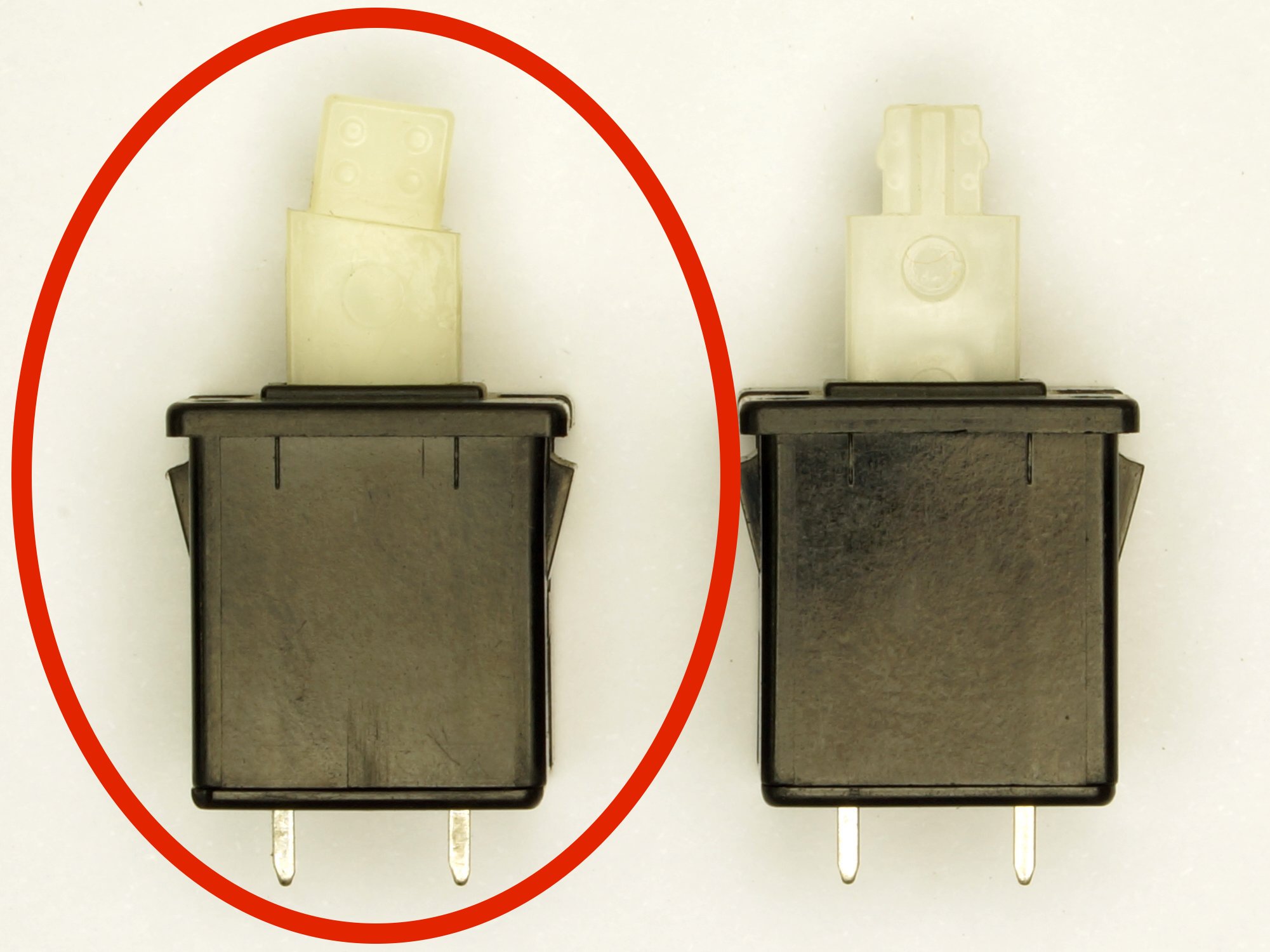

17 Dec 2023, 20:04
I recently find a huge NOS Stock of the one I marked. Have you ever see same key switches on other machines?
Thank you.
Facitman
25 Dec 2023, 12:22
Hello,
Sorry for the late answer, I didn't receive an email for the new post.
Difficult for me to answer if they were used on other makes as I was service engineer for the Belgian importer of Facit.
They were used on Facit models like 1880, 1885, 6452, 6480 and all the 8xxx series.
