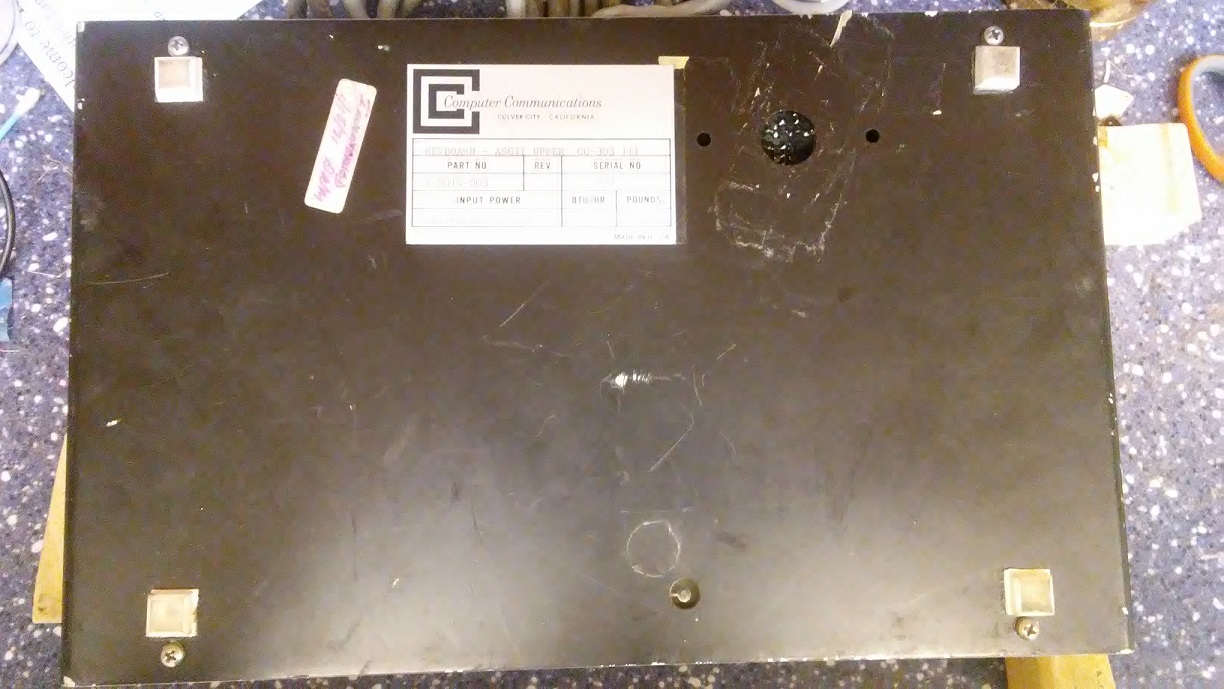

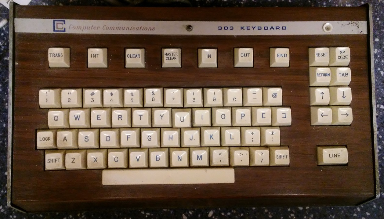

I was recently able to pick up a Computer Communications 303 keyboard.
orig sm.jpg (287.49 KiB) Viewed 3164 times
back sm.jpg (272.73 KiB) Viewed 3164 times

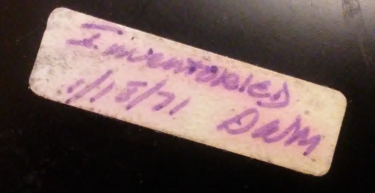

The PCB is marked 4-69, I'm not positive it's a date of manufacture, but I did find a brochure for the board from March 1970 and there is an inventory sticker on the back from Jan 71.
label sm.jpg (257.03 KiB) Viewed 3164 times
tag sm.jpg (84.94 KiB) Viewed 3164 times

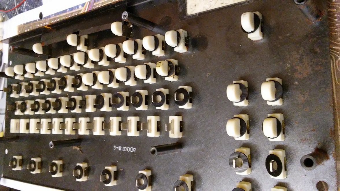

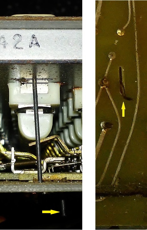

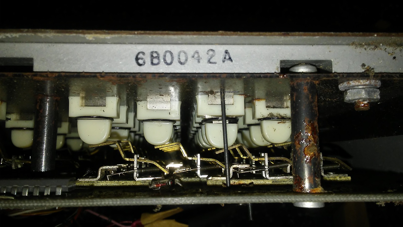

The switches are a mechanical lever type. depressing the top lever stretches a spring and causes a second small lever contact to snap up against a contact plate.
switches1 sm.jpg (408.83 KiB) Viewed 3164 times
PCB front sm.jpg (584.52 KiB) Viewed 3164 times
plungers sm.jpg (339.64 KiB) Viewed 3164 times
Switches in action:

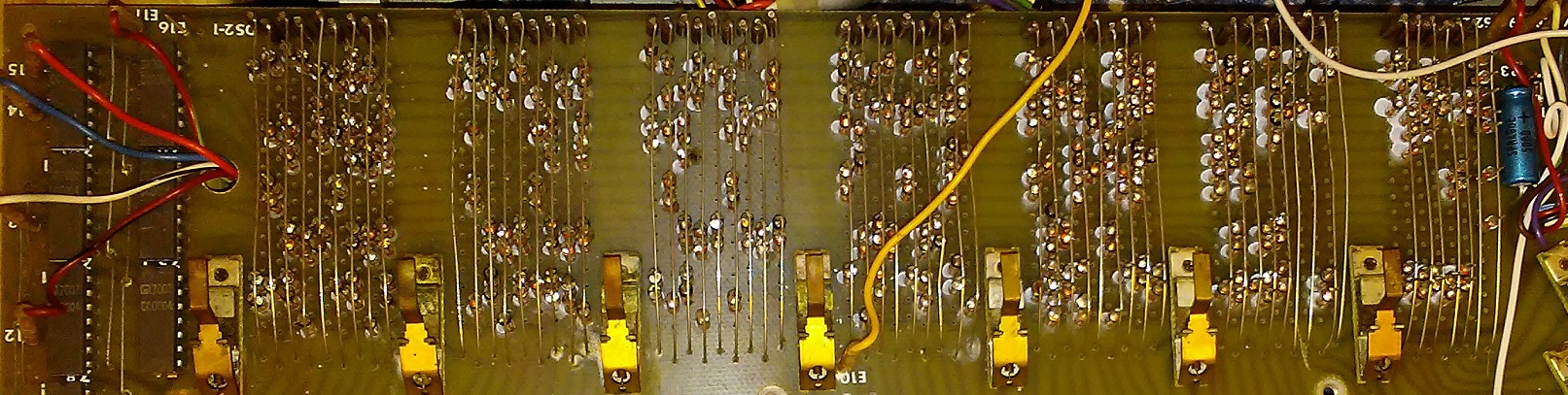

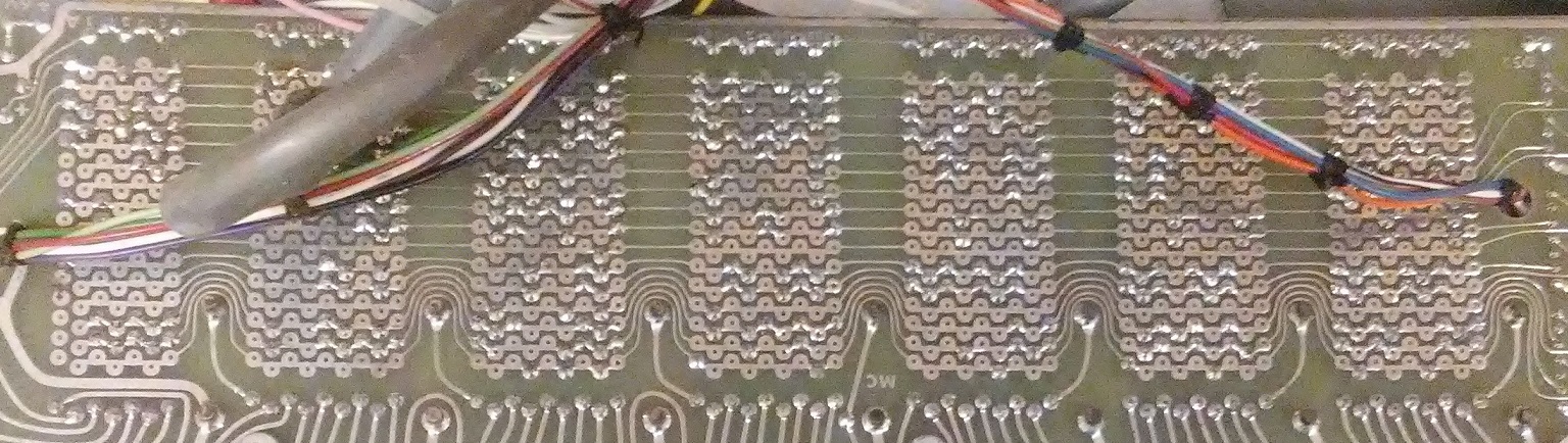

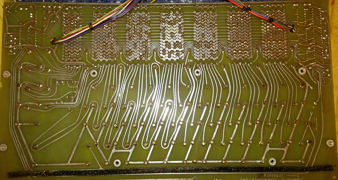

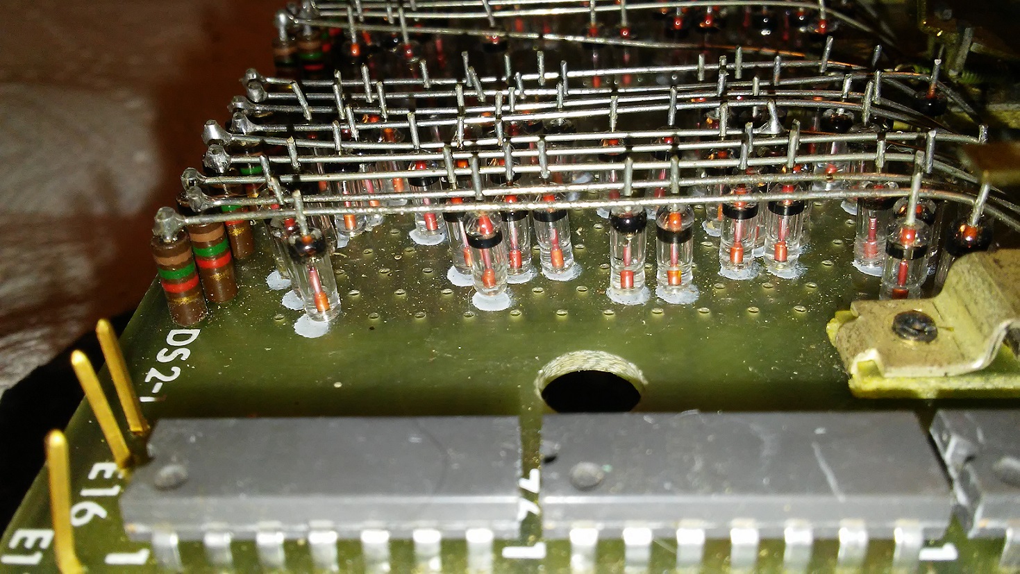

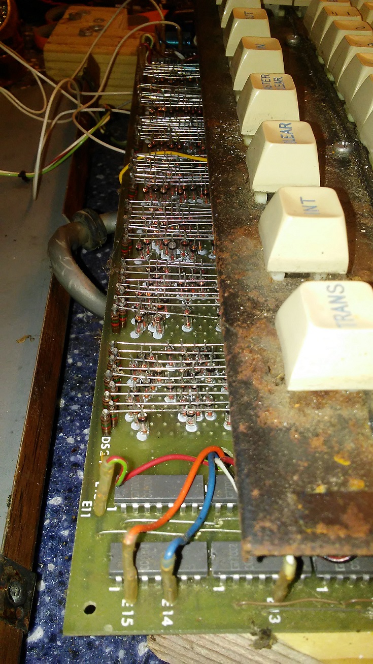

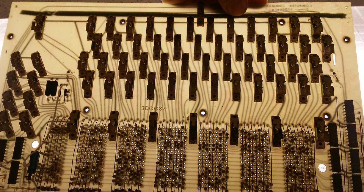

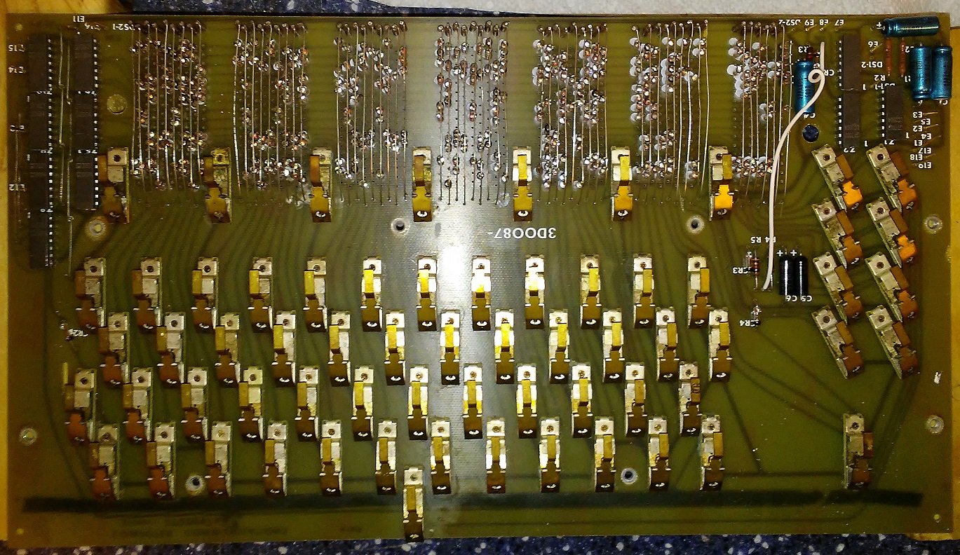

The PCB is interesting ALL the switches are on ONE row and thus each has it's own column which runs though a row of diodes before connecting to ICs.
PCB_BACK2 sm.jpg (503.94 KiB) Viewed 3164 times
diodes sm.jpg (435.54 KiB) Viewed 3164 times
diodes3 sm.jpg (505.47 KiB) Viewed 3027 times

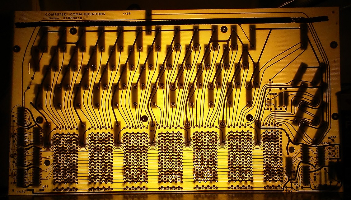

Here a couple of interesting views though the PCB with back lighting:
backlit front.jpg (406.02 KiB) Viewed 3164 times
backlit back.jpg (451.83 KiB) Viewed 3164 times

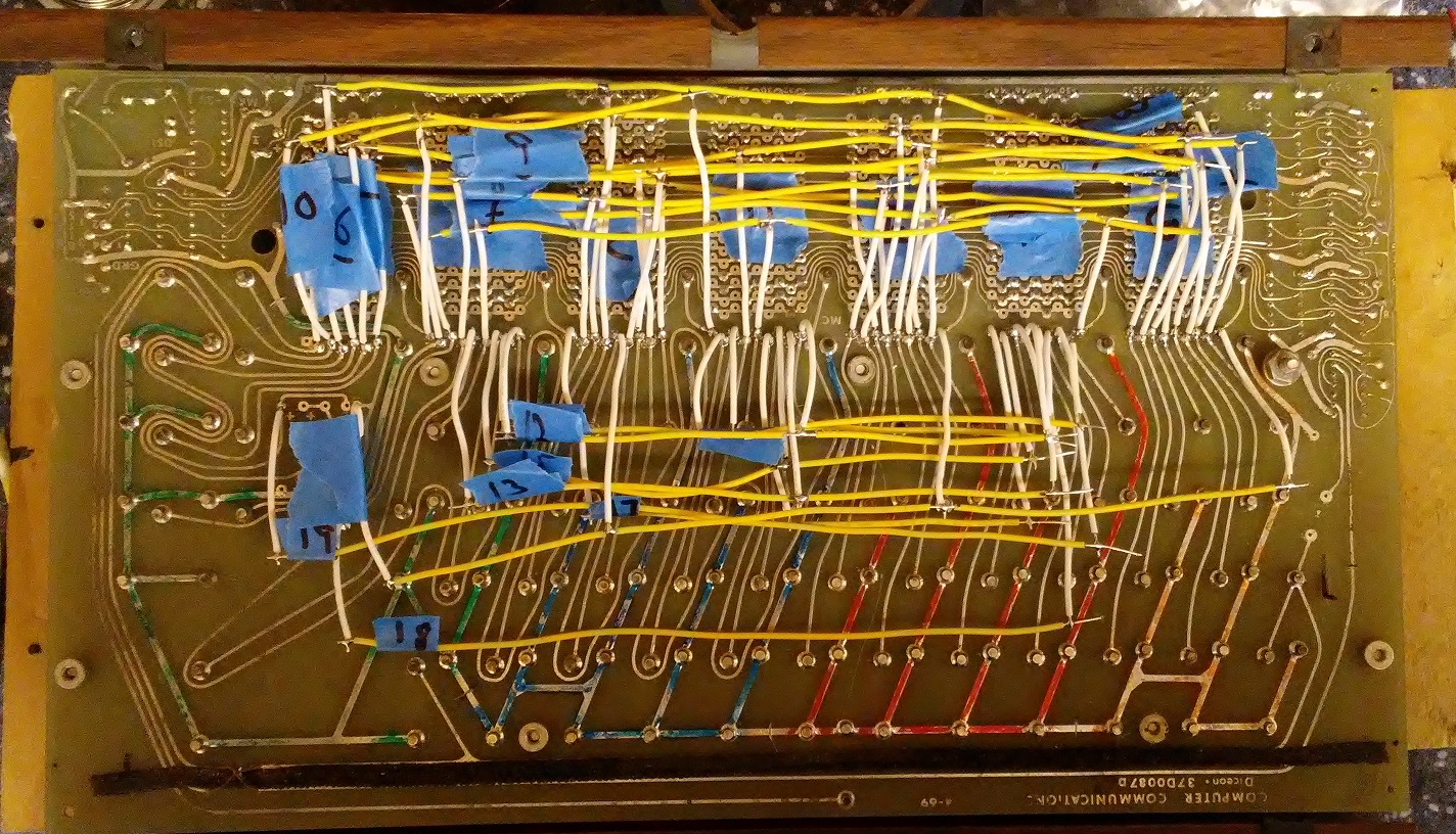

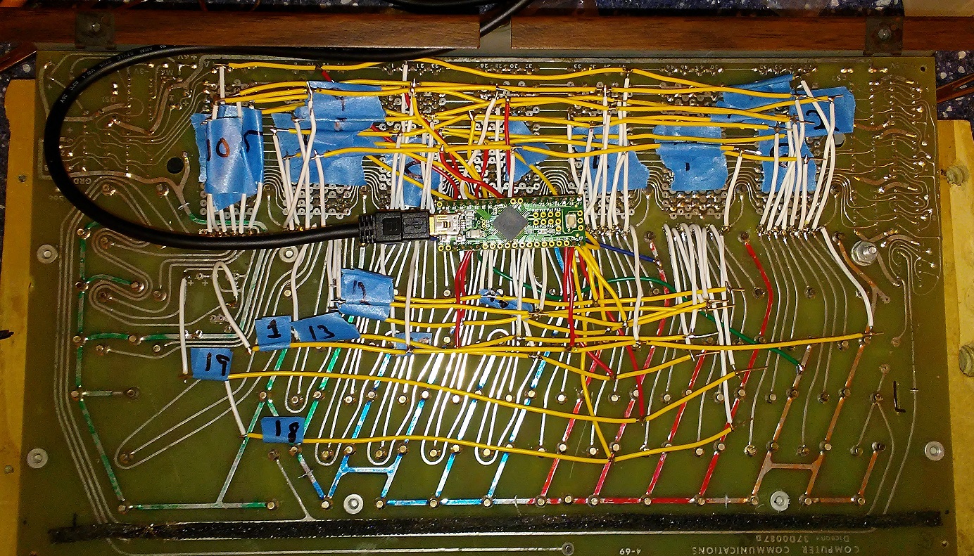

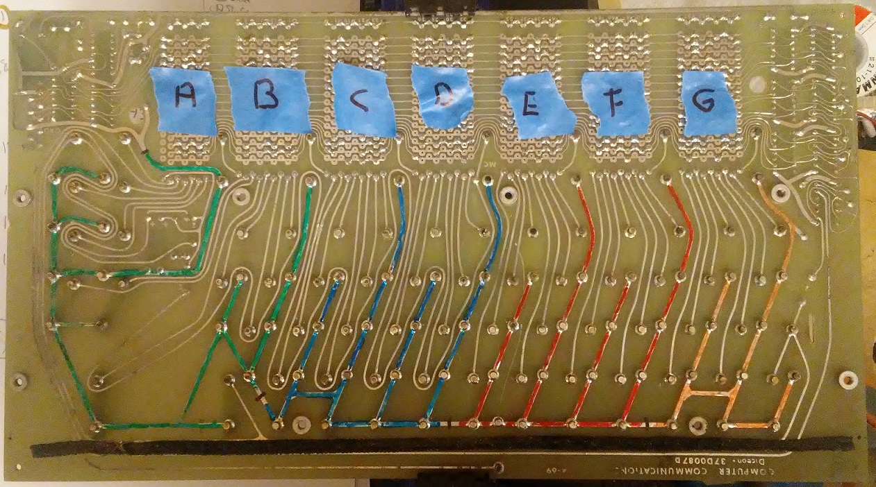

Since the matrix is one row with 65 columns this was a bit of an issue for one Teensy++ - so I bit the bullet and made cuts in the row trace (very small cuts with a utility knife that could easily be re-bridged) to create 4 rows and then wired up the four rows (AB, CD, EF, G) and the columns.
Rows_Color sm.jpg (445.89 KiB) Viewed 3164 times
wired1 sm.jpg (638.73 KiB) Viewed 3164 times
wired2 sm.jpg (699.61 KiB) Viewed 3164 times

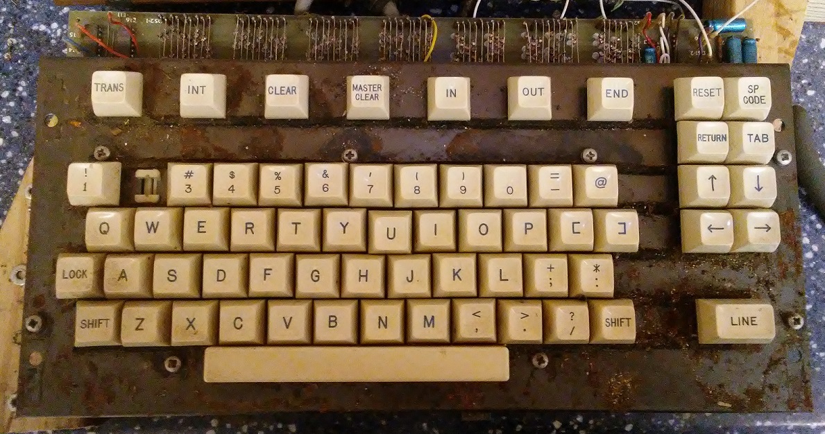

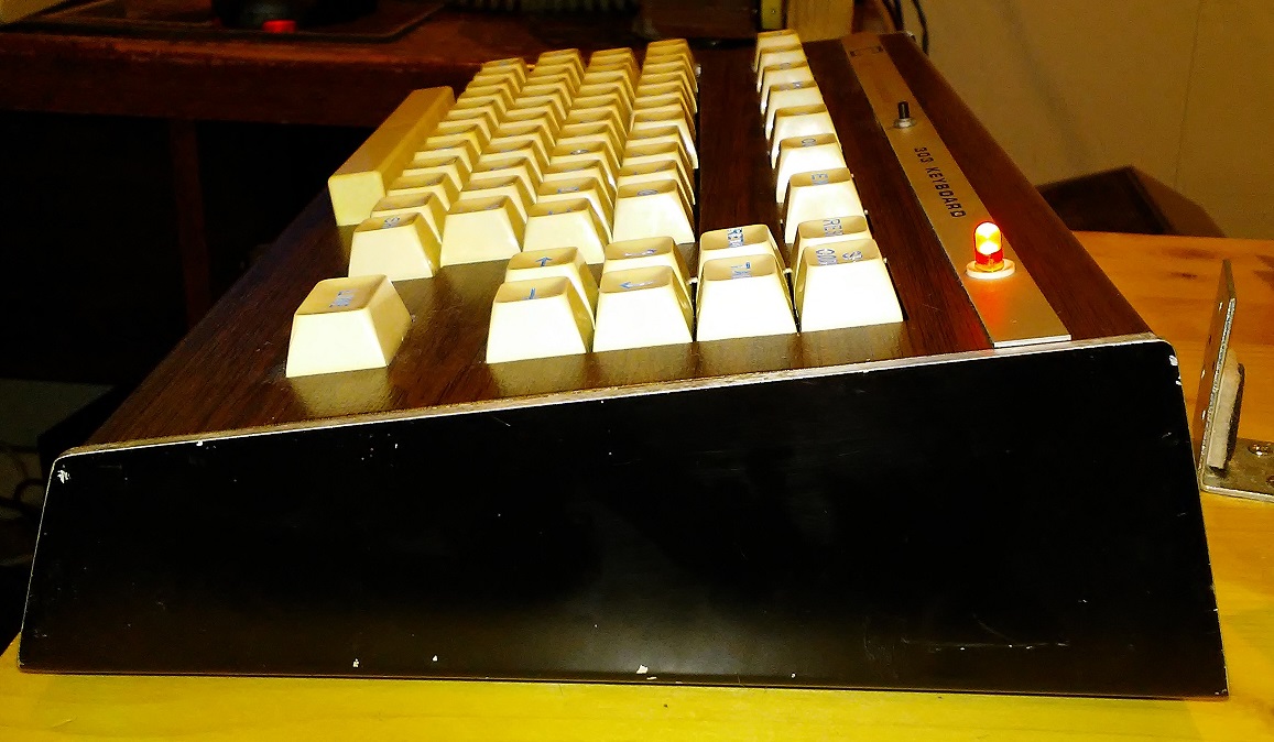

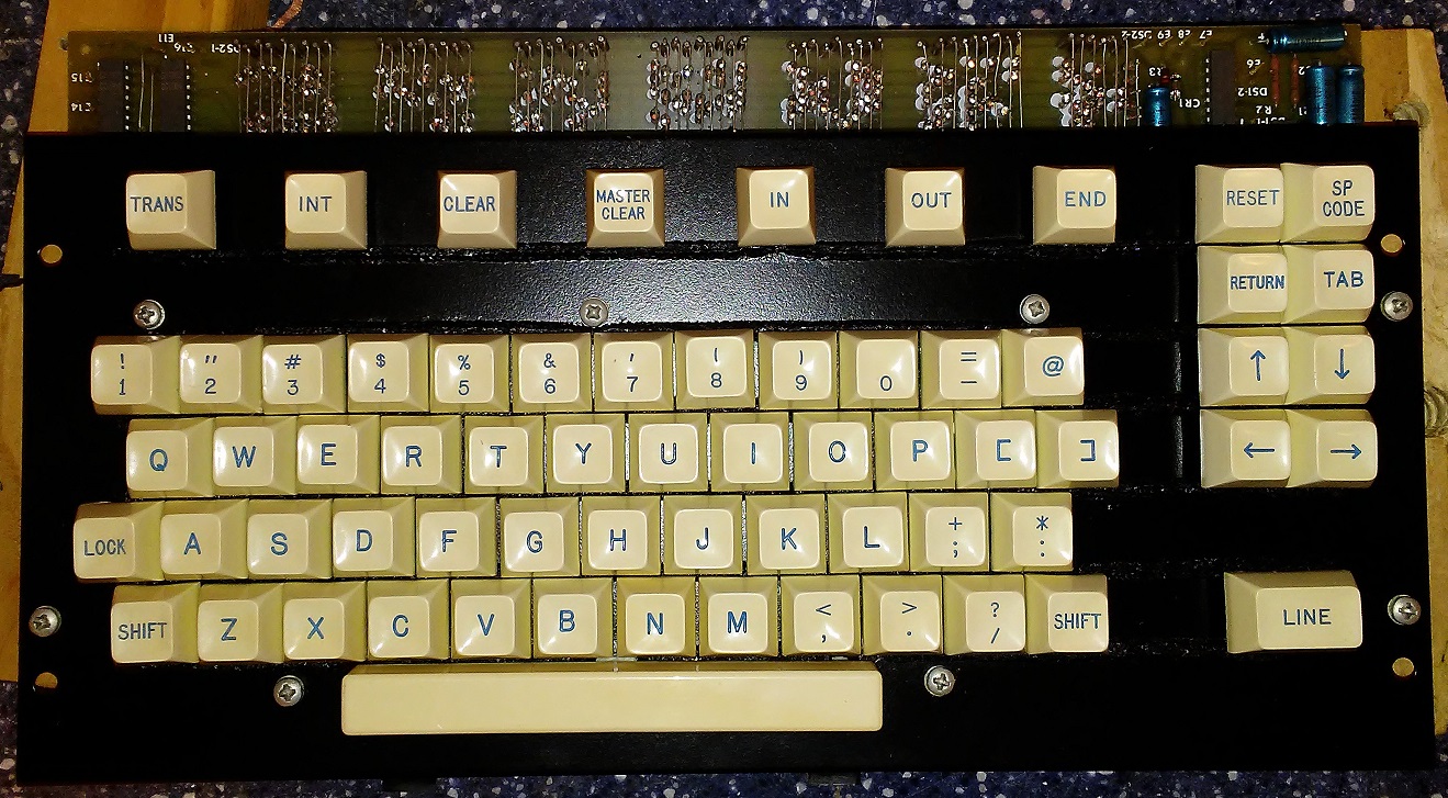

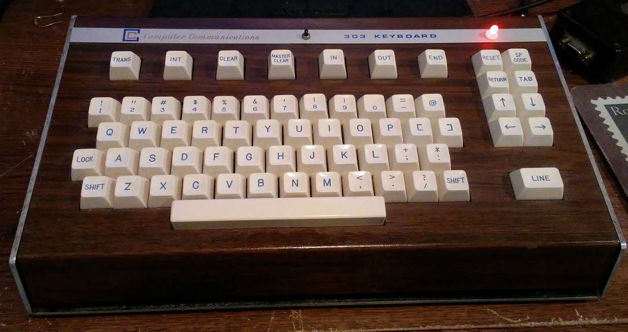

Then refinished the face plate which had quite a bit of rust and cleaned up the case.
refinished sm.jpg (415.34 KiB) Viewed 3164 times
working sm.jpg (263.93 KiB) Viewed 3164 times
working3 sm.jpg (211.26 KiB) Viewed 3164 times
I'm not sure it's going to make it as a daily driver, but it is fun to use!

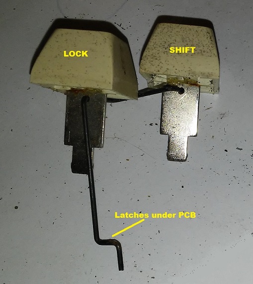

A couple of other things about the board - the original key matrix is actually one row and 63 (not 65) columns because both SHIFT keys and the LOCK key are on the same column. The lock key has a mechanical latch that when pressed also depresses and latches down left SHIFT key :
When the left SHIFT key is next pressed it releases the latch. Kind of a nice simple hardware approach to a caps lock button.
Also I think the diode matrix is one of the more interesting aspects of this board:
Diode matrix front
Diode matrix front
Diode matrix back
Diode matrix back
I haven't been able to find out a great deal about them so far, but apparently diode matrices can be used as encoders (as I would guess it is being used on this board) and were also used as ROM in early computers. Does anyone know more about this topic?
