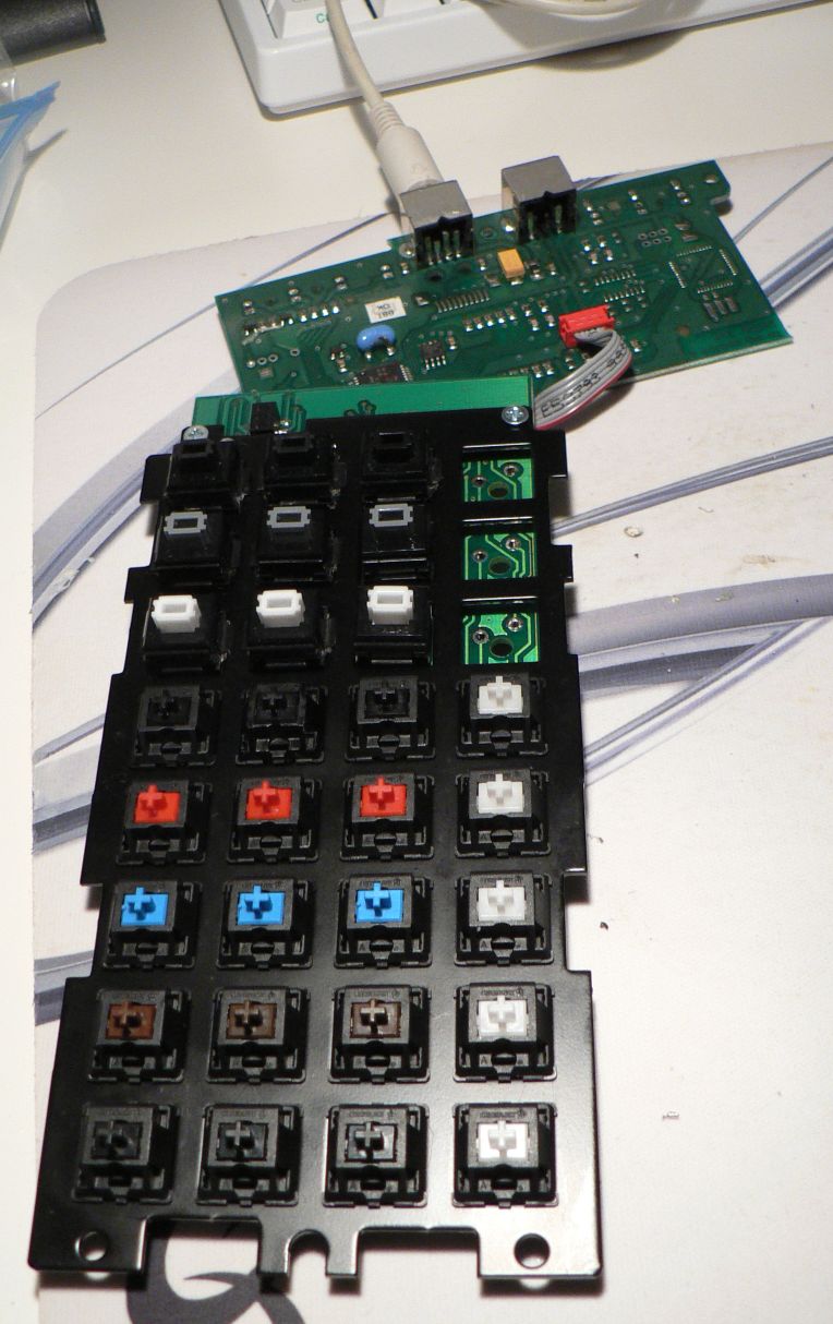

This Item becomes the Switch Try Numpad V2 presented by Mr.Interface and me.
All Keys in full function on a Tipro Modul.
A few things for me ToDo:
- ad 3 mod ML Switches
- housing question (want to keep it light)
A few things the comunity could do
- question of programming
should the keys be programmed with only one key?
so you better could get an impression where is the trigger point?

@sitxty - i file the side's of the alp switches to fit in the plate. i was able to solder them on w/o making new holes.
Unfortunately, some a little bit awry.

ok, item is finished and programmed.
pics here:
http://deskthority.net/viewtopic.php?f=8&t=1897
the buttons are programmed with one key.
1st button always beeps at activation. 2nd and 3rd have no beeps.

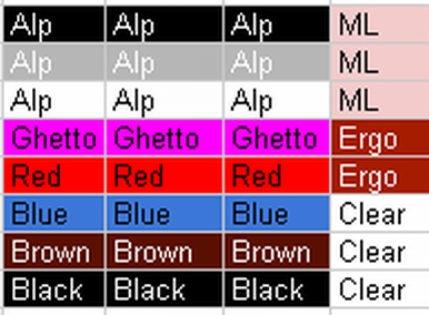

CeeSA
30 Jan 2012, 22:05
Layout:
