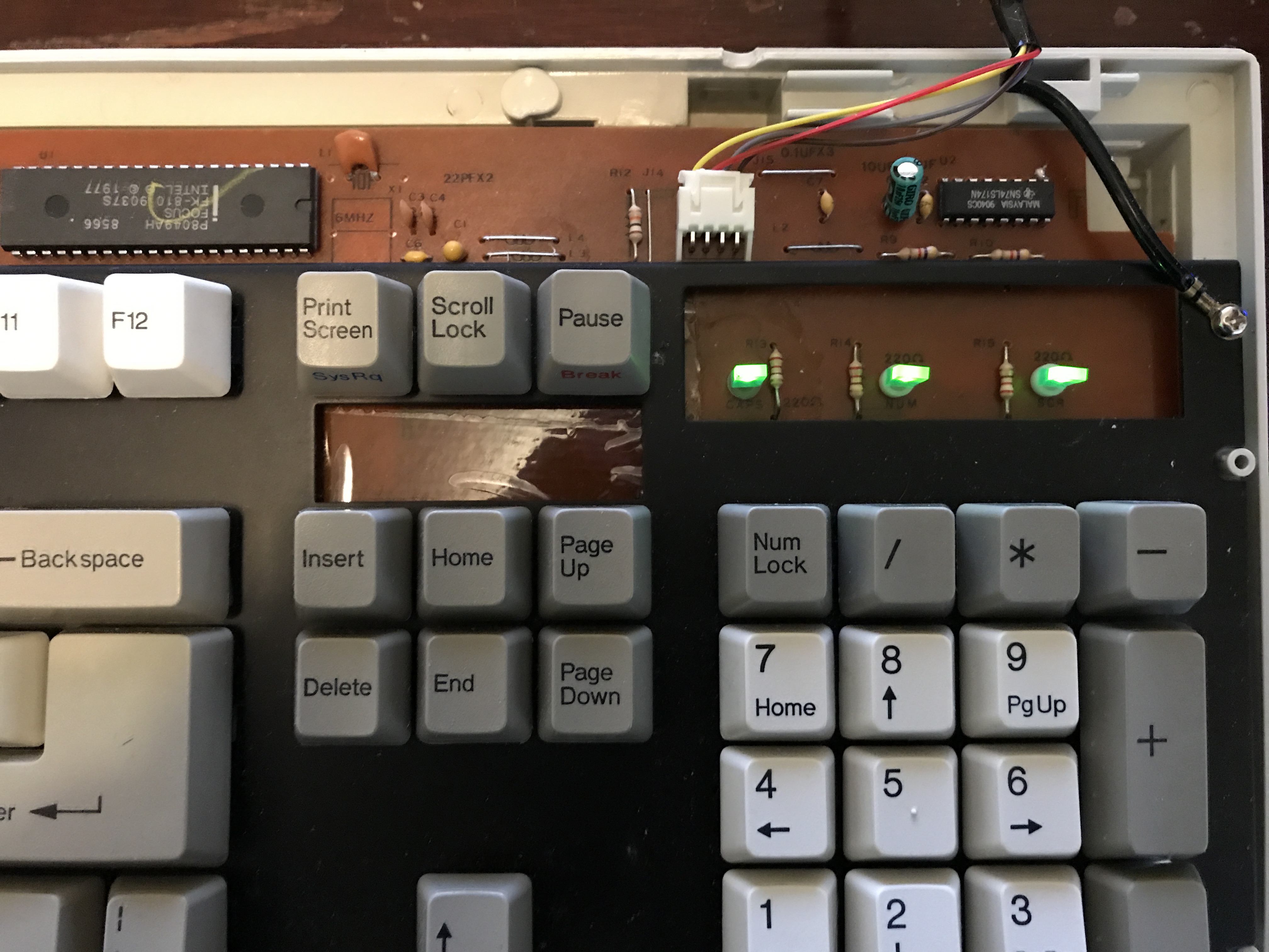

Thanks, Polecat! I was able to wrest the top of the case off, and it was way more difficult than it was meant to be. Anyway I found some kind of (spider?) nest under the Tab key which I quickly swabbed out. Thankfully it was abandoned, and the rest of the interior is really clean. So I plugged it in to see what's what, and all the lock lights work; I can turn them off with their respective keys. However none of the keys register. I'm thinking it's a capacitor, but I'm not sure which ones to replace. I attached a pic. Thanks for looking!
- focus_innards.JPG (1.84 MiB) Viewed 6898 times

if nothing else, the keycaps look to be in excellent condition!

The lock lights look like they're all on. That's indicative of an error of some kind. I'm sure there are people here that know more about it

The blue capacitor upper right would be the one to replace, and any others that look like it. But first have you checked that the AT/XT switch is in the correct position? Also try moving that switch back and forth a few times--the contacts can oxidize with age and fiddling with the switch will sometimes get things working.digital_matthew wrote: Thanks, Polecat! I was able to wrest the top of the case off, and it was way more difficult than it was meant to be. Anyway I found some kind of (spider?) nest under the Tab key which I quickly swabbed out. Thankfully it was abandoned, and the rest of the interior is really clean. So I plugged it in to see what's what, and all the lock lights work; I can turn them off with their respective keys. However none of the keys register. I'm thinking it's a capacitor, but I'm not sure which ones to replace. I attached a pic. Thanks for looking!

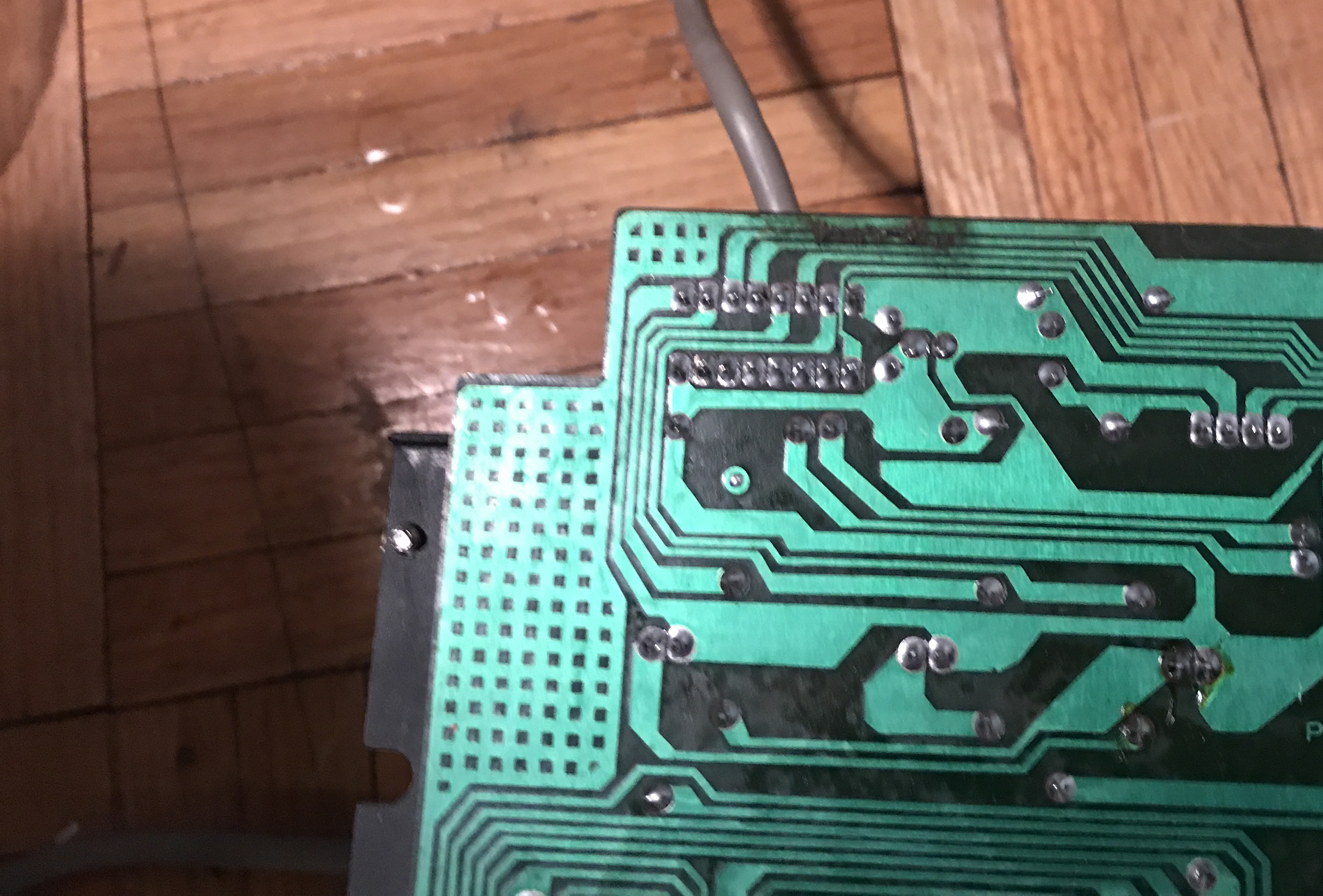

Thanks. I sprayed some contact cleaner into it and moved it back and forth. Alas it didn't work. However, I did flip the board over and noticed some crud on the traces near the cable. I'm thinking of getting some isopropyl alcohol and cleaning them. I'm pretty sure that's the culprit.The blue capacitor upper right would be the one to replace, and any others that look like it. But first have you checked that the AT/XT switch is in the correct position? Also try moving that switch back and forth a few times--the contacts can oxidize with age and fiddling with the switch will sometimes get things working.
Aye, in fact they are my favorite thing about this board.
- focus_crud.JPG (3.03 MiB) Viewed 6857 times
