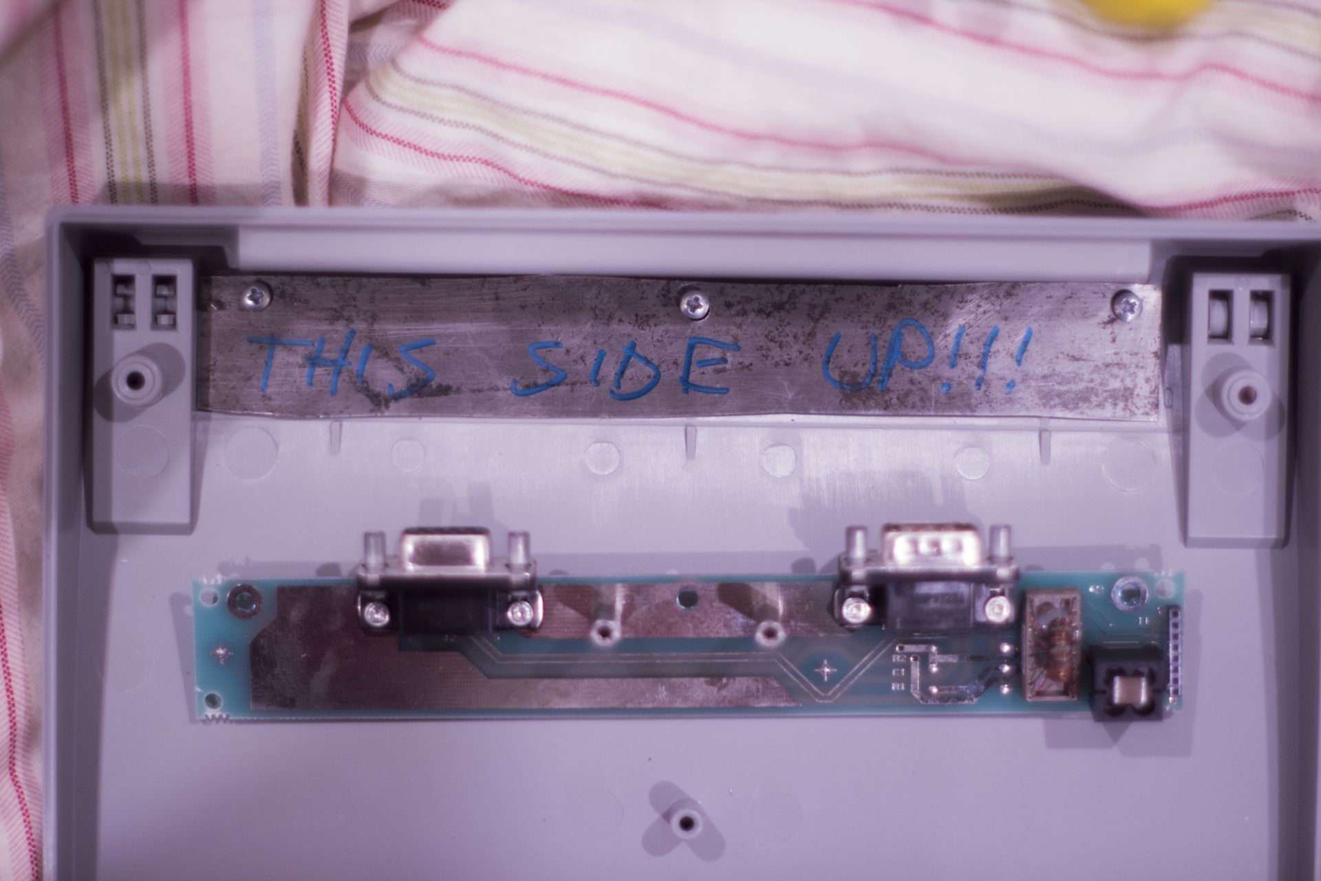

First I removed the main board and fashioned a steel plate to replace the connector plate with.

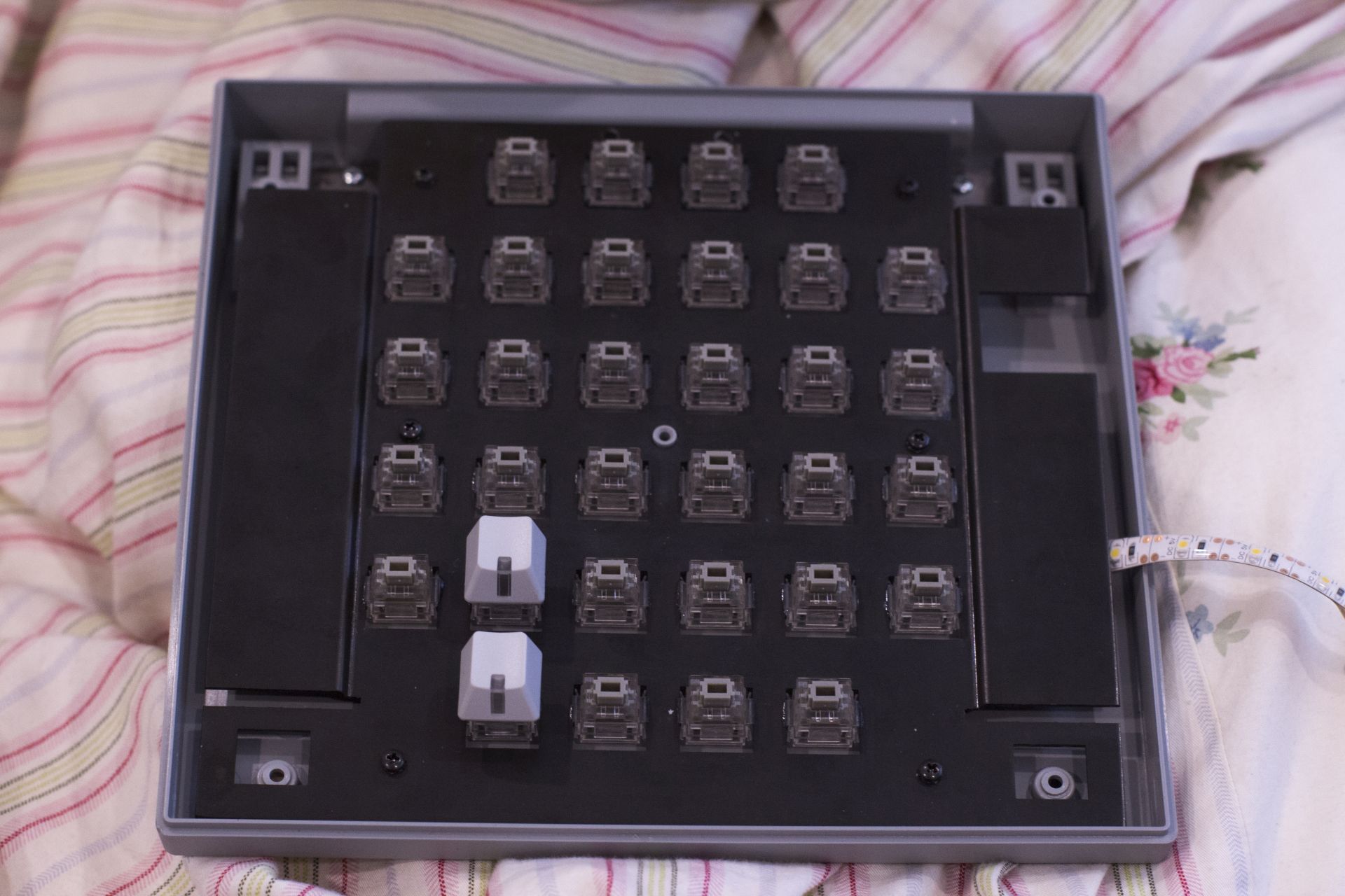

I then went about replacing the horrible Cherry Black switches with my favourite switch, Matias Quiet Clicks with the rubber dampeners removed. I just glued them into the Cherry holes for lack of a better method.

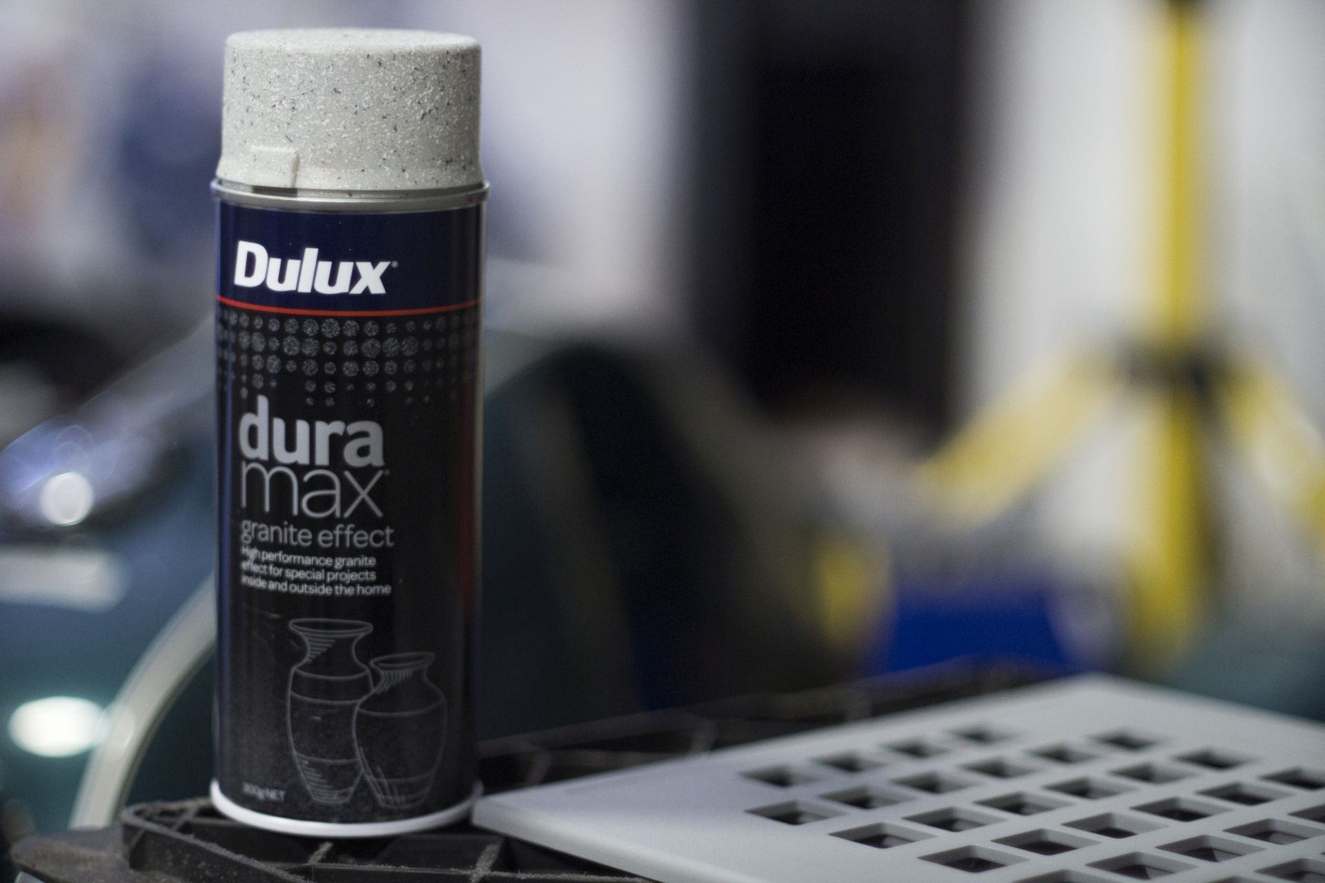

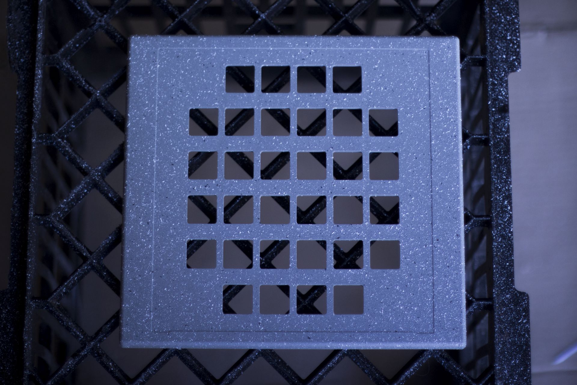

Then I went about solving the issue most boards have, NOT GRANITE ENOUGH.
I was fairly pleased with the end result, this paint is pretty cool stuff, it basically shoots little flecks of black and white rubber to the surface, then you protect it with clear coat.

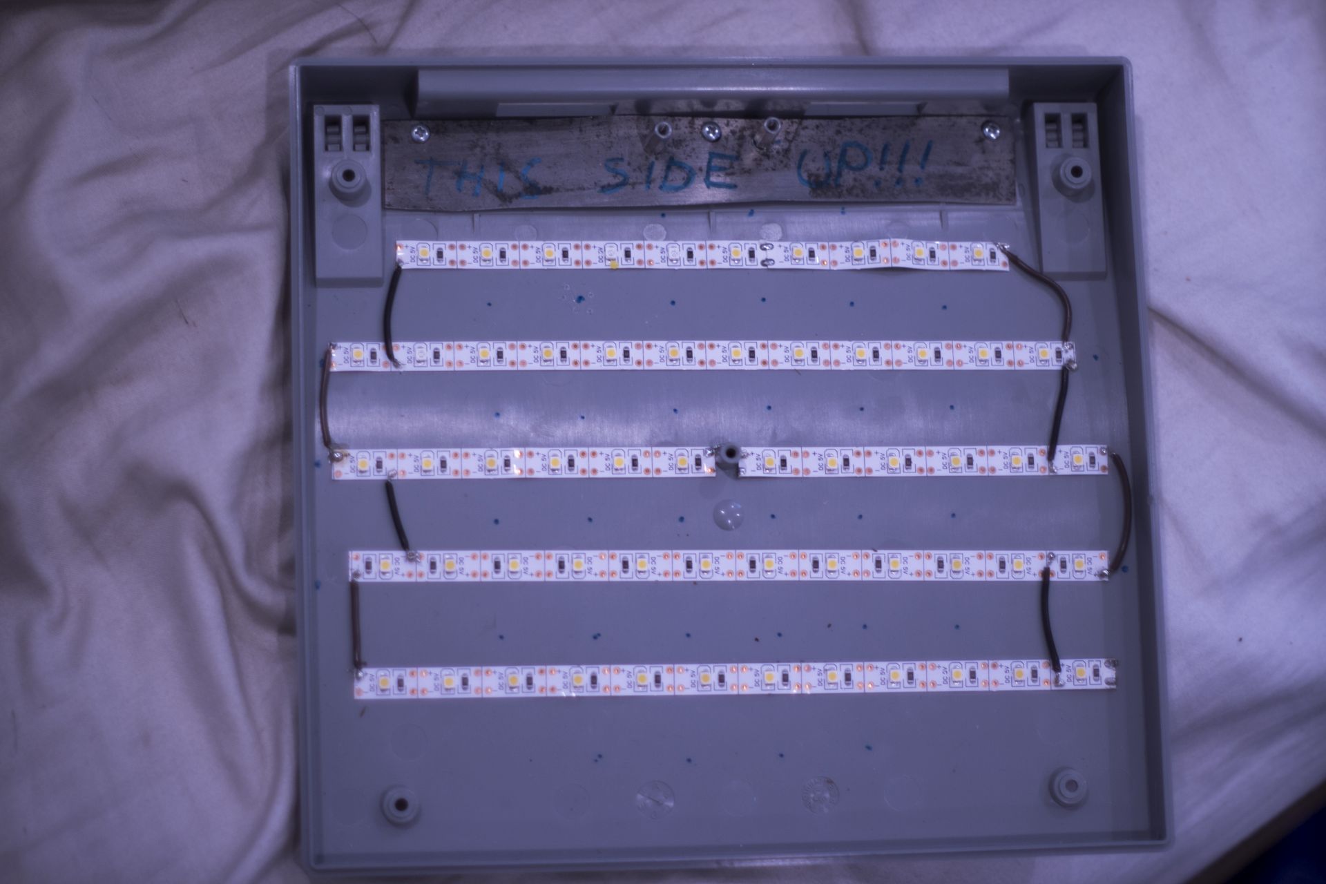

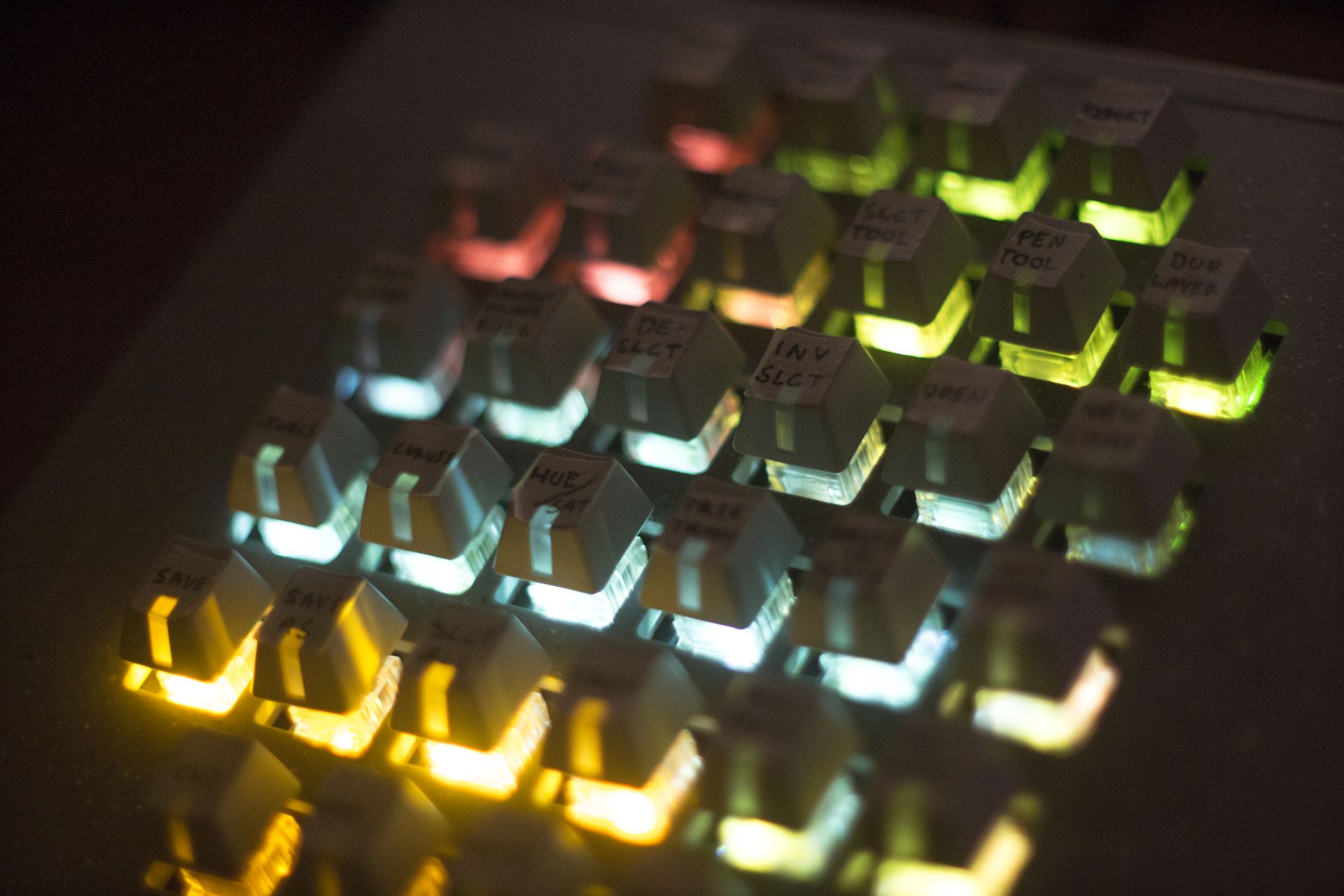

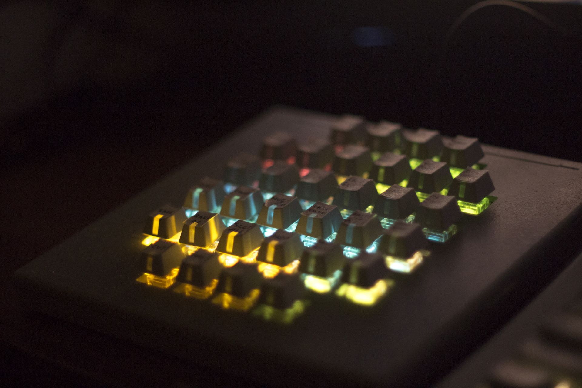

I went about installing the backlighting in a similar fashion to how I did my main Bigfoot. This ended up being a mistake, as with the big board I wanted even dispersal with no hotspots, but on this board, I really should have placed one LED directly under each key. I might go back and redo this later.

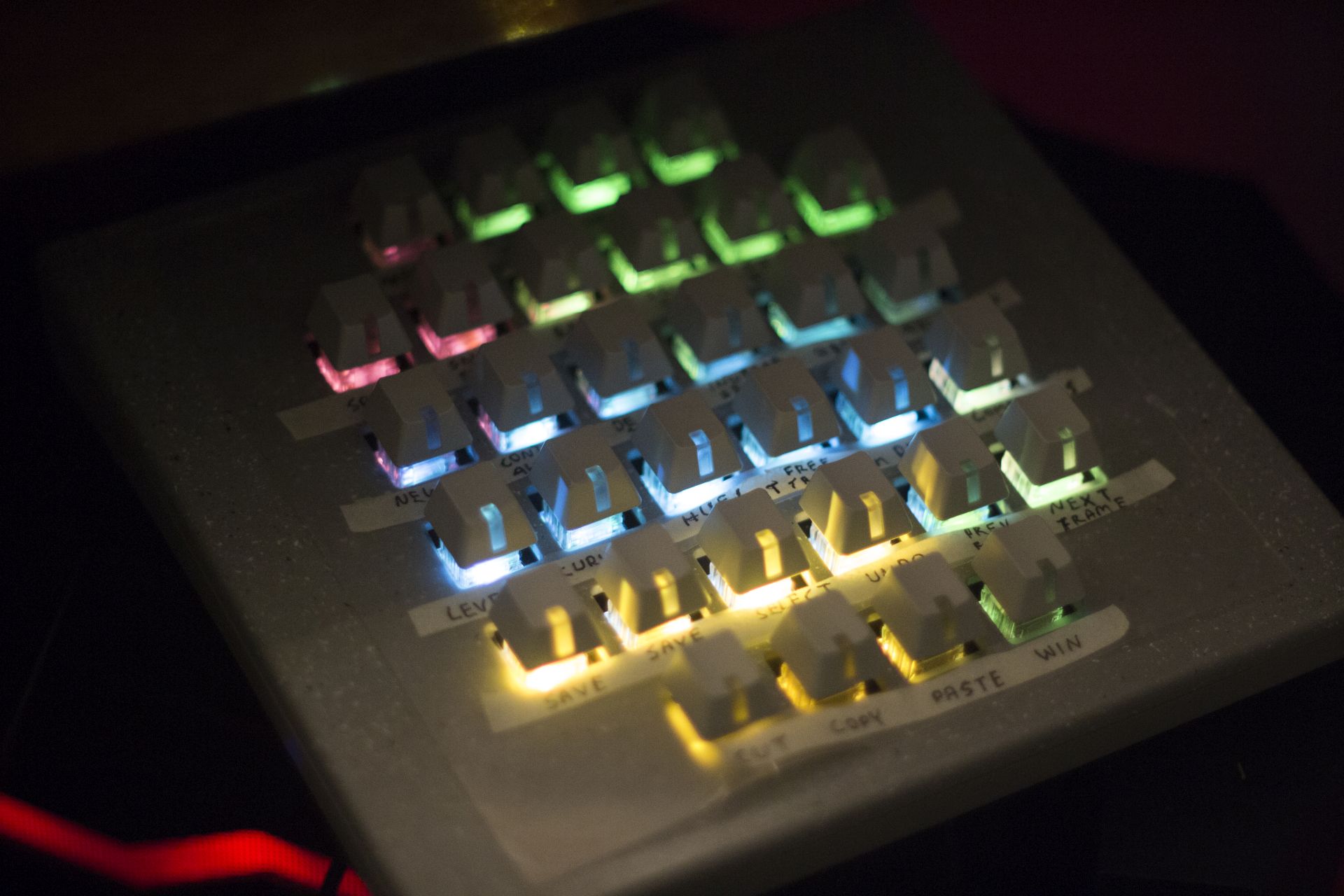

After it was up and running, I decided I needed some colour to differentiate different hotkeys for different programs, so I went in with some Cellophane to make them stand out, Blue for Photoshop, Purple for Premiere, Green for After Effects, yellow for standard Windows stuff.

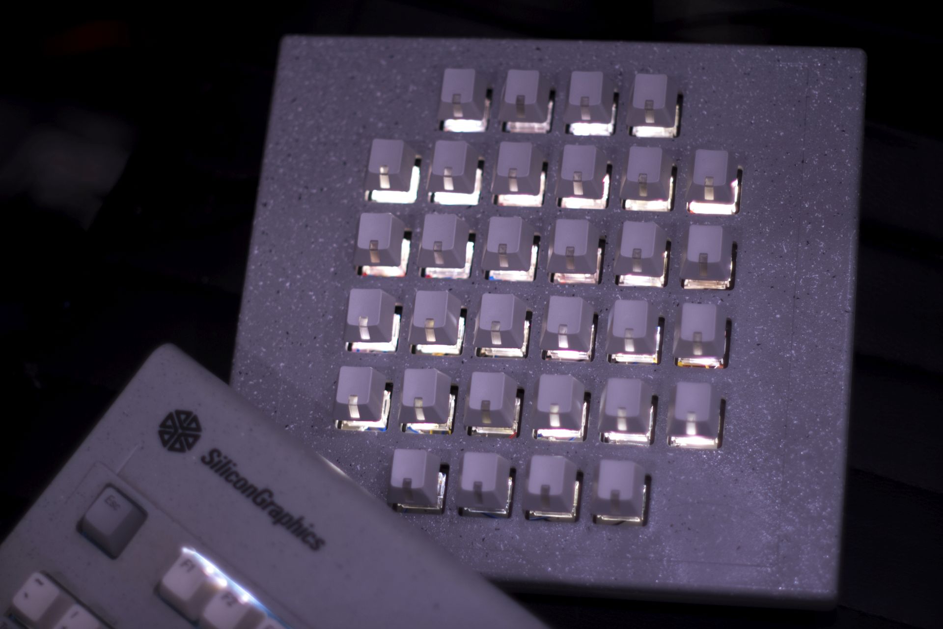

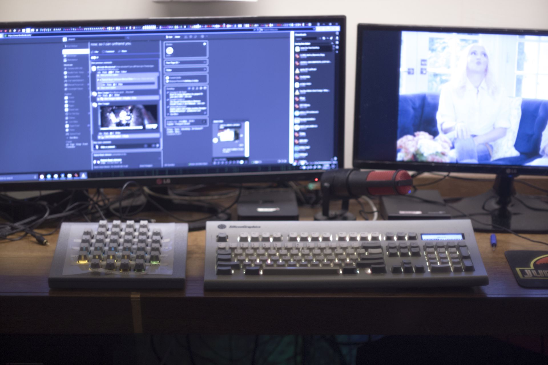

I thought I should take a picture with it's new buddy, so I cleaned my desk just for this, I feel like a real sellout with my hackdesk all neat and tidy.
All in all I love using this thing, as a film maker and Animator every time I have to go to the mouse for something I could otherwise do on the keyboard just adds to wrist strain, and I am loving the use I've gotten out of it so far. I'm glad I could bring this ancient Serial board back to life with the almighty Frankensteins Lightning of USB Power!

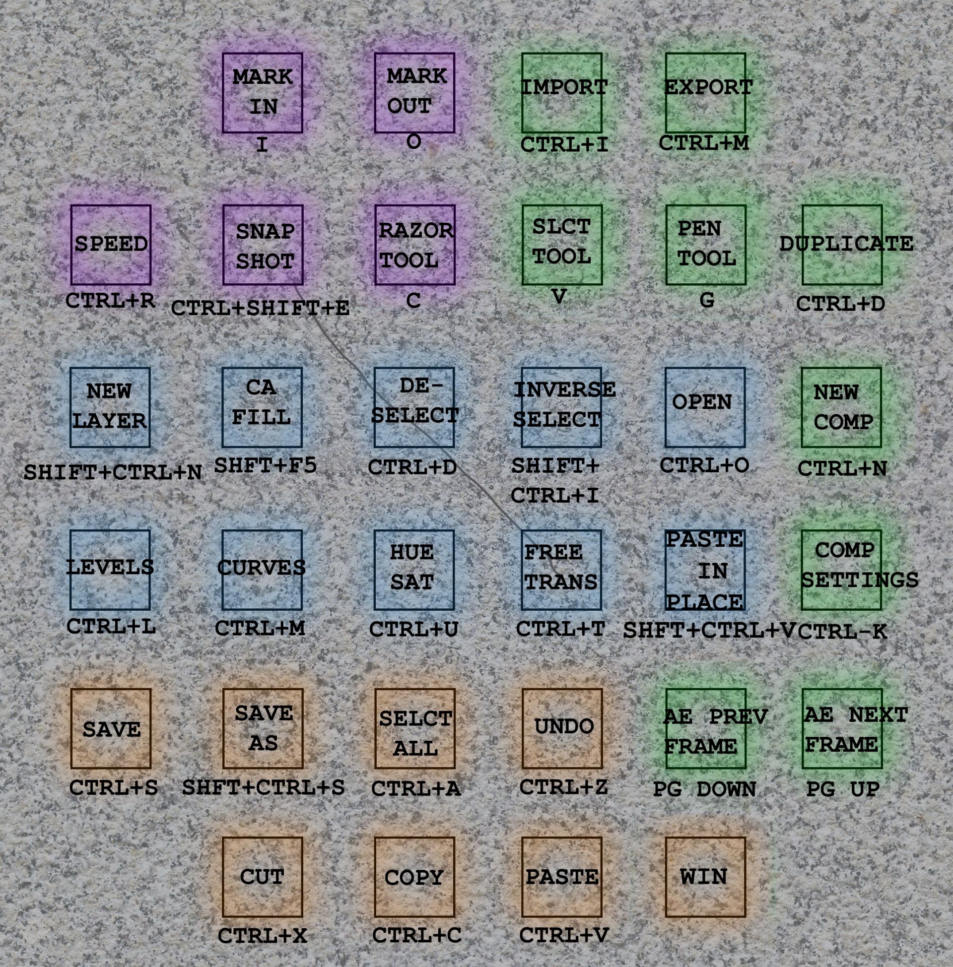

Here is the hotkey layout I decided on if anyone is interested.
