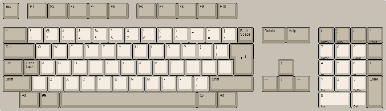

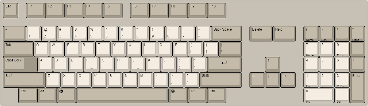

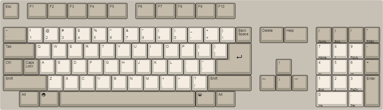

I just bought (as-is, as a project) an A500, and found out the keyboard membrane was removed by the (or A) previous owner. I have a layout ready, and a PCB in design, but I can't seem to be able to find how the membrane matrix is laid out. if anyone can help me with that, I can trace my PCB accordingly and use the original controller board (or at least components). if not, can anyone help with info to program a µC to interface correctly with the A500?
I have PCBs in design for each of these, I'm leaning toward the ANSI layout though.
ANSI Layout

BigAssEnter Layout
BigAssEnter Layout
ISO Layout
ISO Layout

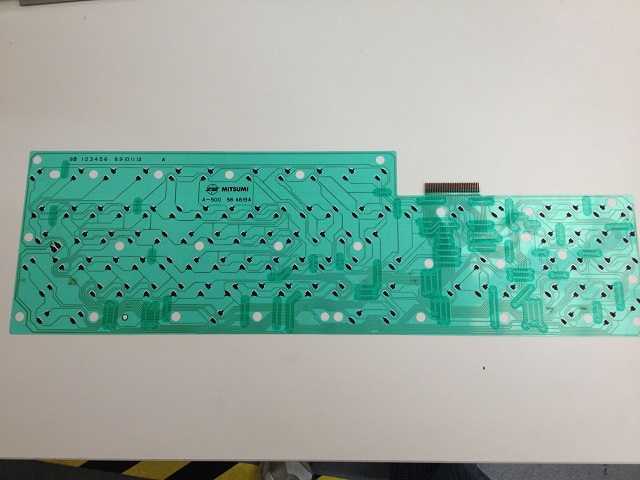

Is this what you are looking for?
Amiga A500 Membrane2.jpg (109.53 KiB) Viewed 6634 times
This is the big ass enter version.

Sarreq Teryx wrote: absolutely! do you have a higher res version?
No I do not :( I googlfu'ed this one. But it seems good enough to make out the traces.

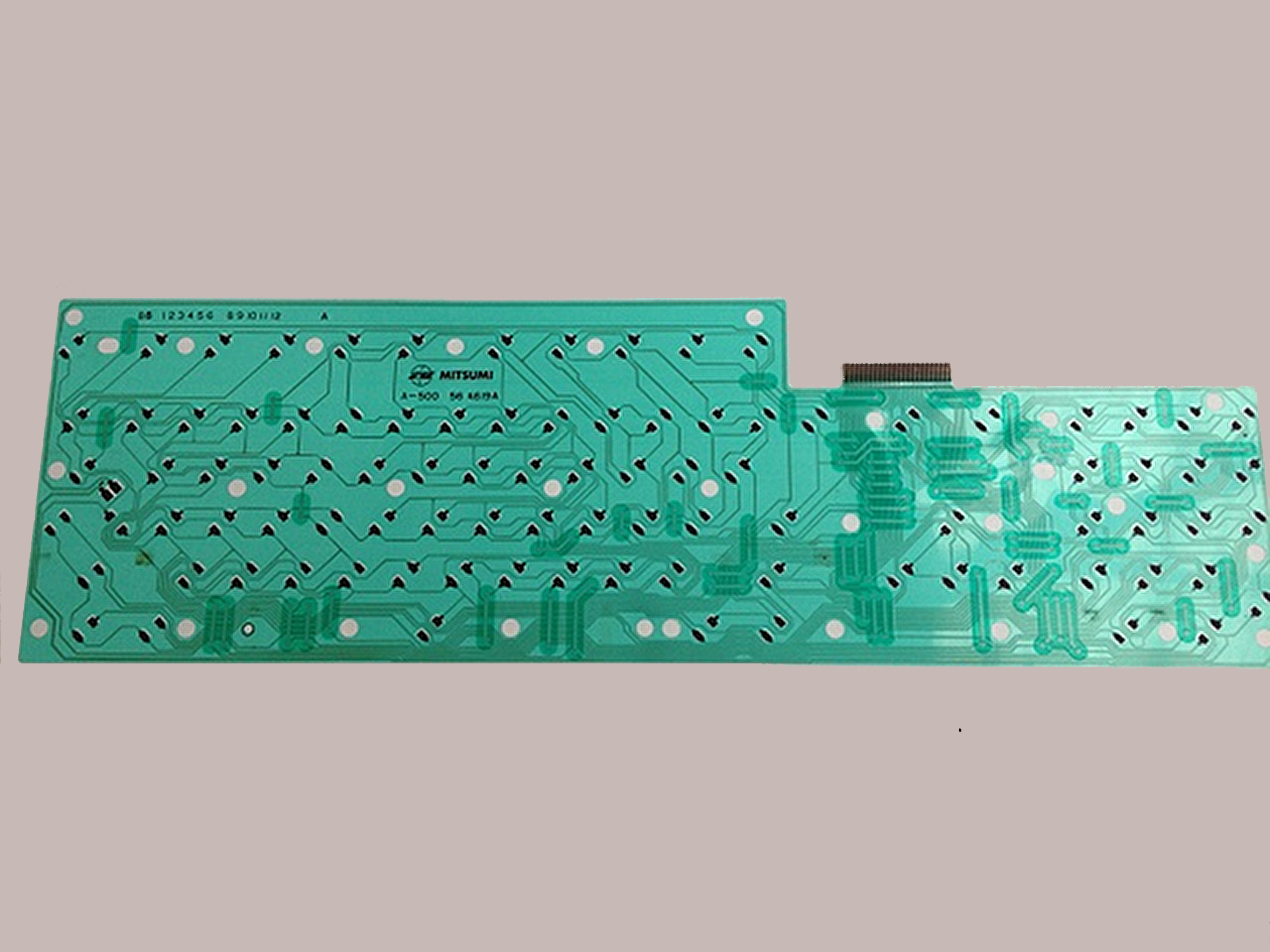

Here, I enhanced it to make it a bit easier to make out:
Amiga A500 Membrane Enhanced.png (4.53 MiB) Viewed 6622 times

I see an error in the diagram at the top. The original Space bar is 9 units wide, not 8.5.
I would suggest using a 7 unit space bar and adding a 1×1 key on the left and right sides.
I also suggest making the larger Caps Lock option a 1.75 wide key, which would also be easy to source. That one would leave a 0.5 u wide gap to the 'A' key, but that gap is just as wide as the step on a stepped Cherry-profile Caps Lock key.
