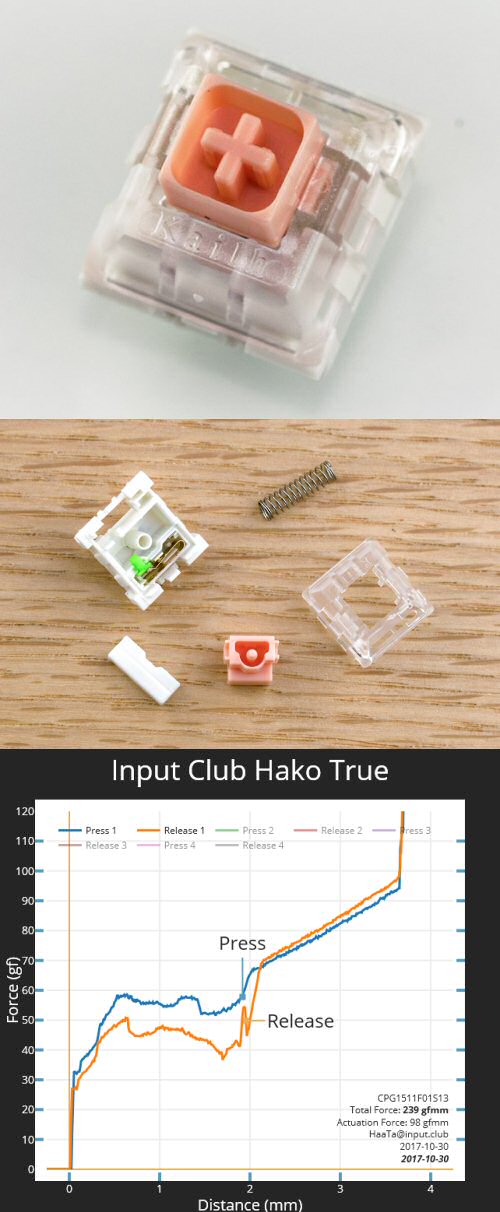

Didn't see a mention of it yet so:
The Hako True switch was designed by Jacob Alexander using Box switch architecture from Kaihua as a replacement for the Halo True switch. It is a medium weight, smooth tactile switch, designed to have a pleasant and intentionally light pre-load force on first touch.
  • Style: Box Tactile
  • Manufacturer: Kaihua
  • Community Name: Hako True
  • Stem Color: Pink Salt
  • Actuation Weight: Medium
  • Tactile Method: Plastic Half Cylinder with Metal Leaf
  • LED Styles: SMD or Through-hole Compatible
  • Tactile Peak Force: ~58 gf
  • Actuation Force: ~60 gf
  • Bottom-Out Force: ~94 gf
  • Spring Force: ~95 gf
  • Overall Travel: ~3.6 mm
  • Tactile Event: ~0.54 mm
  • Actuation: ~1.95 mm
  • Cross-Point: Gold plated cross-point
Source: https://input.club/the-comparative-guid ... hako-true/

The Hako True/Clear are really clones of their own Halo True/Clear but using Kailh's box slider design.
I have been looking over many force/displacement graphs recently trying to find another Cherry MX switch or clone that is similar to the Hako/Halo switches and come to the conclusion that there isn't one. The characteristics of the tactile bump on their switches is truly their unique design.
Yes, it resembles the Cherry MX Clear quite a bit but the peak of the bump on the Hako/Halo is much earlier in the travel and with practically no travel before the bump starts unlike the MX Clear.
