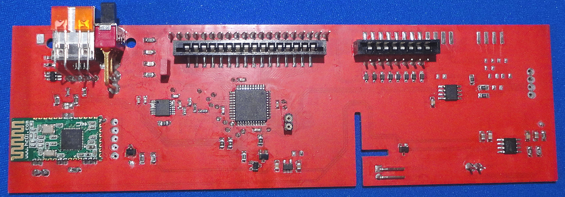

All common variants of the Model M keyboard are now supported (with the exception of the M122 variant manufactured by Unicomp, which is probably very, very rare). That leaves the M2 as the only board I cannot support for now because that would require designing an altogether different controller board, just a daughterboard wouldn't do the trick.

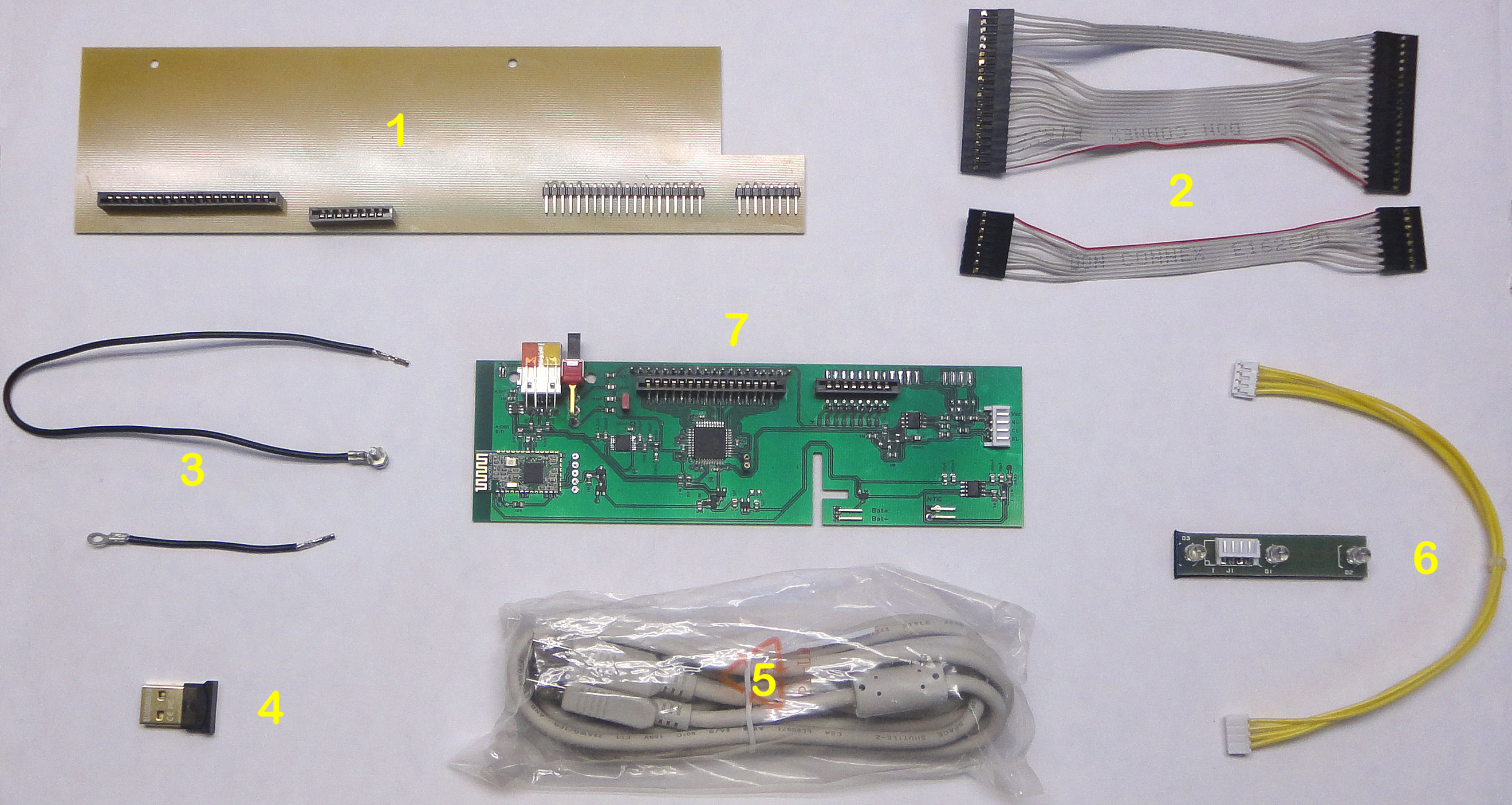

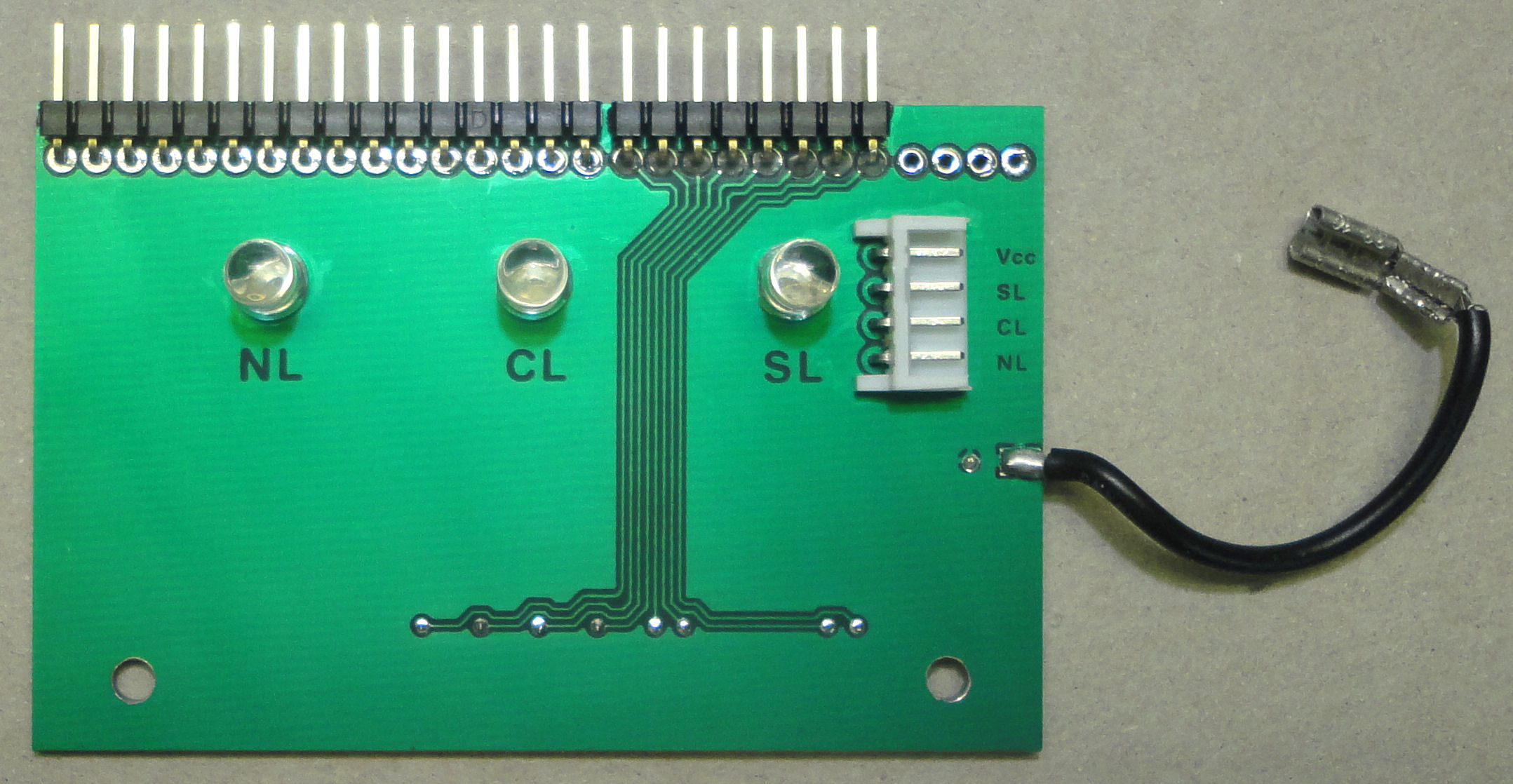

Update - controller board, daughterboard and optional items to be included in a conversion kit:
(1) M122 daughterboard, (2) jumper cables to connect daughterboard and main controller board, (3) shield ground wires long and short, (4) HID proxy dongle, (5) USB-B-›USB-A cable, 1.8m, (6) LED daughterboard (JST EH header) and JST EH connector wire 210 mm, (7) controller board
Update 2 - the daughterboard for 4th generation/Lexmark/Unicomp boards:
Feel free to ask or suggest anything that's on your mind.

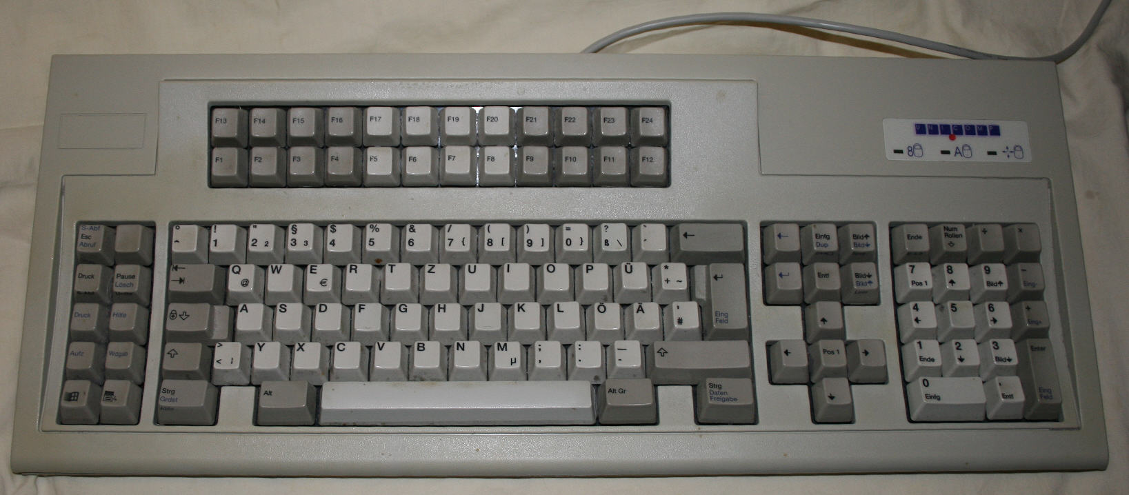

I'd definitely be interested in at least one M-122 board. As you know, mind_prepared, I got 4 of them by now; all hand-modded to USB with Soarer Converter on a Teensy 2 or Pro Micro, 3 of them with added LEDs in the exact same position as the previous Unicomp PC/122 generation had (i.e., using the original Model M "LEDS on bottom of the overlay" position and spacing). Getting the 30+ year old original controllers out would be a good thing. Nothing lasts forever ... and these controllers will presumably die first, long before the keyboard assembly.
To make things a bit more "fun", I also got a Unicomp PC/122 with a PS/2 connector. When asked whether I could have a replacement controller board for USB, they told me that they switched the board layout after I bought it (and yeah, they did - I also got a new black USB PC/122 for comparison. Totally different, and not for the better) and don't have the older style controller board any more. That is a beast that I'd love to drag out of its box (where it sleeps since I switched my KVM from a PS/2- to a USB-based one) and into the USB/BT era ... AFAIR, it got a rather special controller board (sitting on the right side, including the LEDs). I could take some photos of its innards if you're interested.

Ooooo-kay ...

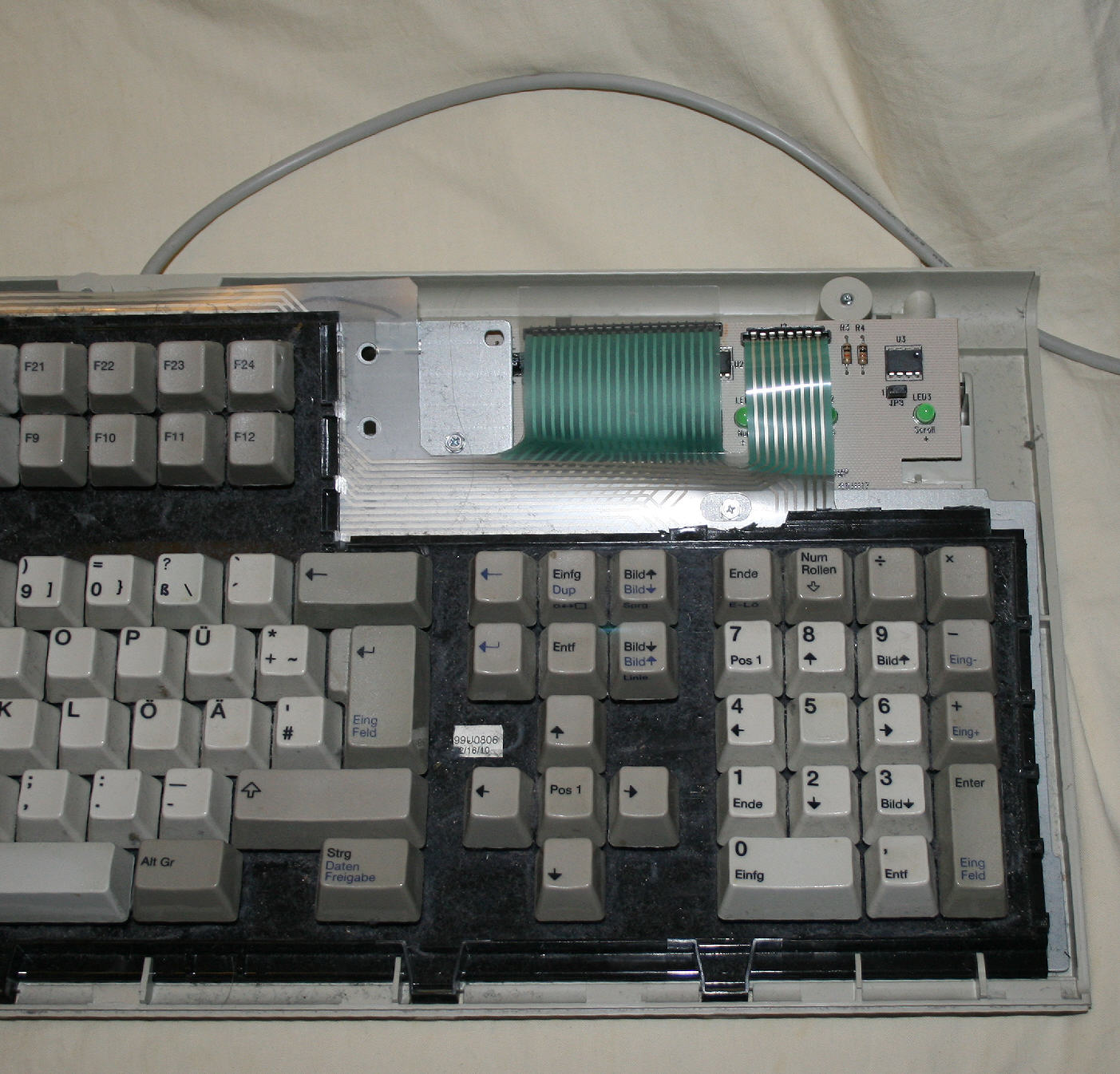

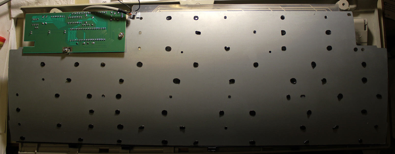

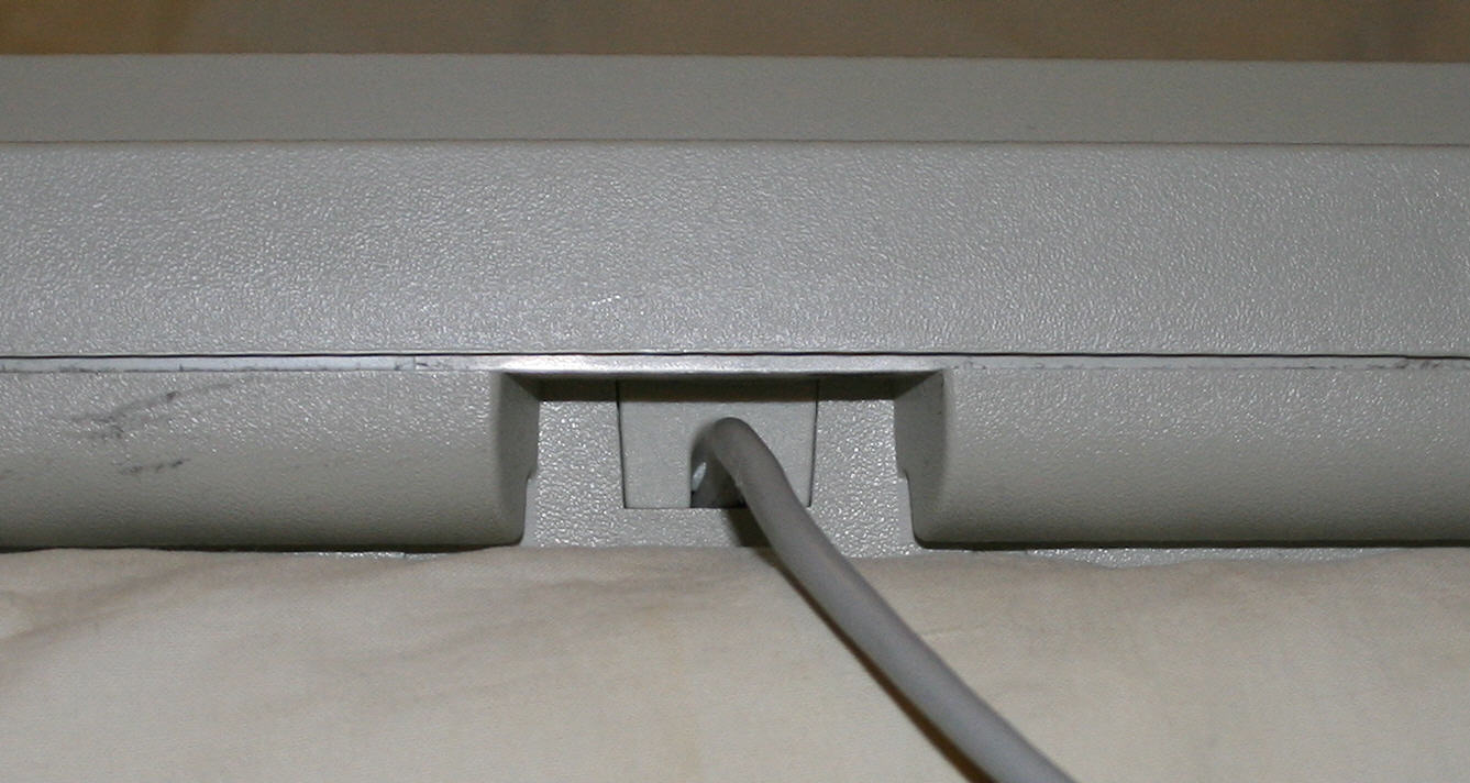

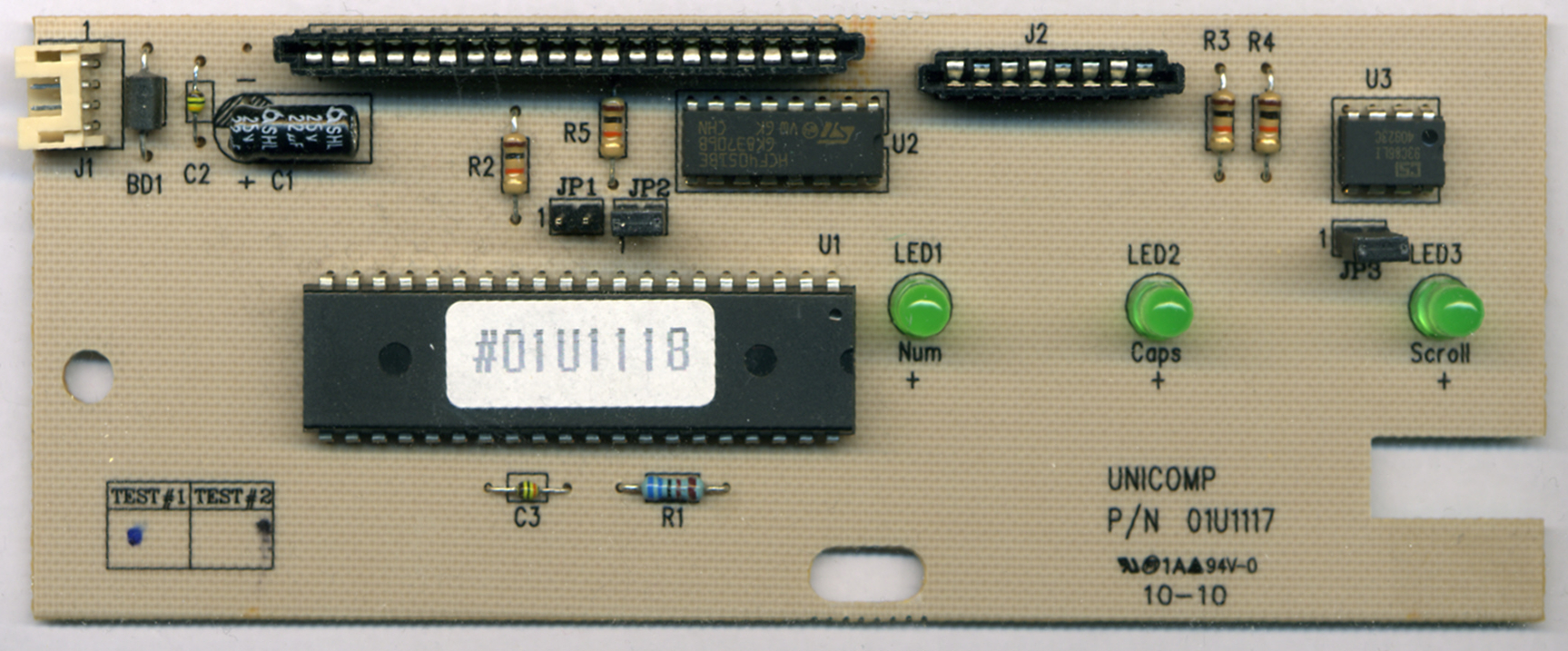

I've taken this little fellow apart:
The cable is "clamped down" (don't know whether that's the correct English word) with a little plastic part, using the same construction as the normal Model Ms do, so a little board with just the USB port, LEDs, switch, and the two 3.2 mm holes instead of the plastic clamp should work quite nicely.

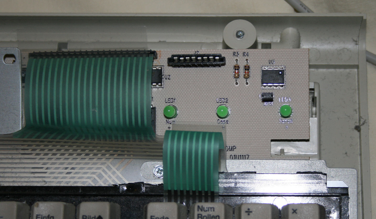

Lifting the lid, we see this:
The controller board isn't located on the backside of the metal plate, it's attached to the upper right corner with two screws. This allows to add the usual 3 LEDs, just with a weird little twist: 2 of the LEDs are partially behind the flat cable:
... which is a bit weird, but works. The LEDS are placed in irregular distances, but the holes in the cover are in the normal IBM layout (1" spacing). Works OK, but I don't see any reason to keep the asymmetric layout if you really create a replacement.

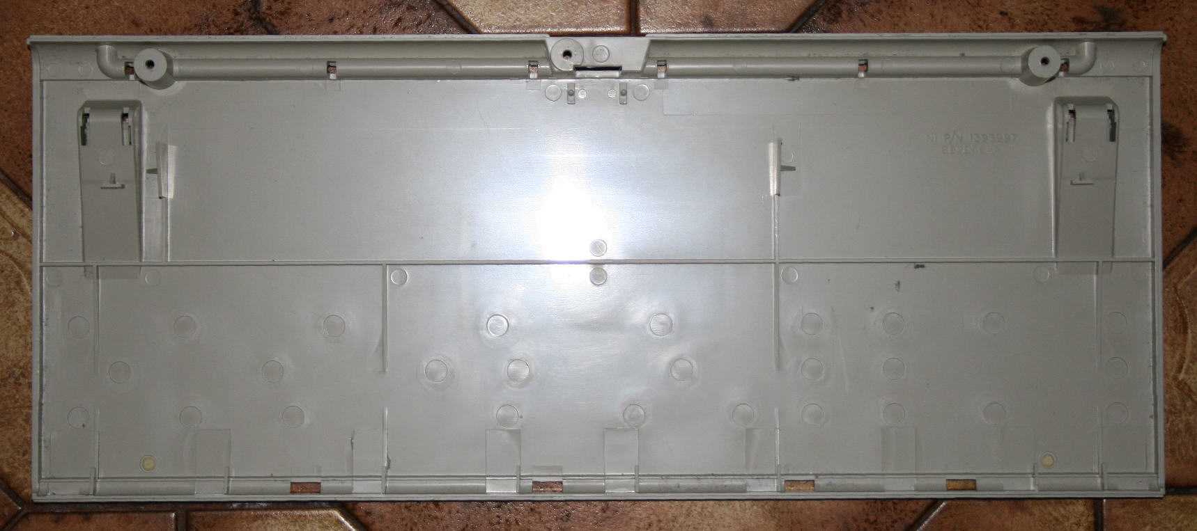

[Update:] Bottom part of the shell looks like this:

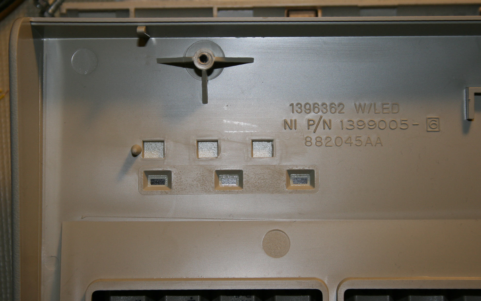

and, for good measure, the inside of the right upper part of the shell looks like this:
... prepared for both kinds of LED positions.

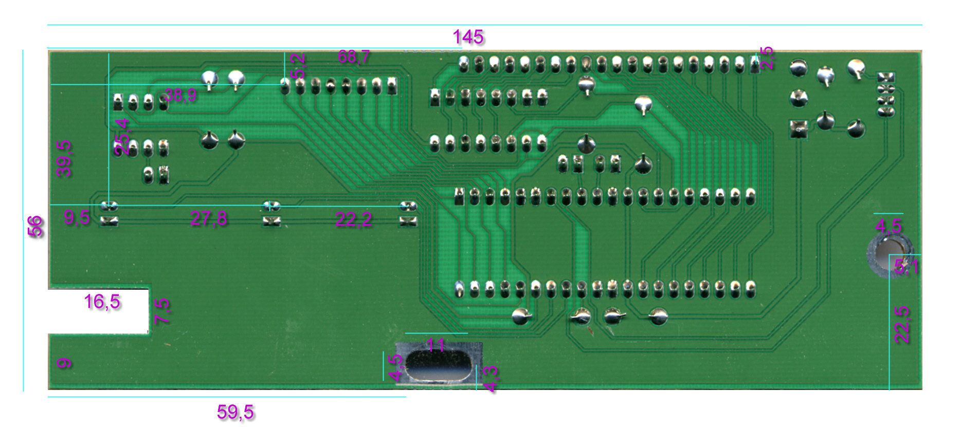

Here's the front side of the controller board, with the PS/2 cable connector on the left side:

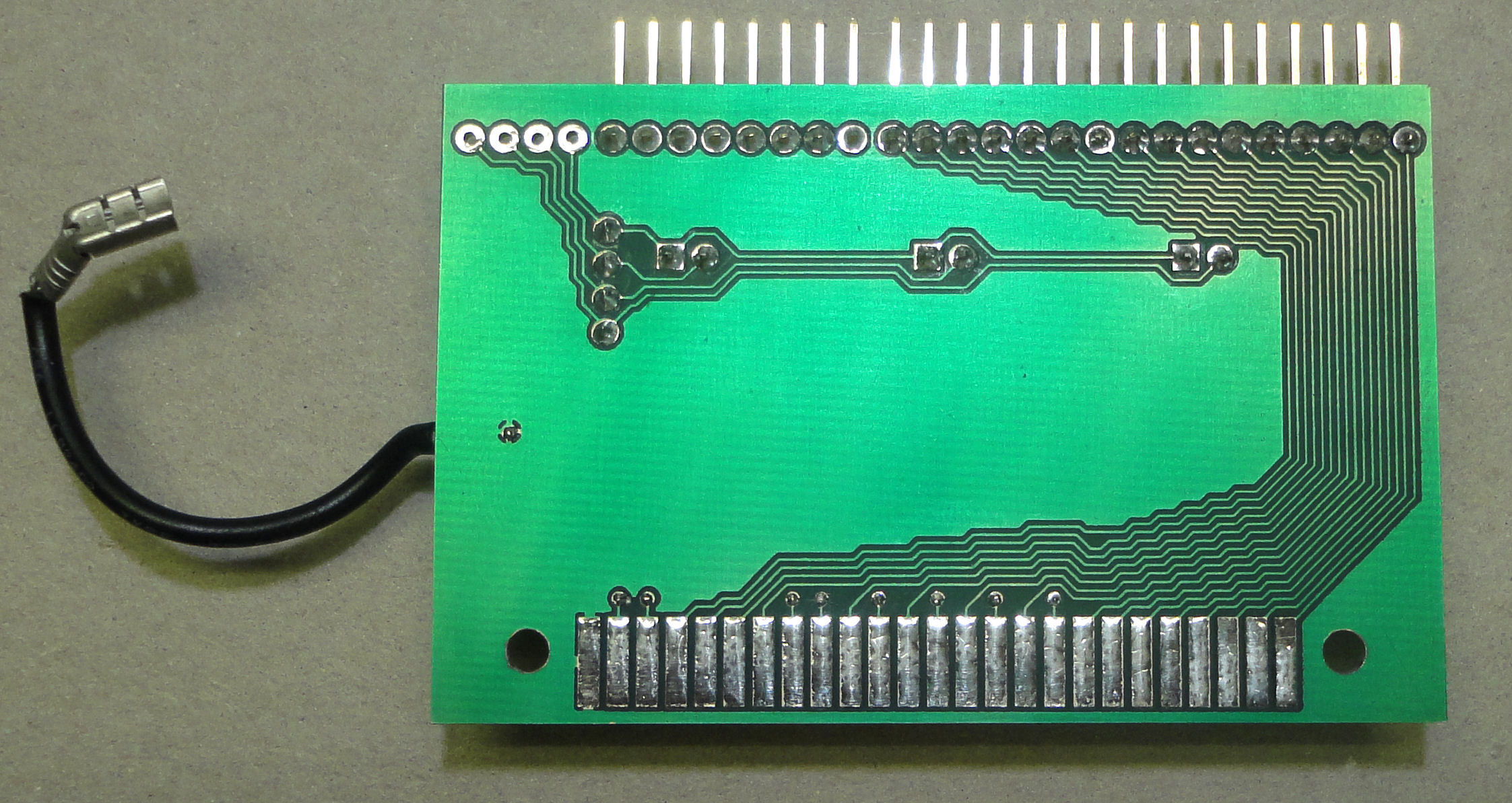

And here's the backside of the controller board, with the relevant measurements im mm (as good as I could take them without desoldering anything):
Presumably, the original design was done in a 1/10" grid, so they might be off a little bit.
HTH

hm, interesting. That's 'yet' another type of Model M which would require a special PCB layout. It would be complete overkill to make a special PCB for every kind of Model M out there, I'd rather keep things simple. Is there a way we could unify the design a bit, at least for the M122?
Could a 170x50 mm PCB be mounted inside the bottom cover? I understand that this particular Unicomp M122 has an outlet for an SDL socket, including the 3.2mm mounting pins for the controller PCB, although its controller is placed in a different spot. It would probably be smart to put the replacement controller PCB near the outlet instead of making a daughterboard, but a daugherboard might be used for the LEDs and FFC sockets to connect the ribbon cables. What do you think?
If you don't mind, please add a picture of the bottom cover without the keyboard assembly, just so that I can see where to put what.

I added pictures of the lower part of the shell and the LED part of the upper part to my post above. At a glance, without taking exact measurements, it looks exactly like the lower part of the shell of "normal" 122-key Model Ms with SDL sockets. So, it should work by "just" adding a matching daughterboard.

alrighty, I've freed up enough MCU pins for a 20x8 matrix by adding a 1-wire PWM LED driver for the status indicators (even though, by default, the M122 doesn't have LEDs nor pre-drilled holes for an LED overlay), so from a technical perspective, the path is cleared. I think I'm gonna start re-designing the PCB layout to make it a universal fit for 1st-3rd generation 101/102 key Model Ms and what seems to be the most common M122 variant. The PCB will need some cutouts/slots to fit inside the bottom cover of the M122 though because the right-hand side rest for the keyboard assembly is in the way (see 5th image from the top).
Anybody got a good idea how to deal with the fact that there are no cutouts/holes for status indicators in the top cover? Anyone wanna volunteer to make suitable LED overlays for the M122?
Anyway, if you're remotely interested in getting a replacement controller, make sure to leave a message (if you haven't already).

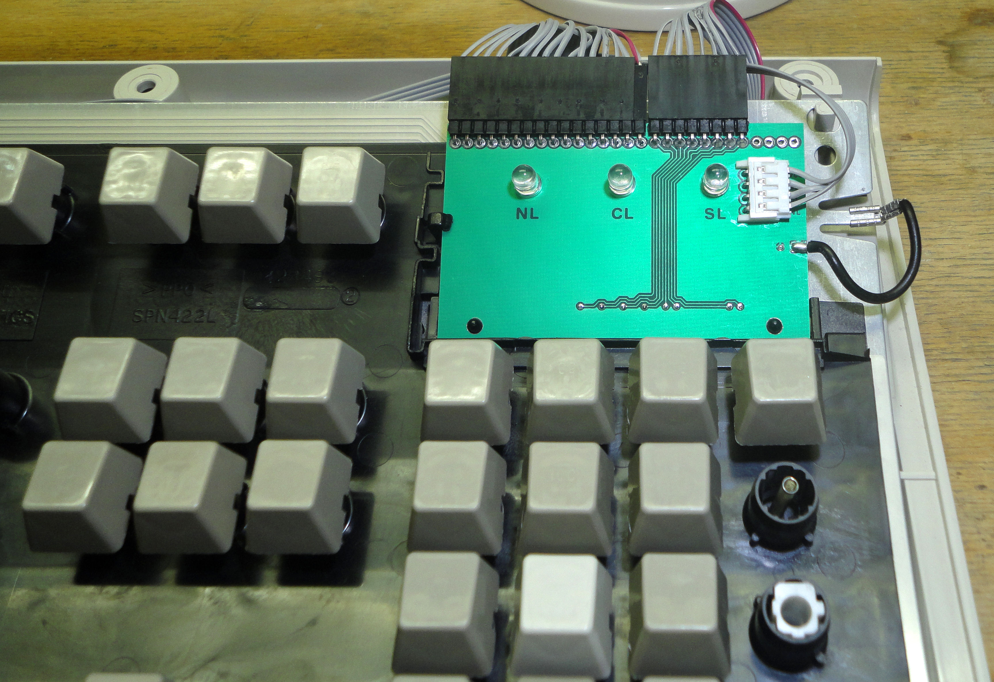

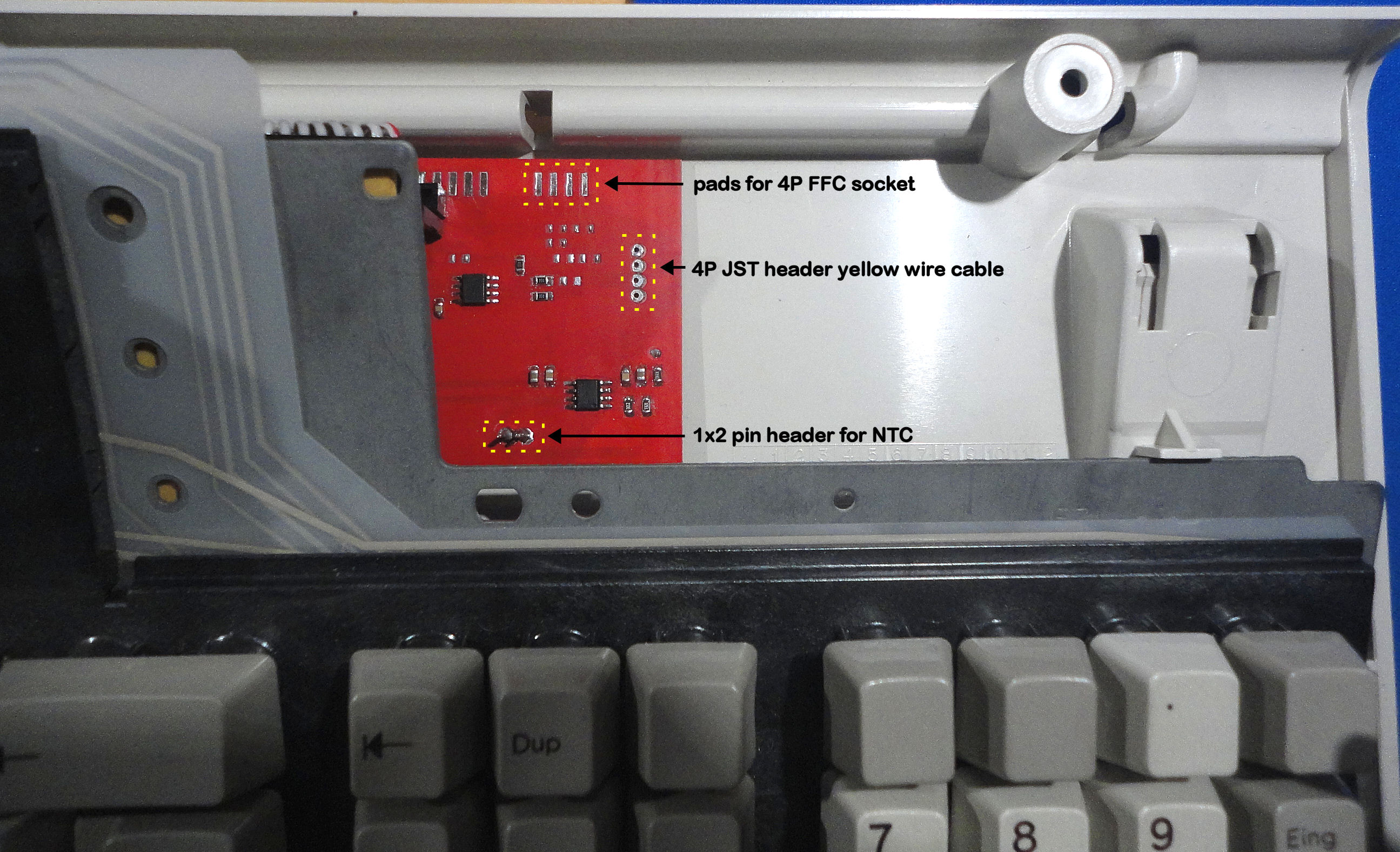

ok, so here's a new prototype. This controller board is truly universal and can be used with any Model M board out there (although some slight modifications and extras might be necessary) (except M2). I've also added new features to the firmware, s.a. support for up to 24 macro keys.
Just in case anyone's wondering: the FFC sockets have 16 and 8 pins, respectively, and can only be used to connect a 16x8 matrix. To connect an M122's 20x8 matrix a daughterboard is necessary. So the final M122 conversion kit will include a daughterboard featuring a 20 pin and an 8 pin FFC socket plus pin header to connect the main controller board and the daughterboard with multi-wire jumper cables.
Similarly, a daughterboard could be made to connect the matrix on 4th generation boards. And instead of a B-type USB socket, some kind of wall-mount micro- or mini-USB socket could be used. That only leaves the question of how to break out the LEDs and the mode selection switch. Either openings could be drilled/milled or pre-existing openings in the bottom or somewhere else may be used.
If you haven't already, vote and let me know if you would be interested in a replacement controller.

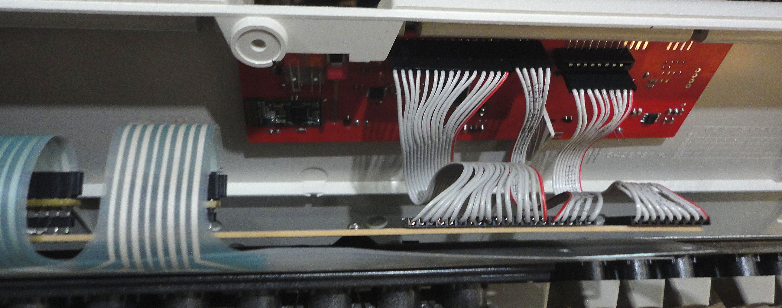

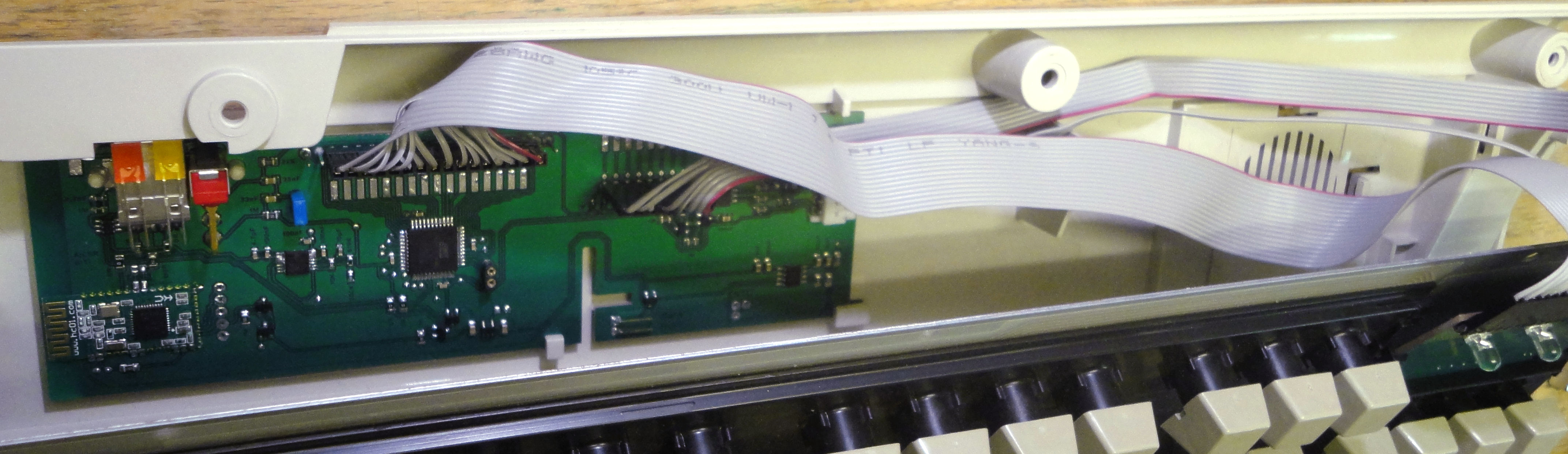

The controller board will fit inside any Model M keyboard. To connect a M122, 4th generation Model M or Unicomp Model M, a daughterboard is necessary, just in case anybody's wondering.
Anyway, here's a few pictures of a converted M122. I hope they also convey the relative ease with which a conversion can be carried out. Although a daugherboard is necessary to connect the matrix, I've designed it such as to create a straight and short path between the pin headers on the daughterboard and the main controller board in order to avoid the hassle of having to route long jumper cables beneath the keyboard assembly.
Since the controller board includes pin headers to connect the matrix now, it could also be used for other keyboards as well (as long as there's enough space for it).
