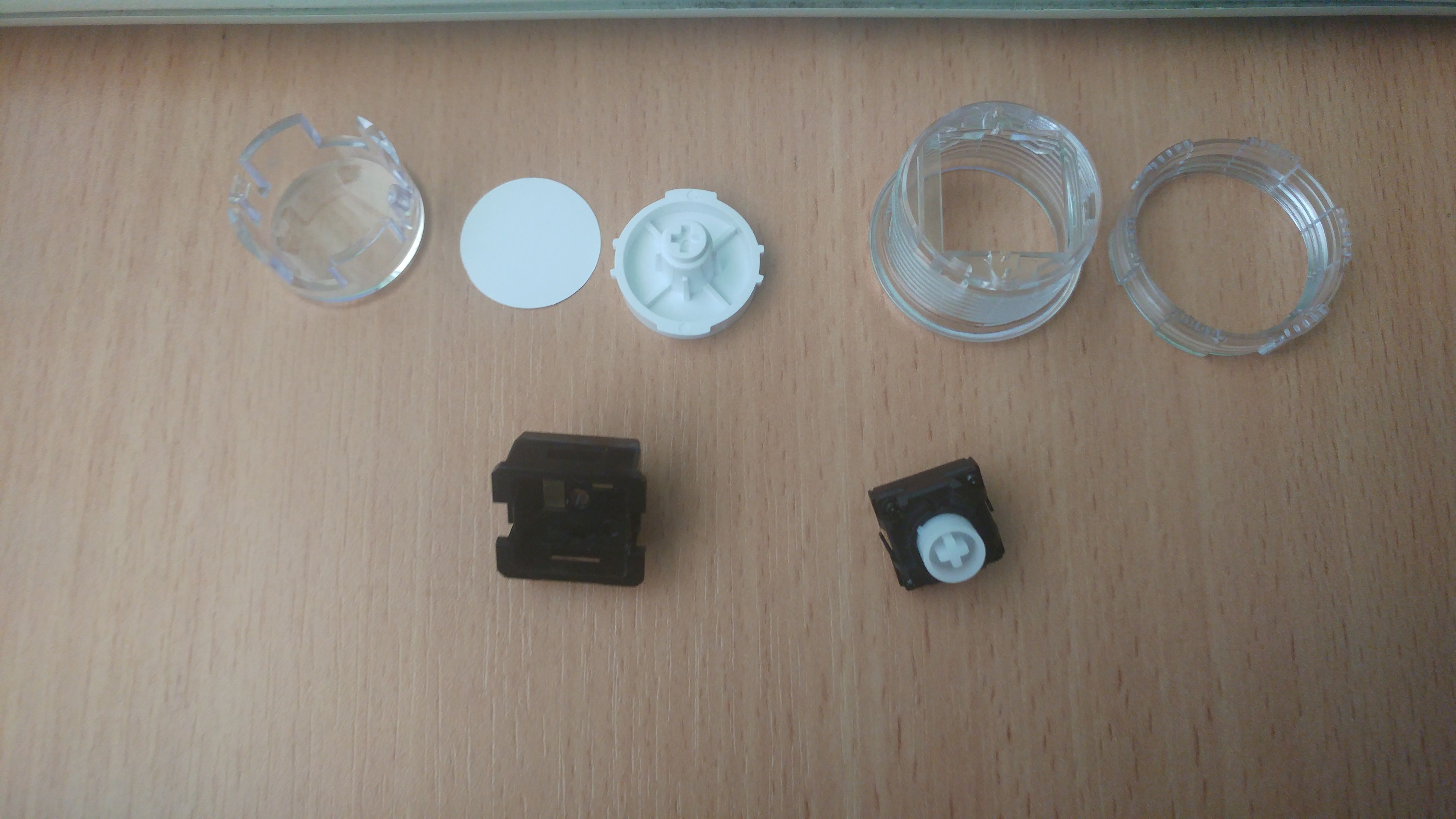

Recently I bought some Samducksa Crown SDB-201 Screw In Arcade Buttons that uses some kind of Futaba switches.
I thought that it uses a dedicated switch like Sanwa and Seimitsu, or uses Futaba mechanism inside dedicated mold (some Chinese arcade button knockoffs uses ALPS-clone switches with different mold).

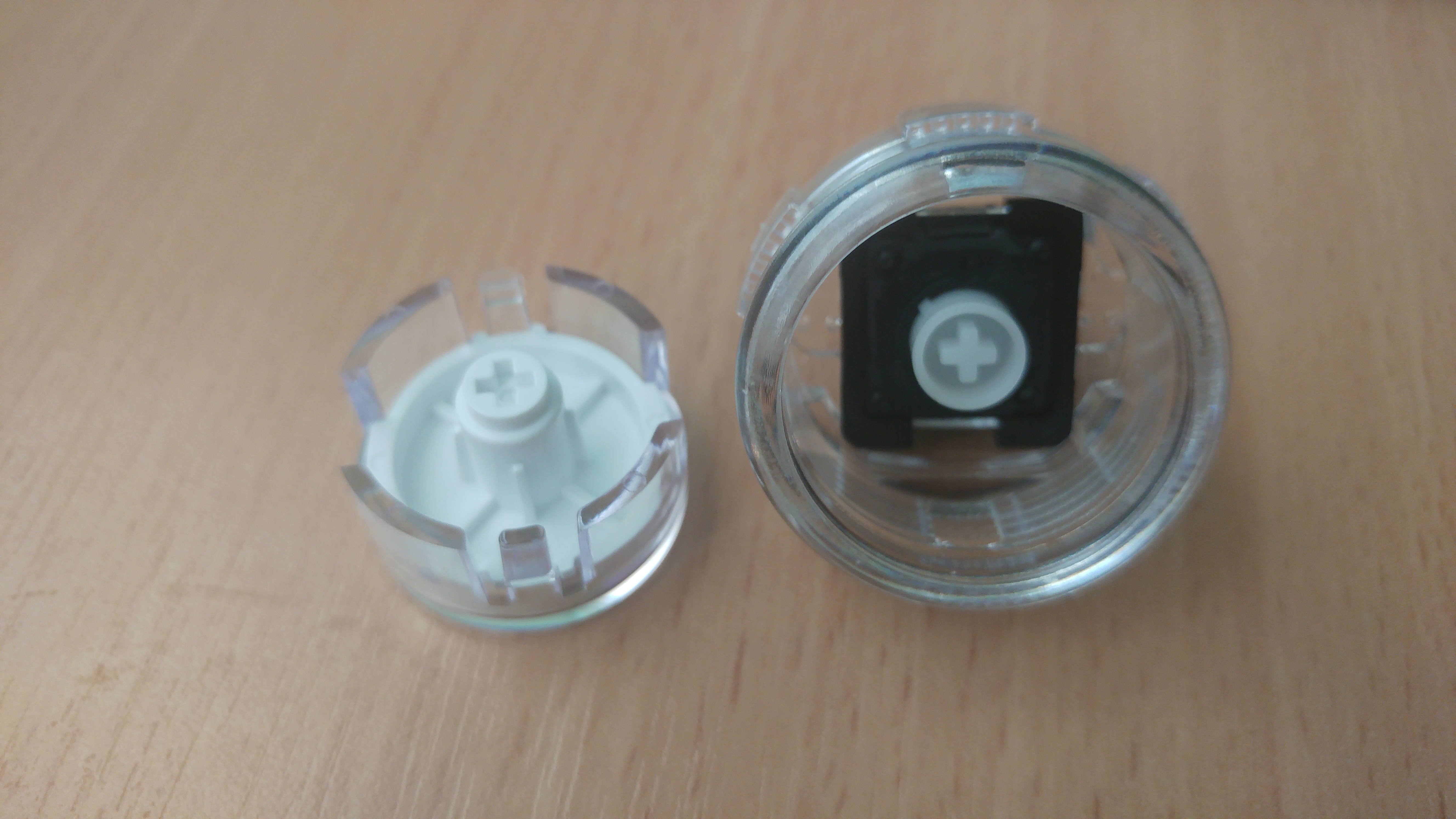

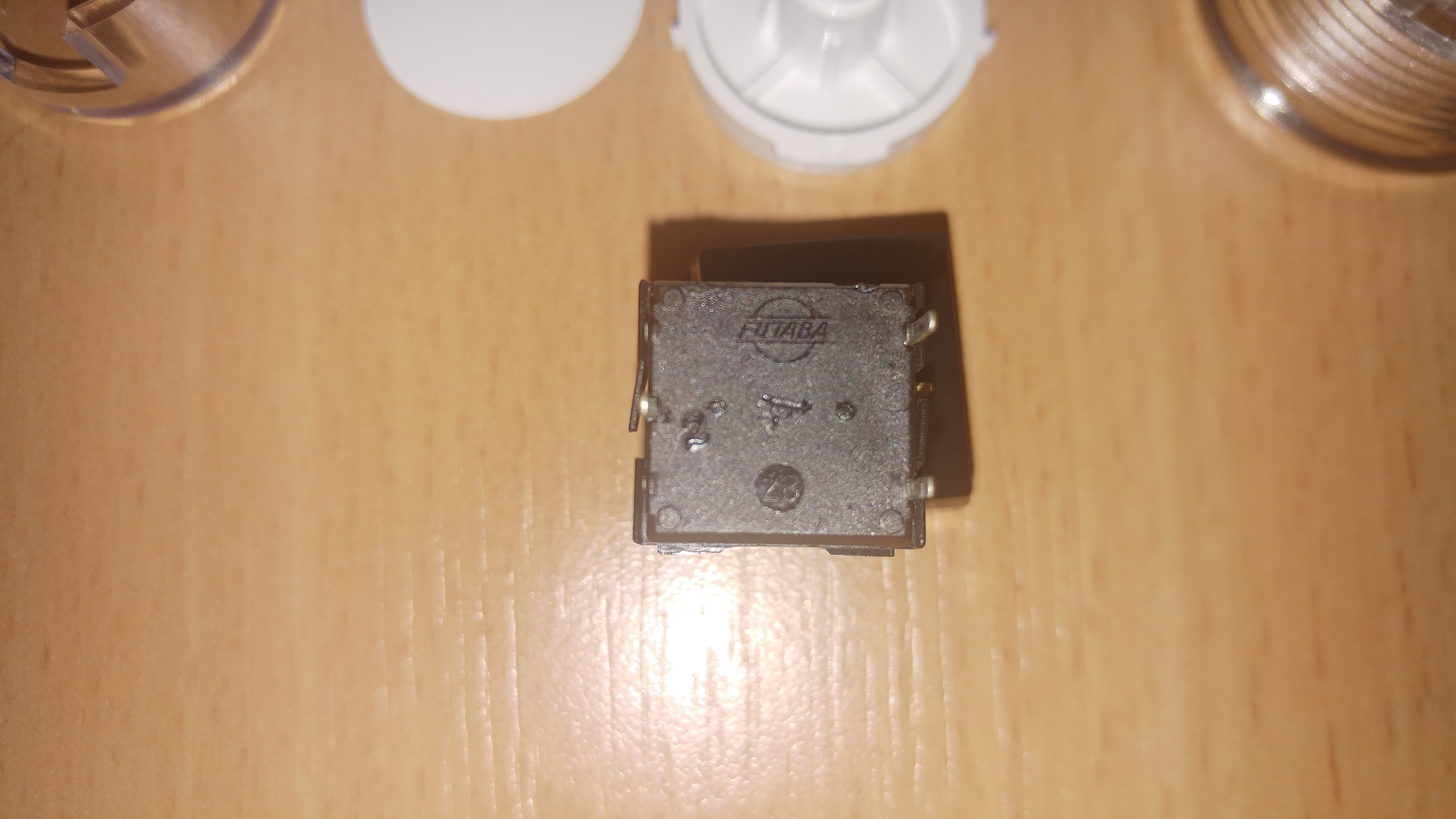

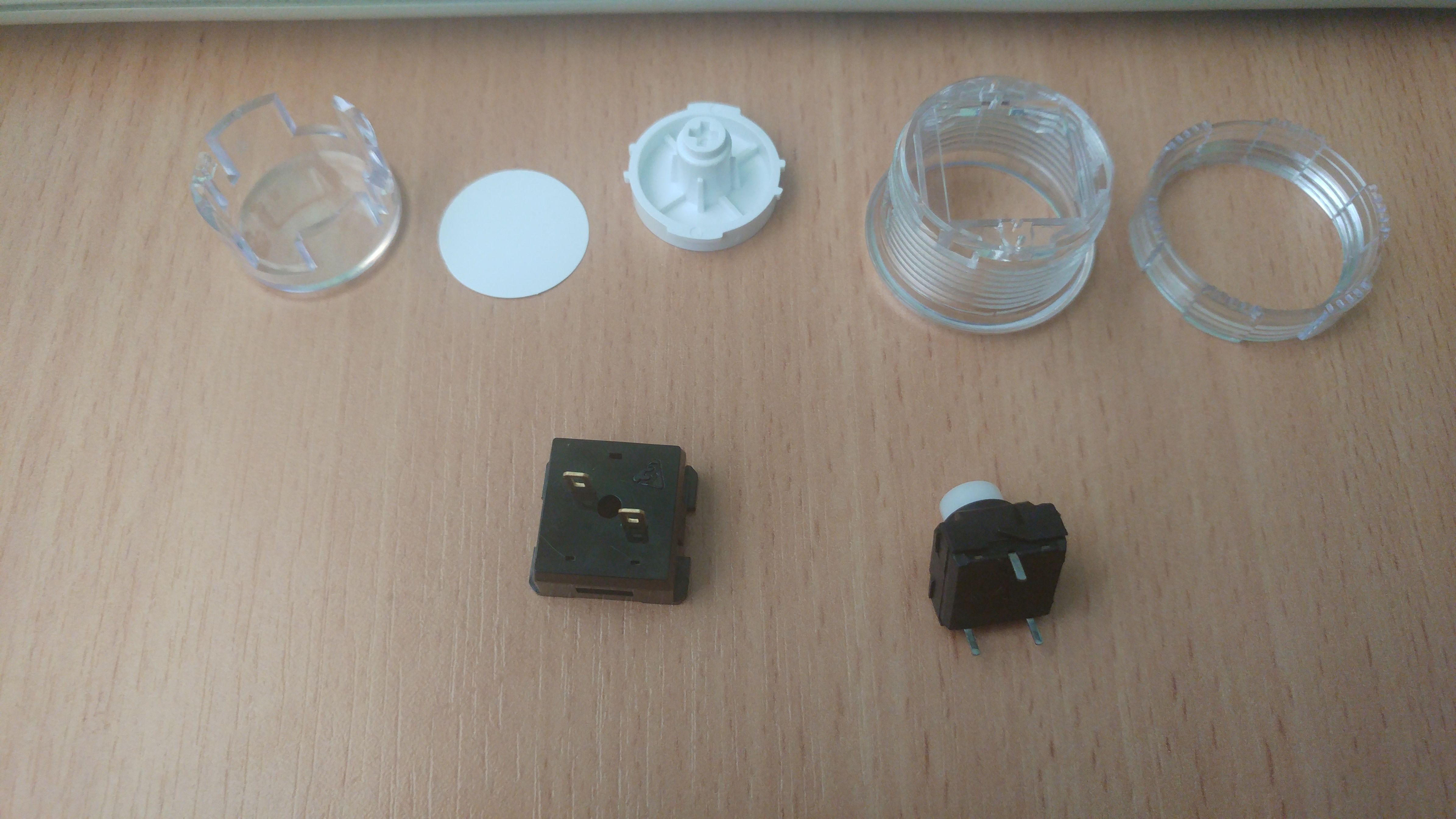

When I opened the button I was surprised to find out that it uses Futaba MA with MX mount variant steam, since I recently bought OBS-MX arcade button mod (with uses original cherry mx keyboard switches)
Button can be easily disassembled and Futaba MA (MX plate mount variant) can be extracted from the arcade button.
It is easy way (but costly one) to get the new replacement for Futaba MA keyboard.

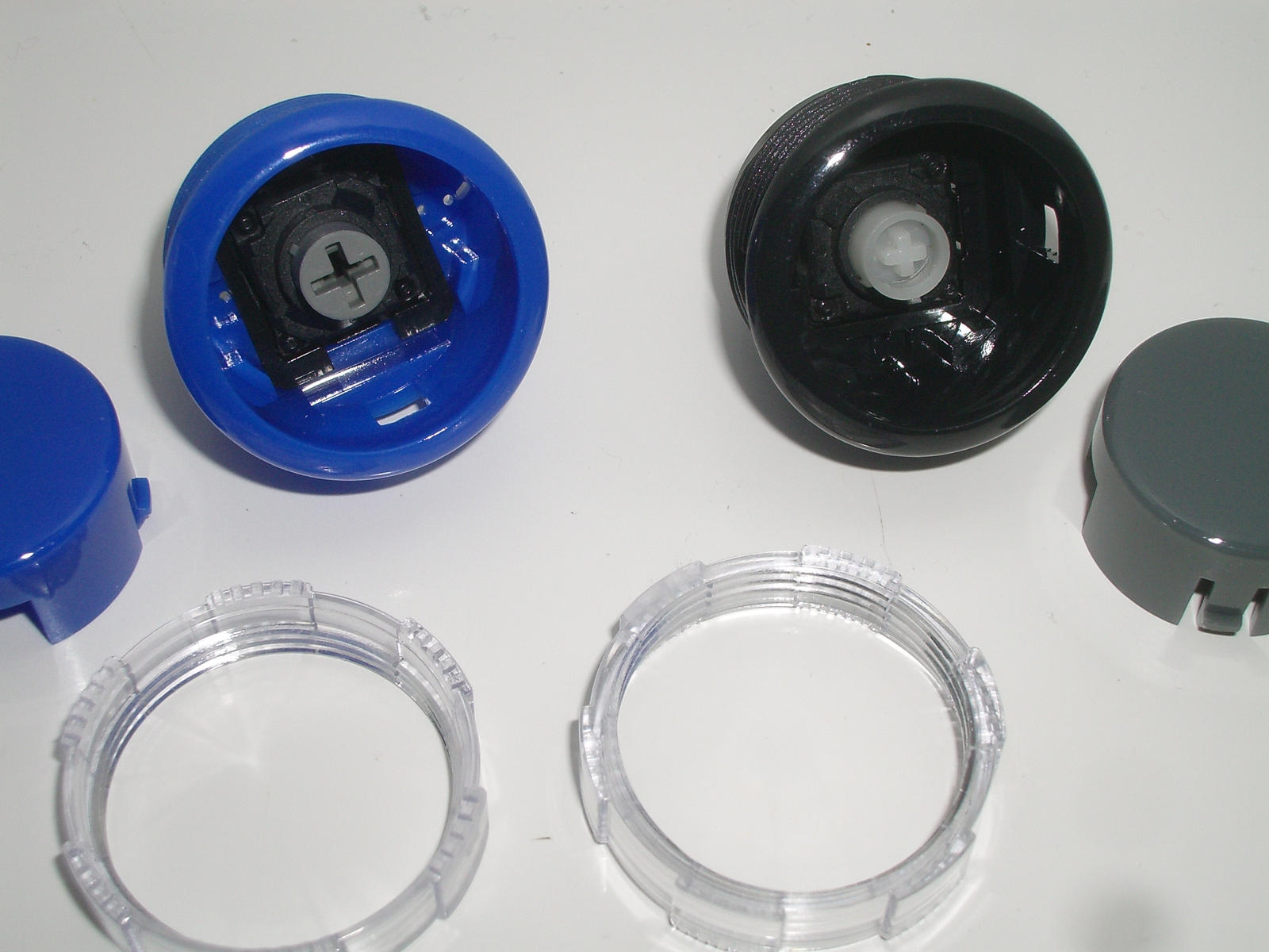

OK, so I think they've bought up all the old switches — I got something very interesting!
One switch came with Futaba mount grey, and the other came with MX mount white. Neither switch is clicky, and they feel around the same weight. (I've yet to figure out how to get the silly things apart — moar force I suppose.)
The switches are not linear either. There's very little tactility on the downstroke (and a very faint click from the grey switch) but upon release, the white gives a sharp kick just above full travel.
From what I can tell (looking at the internals of the alternate action version), the linear versions also have an inverting leaf, but the click version seems to have an extra spring for more sound. Assembled, you'd never guess that these are tactile at all.
So these seem to be MA42 linear versions. No reply yet from Samducksa but I will persevere!

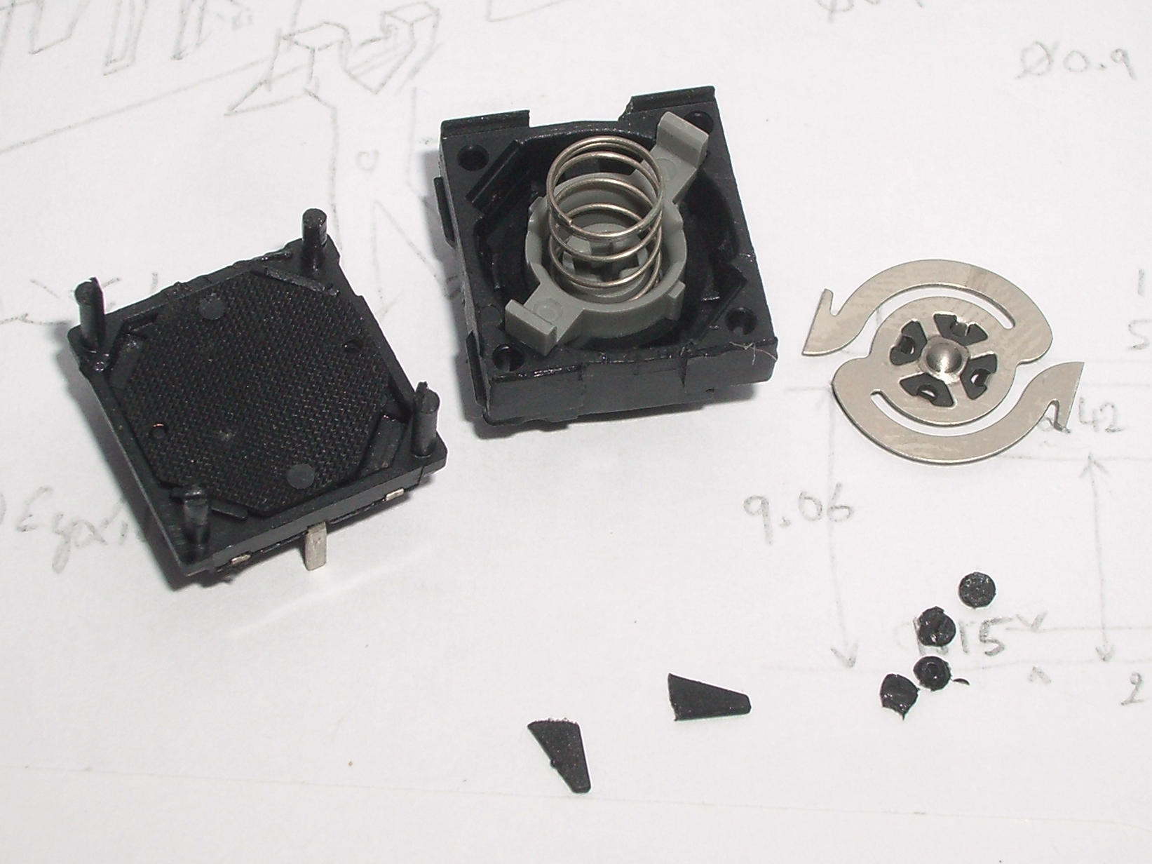

Do NOT press in the wings of the MA switch — both mine on my grey switch are now snapped completely off. I'll have to buy another blue button now and hope I get another grey one :(
- Daniel Beardsmore
- Main mouse: MS IMO 1.1
OK, so, to remove the Futaba switch, turn the button body upside down, place the adapter module upside down over the square hole, and insert a narrow implement into the bottom of the adapter module and push down hard. The Futaba switch will come out cleanly. Or may do.
