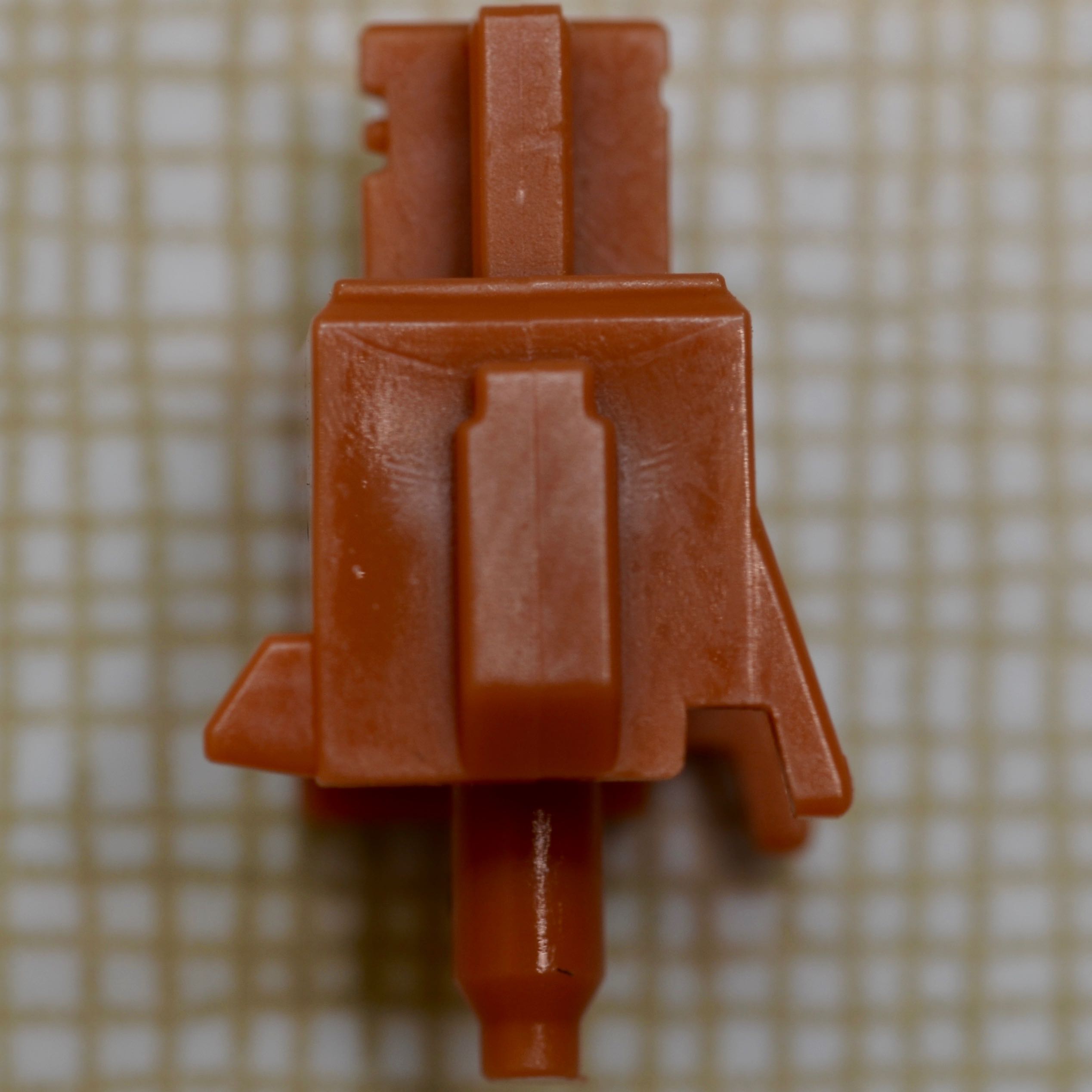

I don't mind collecting switches — I'm at over 300 types now and counting.
However, I photograph very few of them, and I process and upload very few of the ones I do take. I'm now at over 4000 largely unsorted photos and far too many undocumented switches.
Now, I just got some MX Speed Silver switches in. The photo below is adequate within the scope of my work, but the angle isn't quite right compared to my previous MX photos (which is why I prefer to collect a whole series before taking the photos).

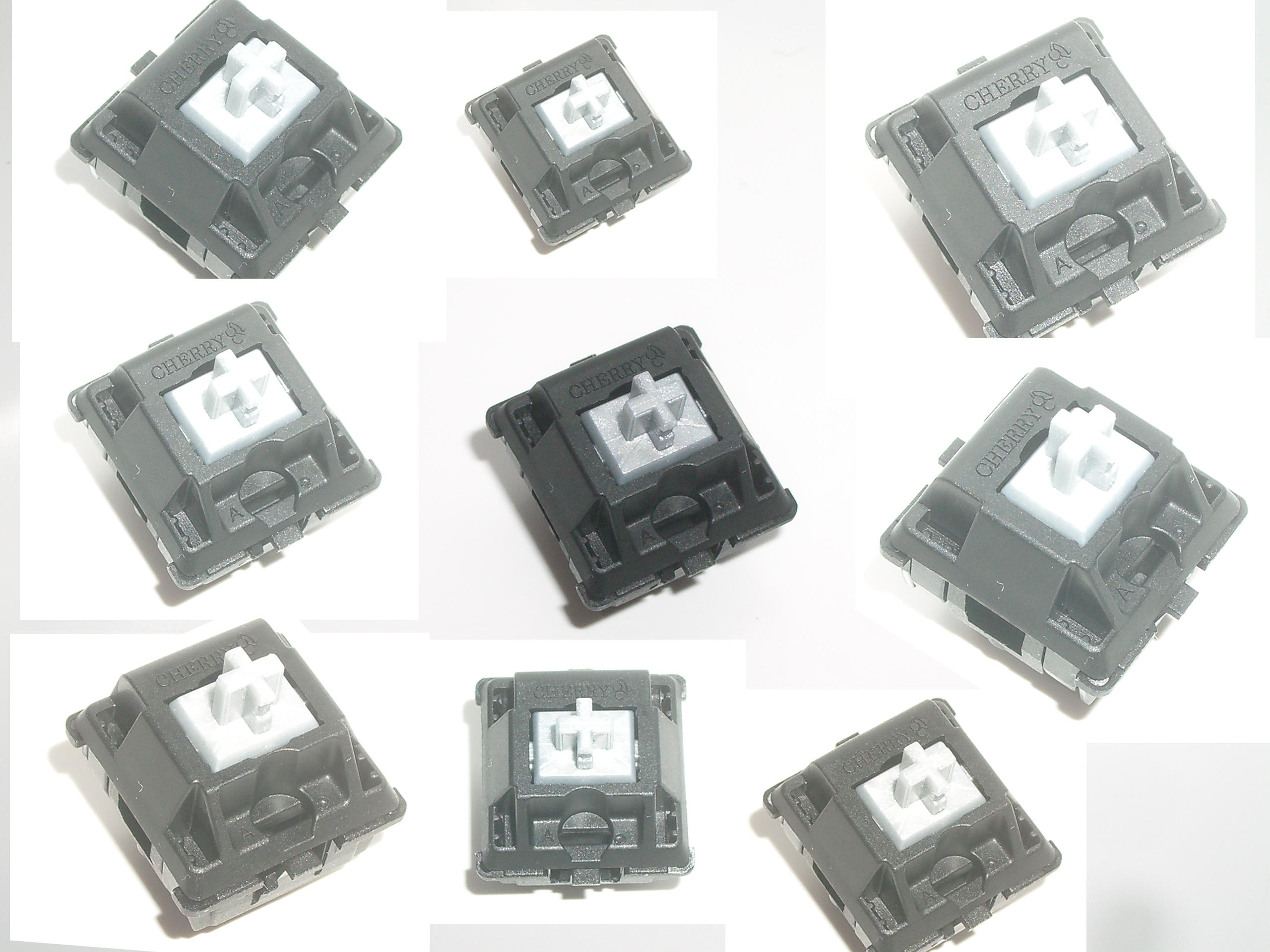

So I turned my camera back on, and set it up the same way as as always: super macro, EV compensation to minimum.
This sucks.jpg (378.48 KiB) Viewed 6446 times
The inset photos are a variety of attempts to recreate the first photo, from any angle. That's both without my little lamp (just used to make autofocus work, but I had it turned off for the good photo) and with it on (facing both towards and away from the subject), using various angles and distances to the subject (all inset images are to the same scale) and with my ghetto reflector arranged in various ways.
This comes close to proving that my camera is not just sentient but capricious. I've known for a long time that the camera virtually randomises the settings, but this is the most extreme it's ever got. It's impossible to recreate the first photo and I have no idea why.

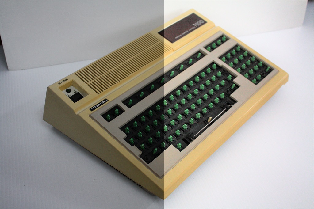

Your white balance is way off and there's way too much light. I just edited the pic in the left side middle and simply lowered the light but the silver was still too washed out so that colour is lost in editing.
This sucks2.jpg (63.37 KiB) Viewed 6437 times

As an example of white balance (and auto ISO), it goes the other way too. If I don't have that on, my pictures come out too dark depending on available light. I never use a flash. In almost all pictures I post, I always have to adjust the brightness. Here's an extreme. Both side are the same picture. Left is as taken and the right is adjusted post production. With this pic, the right side is still a little too dark so I have to retake those pics.

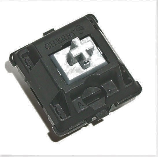

From EXIF data for wiki/File:Cherry_MX_Black.jpg it looks like he's got a PENTAX Optio S5z. Looking at the manual it provides manual focus, manual white balance, and manual sensitivity (ISO), and spot metering, but NOT direct manual shutter speed. You could set this indirectly by doing something like:
- selecting spot metering;
- selecting Program mode;
- using a gray card to determine what the correct shutter speed would be (since aperture hopefully stays fixed);
- setting up your subject and increasing or decreasing EV to get the desired shutter speed.
Since it only offers +-2 EV adjustment you might have to "trick" the camera by selecting a different metering mode (center weighted instead of spot) to get a different range of options.
If you had a Canon point and shoot I could point you at the excellent CHDK which permits full manual control: http://chdk.wikia.com/wiki/CHDK.

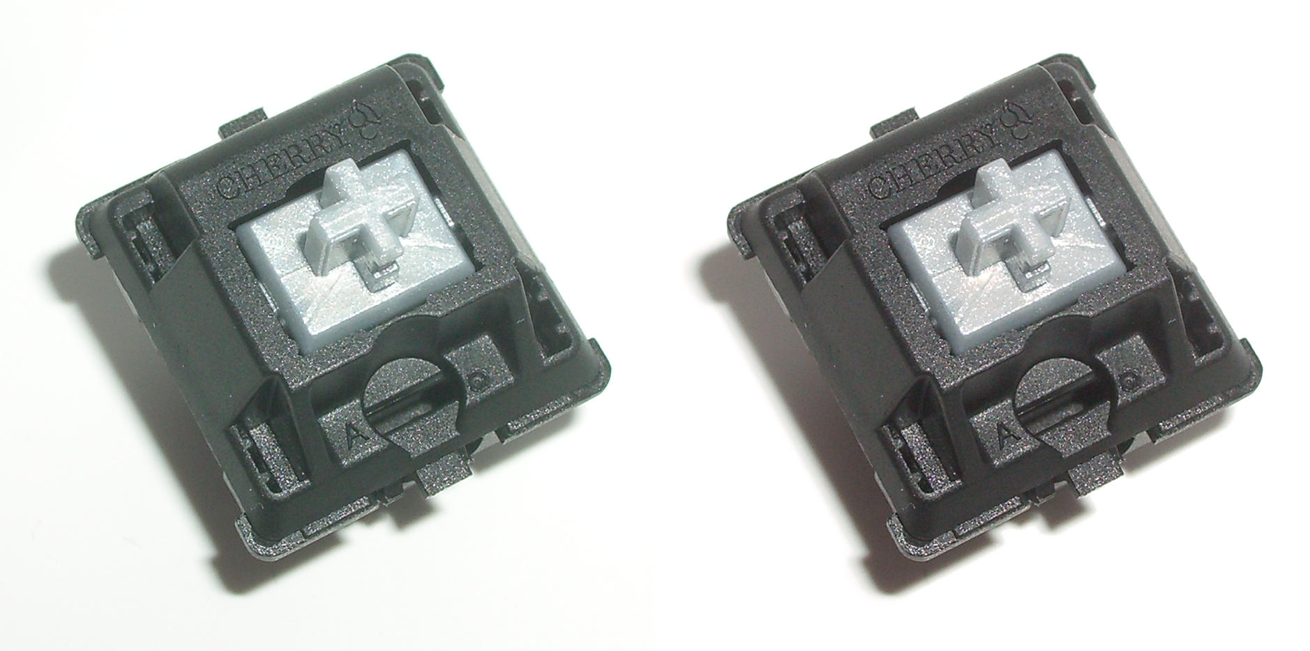

This is the third attempt at the switch, original and adjusted:
IMGP5335 copy.jpg (163.94 KiB) Viewed 6266 times
The colour balance is still weird but I can't fathom what's wrong with it. The background has to be replaced with white as it's never evenly lit, and I've converted it to white without damaging the shadows. Compare this though to a Cherry RGB switch:

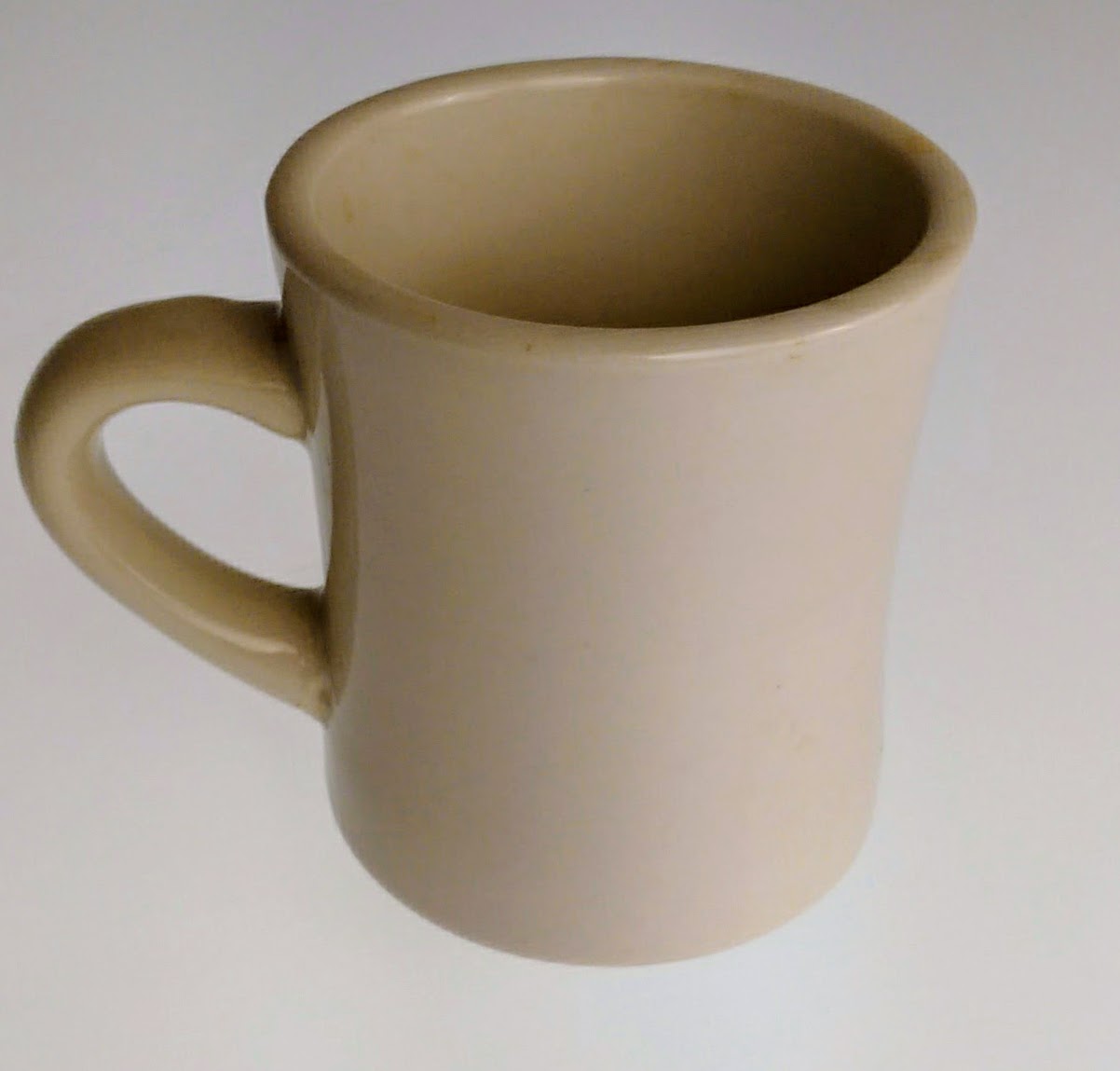

As a really poor example, this is a photo I took with my phone, with the first subject I could find, to show a friend what you can get with almost no customization of the setup.
Coffee cup product photography.
So, my idea of a HOWTO would be creating and building a pretty cheap, easy to replicate, product photography station, for anyone who wants to get photos of switches or key caps, or other small objects.
