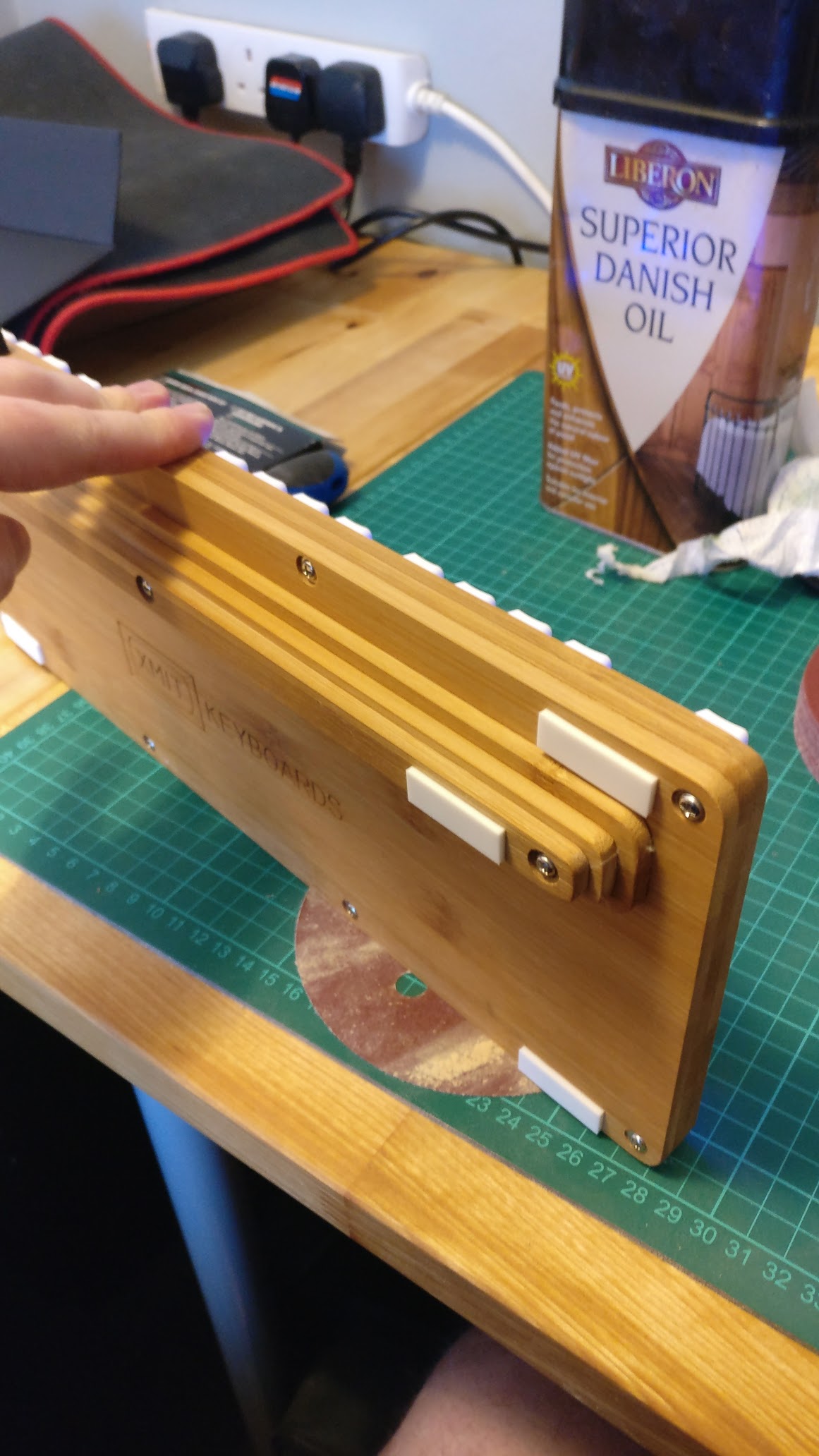

Tip on that bamboo xmit.
The sides of mine where quite rough. Take some 240grit sandpaper , put it on a flat surface and run the keyboard on the edge back and forwards on it slowly until its nice and smooth, and then take some oil ( i used superior danish oil as i had some left from my new desk) and use that on the sides to bring the finish back nice.
I plan to strip it down at some point and sand the whole thing and treat it to multiple layers of oil with wet oil sanding in between.
But for now that fixed one big issue i had with mine.

When i say the edge i mean like this
17 Mar 2017, 18:49
The LED holes on that XMIT keyboard are a bit rough, but the wood looks good. I'm thinking, maybe it should have a brass or aluminium lining (depending on your colour preference) in each hole, with a little lip that sits on the top of the case, similar in appearance to a PCB via.
17 Mar 2017, 18:51
The top surface of the wood is fine , but the sides ( endgrain ) is a tad rough , less than 5 mins work to fix with my method.
