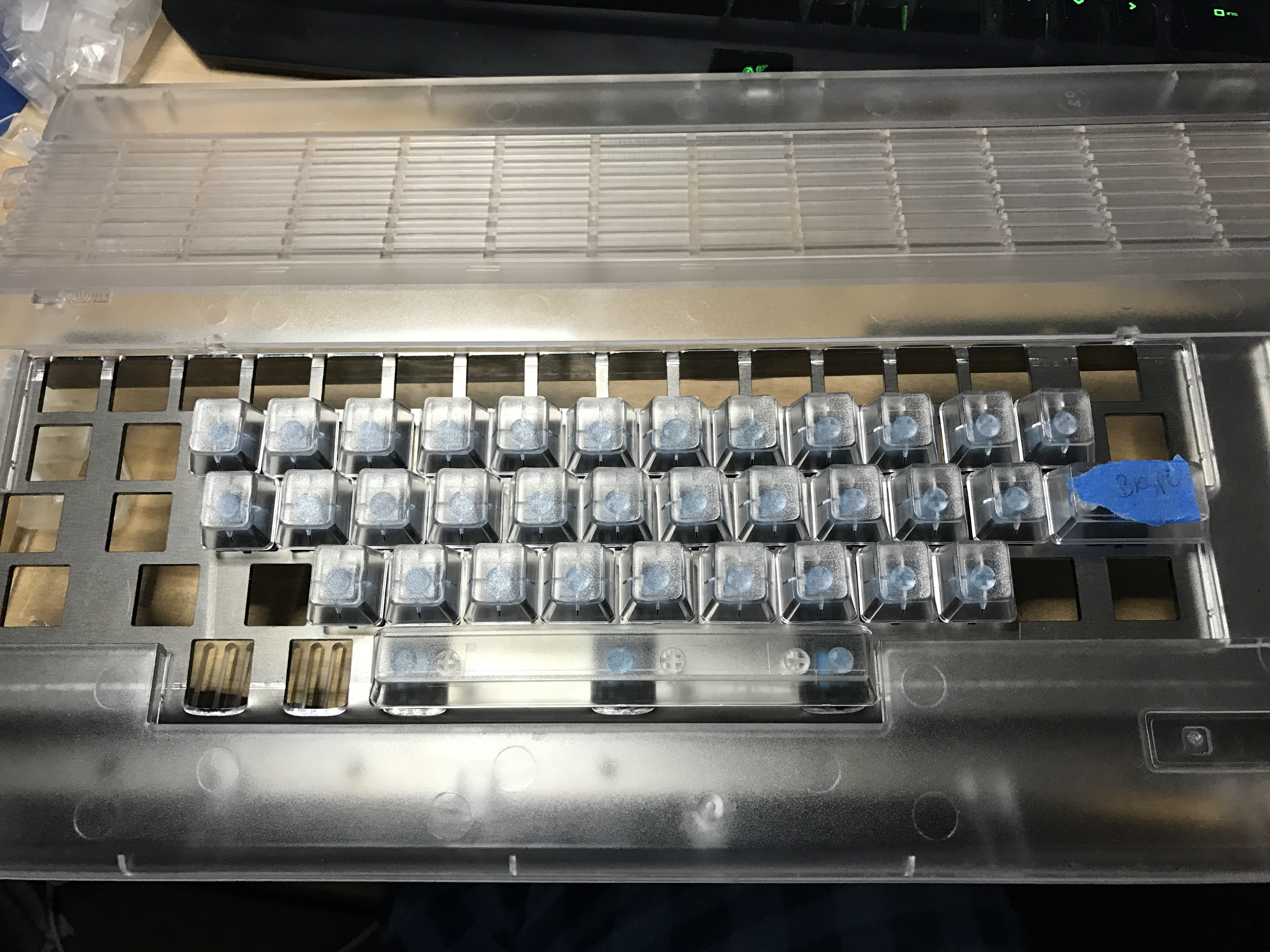

Looking really good. I like how you use the lear case to demo it, very nice touch. What keyset do you have in mind? C64 originals with the adapters, SA Retro or something else? I want to use the original keys with the adapters myself for my first one but maybe something different for another on later down the line.riddleywalker wrote: Hi iceberg,

Here's a picture of the mount with more keys and case.
Thank you. Thinking about using that same set of translucent DCS key caps. Perhaps i'll switch them out for something else, but for the time being they go nicely with my clear case so I'll probably just stick to them.
I'm just about done revising my 2d drawing to compensate for the spacing issues and I've finished adding the keyhole notches I described.
In talks with my friend about the technical details behind bending aluminum. Should have another mount ready in a couple weeks.
I'll keep you all updated.

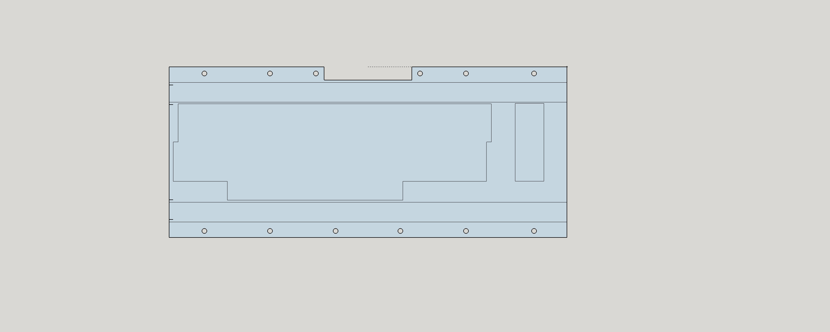

- Location: Nowhere
Hi iceberg,
Oh it absolutely is possible. As a matter of fact, the original key layout is what I used as a reference for how much space I would have to lay out the new keys. It all came down to everything fitting properly inside of the case cut outs if that makes sense. In other words, if you take the dimensions of the original C64 keyboard key layout, my keys fit the same area
The attached image shows the workable area that one has to layout whatever key hole configurations you want. This is accurate to about 100th of a millimeter.
- c64_keyboard_2d_custom_keyholes_final_AREA_ONLY.jpg (127.15 KiB) Viewed 9479 times
