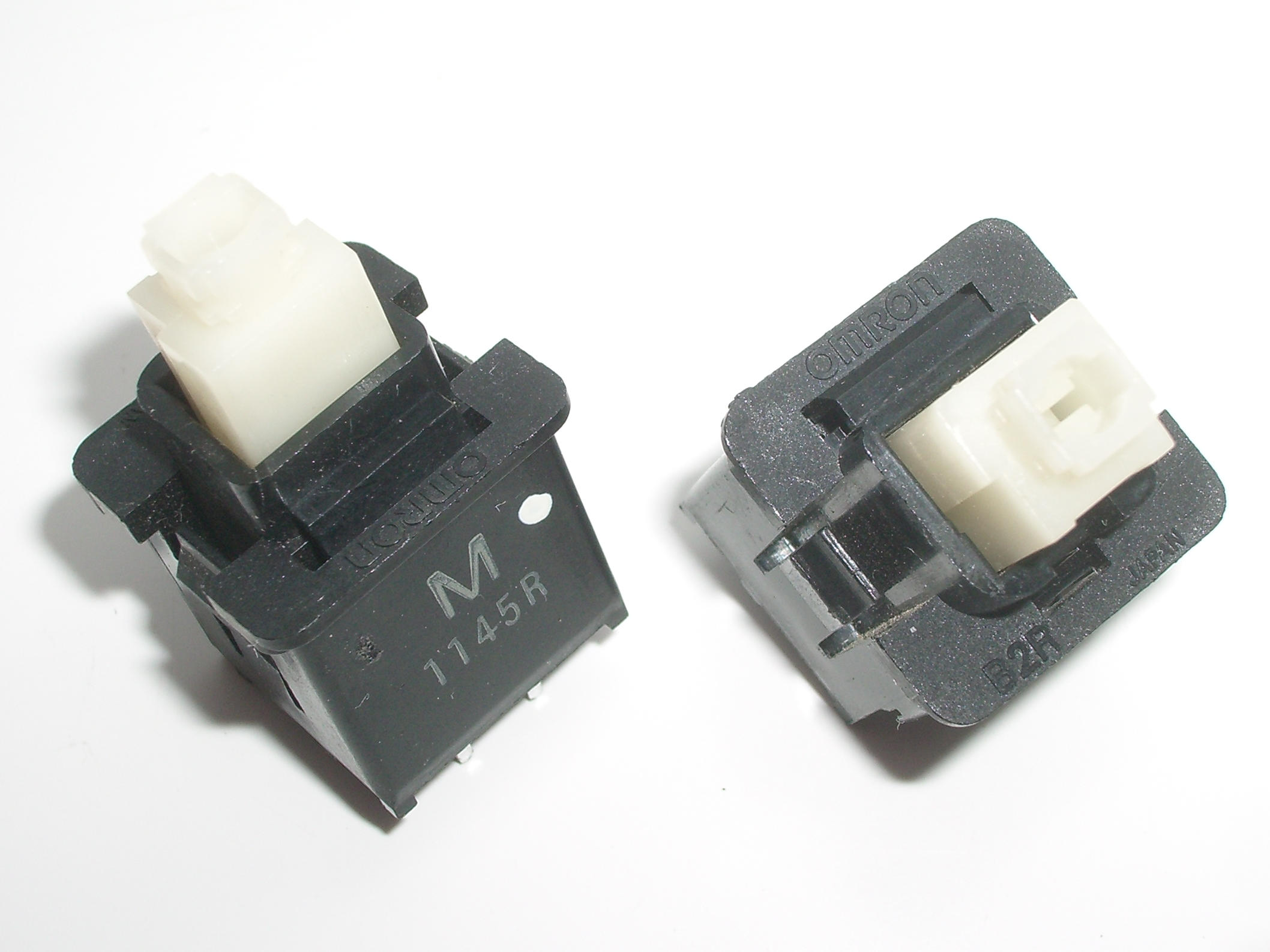

Every now and then you get a switch that just won't come apart. Omron B2R-G1 seems to come apart fairly well:
http://erwin1.blog64.fc2.com/blog-category-2.html

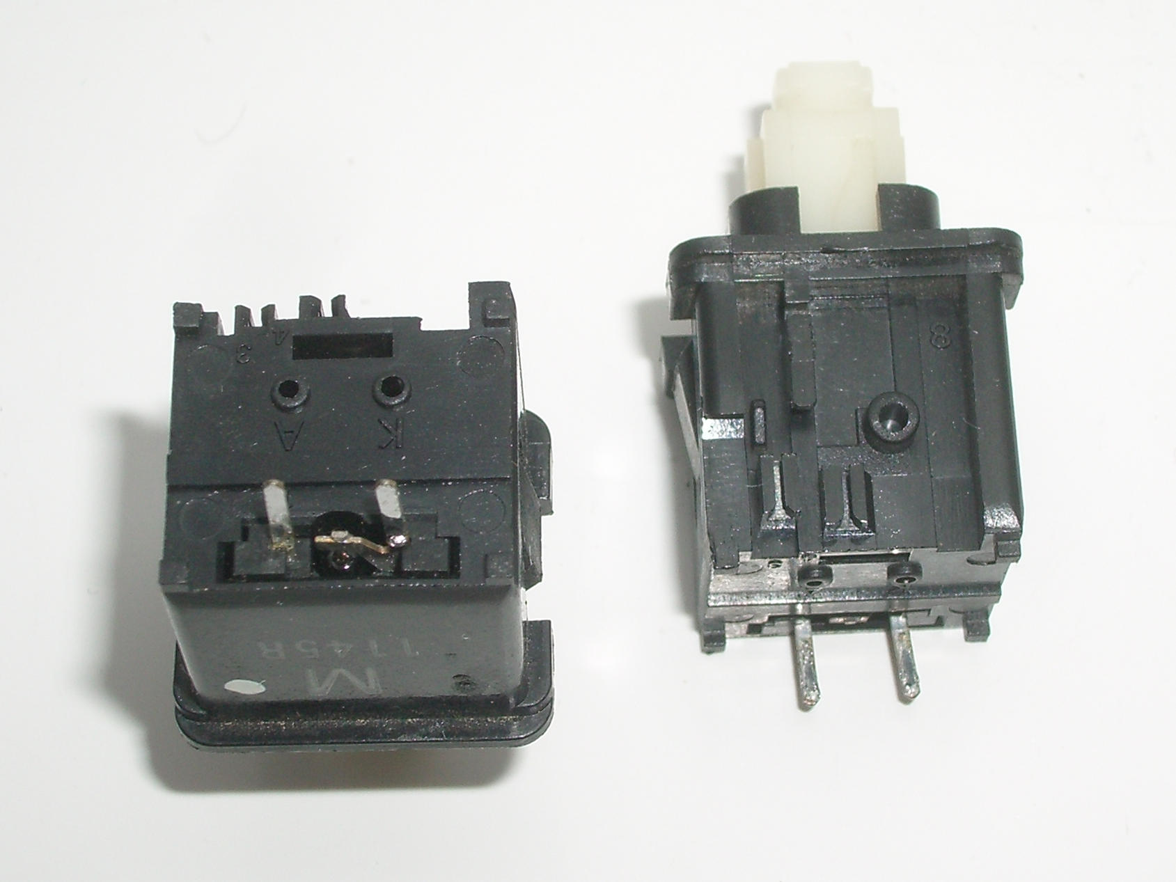

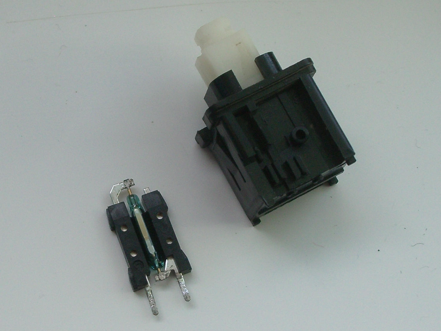

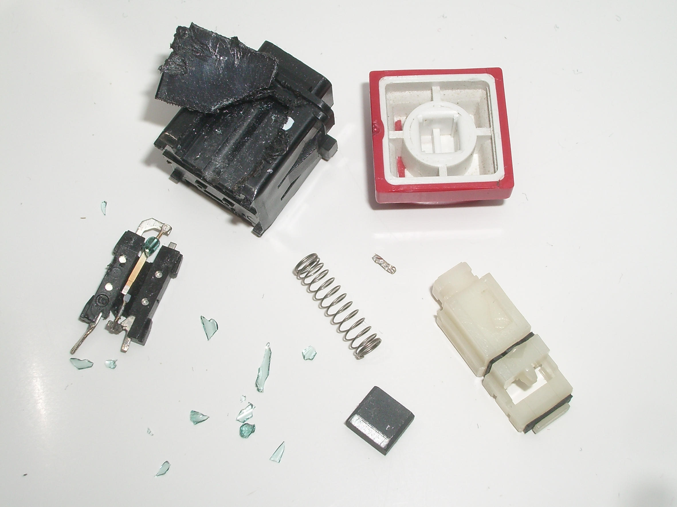

B2R-M (or M1, supposedly, but it says "M" on it), well, not so much. The reed module is a loose fit inside the switch, since it can be slid side to side, but something holds it in and stops it from being pulled back out the switch. Pulling on the legs eventually tore one of the legs apart. You can pull the slider out the top, but you can't then push out the reed assembly as it's actually segregated from the slider chamber by a wall! The reed module has its very own chamber, which is new.
So this is what's left of it after demolishing it to get that reed module out!
The broken-off piece of leg is in the middle.
The switches:
I don't know what I'll do for the wiki, as there's no non-tacky way to show that this is a reed switch!

Apart from the fact that the chamber broke upon disassembly, I still think it looks distinctively reed :)
13 Jan 2017, 22:28
It does, but that would be a truly horrible wiki photo.

Do you have a dremel with a cutting wheel attachment? Cutting the plastic would be much cleaner than using snips.

You'd have to execute a very, very fine cut — you can see in the last picture where the reed module slides in, and you'd have to surgically disassemble that chamber without doing any harm to whatever it is in the reed module that secures it.
I didn't use snips — I used what you'd call an "X-Acto" knife (and blunt, as all the spare blades I got 20 years ago long since vanished without trace) to slice open one side and then just rip it apart with a screwdriver. I'd already crushed the capsule to powder before this stage.
I don't actually want to cut anything apart at all, since then the switch is ruined regardless, but I don't understand what holds that reed module in place. The capsule is so close to the bottom (it's actually visible in the photo) that trying to prise it apart will shatter it instantly.
My guess is that the top pair of tapered lugs on the sides go into recesses inside, since the bottom ones don't seem to correspond with anything and I can just see something (I'd have to tear more of it apart to be sure). The chamber does open to two very small holes at the top (a little over 0.6 × 1.3 mm), meaning that a very rigid wire inserted into each side might force it out, but you'd need neutronium or some such for it to not buckle under the extreme force needed to get this thing back out.
They did not intend for these to ever come apart!

When cutting open components made of plastic, I find that the best tools to use are a narrow chisel (6mm or 1/4") and a sturdy retaining device to hold fast the victim. The retaining device is carved from wood to fit the purpose. Using a vise will risk crushing the component. This is the best way I know of to make a controlled, precise cut. The plastic, if not too brittle, can be shaved away gradually. With due care and patience, the rest of the component won't suffer too much strain from the operation.

For accuracy I won't cut apart anything I can pull apart. Fortunately the others seem more co-operative:
The grip from the pliers has upset the smooth solder finish, so I may see if I can smooth that out.
They're not hugely smooth, no — scratchy and some are a bit juddery. I guess they're all heavily used.
Light though -- something like 50–55 cN actuation force!

B2R accepts a two-pin LED (single colour), while B3K (Romer-G) simply provides a cavity for a surface mount LED, which can be RGB (four-terminal). B3K then provides a light pipe to bring the light up to the keycap level; this does not move. The B3K design untangles the switch from the lighting implementation, while with Cherry MX you're officially tied to single-colour LEDs. Many Cherry MX clone switches allow a wide four-terminal LED to utilise all four holes (inner LED holes and outer diode/jumper holes) by making the switch slot long. Cherry themselves did the same thing as Logitech/Omron and allow an SMD LED to sit within the switch. Matias switches are similar but the LED has to go on the back of the PCB.
B2R is of course a reed switch. B3K has what seems to be a unique design where a single pair of contacts provides two sets of contacts, so from the outside it's one SPST switch, and from the inside it's a pair of switches, the idea being I assume is that if one side goes jittery (leading to chatter), the other side will function normally and conduct while the other side is bouncing: the bounce won't be detected by the keyboard controller.
B3K is tactile. Not very tactile, but the tactility is there. B2R is 100% linear — being a reed switch, you can't even feel the contacts engage. At least one switch would emit a faint click, but by and large the only sound you hear is scraping (they may be worn, as when new I'd expect them to be much smoother and quieter).
B2R is both downstroke and upstroke damped, using two very different approaches. The downstroke damping uses a rubber pad pressed onto the bottom of the slider, and the sides of this collide with posts inside the switch. The upstroke damping uses a "waistband" around the middle of the slider, with a protrusion that catches on a downwards-facing ledge inside the shell.
Detailed pictures of B3K are on the wiki. More pictures of B2R will follow, although there's not a lot to see as the shell doesn't come apart and it's hard to see inside. The additional pictures will be of more use in demonstrating the damping, and the off-centre return spring. The action (the reed module) is already covered (not a great photo, as it was at the very edge of macro depth of field).

I've not ordered any yet, so I don't know what the G1 type is like. M type is just all pushed together, and it takes a lot of force to pull the reed module and slider back out. One slider was destroyed trying to get it out, but the switch at the top of the thread has intact slider that I can substitute for the broken one.
There are no details on G1 in English (and I don't recall seeing any in any language but Japanese which I can't read and is virtually impossible to machine translate with current technology).
