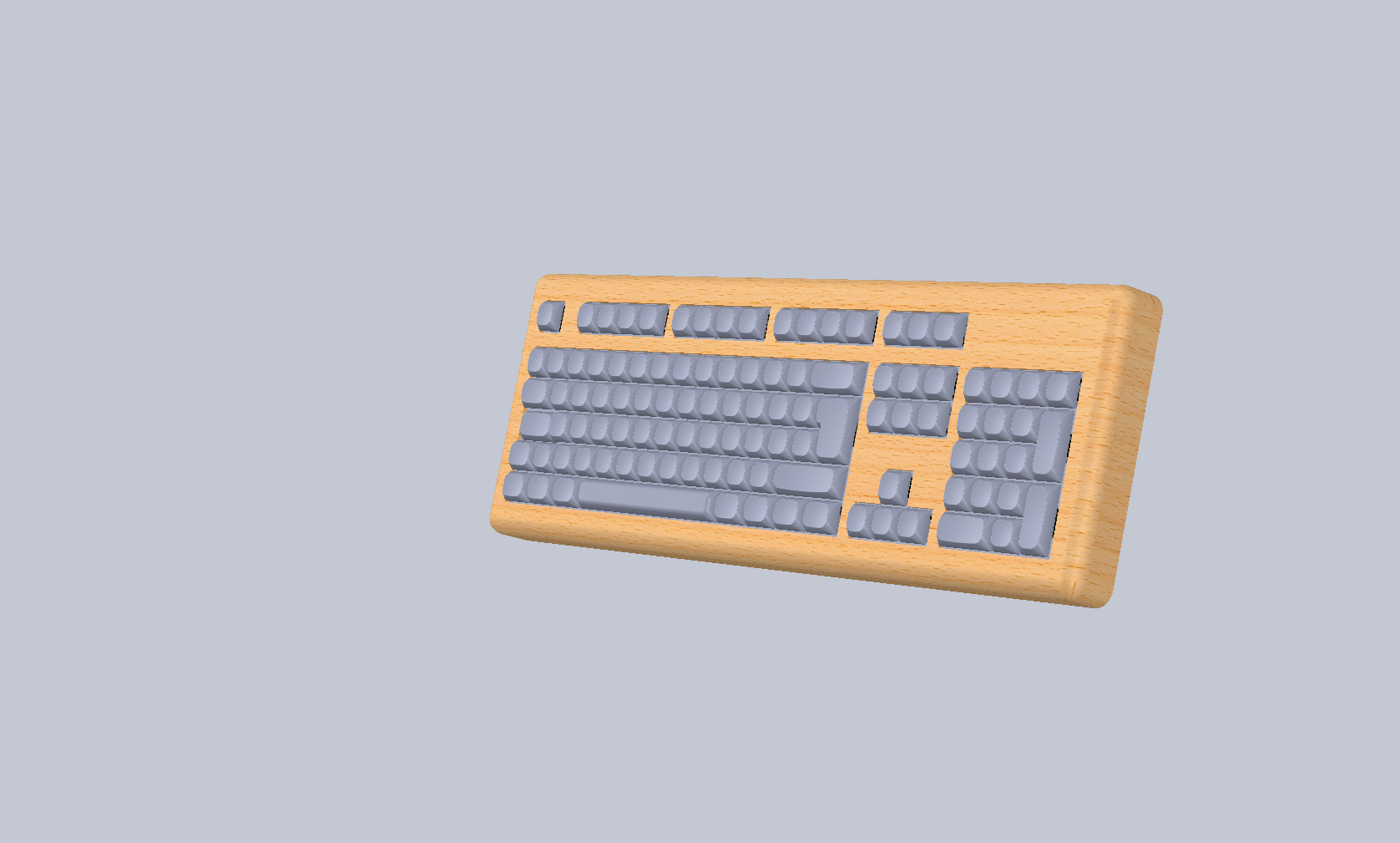

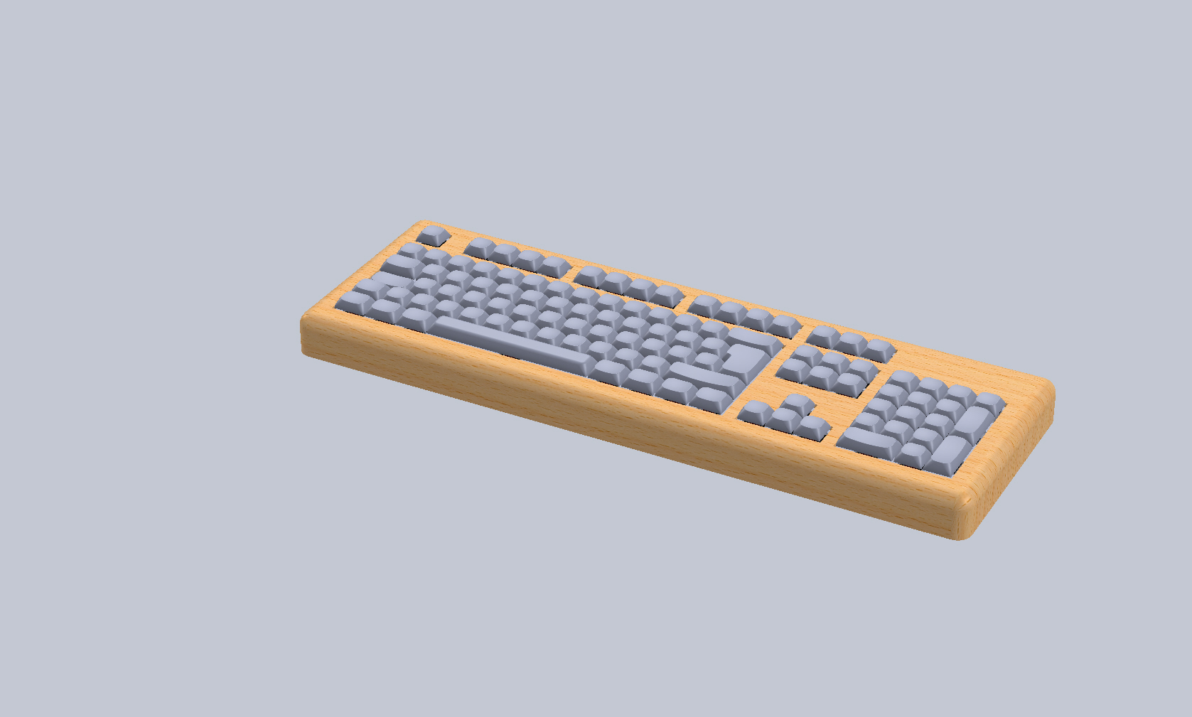

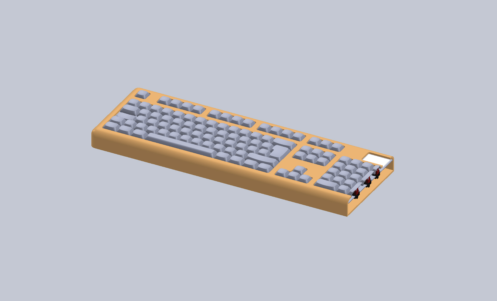

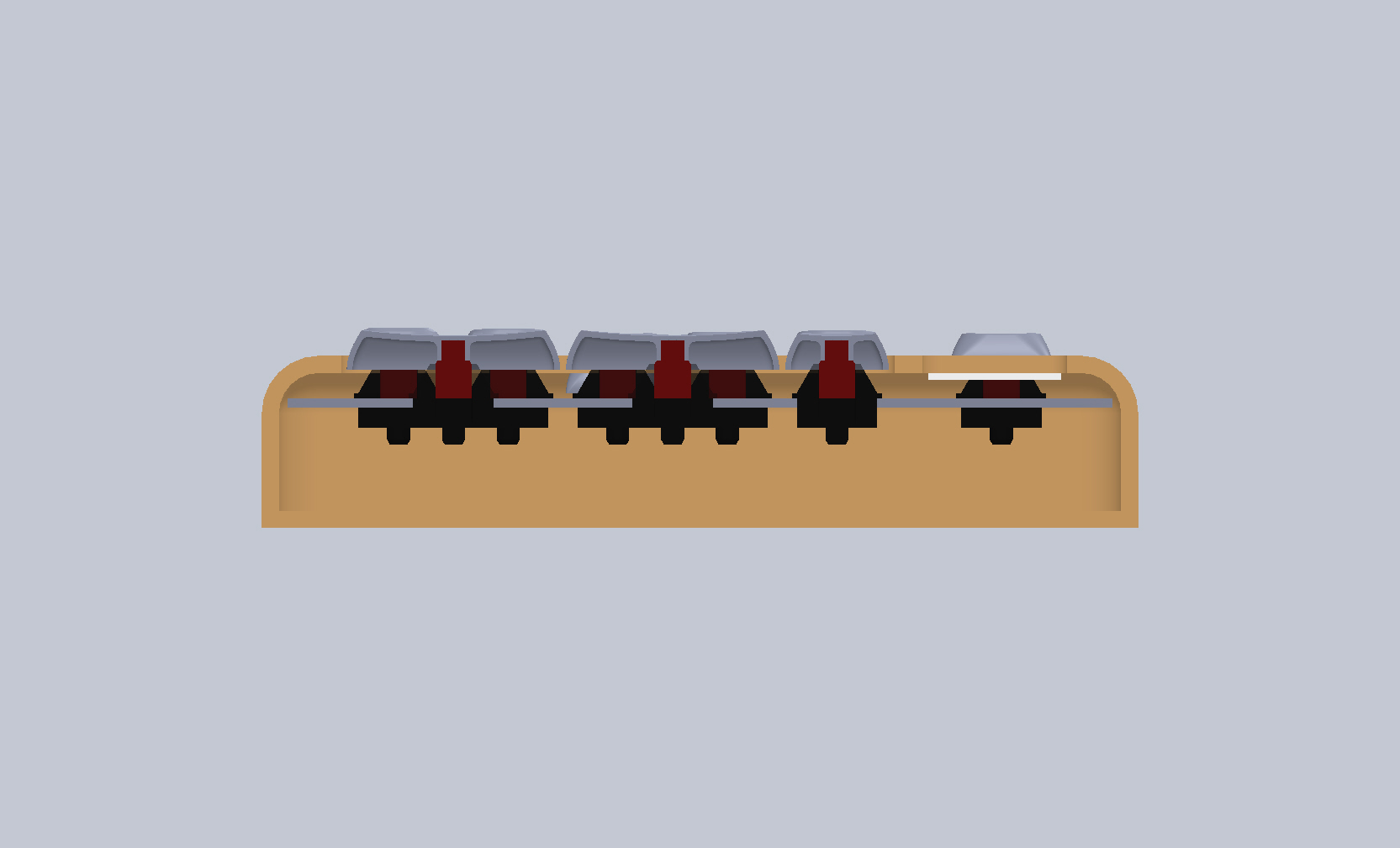

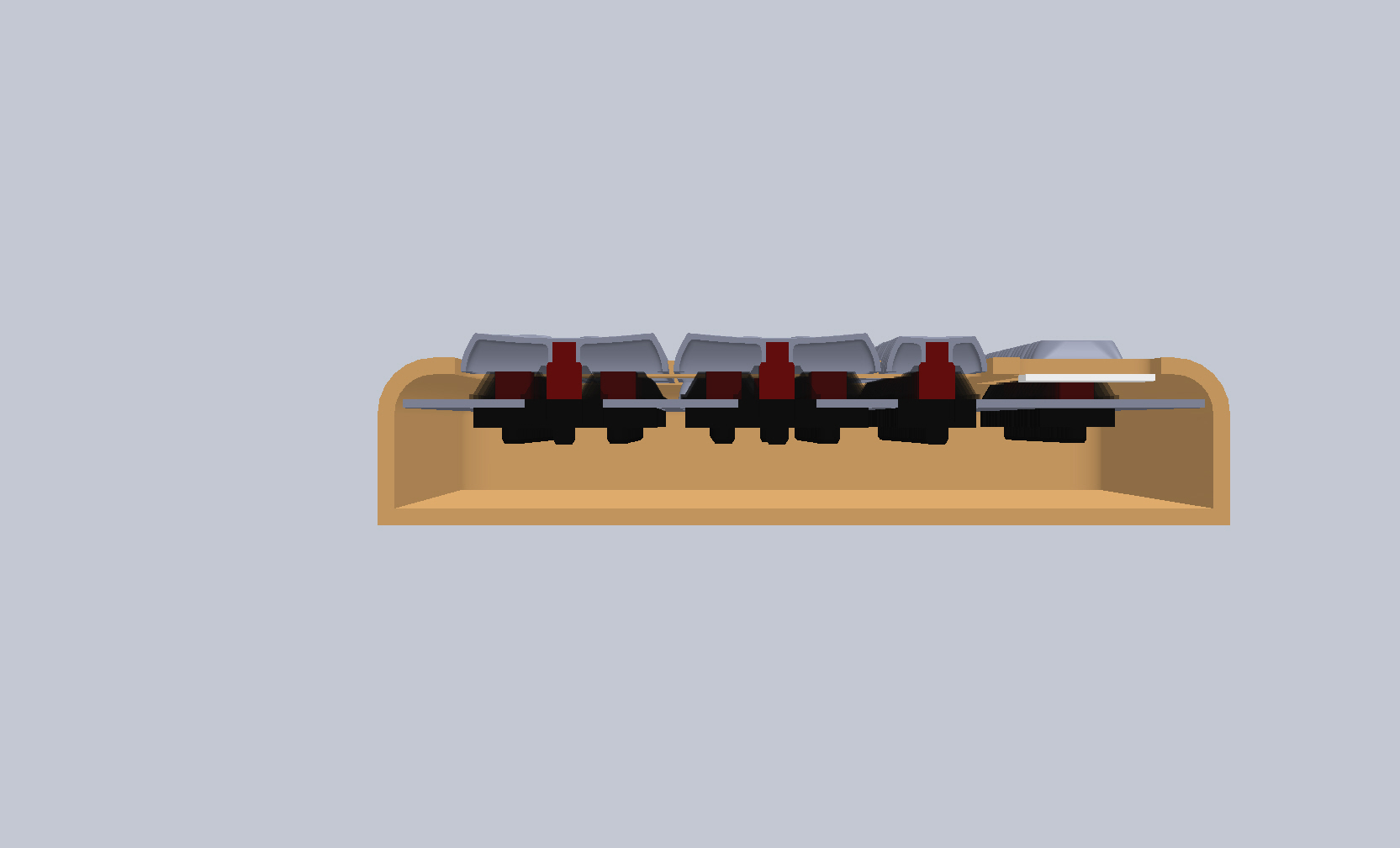

Or maybe you can just CAD something yourself. This is just something I threw together in a few hours (for Cherry MX compatibles) for playing around with looks and sizing for a CNC-milled wooden case. (This is a gateway drug keyboard for getting off from flat notebook keyboards, so I was deliberately going for a single row shape, shallow and slightly edgy design - but since its all parametric it's easy to adjust side angle, dish depth, edge radiuses, etc.)

tigpha wrote: The other consideration is the dished shape of a spherical cap, and that the transfer foil needs to conform to the dished shape.
Yes, not really knowing the dye sublimation process I indeed did not consider this. Maybe you could ask Nakazato-san what the possibilities are there? Maybe he sees a challenge (or value) in working out a good transfer process for spherical caps, and then we created something new and useful for the world. We will never know if we don't ask.
