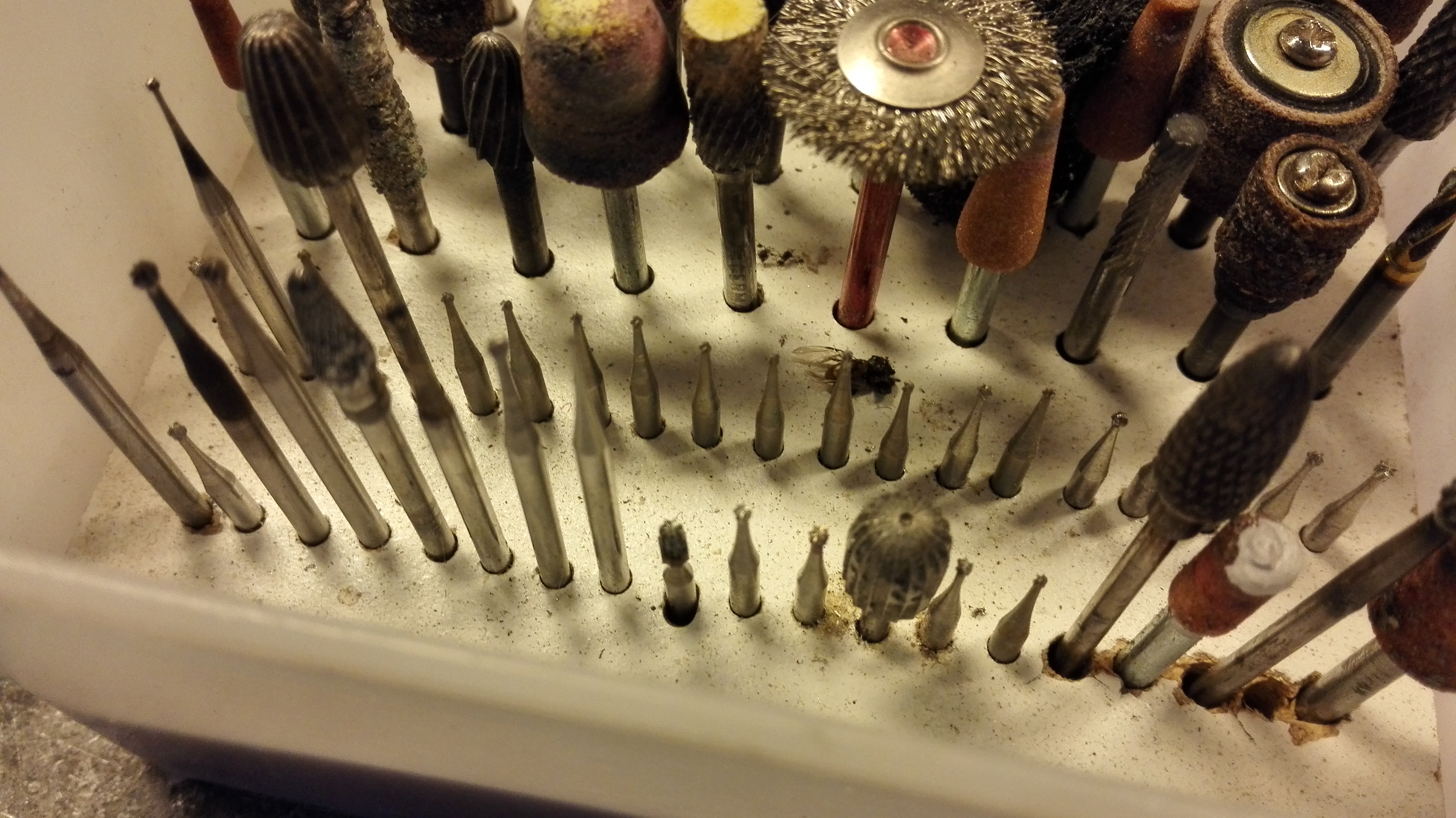

Anyway. I don't think you would be able to dremel it without having to replace the stem completely. There aren't that many dremel bits that are small enough to get into there ...
