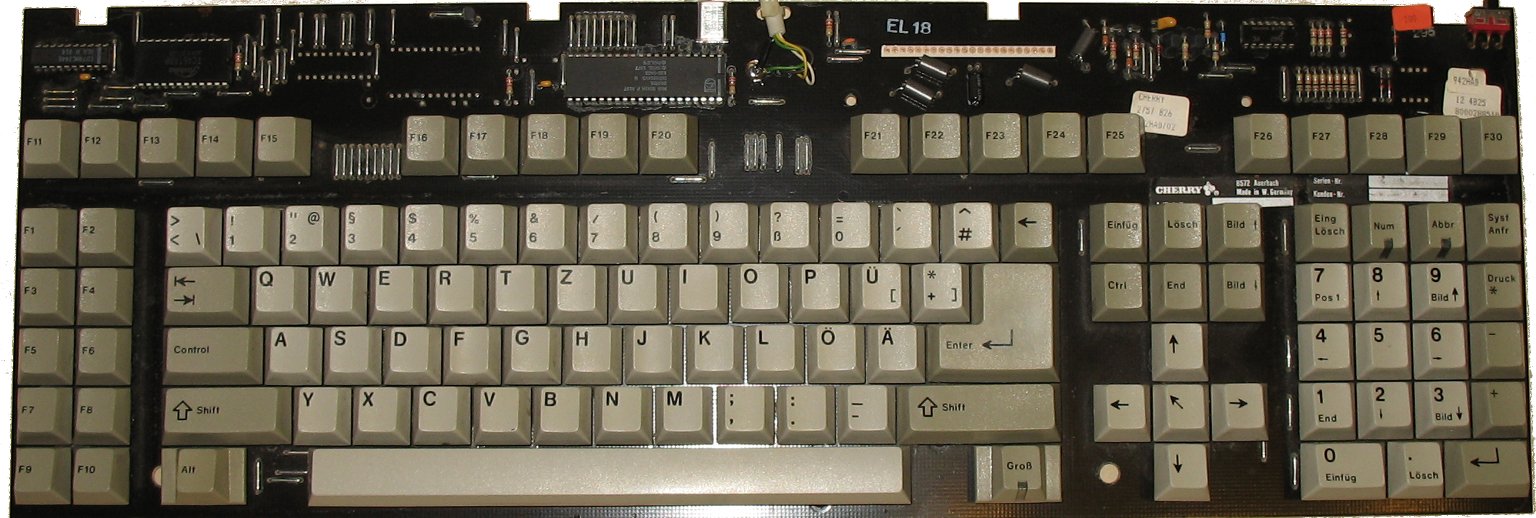

Cherry 942HAD/02
mintberryminuscrunch
25 Nov 2011, 22:32
Cherry 942 HAD
Double-shot keys
Cherry MX black
XT/AT switch
30 Function keys :D
1,75 Control key :twisted:
first 2 pics, more to come once cleaned

25 Nov 2011, 23:55
G80-0528HAU for NCR
G80-0528HAU: L-shape Enter key.

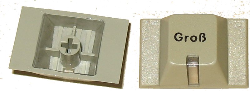

do you know how the windowed keys were made/printed
they look 2shot but the bottom says no.

All LED-window keys are engraved and filled.

26 Nov 2011, 12:35
7bit wrote:All LED-window keys are engraved and filled.
Nope. All Cherry LED keys and keys with complex graphics are pad printed and then coated with a clear coating, that lasts about 2 years of heavy use. These keys have the exact same contrast as their double shot ABS keys.
26 Nov 2011, 14:52
And why is the coating invisible?
It is visible on the Cherry key:
No such coating visible here:

26 Nov 2011, 15:40
If you move them around a bit in the light and compare them to a double shot one you will see it, assuming the keys are from a NIB sample. The coated keys have a very light shiny texture in a squareshape, almost filling the entire front of the keycap. It is actually hard to explain.
There is a single exception, where Cherry did infact make 2 engraved keys. This is on the newer revision of the Phoneboard, because the old ones wore off after a couple of years in use in call-centers. The newer phoneboard uses both the old pad-printed & coated keys, as well as 2 engraved and filled keys. This is the only time Cherry did this. The engraving is very noticeable and unlike the pad printing you can feel it.
With some color changes you can even slightly see the coating in this picture:
The coating is the slightly darker part of the keycap. You will find this on all types of complex and LED keys from Cherry.

26 Nov 2011, 15:43
Edit: Turns out the coating actually is also very visible on your own pciture of the Cherry key, even more so than on my picture:

26 Nov 2011, 15:48
7bit wrote: No such coating visible here:
It is very subtle, but it is there:
Looking at the small blue arrow on the Numlock, you can also tell that it is not engraved, because the original texture of the keycap is still present and visible through the slightly opaque arrow 8-)
