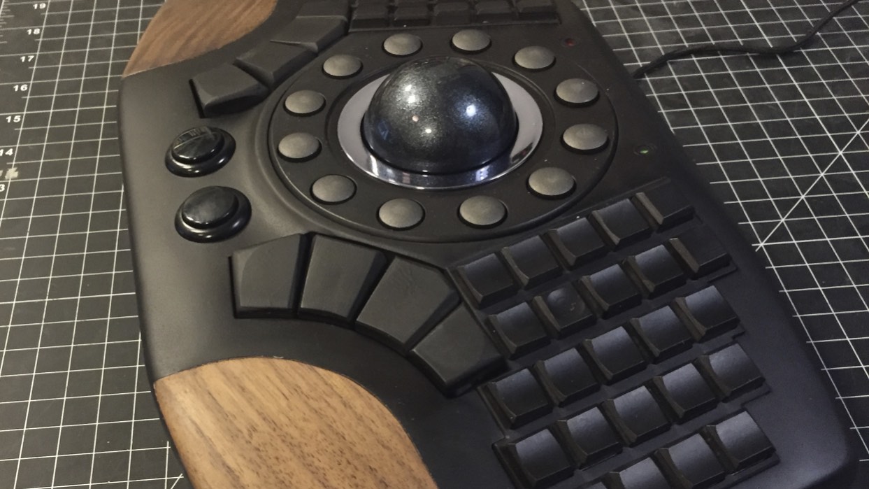

Just finished Planet 6; My latest ergo board
Posted: 25 Nov 2016, 18:44
by Kurplop
IMG_1319 - Version 2.jpg (156.84 KiB) Viewed 4462 times
After a year+ of starts, stops, redesigning, delays, missing fingers, etcetera, I finally finished, what I would call, my CAD friendly ergonomic keyboard. Check out the pictorial chronology here: https://youtu.be/FI37j5bLnKY

Posted: 26 Nov 2016, 06:22
by Kurplop
Thanks for your questions and kind words.
I hoped the milling action would whet some appetites. It's hypnotic; almost sensual.
Here is an early map I made. It's incomplete and only about 90% accurate but gives you an idea where I'm gong with it. Some of the final keyring assignments will be decided later by trial and error. Most of the 2nd layer key assignments will be on the right half. Well suited for me since an accident in April left me with a few shortened fingers on my left hand.
keymapping.pdf
(1.34 MiB) Downloaded 196 times
I weighed it today. It is seven pounds. The bottom walnut and aluminum cover weighs three pounds and the working half the other four. I could have dropped almost 2 pounds from the bottom cover but since it will be mounted to a keyboard tray arm the extra weight won't matter. Considering its fairly small footprint (15" wide), it feels very solid. By comparison, I kept my AlumaPlop down to a pound and a half. Same aluminum body but designed for portability.
The reason I went with such a radical departure from traditional switch and cap design was because of the smaller vertical spacing between keys I wanted. Losing a half inch of distance between five rows of switches makes it much easier to reach the top and bottom rows.
The twelve switches around the trackball will allow most CAD functions to be executed with minimal hand movement.
