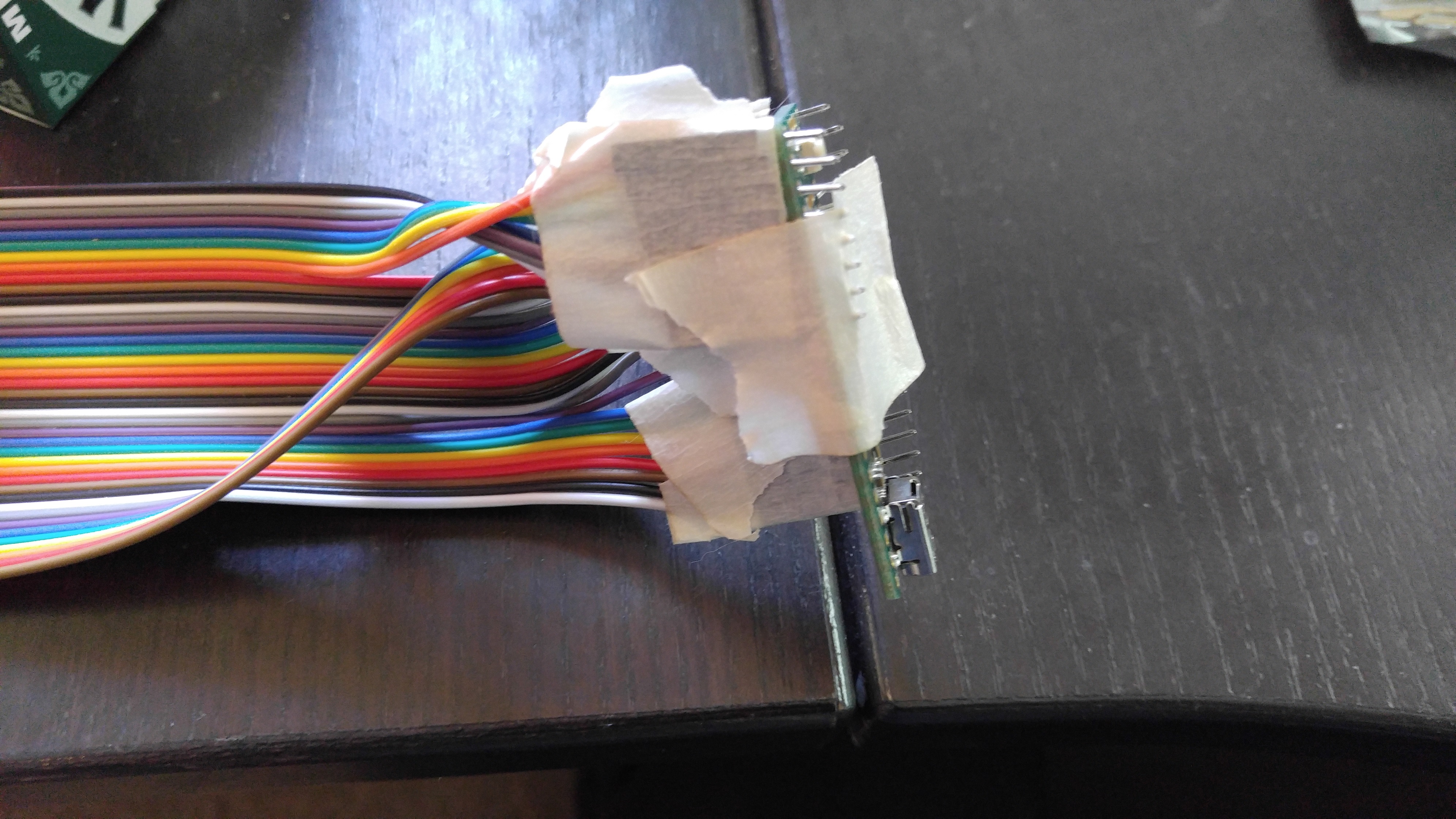

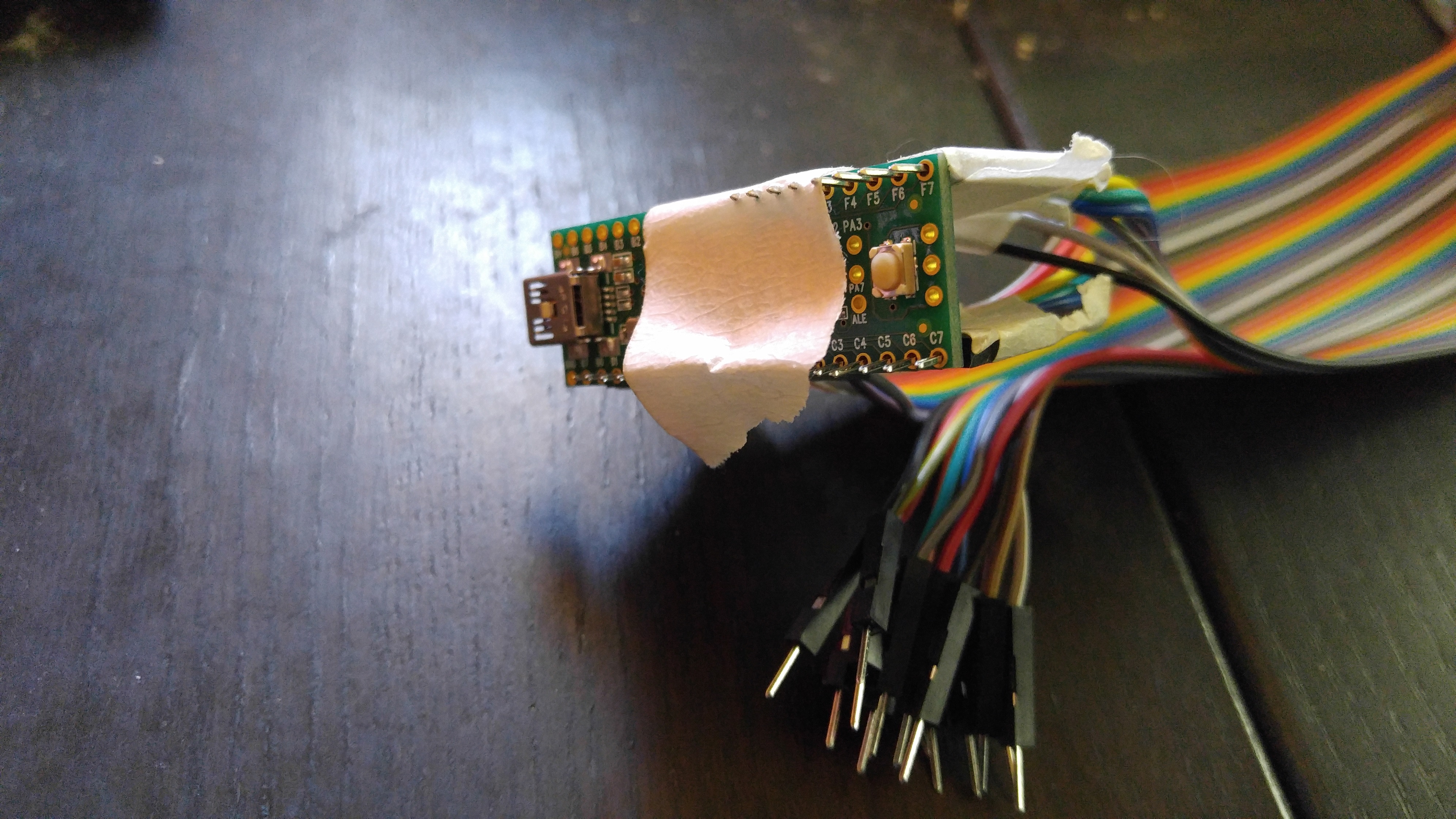

So, we've got a pre-made PCB with plate. We've got (presumably) switches that you're gonna replace because uuuuugh they only came in MX Black and MX Red. We've got a well mapped 8x18 matrix. So, I grabbed one of my (don't ask how many) Teensies, TMK, a lot of ibuprofen, and set to work putting together a prototype I call:
Fuck no I'm not soldering this shit till I'm sure it works.
GitHub fork of TMK for Costar CST104 - no, my workflow for this is not well integrated.
Fun Fact: masking tape is non-conductive!

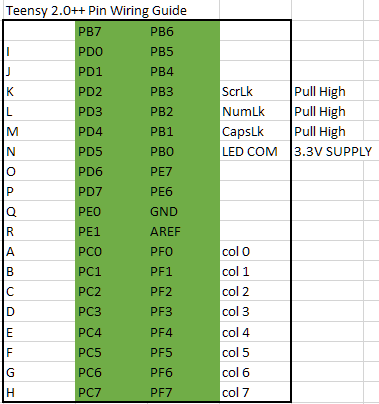

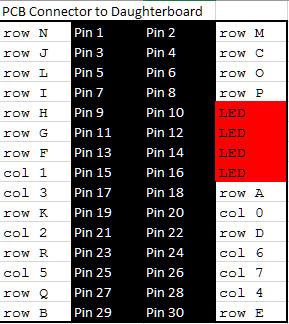

RESERVED FOR PINOUT DIAGRAMS (gimme a sec damnit.)
PCB side pinout
PCB side pinout
Teensy wiring
Teensy wiring

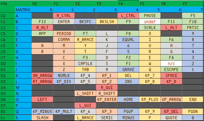

RESERVED FOR MATRIX STUFF (gimme a sec damnit.)
KLE - annotated layout

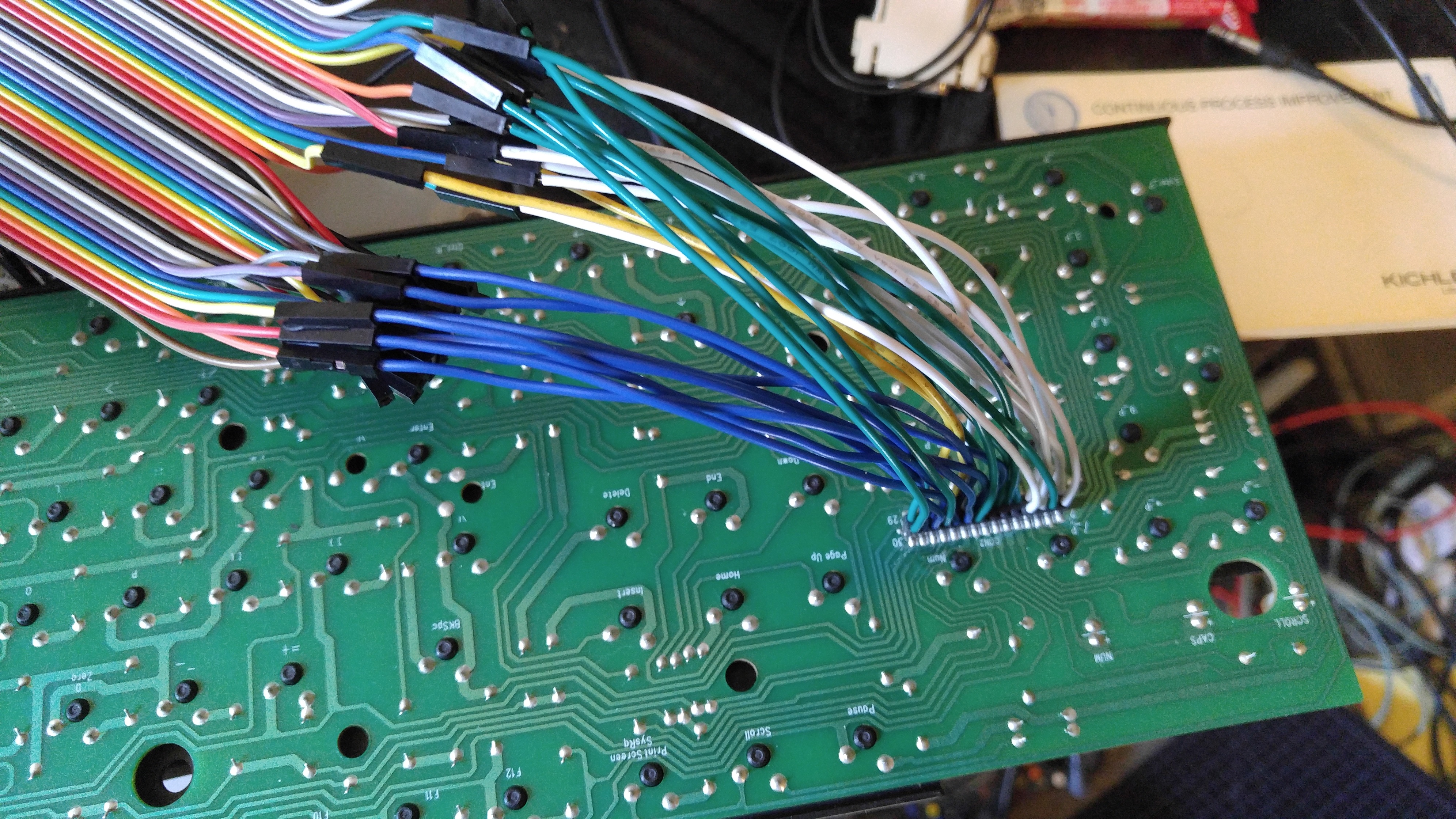

Miscellaneous Notes on working with the CST104 PCB
Attention: this is for ANSI layouts, but is convertible to ISO
The CST104 uses a common PCB for both ANSI and ISO layouts. This configuration is my preference - ANSI. ISO requires implementing two additional keys already in the matrix.
WARNING! Bad solder joints!
Invariably you will find at least one bad solder joint on the narrow pitch connector, usually toward the middle. You will need to repair this, especially if you are using a mating connector. The PCB side connector is surface-mount soldered so there is a risk of damage if this is uncorrected.

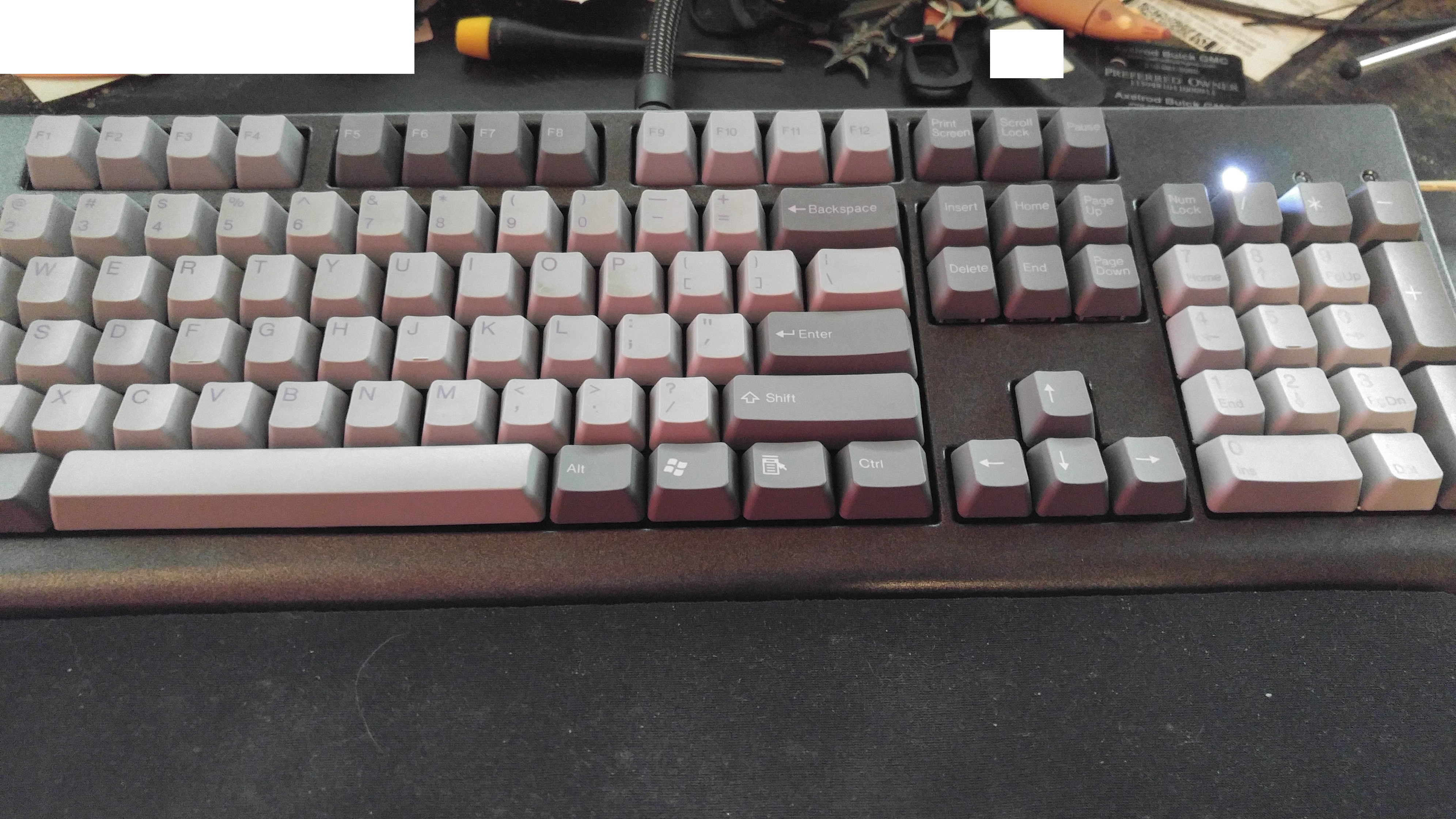

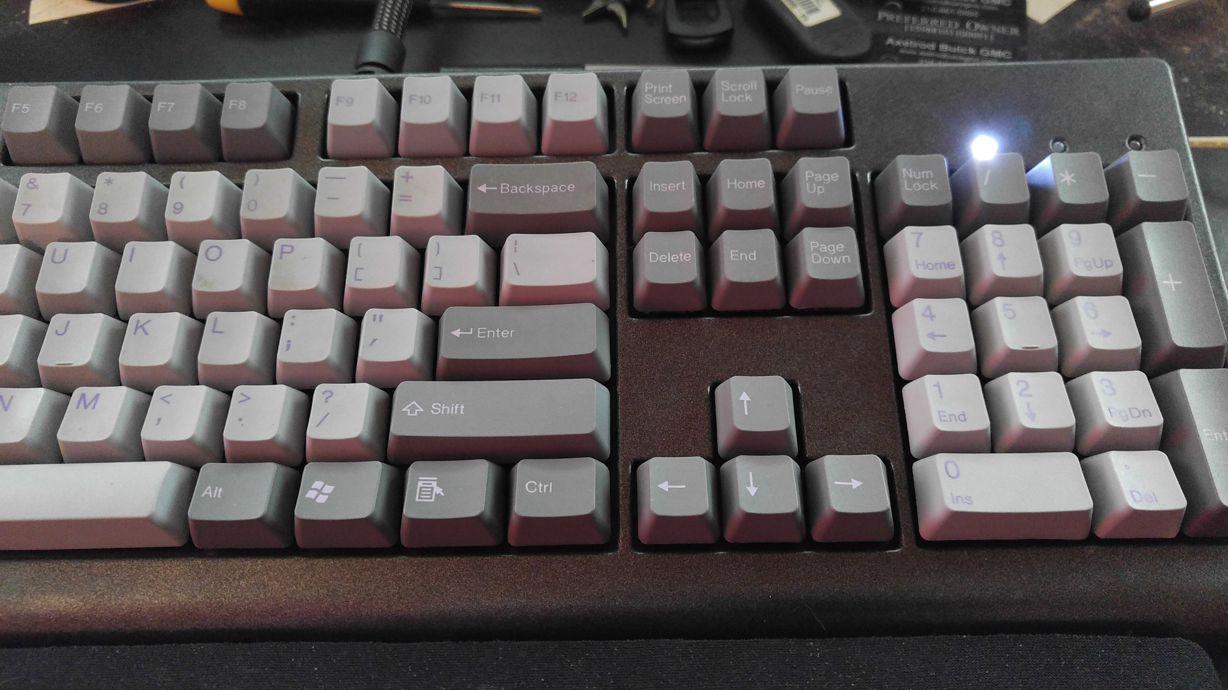

After quite some time wasted trying to find the heisenbug in the compiler, I finally threw in the towel for the moment on the controller. I'll get back to it when I have a keyboard I'm comfortable on that, as an added bonus, actually works. Something that can't be said for this Rosewill RK9000v2. (Garbage bones beget garbage boards.)
The top cover's already done. The Thermaltake cover is just ugly. So I hit it with Rustoleum's plasti-dip clone in graphite. I'll post pictures later. They go here. Don't let me forget. It came out pretty good.

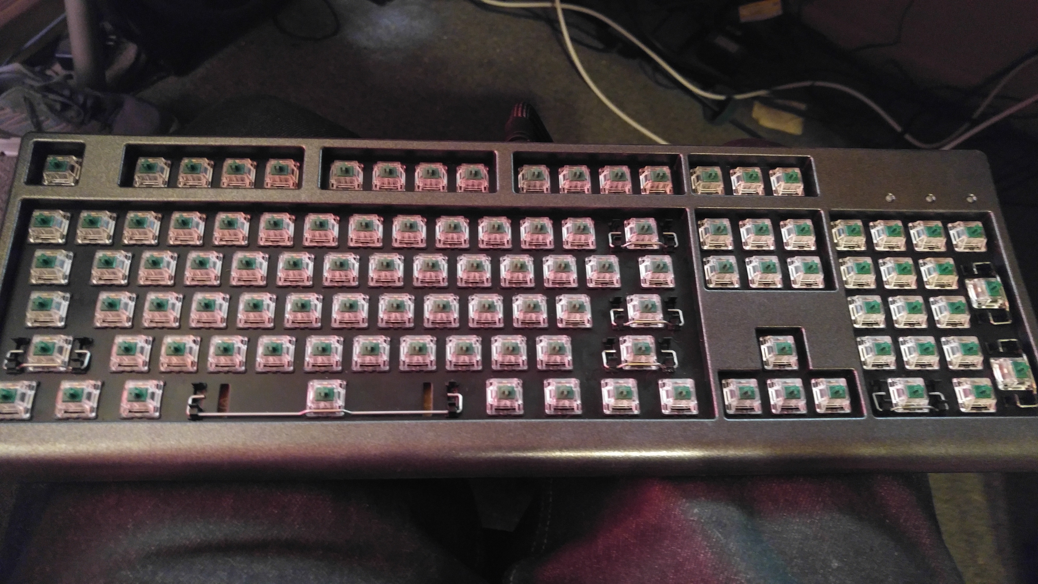

So today I spent about an hour desoldering. It took about an hour because Costar's work is... highly inconsistent. Some joints were ~5 seconds at 230C, while others on the same switch were 30 seconds at 230C with lots of slop. Which is where the PCB fun then comes in.
The CST104 PCBs are single-sided and VERY flex happy. You don't lift it off the switches, you peel it. All of the diodes reside on the top of course, using through holes. But it'll take another hour just to clean up the poor quality soldering from the factory. And you really do need to clean that up. It's a huge mess.
All of the strength in these boards is from the very thick plate. So if you ruin the PCB? Screw it - hand wire it. I didn't ruin the PCB (though you'll need to be extra careful of pad lift.) So next up is soldering it up, verifying the PCB's in good shape, and then I can go back to flipping through compilers to see why they're generating bad output for the 1286 any time there's more than 16 pins.

Inconsistend desoldering times are usually caused by differenced in the thermal mass neas a soldering joint. Pins only connected by a thin PCB trace desolder nice and fast but if they are part of a larger ground plane, desoldering can take forever. This is of course amplified by thick, multi layer pcb. Most of the desoldering I do is Cherry G80s which are flimsy single sided pcb and a pleasure to desolder. For MX Clears, I have a few GMK made keyboard for desoldering and they use thick, double sided pcb and desoldering takes much longer.
I also desolder at much higher temperatures, more like 330C-350C

Wodan wrote: Inconsistend desoldering times are usually caused by differenced in the thermal mass neas a soldering joint. Pins only connected by a thin PCB trace desolder nice and fast but if they are part of a larger ground plane, desoldering can take forever. This is of course amplified by thick, multi layer pcb. Most of the desoldering I do is Cherry G80s which are flimsy single sided pcb and a pleasure to desolder. For MX Clears, I have a few GMK made keyboard for desoldering and they use thick, double sided pcb and desoldering takes much longer.
I prefer to keep temperatures low, but no, this is just flat out inconsistency. Frankly, I think there's two different types of solder, given this is the flimsiest of the flimsy single-layer PCBs ever and no thermal mass difference. Seriously, it's even worse than G80's. By a wide margin.
Moves like a sheet of paper. Which is exactly why you want to desolder this one at the lowest temperatures you can. Pad lift or trace scorching is GOING to happen if you run even a bit too hot. There's a reason I call Costar cheap, and it's because they very much are. Especially compared to Ducky, much less group buy PCBs.
Pretty moot for me till Memotronics replaces my ZD-985 though. Yep - vacuum pump just up and croaked. KWALITY!
Also because I'm done with the straight swap so I can go back to the Teensy issues. Note that the narrow pitch connector that Costar used? Is cheap as crap and will be out of spec after probably 5 or 6 insertions. Requiring you to slightly overtorque after applying some percussion to solidify the contact on the X or Y axis.
But so far, I do say this is one sexy board. Especially considering the whole build cost less than $50 with all new switches, caps, and LEDs. Yes, those are narrow angle white LEDs for all three. Much better than the wide-angle blinding reds that Thermaltake used. Also, that's not potato or fuzz.. that's how the graphite plastidip is supposed to look. It has a bit of texture to it.
