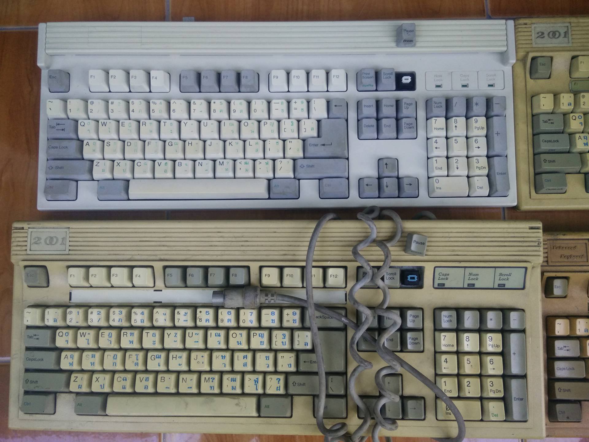

Hi, I have recently got myself a FK-2001 with SKCM Blue but there is also another one in which i could also buy, the one on top. It uses the similar design case without any badge but utilizes ALPS clone switch. What is it actually, and is it worth getting one? He offered me $20 including shipping. And can I swap the case of that thing with my FK-2001 ? since my FK-2001 does not come in clean condition.
Picture below, thanks.

Looks like an Ortek
wiki/Ortek_MCK-101_FX
29 Sep 2016, 17:15
Tangtawan wrote: And can I swap the case of that thing with my FK-2001 ?
No I don't think so. And since you have a very nice FK-2001 with nice keycaps (thai ?) I'd say the Ortek is not worth it. Forget about it and clean that nice FK-2001 up, the SKCM Blues alone are worth the effort.

Thanks for the comment guys, yea.. it does look like Ortek_MCK-101- but im quite surprised that it still looks good and there is no sign of yellowing despite its age.
Btw, what should i do with my FK-2001? Whats the most simple way of restoring the plastic color and getting rid of those dirt? Hydrogen Peroxide is not that easy to find around here.

Oh, those keycaps on the 2001 look amazing. Match the switches perfectly. You know who to call if you don't end up liking that yellowed case ;)

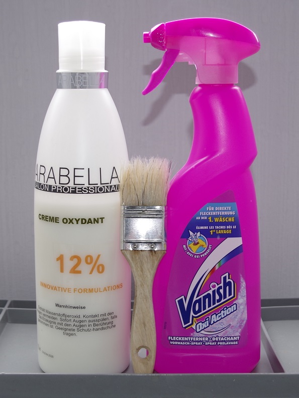

Tangtawan wrote: Btw, what should i do with my FK-2001? Whats the most simple way of restoring the plastic color and getting rid of those dirt? Hydrogen Peroxide is not that easy to find around here.
I'm assuming you have plenty of sunlight in Thailand so you could use this method to retrobright:
kbdfr wrote: Apply H2O2 cream with the brush (not much more than a spoon needed for a keyboard case), then spray Oxi Vanish upon it and brush. Brush again in intervalls of about half an hour, adding a bit H2O2 and Oxi Vanish if needed to prevent drying (which is essential). Use gloves (OK, I don’t, I’m just careful to avoid any splashing and skin contact) and be aware the stuff will inevitably drip.
When exposed to sunlight (which obviously is necessary), a yellowed keyboard case will need not more than a few (let’s say 4) hours to look like new again.
At least that’s my experience (based on half a dozen items), but of course I won’t be liable if you mess it up :mrgreen:
