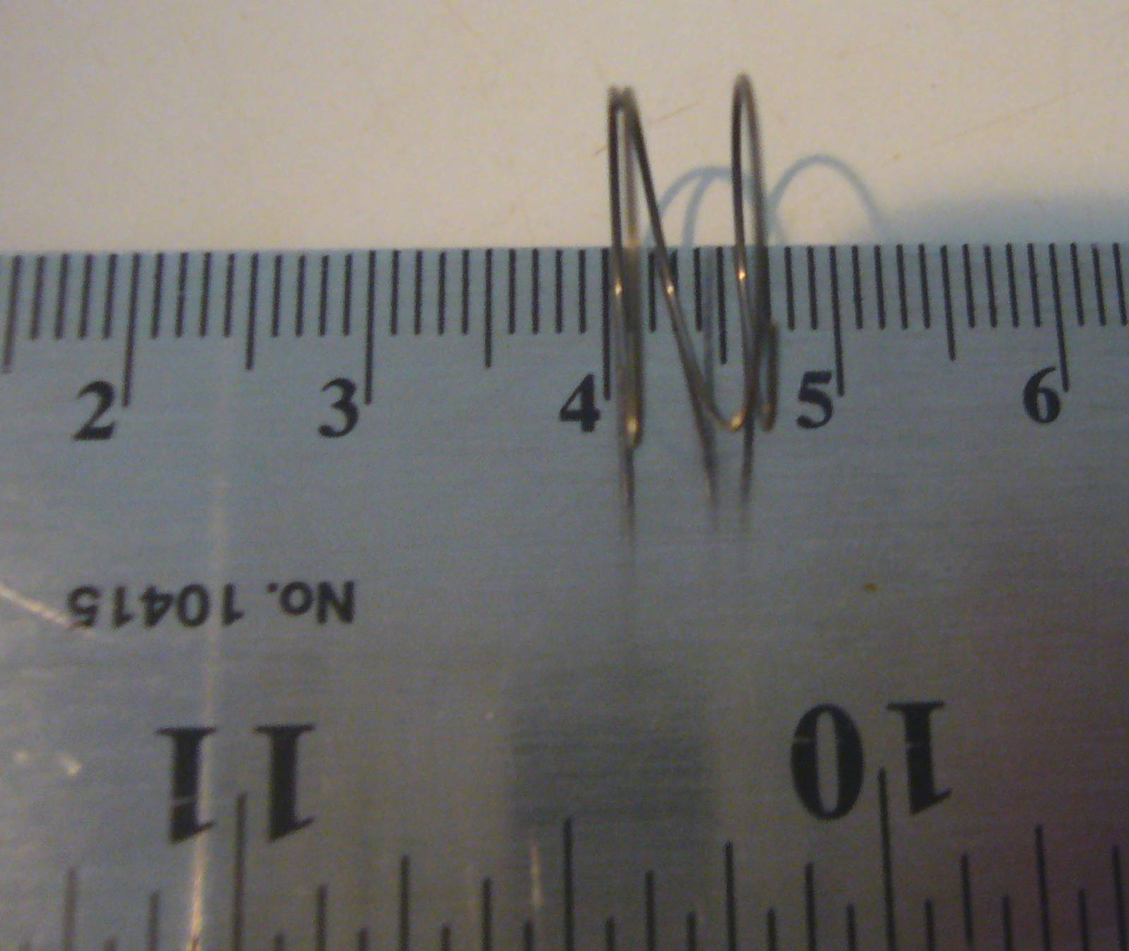

Yesterday I was cleaning up my work bench and came across a spring. I do not know where I got it or what it came from, but it looked like just the right size for an IBM buckling spring barrel and not very stiff.
I installed it on the space bar and it felt wonderful! Using the crude "stack of nickels" for measure, it increased the actuation force from ~70 grams to ~90 grams. But it also reduced rattle/clatter and made the entire length of the space bar seem firmer.
The jury is still out on whether the improvement is worth the extra effort required to use the key hour after hour, and I would certainly not want it on every key, but the space bar feels great so far.

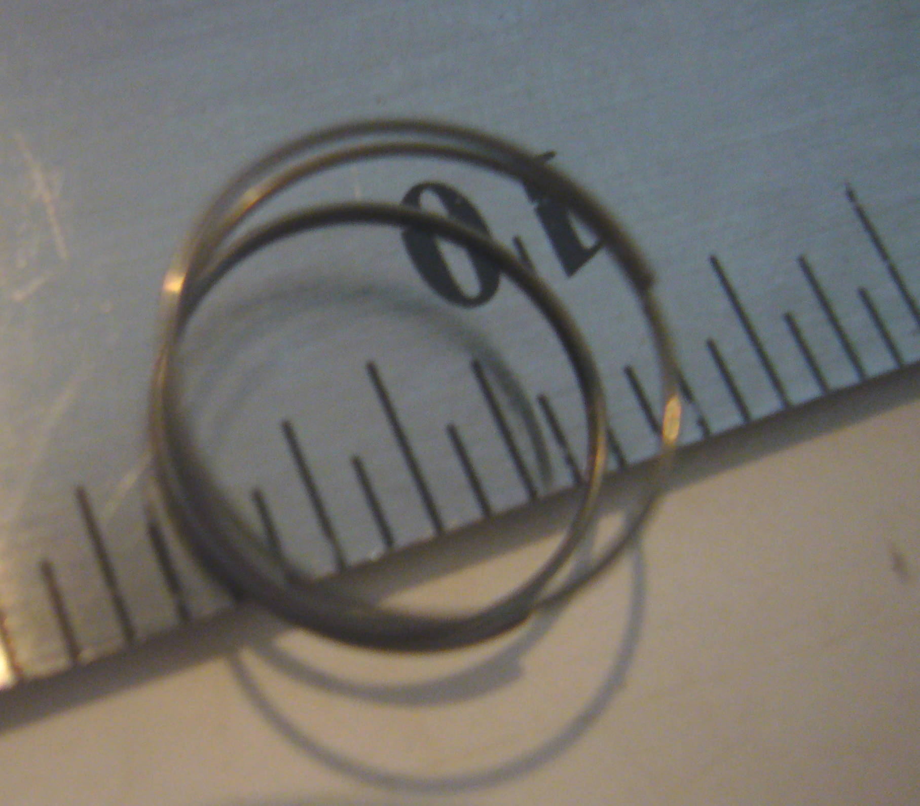

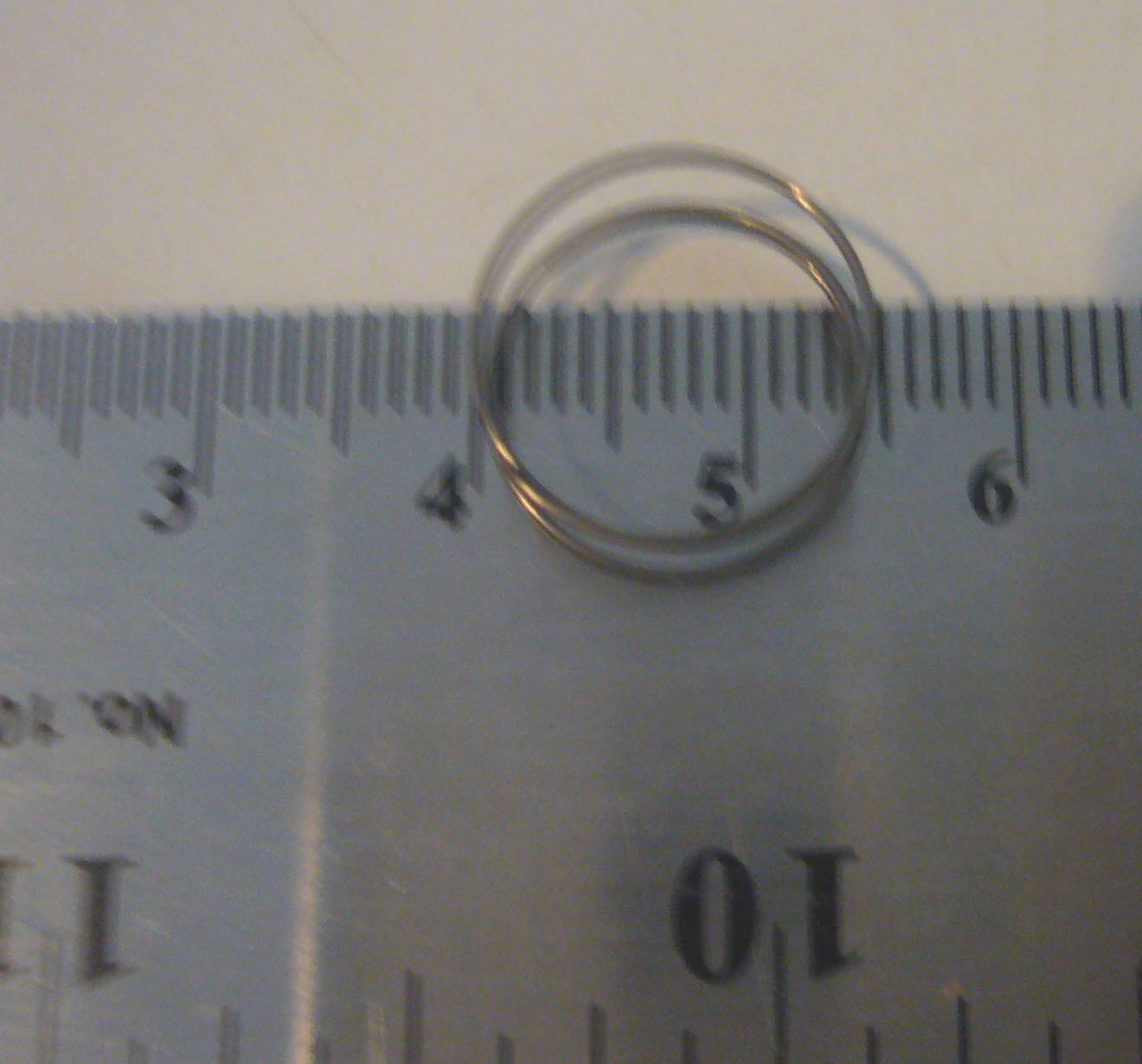

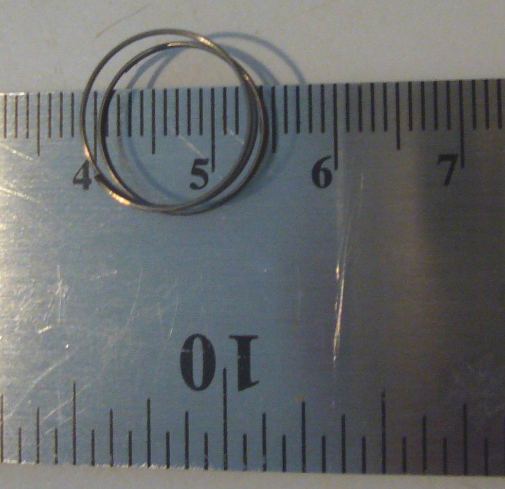

This spring has a diameter of about 14.5 mm (<9/16") and a height of just under 7 mm (<1/4") with very thin wire and just barely over half of a single full turn around the circumference - this is an unusual and "weak" spring.

So this surrounds the barrel and adds extra effort at the bottom of the keypress? Interesting. I'd be interested to hear how you like it long term, and for long typing stretches. I agree that the space bar would be the only place I could use a little extra weight.
18 Sep 2016, 17:10
Yes it surrounds the barrel, but no, it is in play all the way. That is why it reduces rattle/chatter from the start.
