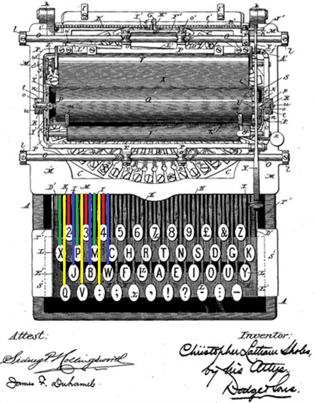

I would negate that. You don’t hold the handle of a cup the same way in your right or left hand, irrespective of whether you are right-handed or left-handed.
As for "keyboard designers in the past", there were none.
People who designed writing devices had to find solutions to mechanical issues. They would most certainly have chosen a matrix pattern had it not been necessary to mechanically convey key presses, i.e. to have a metal bar attached to each key and to have all those metal bars positioned beside each other. This precisely
excluded a matrix pattern and explains the non-identical staggering of the different rows:
- staggering.jpg (184.89 KiB) Viewed 3065 times
