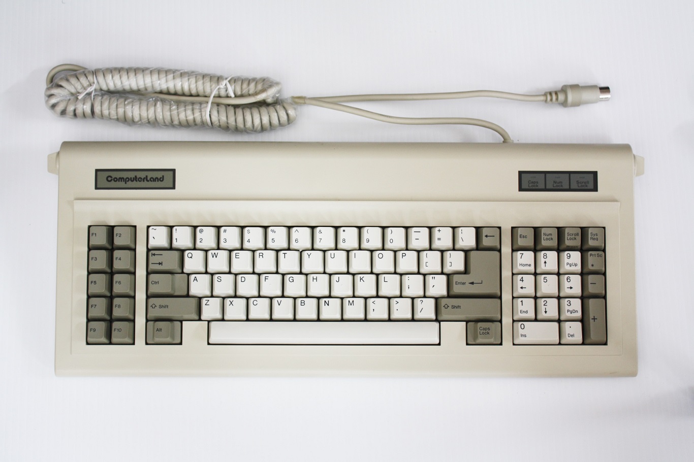

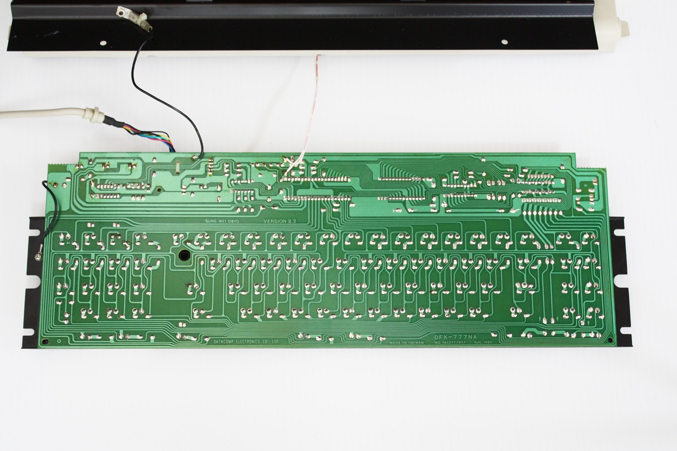

A recent acquisition had a complete surprise in it. I purchased an Apple Clone and the owner said he's throw in this "Wizard" computer for an extra $50. I thought it was a more vintage computer (he didn't take any pics since it was a throw in) but it turns out it was a 286 (not 386SX as was printed on the box) based computer. Included was this Computerland keyboard.
This keyboard looks pristine. In fact, I had to wipe down my finger prints because the black metal plate on the back was spotless. Even the cord is still wrapped but if it was used, I can't see signs of it. Internally this is a Datacomp DFK-777NA keyboard with PCB dated August 1986 but the components are several months later. When I pulled out the keyboard sand mashed down on the keys, there was several clicks. I pulled off a key cap and I saw blue. I did a quick search and couldn't find any information on this particular keyboard so I unsoldered a key switch to check if it was real. Well, it is a blue Alps key switch so I finally have one by accident.
It must be a re-badge of something but I really love the layout. It's an XT/AT switchable keyboard with the function keys on the side like the Model F XT but has a full numeric keypad like the Model F AT. This might become a daily driver for a bit.
Here are some pics.
Computerland Blue Alps - Datacomp DFK-777NA
Computerland Blue Alps - Datacomp DFK-777NA.JPG (234.22 KiB) Viewed 6772 times

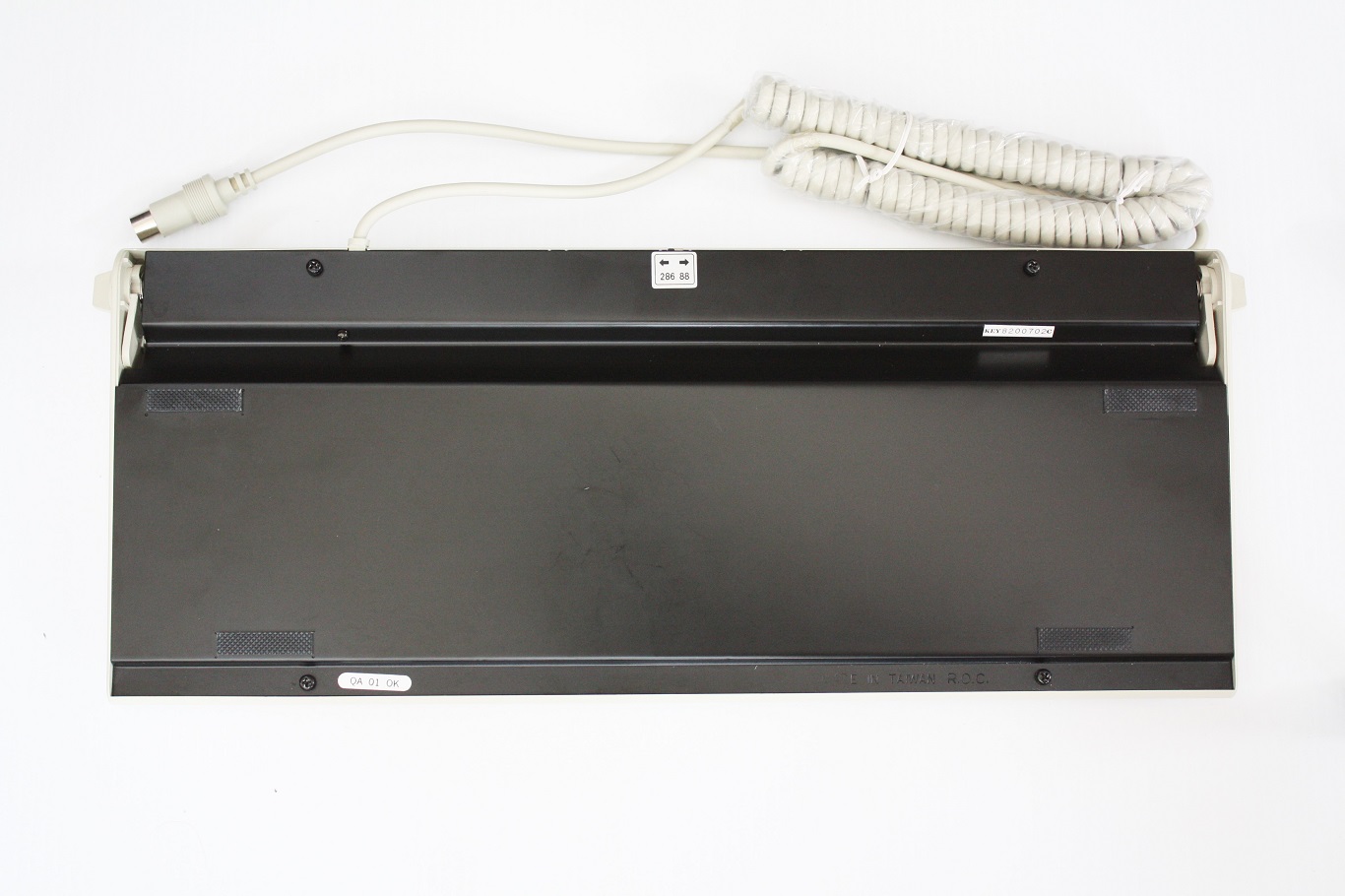

Computerland Blue Alps - back of keyboard
Computerland Blue Alps - back of keyboard.JPG (215.79 KiB) Viewed 6772 times

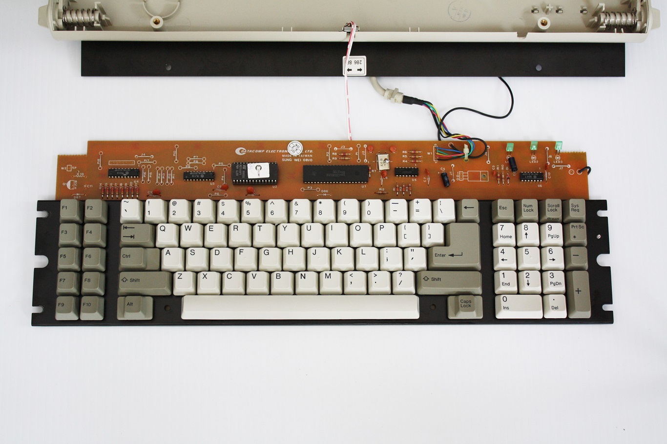

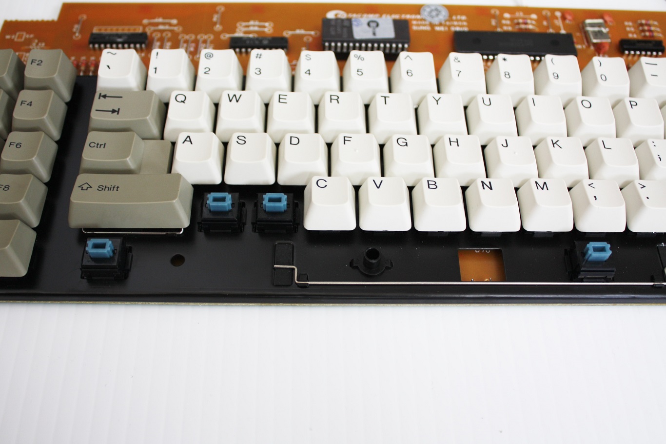

Computerland Blue Alps - keyboard mechanism front
Computerland Blue Alps - keyboard mechanism front.JPG (293.18 KiB) Viewed 6772 times
Computerland Blue Alps - front key caps removed
Computerland Blue Alps - front key caps removed.JPG (255.44 KiB) Viewed 6772 times

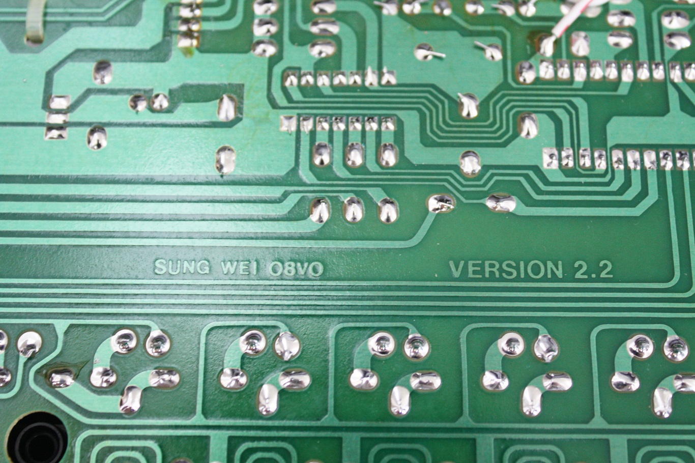

Computerland Blue Alps - Sung Wei Version 2.2 back markings
Computerland Blue Alps - Sung Wei Version 2.2 back markings.JPG (446.41 KiB) Viewed 6772 times

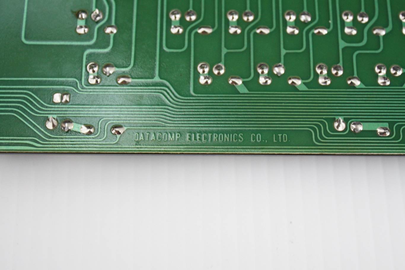

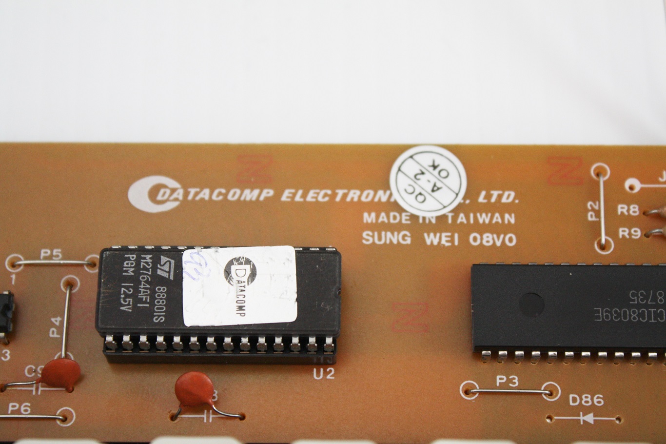

Computerland Blue Alps - Datacomp back markings
Computerland Blue Alps - Datacomp back markings.JPG (306.54 KiB) Viewed 6772 times

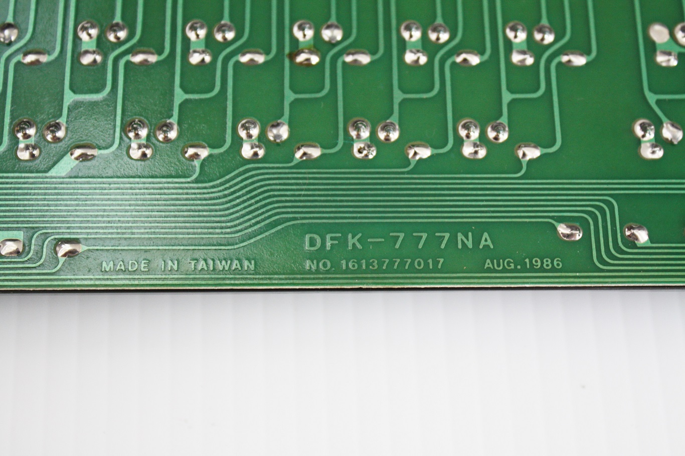

Computerland Blue Alps - DFK-777NA August 1986 back markings
Computerland Blue Alps - DFK-777NA August 1986 back markings.JPG (350.37 KiB) Viewed 6772 times

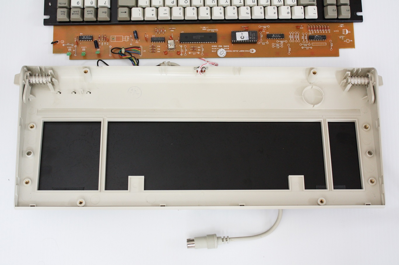

Computerland Blue Alps - interior of case front
Computerland Blue Alps - interior of case front.JPG (269.59 KiB) Viewed 6772 times

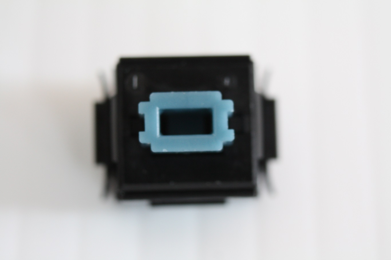

Computerland Blue Alps - front of key switch
Computerland Blue Alps - front of key switch.JPG (121.02 KiB) Viewed 6772 times

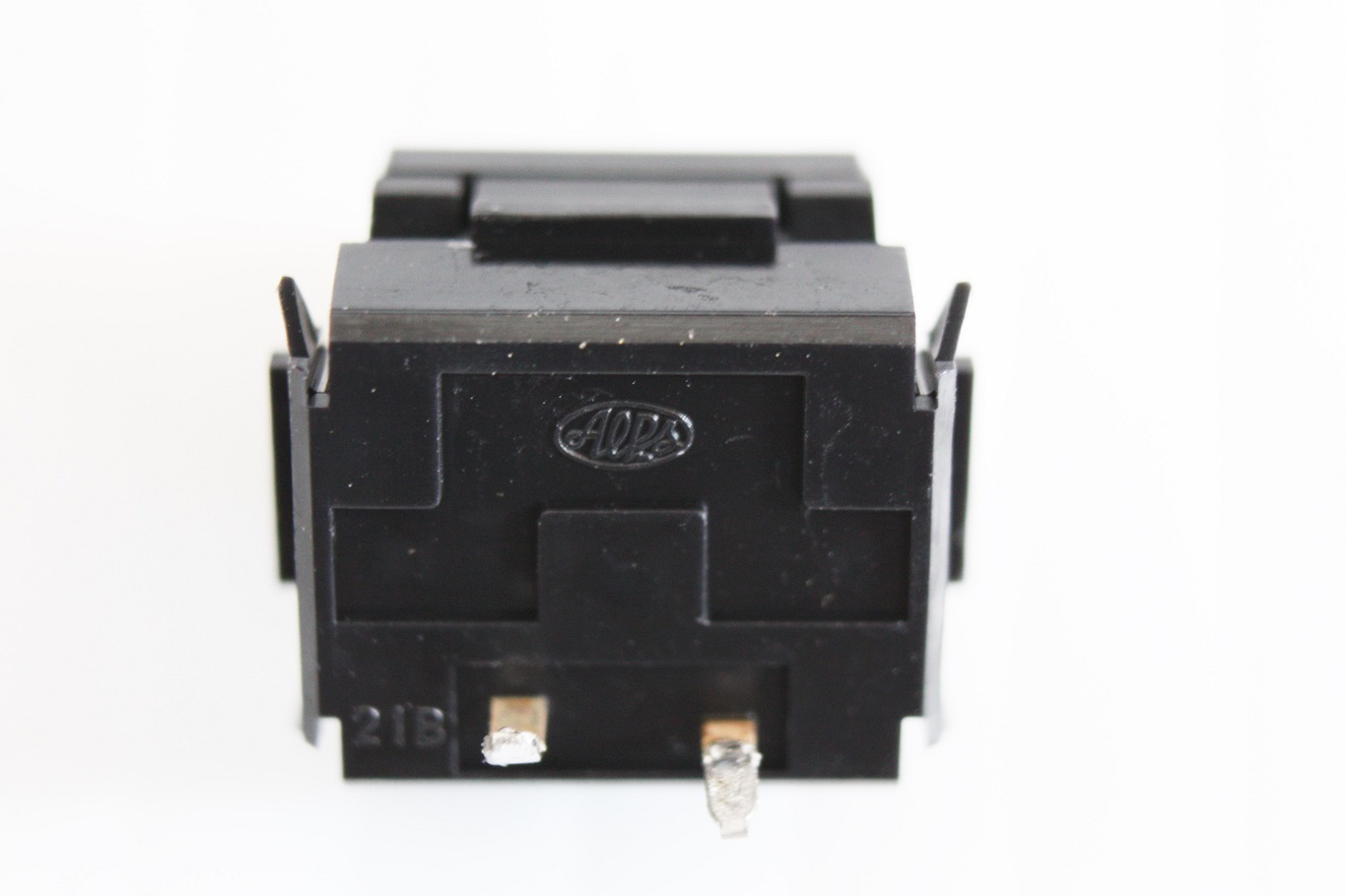

Computerland Blue Alps - back of key switch
Computerland Blue Alps - back of key switch.JPG (159.12 KiB) Viewed 6772 times

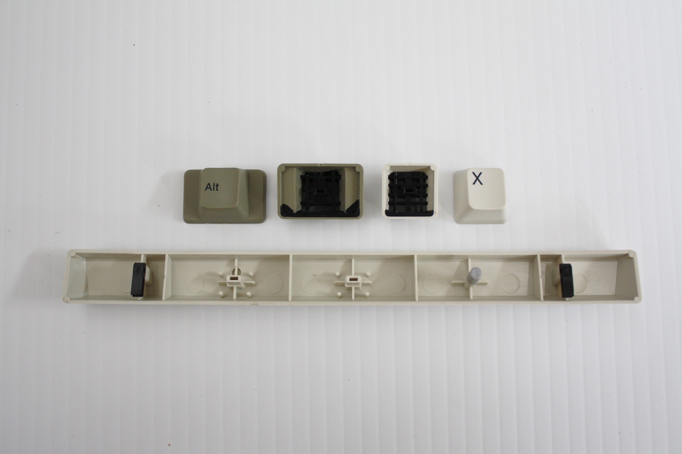

Computerland Blue Alps - key caps
Computerland Blue Alps - key caps.JPG (168.82 KiB) Viewed 6772 times

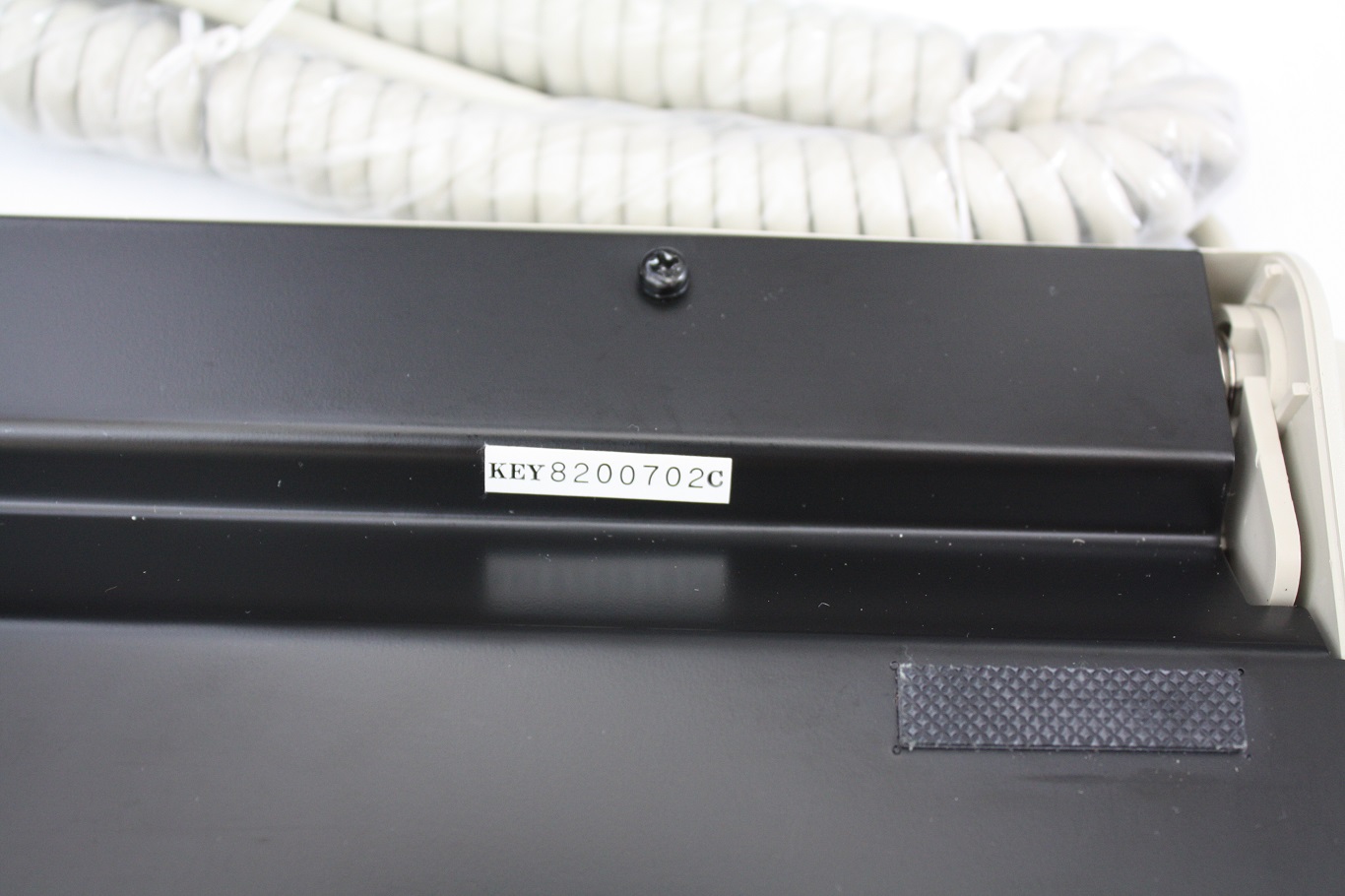

Computerland Blue Alps - back metal plate markings
Computerland Blue Alps - back metal plate markings.JPG (225.43 KiB) Viewed 6772 times

Rimrul
29 Jul 2016, 19:54
Oh. Now I understand the purpose of the Model F "ears" and feel slightly stupid.
