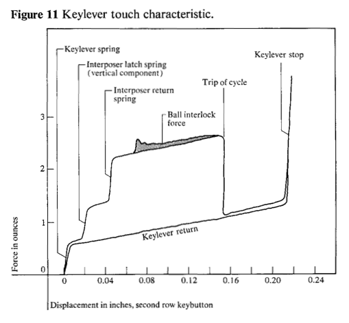

3. Does anyone have definitive numbers on the force/travel/actuation point of an IBM Selectric? I've heard 30g / 6mm / ???, but I'd like to ask you folks.

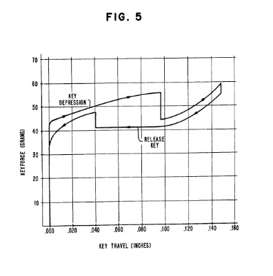

The much loved IBM Beam spring switch starts at 45g and has a very low slope until actuation where force drops considerably but where the slope after the actuation point is very steep.

3: I found this force graph of the Selectric on my harddrive. Not sure what it comes from, but it does not look very smooth.

5. Could get stuck below the tactile peak. I'm a fan of heavy switches, so that's rarely a problem for me. Findecanor's diagramms remind me of those ballpoint pens where a little pin glides down a tactile shape on the way down when you press the button, locks in place and takes a linear path back up. That mechanic without the locking could eliminate this problem, but probably isn't applicable to keyswitches.
