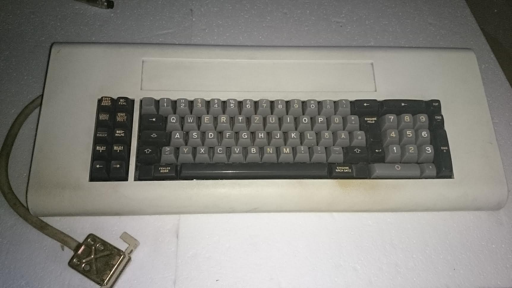

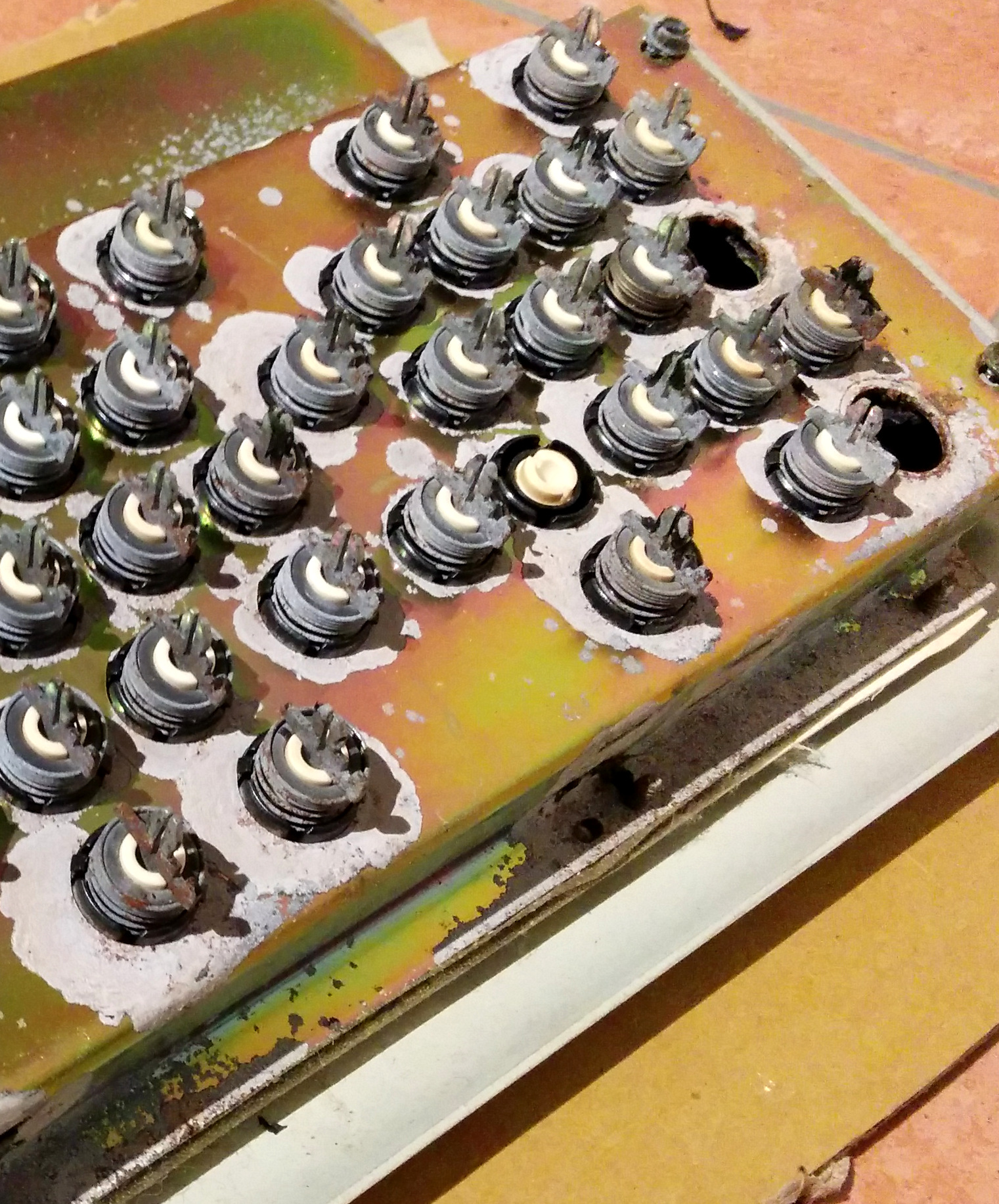

So I got an IBM 5251 from the infamous rust merchant and it was in pretty poor shape overal. The shell has taken a beating, note the yellow patch at the top left where they've completely removed the painted textured upper layer. The spacebar was rusted in the down postion and wouldn't budge. Keycaps were very dirty indeed, but inspired some hope as most were not yellowed and the only ones that show actual signs of use were the numpad ones !

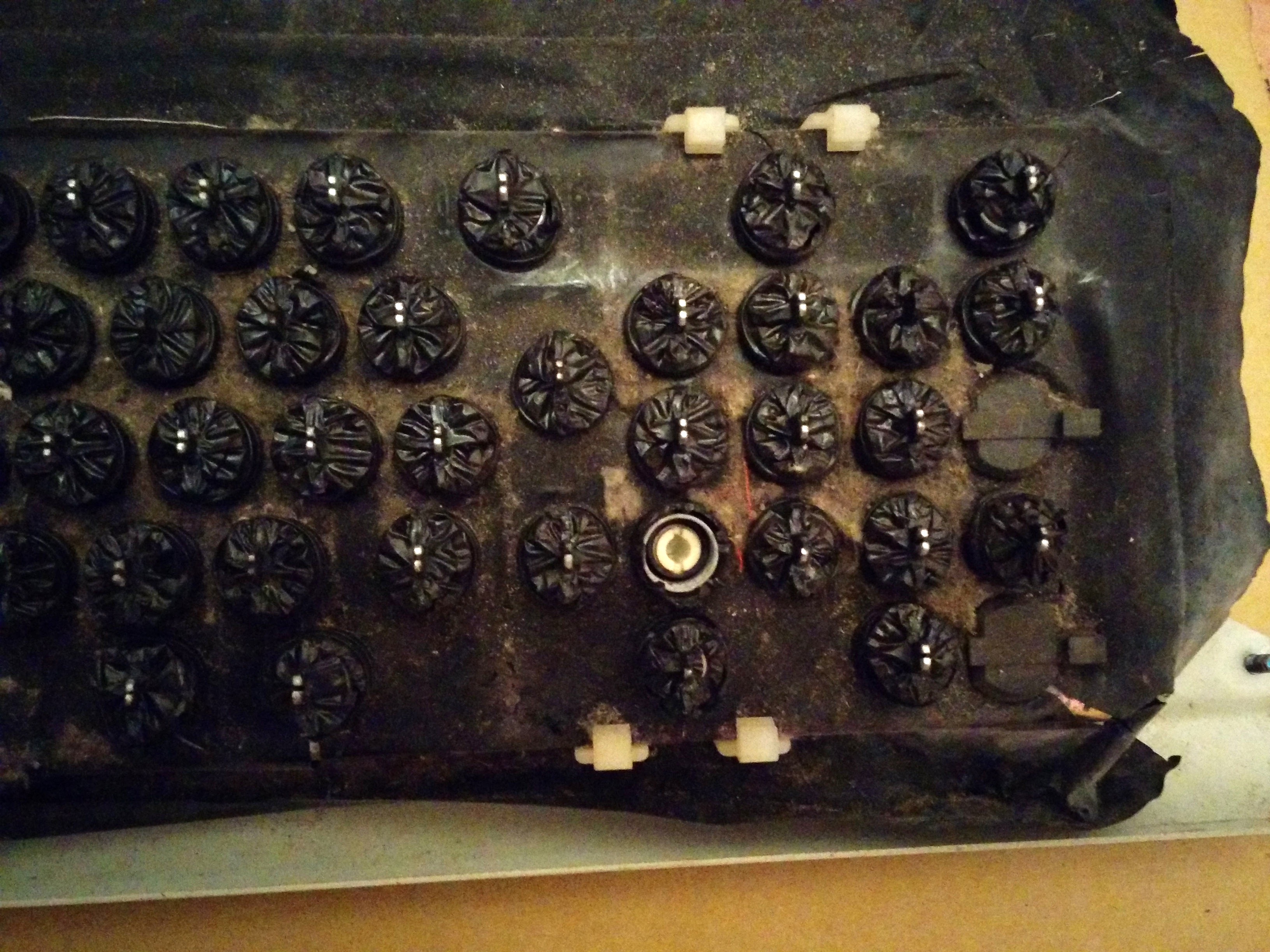

The underside is completely rusted as well, the rubber shock guard between the switches and the plate is disgusting and disintegrates when handled. Switches are surprisingly OK, but a bit scratchy from particulate that got in there.
Some ID on the back of the sense plate assembly. German board, made in Amsterdam ?
After sanding the plate it still shows signs of discolouration. I wanted to go to a raw steel look, but decided I would paint it because I just couldn't get rid of the color difference with the tools I have.
Using a steel punch to make a new rubber mat for the back of the plate. Tiresome but necessary because otherwise the switches were too loose.

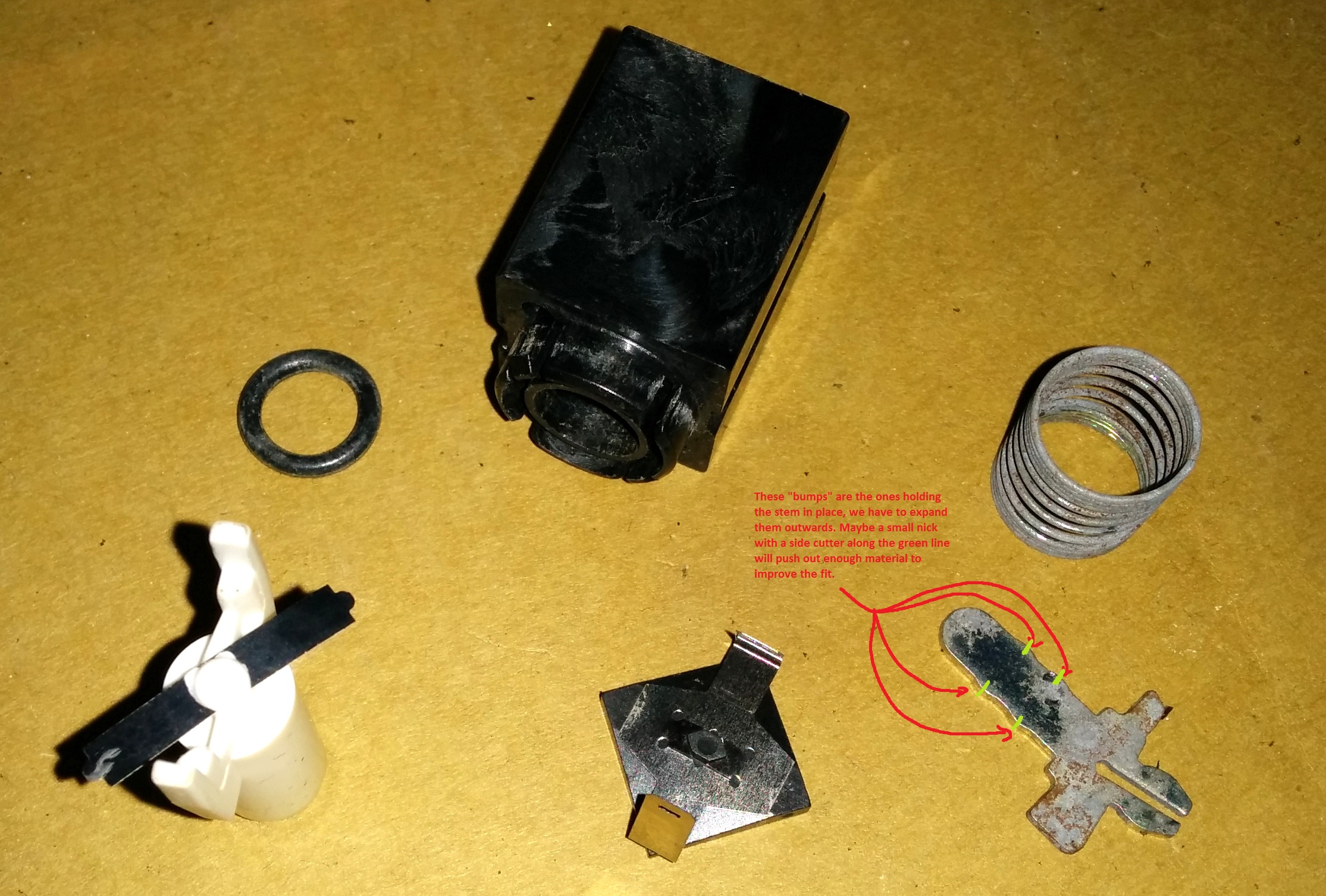

Disassembled all the switches to clean them. The metal stems and springs were given a vinegar bath to clean off the rust. The plastic housing just cleaned out with soapy water and the plastic stems gently wiped down with antistatic cleaner.
Before and after example of a switch

Reassembled it can now be used, but it's still ugly with it's busted case :( Planck for scale 8-)

when pulling Beamspring keycaps from stems that are in bad shape the metal stem can come off the plastic stem, this is very fixable but one then needs to improvise. I'm sure many of you have noticed that the Beamspring switch has quite a bit of wobble / play on the keycap when normally mounted, that is simply due to the design of the switch itself IMO which is quite elaborate in design and susceptible to not only dirt but also wear. Ever seen another keyswitch design where they thought they needed a contamination shield?

I used 2mm craft foam which is what I had readily available and that has done the trick. It's just the right thickness that it needs to compress slightly and keeps the switches stable. I think I saw someone used neoprene in another thread.
To disassemble the switches I pulled the metal stem with some pliers straight up. I tried a couple first as an experiment and when I was satisfied that it hadn't caused permanent damage did the rest. When pushing the metal stems back in it was pretty obvious when it hit the bumps internally that keep it in place. I've since pulled some keycaps and the switches are as sturdy as they were before. Even so, IBM never probably intended for people to do this so be careful always.

I said I was sorry for spamming your thread, I'm sure terrycherry would never do that! Not that it really matters. I need to get some of that 2mm craft foam. The thing with some of my stems is the metal degraded over years. This is a weakpoint of the entire switch design and I'm pretty sure IBM did not plan on people using these keyboards 30-40 years later. Interesting that my 5251 has that same "Amsterdam" sticker.
