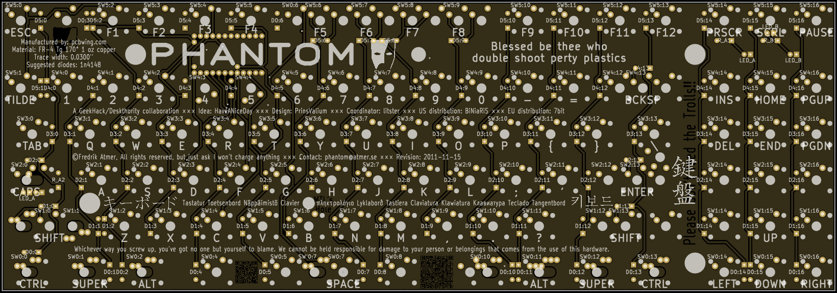

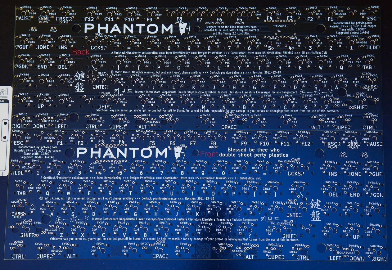

PrinsValium has designed a PCB with a programmable controller and a mounting plate that will fit inside a regular Filco tenkeyless keyboard case, which will enable every Filco tenkeyless user to use a full set of good old Cherry keycaps, including Cherry’s original 1.5x wide Ctrl and Alt keys. Detail technical discussion is here.
Latest PCB design:
Phantom PCB-Small.jpg (732.46 KiB) Viewed 31954 times
Other unique features of this design:
-There are 4 extra holes on the PCB for each switch that should provide each stem/spring replacement without desoldering the switch from the PCB and metal plate.
- per 7bit’s request, you could do something crazy like this for the front row:
HaveANiceDay started the project originally with PrinsValium, and we are carrying it forward. Here is HaveANiceDay’s original post:

What will the PCB look like?
It will have an awesome black finish on both sides with white silkscreen markings for easier switch mounting. The Phantom logo and text will be embedded on the copper layer like on the Filco gen2.

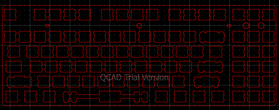

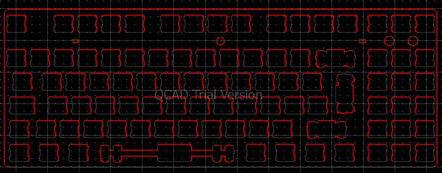

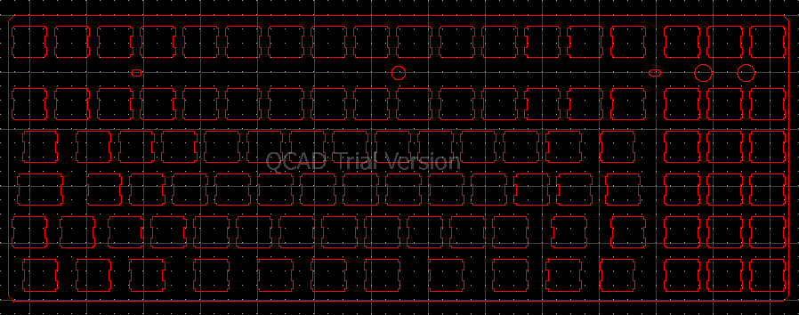

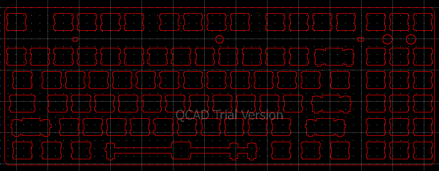

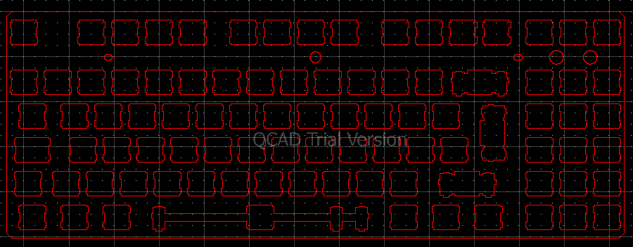

Layout Examples for the different plates.
ANSI layout with Cherry 1.5x wide modifiers (There should be a 1x key on both sides between the Ctrl key and the Alt key):
ANSI layout with 1.25x wide modifiers (E.g. modern layout like Filco):
ISO layout with Cherry 1.5x wide modifiers:
ISO layout with 1.25x wide modifiers (E.g. modern layout like Filco):

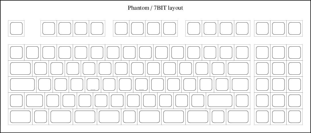

7bit's Special:
Here are the 5 plates we have available in this group buy:

02 Nov 2011, 10:50
sixty wrote:ANSI only! Screw ISO for me :D
Also for space row: [1.5][1.0][1.5][7.0][1.5][1.0][1.5]
you have this right?

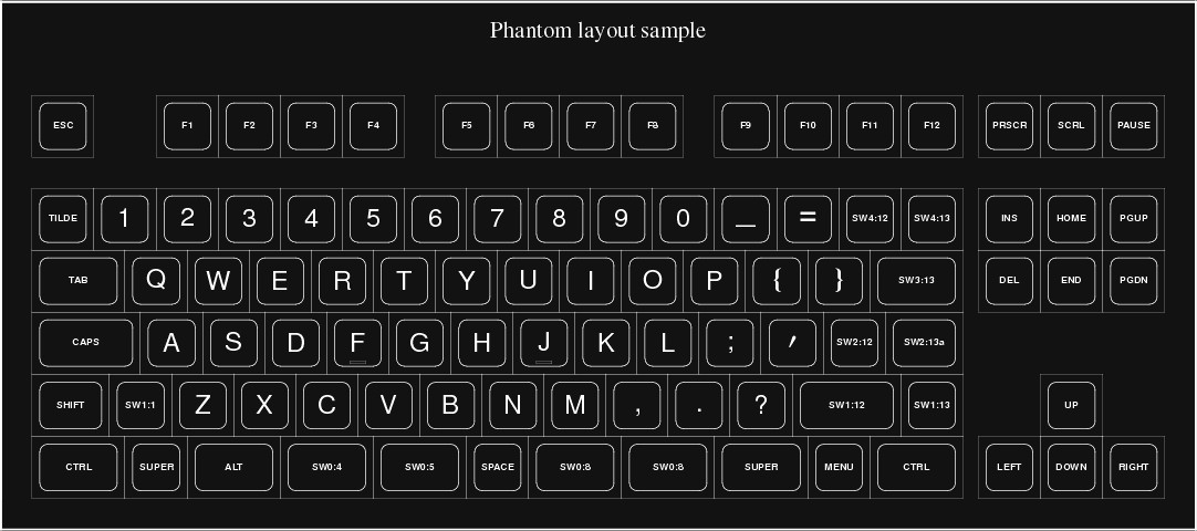

ANSI, ISO, 7BIT - anything is possible;-)
The bottom row works with the following key-sizes:
[1.5][1.0][1.5][7.0][1.5][1.0][1.5] :cool:
(This was the original plan.)
[1.25][1.25][1.25][6.25][1.25][1.25][1.25][1.25] :geek:
(Someone let PrinsValium mess it up a bit to make sure a 'modern' layout is possible.)
[1.5][1.0][1.5][1.5][1.5][1][1.5][1.5][1.5][1.0][1.5] :ugeek:
(Someone else forced PrinsValium into messing up the design much further to maximise the number of keys and avoid any need of stabilisers.)
I will post some layout samples ...

Questions:
-is it possible to make a plate that is ISO and ANSI compatible
-what controler will be used
PS: Ansi with 1.0 winkeys is missing
02 Nov 2011, 12:31
mintberryminuscrunch wrote:Questions:
I think the ISO-enter-switch will cause a bit of trouble.

I noticed that you use a Teensy 2.0 for the controller. Can you exclude this from my order to reduce cost?
H-shaped plate holes! Awesome!

I want [1.5][1.0][1.5][7.0][1.5][1.0][1.5] bottom row but I see the first picture is without the 1 sized keys.
