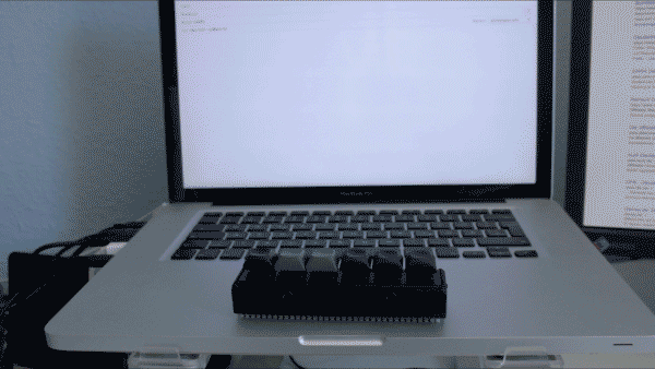

Oh and I figured out a pretty smart way to use this 10% as a fullsize keyboard. Here you can see me writing an email.
