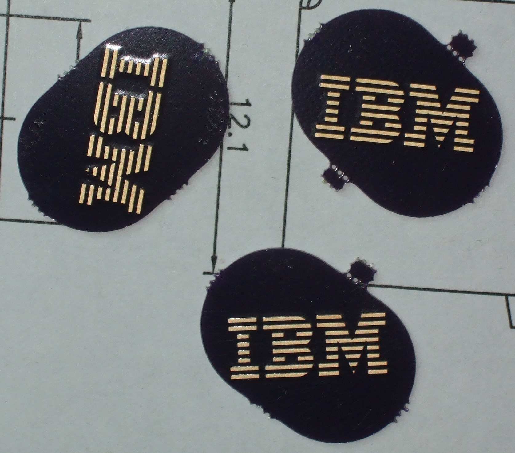

I posted this idea a while back in i$'s FSSK thread - a replacement badge made from a PCB.
OshPark has a unique price structure - you get 3 copies of your design for $5 per square inch including ENIG (gold) finish and delivery. This price structure makes OshPark attractive for very small runs of very small PCBs. My test run came out to $3.65. On the minus side, they use break-away tabs instead of routing the full perimeter of the boards. These need to be cleaned up with a Dremel, but i think the idea is pretty good. Full routing would have made them perfect. HASL finish would have made the text silver. I'll take more picture is you guys like it.

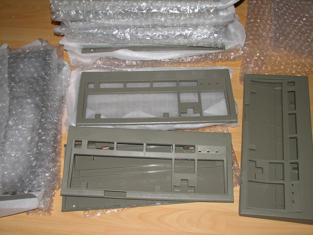

Well I got something here that IS SCREAMING for one of these...PM'd !

I'll publish the files here after i test the fit. This is the 101 size - the SSK size will still need to be drawn up. It would be easy to do square badges and custom badges too. If you are looking for something special, shoot me a PM.
My skills are in drafting, so would suggest that someone volunteer to run any group buy. Or you could just order 3 from OshPark - but think that the edge quality would be better from another fab (sorry OshPark).
For anyone thinking about running a group buy, these are 0.8mm PCB; thinner PCB (0.4 or 0.6 mm) would probably look better for the thin oval badges. With any fab that is not OshPark, you will find that there is not much difference in price between ordering 10 and ordering 50 - so your cost per badge will go down quickly as you order more.

I had time to dig out my Dremel and i cleaned up the edges some. Here are some quick pictures.
The zip file below is what i sent to OshPark. If you send them this same file, you will get a couple of warnings that the there is no drill file, bottom mask, bottom copper, silkscreen - this is normal as this doesn't have any of those things; check the box that says "continue anyway". When you get to the "Cart", check the option for "2 oz copper, 0.8mm thickness". The text will be gold and the mask will be dark purple - same as in these pictures. The price it shows is the price delivered. Mine arrived about 3 weeks after i placed the order, but i have heard that international delivery can add a few additional weeks.
If you order from another vendor, delivery will likely be quicker (even coming from China) and edge quality will likely be much better. You also have options for PCB thickness (.06 would be a good option), mask color (lots), and text color (HASL for silver, ENIG for gold).
Now the question is ... what to use to stick it on the case?

seebart wrote: Well I got something here that IS SCREAMING for one of these...PM'd !
Just seen this now. Where did all those M(13) cases come from? :o
25 May 2016, 19:26
That picture is from webwit's The Wild Duck Exotics Boutique sale, I bought one of those.
