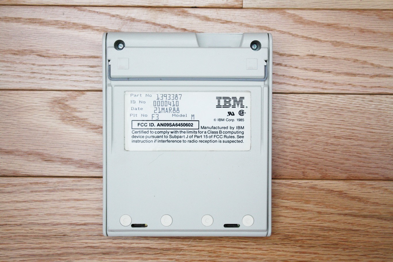

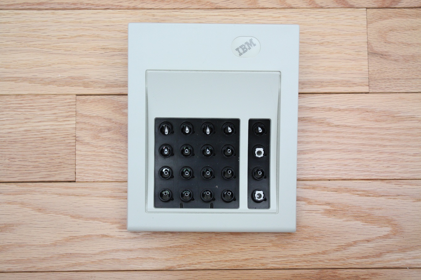

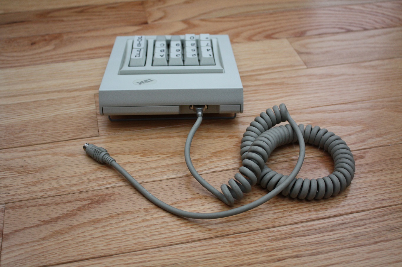

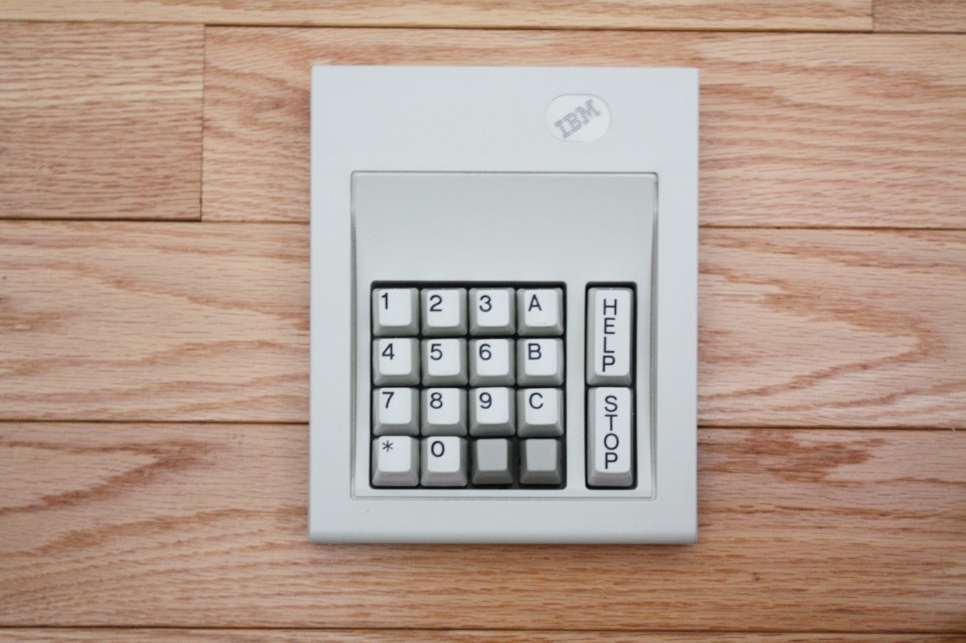

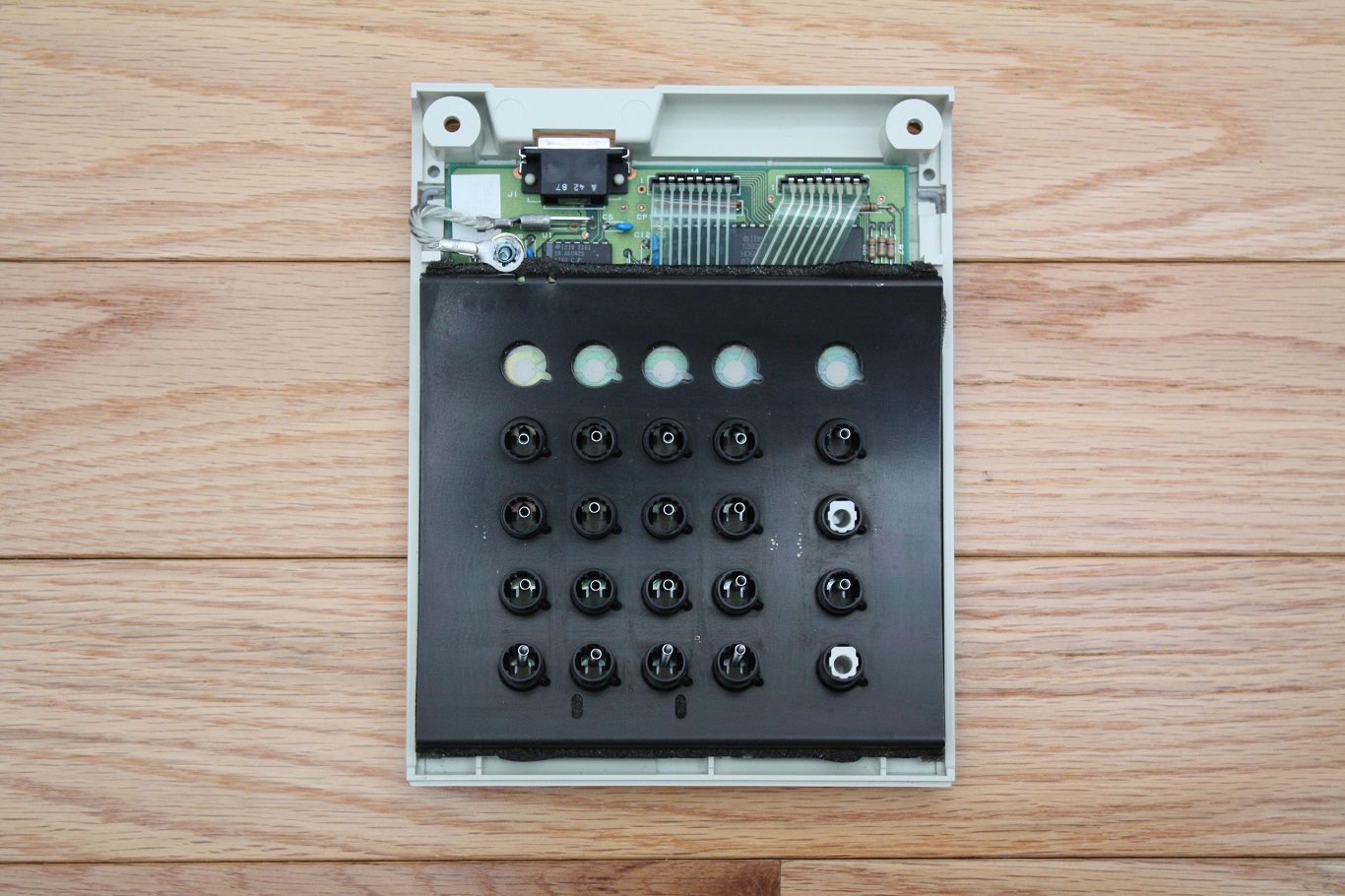

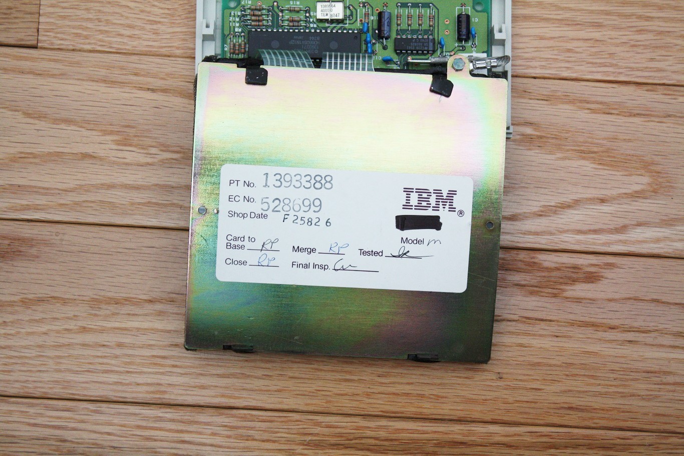

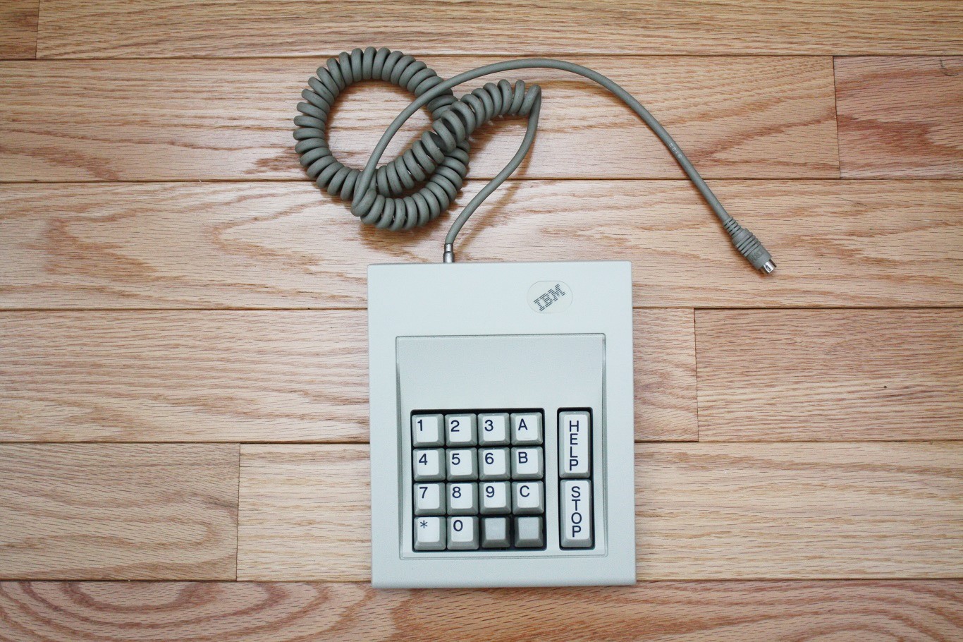

Some of you may have seen an IBM OS/2 screen reader keypad on eBay recently at a pretty high price. Well, I couldn't let it go and worked out a price for it that was reasonable given that shipping was included and there were no duties. Below are some pictures of the IBM screen reader keypad. Yes, there are two key caps missing and I'm not sure if I can ever find them or have them reproduced. If anyone knows, please send me a PM. There is a "D" and a "#" missing.
You will notice the back label is marked "Model M" but it sure looks like a Model F to me. I could tell by opening it up but I've done that before with other Model F's and it is not easy to get the back panel back in place sometimes so I will leave it as is. It does have a couple of classic Model F construction features. For one, the barrels are removable. You can see by the absent top level of keys that they have a stop in them as well so that the barrels won't spin. Also, the back plate is solid and slides into place like a Model F as opposed to the plastic rivets normally seen on Model Ms. However, there is a plastic membrane as opposed to a capacitive plate as seen through the absent keys as well. Am I correct in believing this is a hybrid Model M/F?
I added the SDL cable from a Model M keyboard but I forgot my PS/2 to USB converter at work. I'll have to try it out tomorrow and see if it works as normal with the keys being displayed as marked.
Here are some pics:

IBM Screen Reader Pad - back
IBM Screen Reader Pad - back.JPG (342.4 KiB) Viewed 4186 times
IBM Screen Reader Pad - key caps removed
IBM Screen Reader Pad - key caps removed.JPG (369.72 KiB) Viewed 4186 times
IBM Screen Reader Pad - complete key pad
IBM Screen Reader Pad - complete key pad.JPG (409.44 KiB) Viewed 4186 times
IBM Screen Reader Pad - SDL cable plugged in
IBM Screen Reader Pad - SDL cable plugged in.JPG (372.99 KiB) Viewed 4186 times

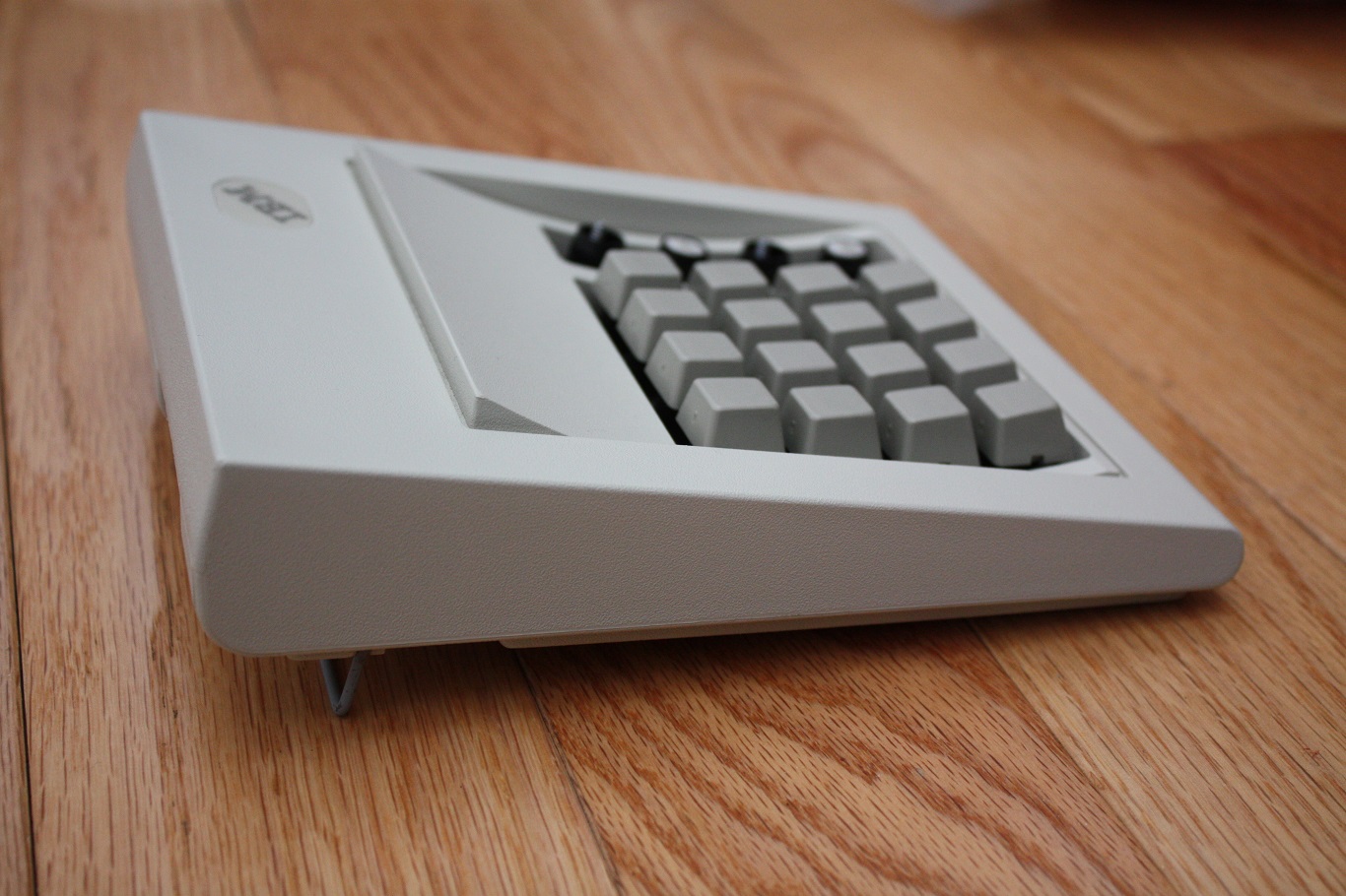

IBM Screen Reader Pad - side profile with stand
IBM Screen Reader Pad - side profile with stand.JPG (334.52 KiB) Viewed 4186 times
IBM Screen Reader Pad - membrane exposed through absent keys
IBM Screen Reader Pad - membrane exposed through absent keys.JPG (385.53 KiB) Viewed 4186 times

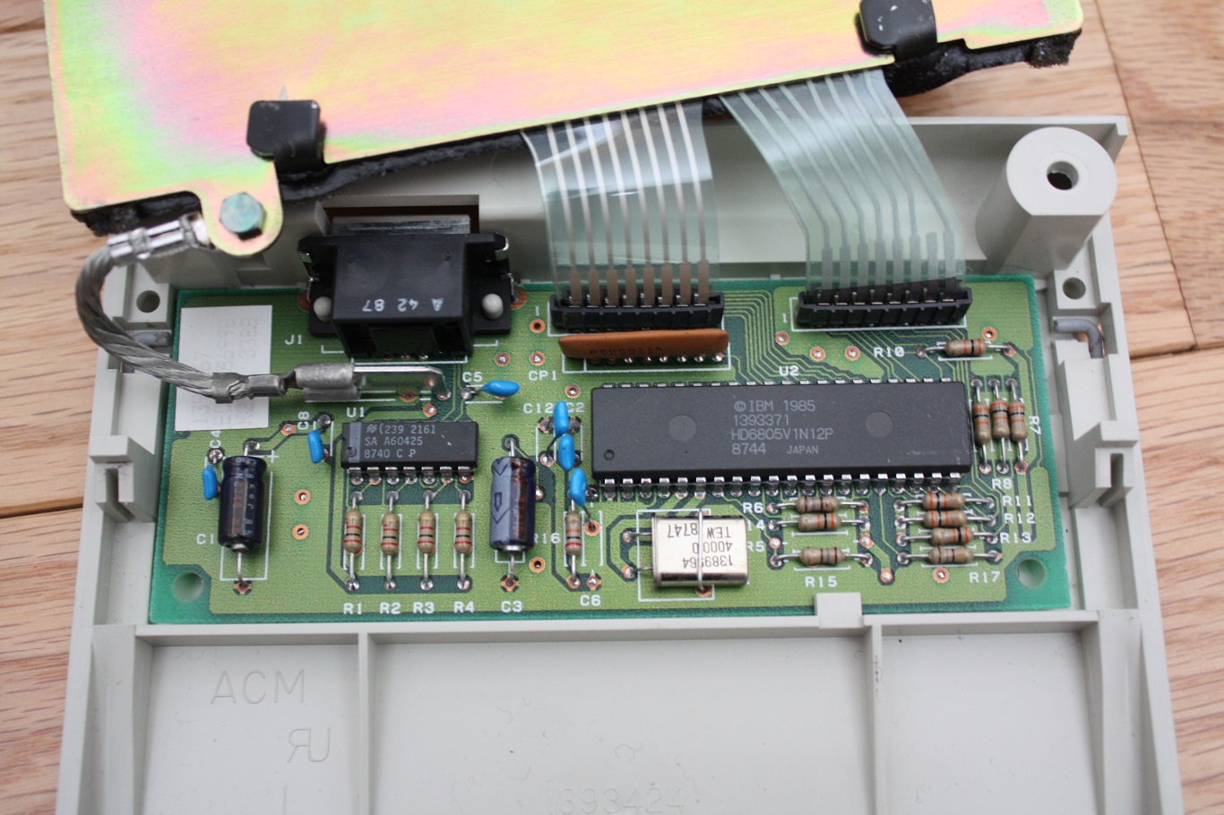

IBM Screen Reader Pad - PCB board ICs marked late 1987
IBM Screen Reader Pad - PCB board ICs marked late 1987.JPG (363.22 KiB) Viewed 4186 times
IBM Screen Reader Pad - back plate identification label
IBM Screen Reader Pad - back plate identification label.JPG (370.73 KiB) Viewed 4186 times

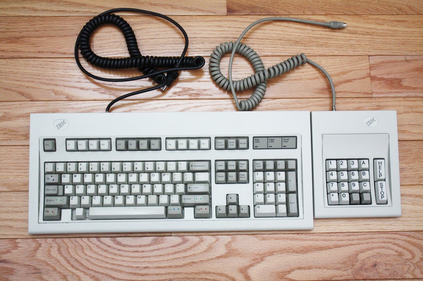

IBM Screen Reader Pad - next to normal Model M for size comparison
IBM Screen Reader Pad - next to normal Model M.JPG (369.27 KiB) Viewed 4186 times

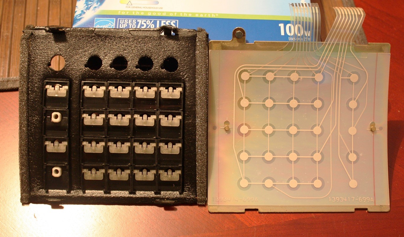

Turns out you are correct about the paddles, emdude. I couldn't take the suspense and opened it up...
IBM Screen Reader Pad - odd mix of Model F plates and Model M paddles and membrane
IBM Screen Reader Pad - odd mix of Model F plates and Model M paddles and membrane.JPG (347.55 KiB) Viewed 4114 times
The sound, however, is much crisper, the feel is heavier. I think I use the word "crisper" because there is no rattle or reverberation when the sporing buckles; probably because of the foam sound deadening. If you think about it, the use of this was as a screen reader for the blind. Avoiding added noise would be pretty important. Maybe that explains the construction? This is just a total guess.
