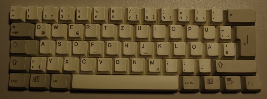

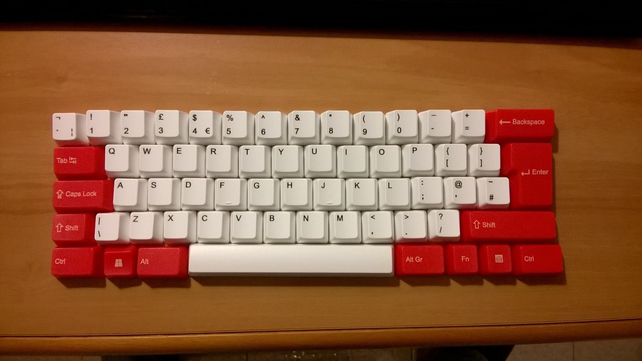

It's just the size I ordered, within a bottom layout of 1.5u - 1u - 1.5u - 6u - 1.5u - 1u - 1u - 1.5u
I'm argueing with the vendor from 10 days now, because they sent me the wrong sized bar.
The post sales support writes things like: "On the keyboard, there is gap between each keycap, 6.0 spacebar is equal to 6 of 1u keycaps plus total gaps dimension. "
I'm getting angry, but trying to stay onto politeness rails. :)

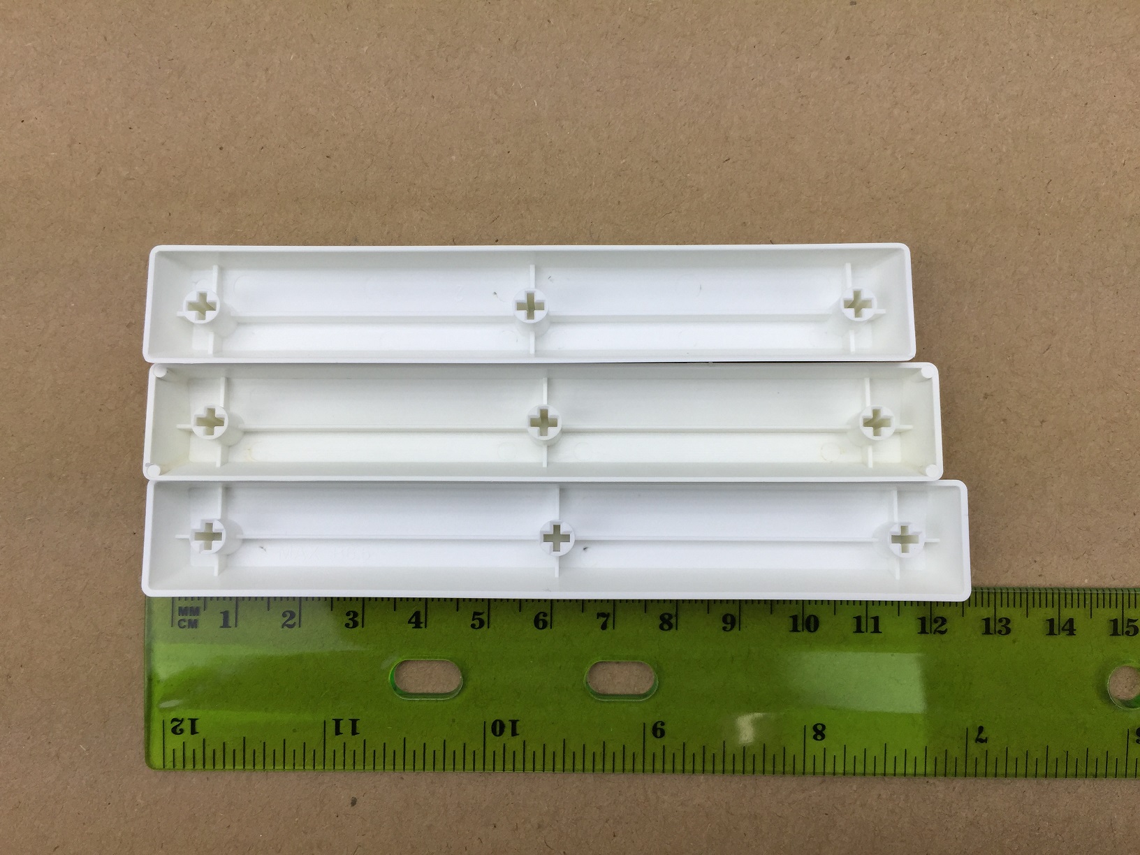

In last reply to their support, I attached these pictures, hoping they'll stop kidding me.

Anyway, this is the layout I designed with the awesome Keyboard Layout Editor tool.
I know, the pageup-down keys are in the wrong row, but I have two blank caps to customise and place there.

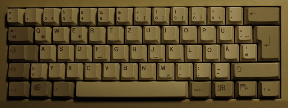

Here's mine:
Not a great picture, i need to reshoot it and document my mods properly some day. Note the arrow keys, the ANSI layout, and the detachable USB cable at the top! There's a lot of life left in a good AT. Plenty of new tricks.

I'm not as sure as all the others in this thread, because it's true that there are gaps between caps on a keyboard that add up.
However, it`s pretty easy to find out: One unit (dinstance between centers of 1u caps) is 0.75'' or 19.05mm, so a 6 u bar is 4.5'' long or 11,43mm, minus one gapsize. If yours is any longer than 11,43mm, it's a 6.25u space bar. If it's shorter, the seller is right.

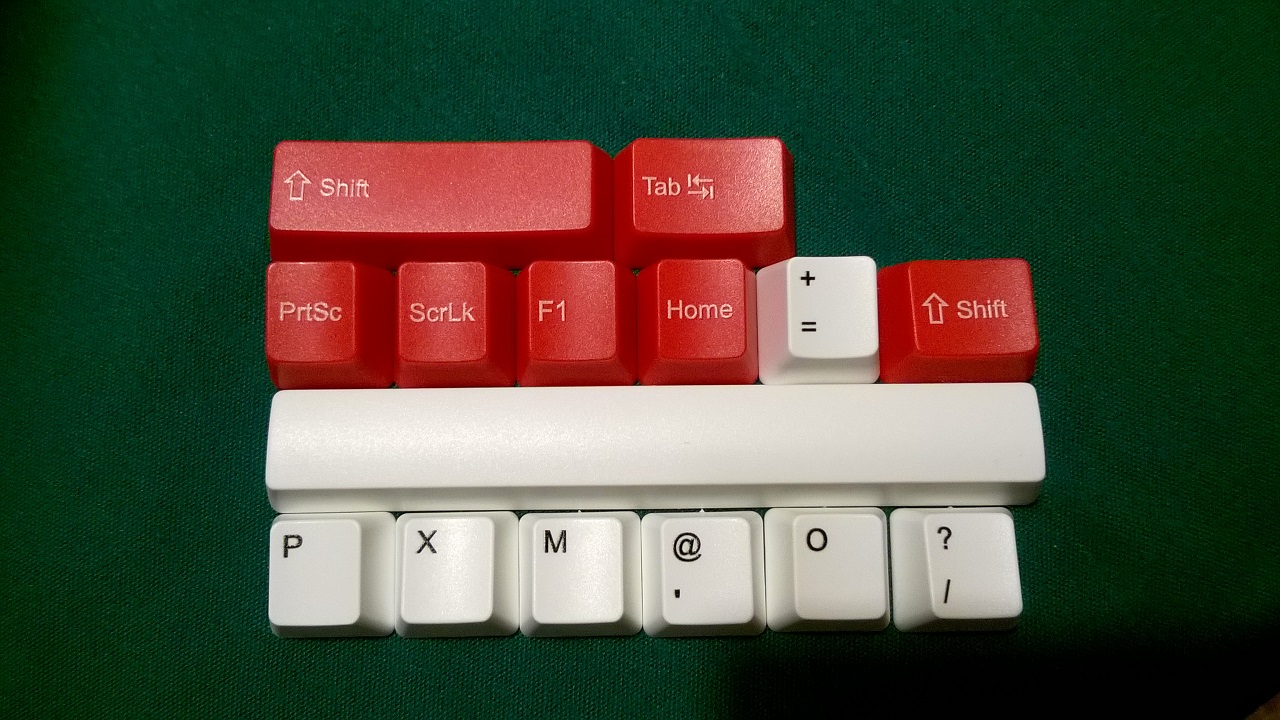

There are gaps, but wouldn't all those 1u gaps make this picture impossible for a true 6.0 unit spacebar?
The seller sounds like a chancer. The only way to deal with them is with firm, uncertainty-free, facts. Such as the direct measurement you mention. It'll be 6.25 units, or all those alphas are mysteriously small!

Looks like 6.0u, if you space out the 1u keycaps properly. Why don't you just put it on the board you intended to buy them for?

The layout spacing isn't part of the sum. Do We refer to keycaps units of measurements, or to their clearance inside a keyboard layout?
Please, let me understand why this theory only applies to the bottom row, while all the others align perfectly.

No, you've got it. I'm not sure why these fellas are being wrong. But I do understand your seller: they're trying to rip you off.

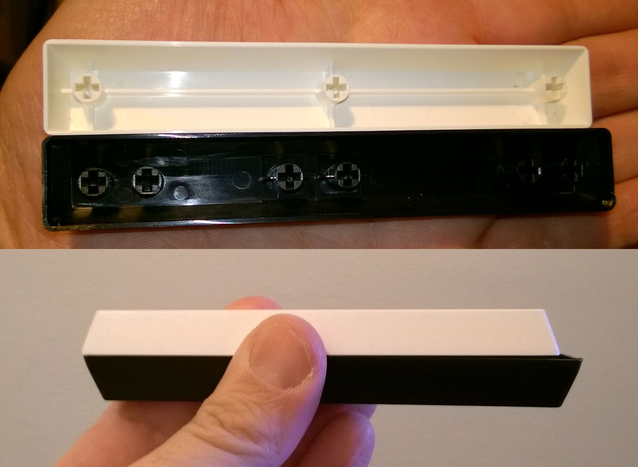

They sent these pictures, that show up an unexpected stems position for their (so-called) 6u spacebar.
I'm feeling like they're trying to save the shipment costs to repair their mistake.
Otherwise they actually do *not* manufacture a real 6u spacebar.

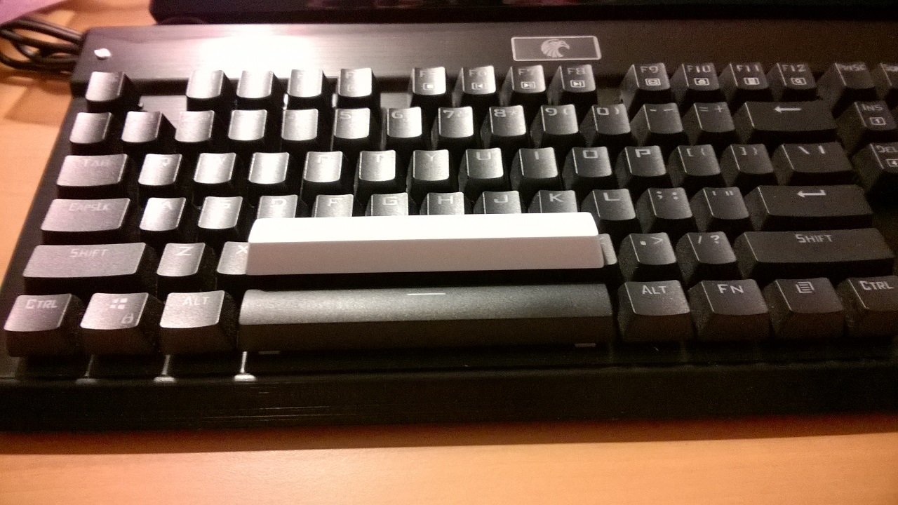

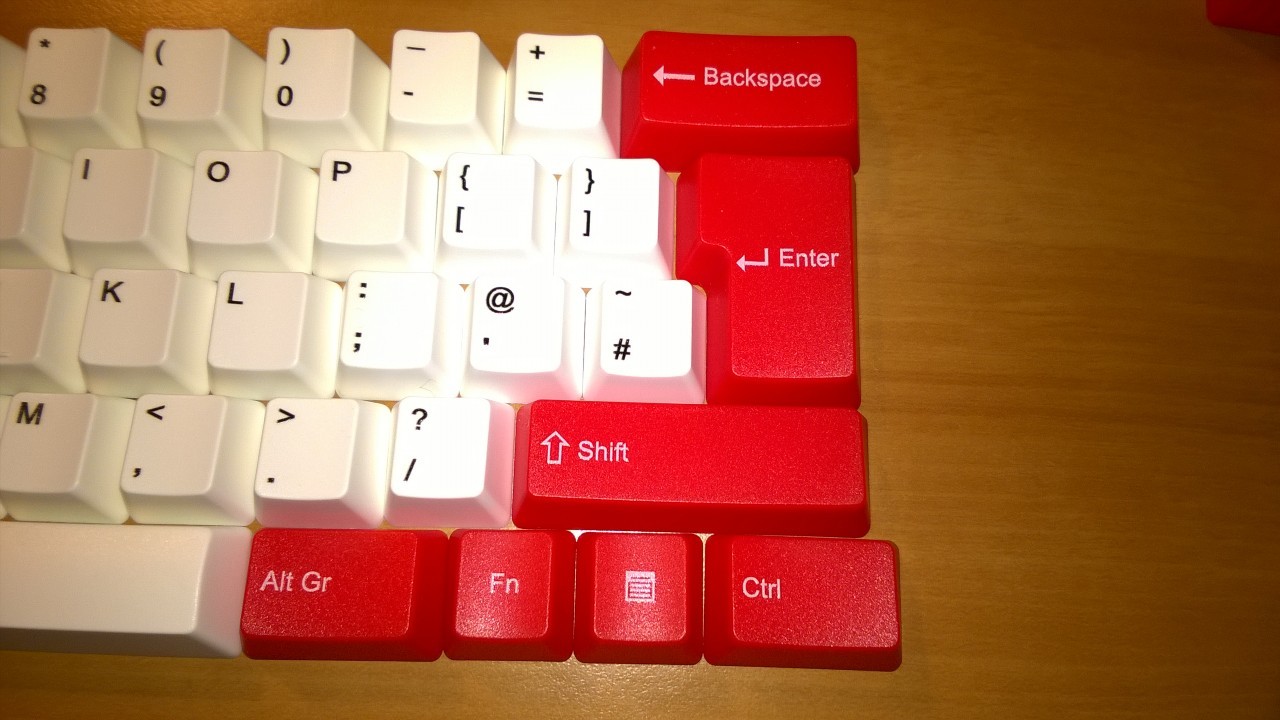

And this is their "6u" spacebar, perfectly aligned (strange) with the standard bottom row (6.25u spacebar) of my E-Element RGB keyboard:
I said everything. :)

Talk. ;) Did you measure yours?
The white spacebar on the last picture is clearly shorter than the black one underneath it on the board. If this is the one they sent you, that's clearly a 6u space bar. Compare the lengths of the bottom sides. Compare by putting them next to each other, not above each other.

Perspective, my friend. :)
You can check it by comparing the alphas in the upper rows, progressively less wide than the lower ones.

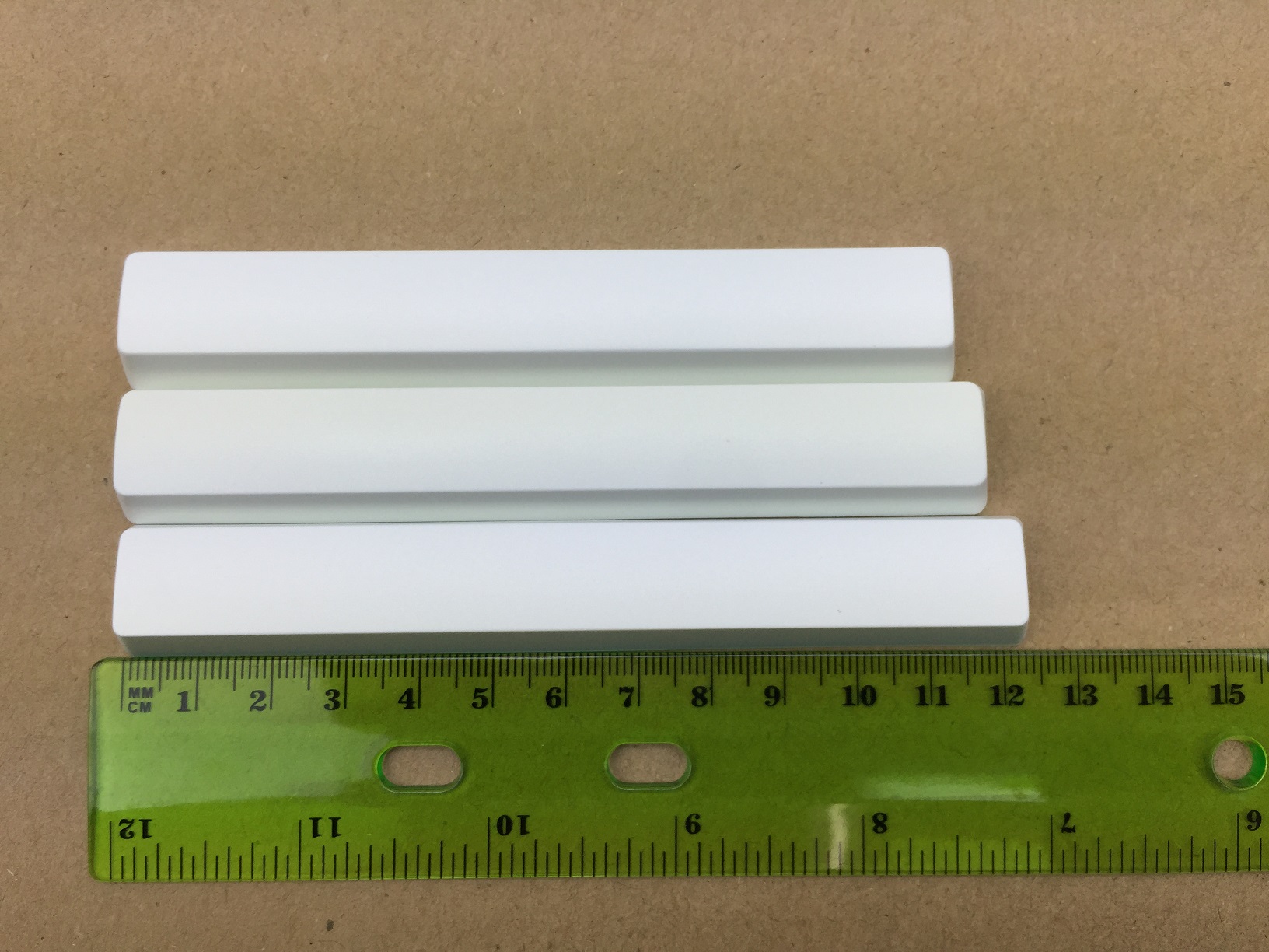

I haven't the spacebar with me right now, but I'm going to measure it as soon as possible, because it seems the only way to prove I'm not in error.
And I'm going to remove the E-Element standard spacebar too, to make a clearer comparison.

Corummo wrote: The layout spacing isn't part of the sum. Do We refer to keycaps units of measurements, or to their clearance inside a keyboard layout?
1 unit is the distance between the centers of two 1 u keys on a keyboard. Every keycap is 1 gap size smaller than the number of units it takes. A 1 unit cap is 1 gap smaller than 0.75''. A 6 unit space bar is 1 gap smaller than 6 * 0.75''.

The keyboard layout editor is fine, it uses a gap size of 0, which wouldn't work on a keyboard but is the best way to do it on paper. Print out a layout in real size and you'll see that the real caps are a little bit smaller than the caps on paper.

Of course not: the number of gaps differs in the bottom vs. the top row (7 gaps in the bottom row vs. 13 in the top row).
Putting all caps on a table without any gaps equates to eliminating the added width of 13 gaps in the top row, but only 7 gaps in the bottom row.

Edit: sort of ninja'd by Halvar, whose gaps argument is so obvious I wonder it had been doubted at all :mrgreen:
Edit2: on my second pic the space bar looks like 6.5u, but on my first pic it shows its real length of 6.25u.

by OleVoip
The seller's reply is correct.
With a unit length of 19 mm, typical cap widths are 18 mm for a 1-u cap and 113 mm for a 6-u cap.
Thus, a 6-u cap is expected to be 1/4 u wider than the sum of six 1-u caps (but it still is 1 mm narrower than 6 u = 114 mm).
