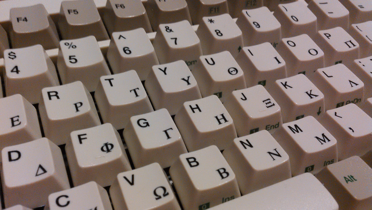

Cosmic Greek keycaps.

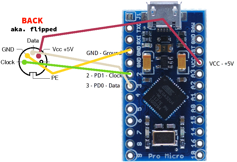

My first mission was to figure out how to solder wires correctly. I made a correct map which is already flipped so you don't have to worry about that at all. I cut my AT cable and took wires from there. If your nails aren't long enough to open clips; just use something that is wooden or soft etc. so you won't make scratches anywhere.

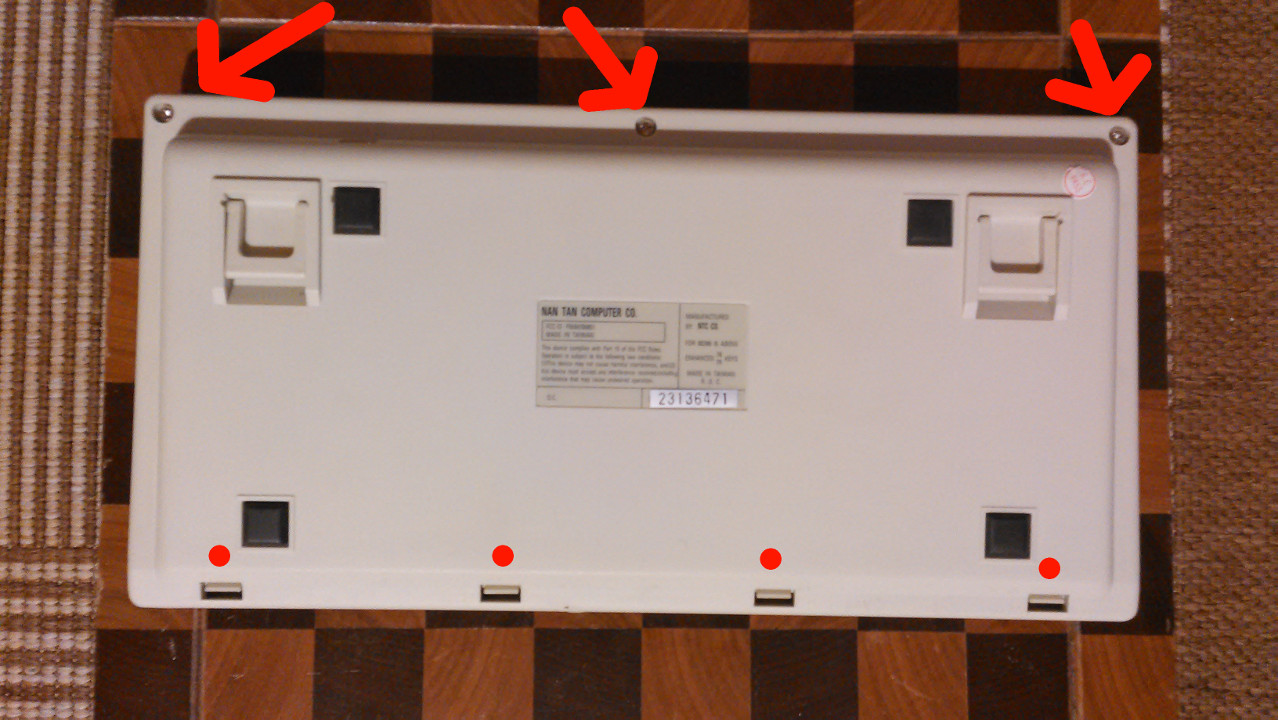

Case was pretty damn easy to open. There are only three screws and four clips to work with. Be sure to keep them in a safe place so you won't cry later on.

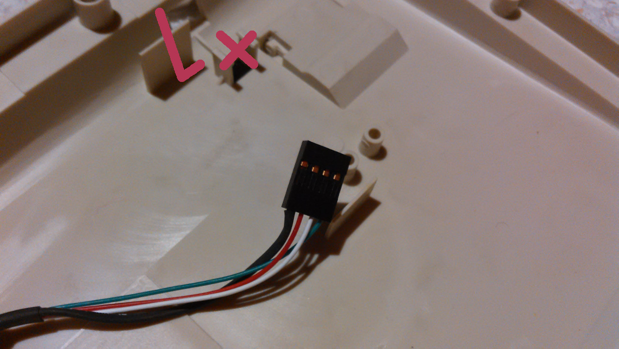

After you've opened the whole thing, you'll just need to take this thing off from PCB and make your dreams come true. Yellow wire is inside of that bulky and black wire. If you want to make room for your controller, you'll have to cut a bit from that clip and cable holder off.
Here I have my cable finished and I was making some adjustments. It's also very important that you won't cut wires too short. It seems to fit there just fine.

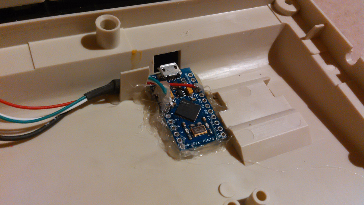

After I soldered things together I placed my Pro Micro on the bottom of the case and I spammed hot glue a lot around and pushed PCB with a tiny force to keep things tight.

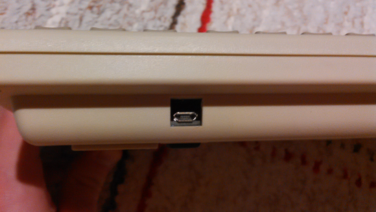

I felt quite happy when I looked how Pro Micro sat down.
