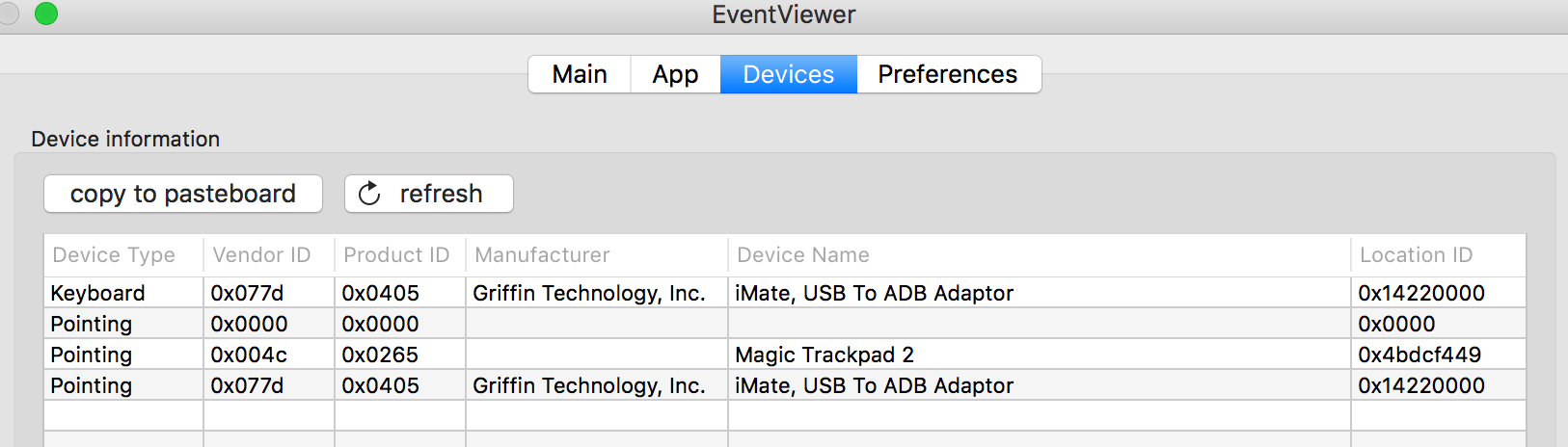

Here are my Devices
[img]
[/img]

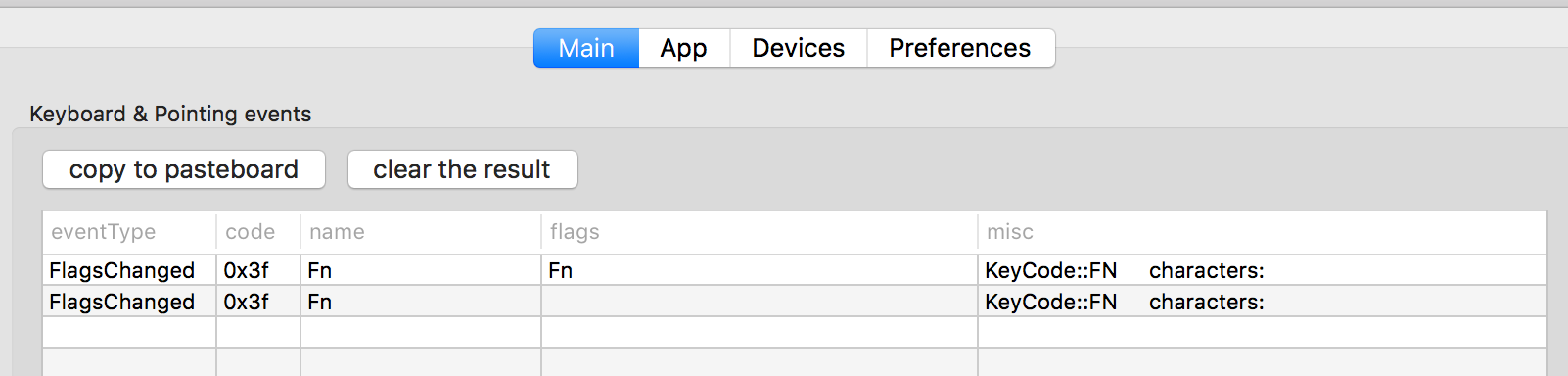

Here's what happens in the Even Viewer when I press and hold backspace key
[img]
[/img]
