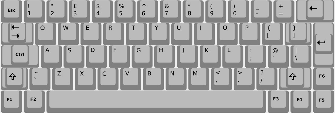

The F1...F6 in the first image along the bottom aren't going to be function keys, necessarily. These are keys I have salvaged from the same donor. They happen to be the the darker ones that suit the aesthetic. The bottom keys are Meta, Alt, Space (9.75 units!) Alt-Gr, then some other Meta, Super, Ultra, Etc. These keys could be anything at all, since the controller will offer remapping and layers.

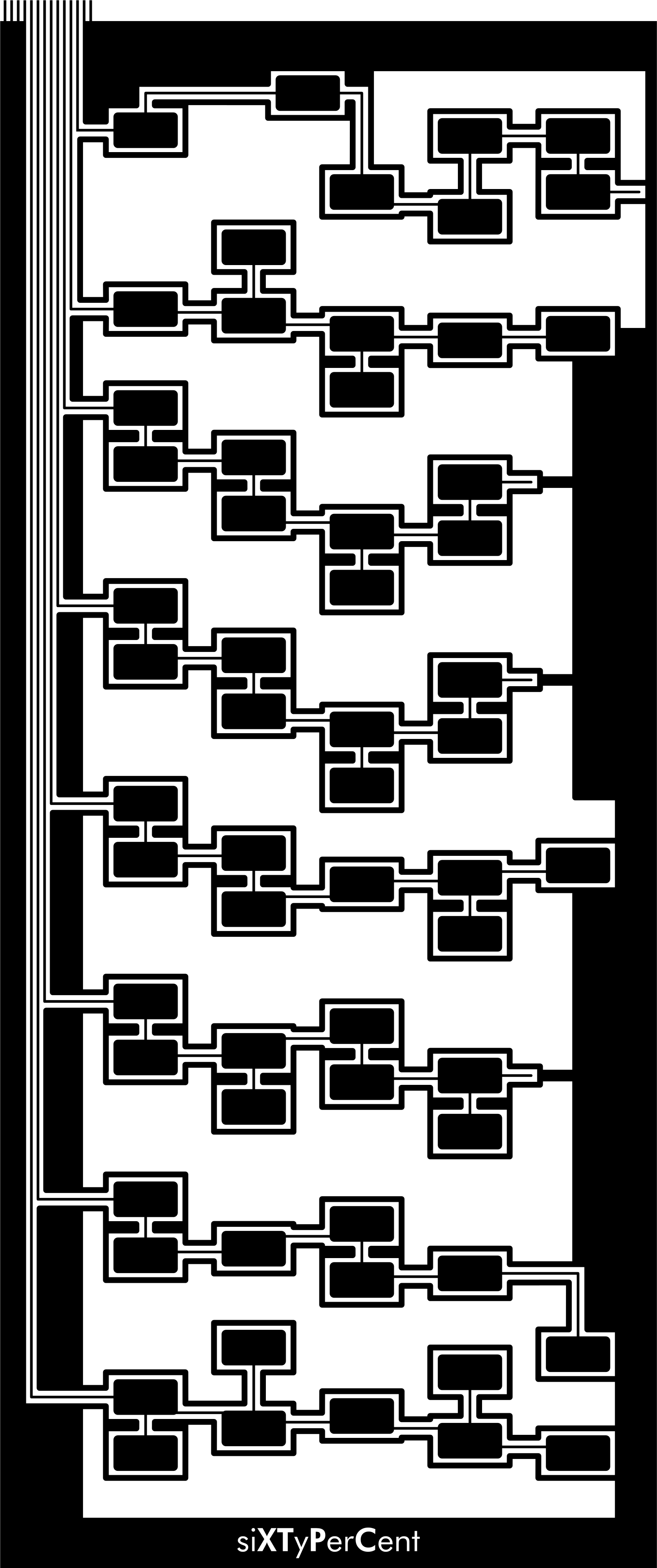

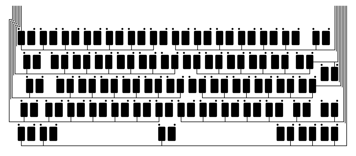

Better images, as promised. These are not mirror images. The "under" image needs to be flipped, to be applied as an etching mask on a PCB. The prongs along the top are connection soldering pads for a ribbon cable. I haven't yet discovered a better connection method.

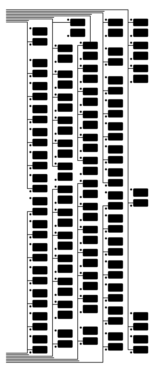

To illustrate, I suppose something resembling the beamspring PCB, such as the one shown in the Rustmaster Strikes Again!. I'll aim to design the matrix as a four-by-sixteen grid. The PSoC 5 series appears to have enough I/O to cope with that, without need for external components. In fact, with 72 I/O, the matrix grid could even be 71 x 1, but that requires too many wires!

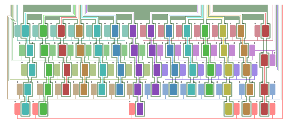

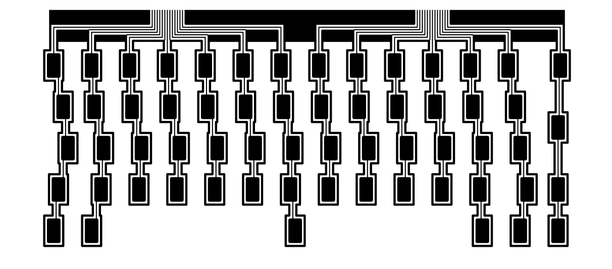

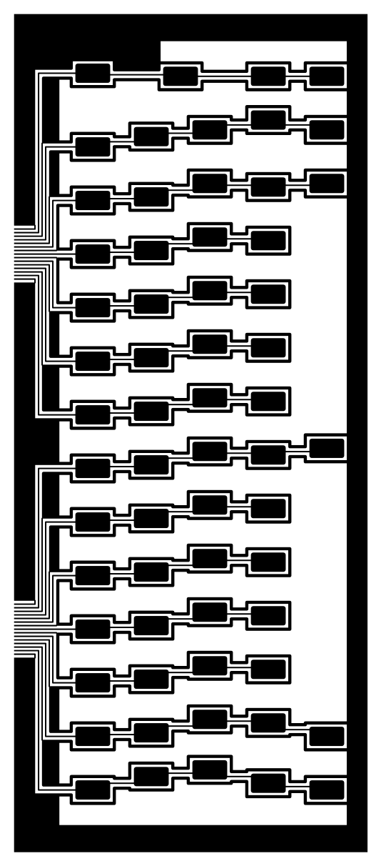

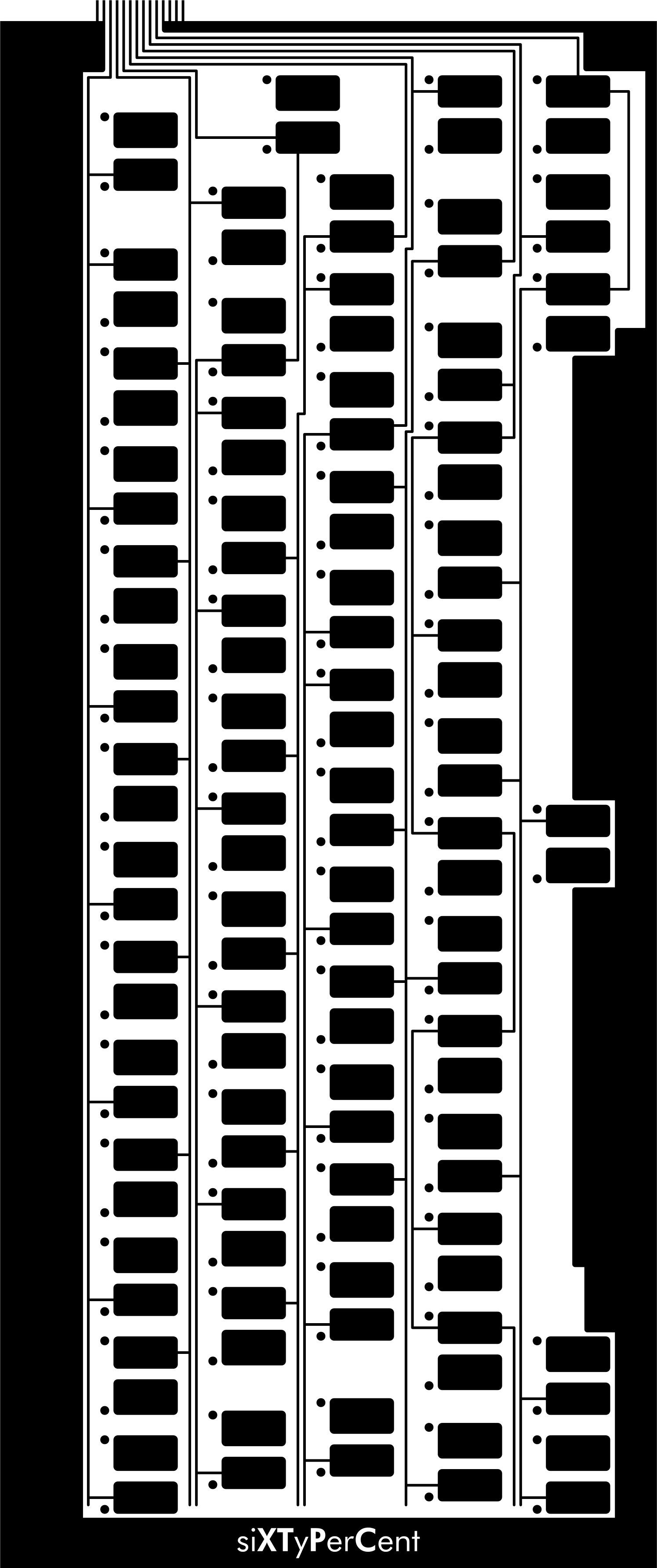

New PBC design, following suggestions from DMA. First the rows, on the front of the PCB:
And the columns, on the back of the PCB:
The weird lines leading nowhere are ground lines to prevent cross-talk. The connections are by 0.05 inch pitch ribbon cable to the controller, which looks as if it will be a PSoC from Cypress.
The matrix is nine-by-seven, divided into two halves left and right of the PCB (above and below in the images).
DMA
19 Jun 2016, 22:17
top row sense line looks perilously close to that solid column ground plane.
This will bite - the signal from the top line will have lower amplitude. But how much exactly - I do not know. It should be possible to retrace it to 4/8 rows. And if it's 8 rows - are you going to connect 2 columns to the same pin on the controller? Wouldn't it complicate the cabling?

tigpha
20 Jun 2016, 22:06

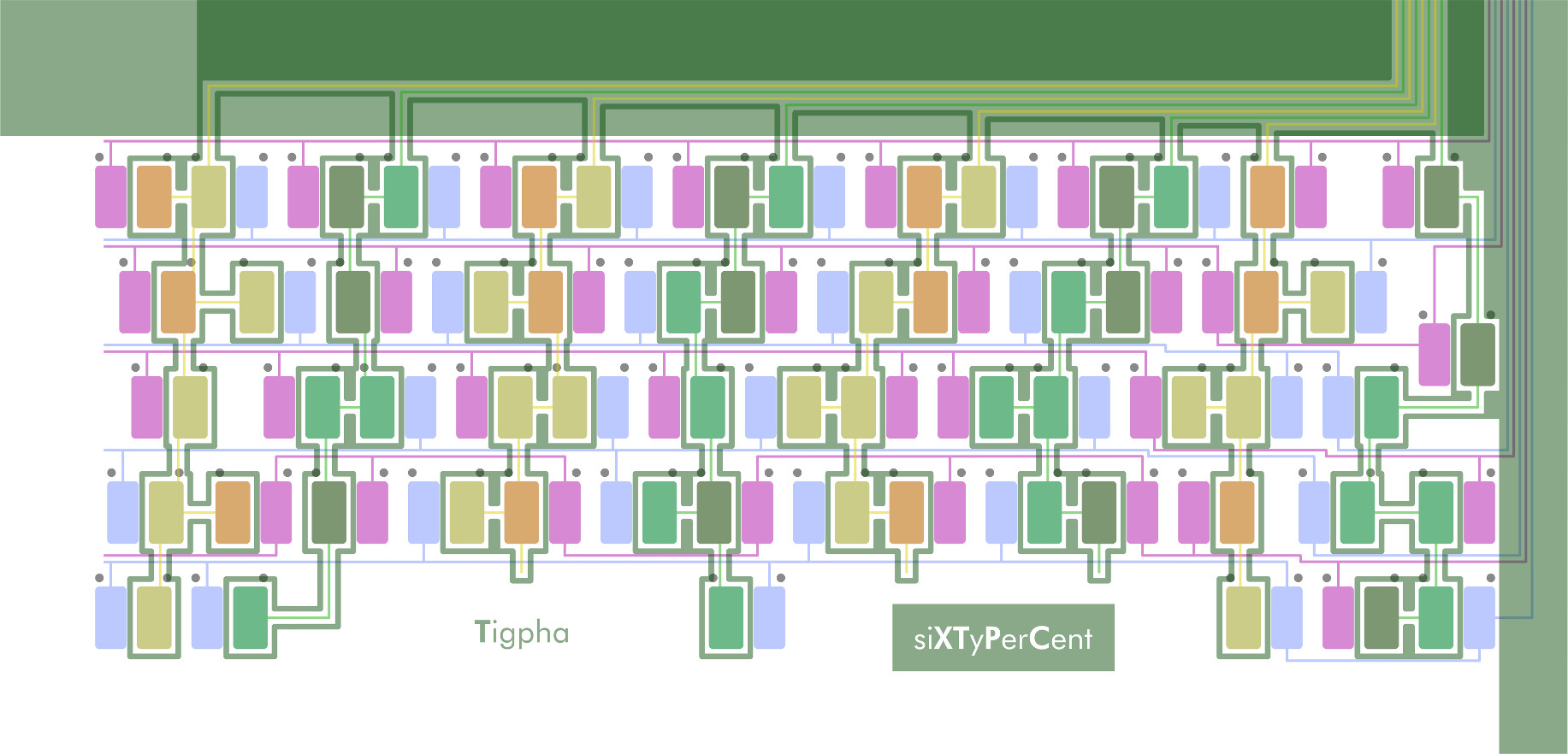

More PCB revisions.
Composite view with colour coded rows and columns:
The columns on the under side of the PCB, which appear to be the driven lines on the IBM PC-XT reference. The columns are separated by chunky ground fencing, which I guess is necessary because these lines will carry relatively high voltages, and need protection from cross-talk:
The rows on the upper side of the PCB, which appear to be the sense lines on the IBM PC-XT reference. I have moved the sense lines away from any ground planes, but I still have the interleaved ground lines separating the sense lines to avoid cross-talk. I'm not sure how critical this is on the sense lines as the voltages will be very small -- the interleaved ground lines might suppress the sensed signal by capacitive coupling to ground.:
DMA, the sense lines on the original PC-XT and Bigfoot terminal keyboards do not have interleaved ground lines, but there are large ground planes beneath the sense lines leading up to the controller circuit. Do you reckon that the interleaved ground lines on the last image are actually of any use?
tigpha
20 Jun 2016, 22:12
DMA wrote: top row sense line looks perilously close to that solid column ground plane.
I moved the sense lines away from the ground planes.
DMA wrote: Also I've discovered the calibration pad on my F122. Don't know how they made it, though. Afraid to disassemble it - the foam looks reeeeally decomposed.
I've not found sense pads on the IBM Bigfoots, or the PC-XT, but maybe I didn't know what to look for. As for the foam, I replaced this with 2mm thick neoprene foam. It was a minor struggle, but I believe it was well worth the effort.
