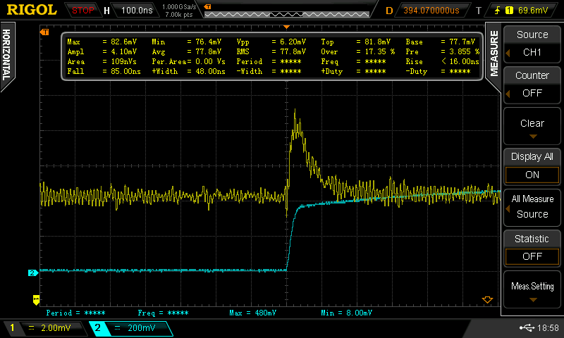

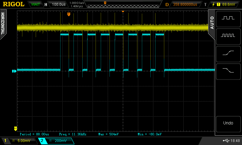

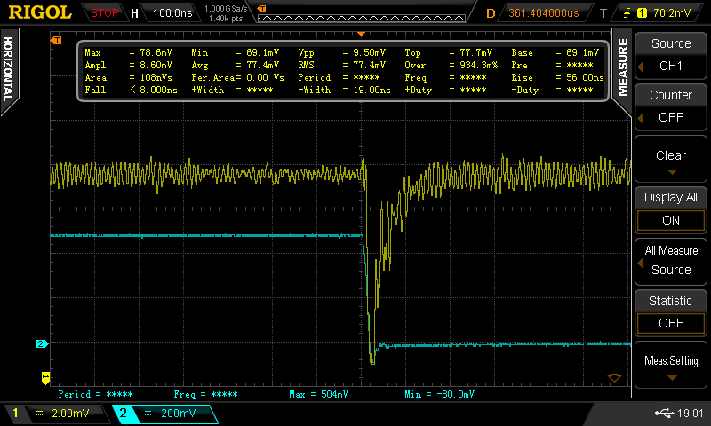

05 Jan 2016, 13:56
Disclaimer - I am not an expert, this is my reading and understanding of the scope. I'm completely prepared to be wrong. In fact I'm really very good at being wrong, it should be my vocation.
Every strobe actually consists of eight 5V pulses over ~700us period.
On the uptick there's about a 40mV spike which dissipates pretty quickly. I don't know if this dissipates this quickly because of the bleed resistor in the circuit or whether the input impedance of my scope is having significant influence. Schrödinger's Oscilloscope as it were...
So here's the shot we're interested in:
We have a whole 80mV to play with in a 30ns window. To put that in perspective I need to sample at at least 100Mhz to have a (finger in air) chance of getting a decent S/N ratio.
Now I'm starting to understand the difficulty in detecting this in pure software at a somewhat economical price.

02 Apr 2019, 07:19
__red__ wrote: 05 Jan 2016, 13:56 Disclaimer - I am not an expert, this is my reading and understanding of the scope. I'm completely prepared to be wrong. In fact I'm really very good at being wrong, it should be my vocation.
Just to be clear, the eight pulses are the controller walking through all eight rows on the same column. The column pulses once per key.
__red__ wrote: 05 Jan 2016, 13:56 On the uptick there's about a 40mV spike which dissipates pretty quickly. I don't know if this dissipates this quickly because of the bleed resistor in the circuit or whether the input impedance of my scope is having significant influence. Schrödinger's Oscilloscope as it were...
The uptick is the rising edge of the column signal being capacitively coupled to the sense amplifier input, before the amplifier has a chance to respond. The amplifier itself, when it responds, presumably drives its output low. There's an integrating capacitor from this output back to the input, and it's the amplifier output going low that drives its the input back to where it started from.
The amplitude and timing are much more relaxed than that, but you have to sample the output of the amplifier, not its input. Only one sample is necessary in the time that the column line is high, and in fact, the sample should be taken after the spikes you see, not during. That is, sample after things have been transferred from the amplifier input to output.
