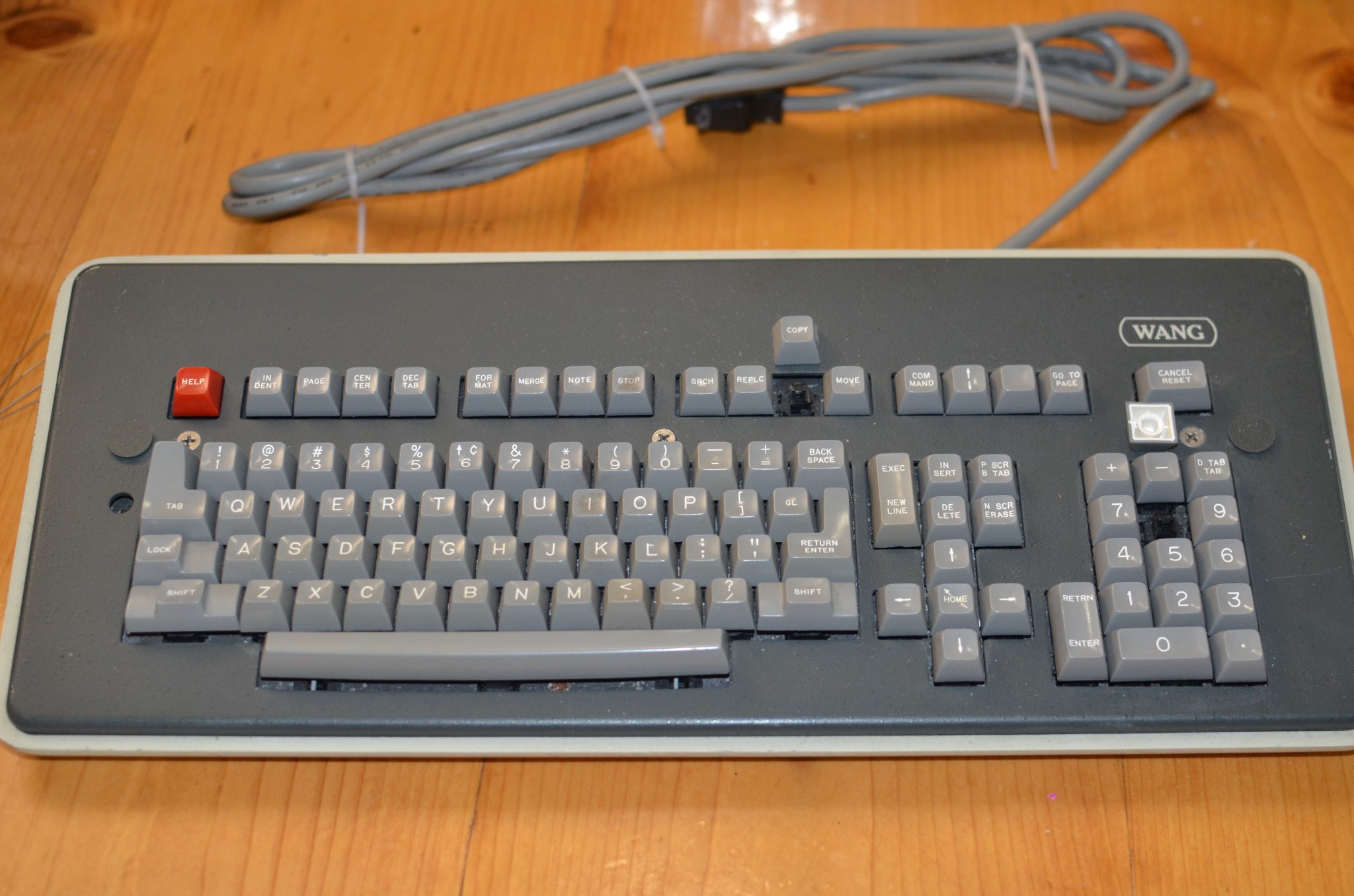

It's here! It's gorgeous! Complete metal casing, unlike the plastic of its foam-and-foil brother. I've never had USPS deliver something before 8am. Wow.
Wang terminal keyboard, Micro Switch Hall effect
Expect a full disassembly and reverse engineering for this one, it's one of the nicest keyboards I've ever seen! A full sculpted spherical double shot Hall effect board with a heavy metal casing in an almost perfect PC compatible layout. Wow.

That wang is quite big.
Would you keep your wang at home or take it work and show it off ?
Posted: 18 Dec 2015, 15:11
by chzel
Nice wang! Just be careful swinging it around!
by scottc
I've never been so happy to see an unexpected picture of a Wang before. Nice catch, XMIT.
Posted: 18 Dec 2015, 15:13
by klikkyklik
Looks like you wouldn't even have to worry about leaving your Wang in the sun and having it turn yellow!
Posted: 18 Dec 2015, 15:15
by andrewjoy
Well grey ABS does yellow to be fair but you just wont notice it.
