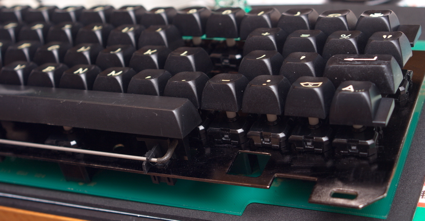

Since receiving a HHKB I have wanted to reverse engineer the matrix to make my own split hand Topre keyboard. With the help of Hasu's work I set about probing around my HHKB's PCB and particularly the function of the TP1684 chip.
TP1684
Recently I have been able to breadboard a 2x2 matrix using test pad PCBs I had made using itead.cc. I have sensed key height successfully with rudimentary firmware running on a Teensy 3.1.

Each key on a Topre keyboard is essentially a variable capacitor. Capacitance can vary from basically 0 to around 6 pF (estimated). The keys are set up in a matrix with one side connected to a row and the other connected to a column. Initially the entire matrix sits at ground (this is not how the HHKB does it, the matrix is pulled up to 5V). We drive the columns individually to 3.3V and then watch the voltage of the row to look for capacitive coupling. It takes the form of an exponential decay voltage which can then be read through a buffer or amp.
The decay time of the row is primarily controlled by the resistor and capacitor linking it to ground. The capacitor serves to reduce the effect of pressing another key on the row at the same time as the one being sensed - without it, there is a large voltage drop which could cause missed key presses (see the small difference between row1 and row2 in the simulation). The resistor pulls the row to ground, and the combination of the two provides an RC time constant T = RC which limits the speed we can drive the columns because we need to wait 5T to ensure the row has reset.

Back to the prototyping, I had some temperature tests just using a hairdryer to adjust the temperatures while watching the measured capacitance on a test cap. Results didn't move too much considering the large temperature change, I have lost the data I took though.
I had one column manufactured for the keyboard. There have been some issues with the piece slipping in the press because of the small size. Overall it has turned out quite well, of course expensive because it was a one off. I have ordered some more PCBs for fitting to it, they should be arriving shortly. Here is the column with some Novatouch housings inserted:
The holes still need tapping (M2). The bolts will go through the PCB, round the convenient bolt clearance cutouts in the housings and into the switch plate. Will update after PCBs arrive.

Update: built column
I have tapped the holes to M2, cutup some rubber domes and sourced M2x8mm pan head bolts. Assembled a single column:
My fears about the caps hitting the housing with 1.5 mm plate have been extinguished, thanks to the rubber dome cushioning:
Also here you can more clearly see the M2 bolts running from the PCB to the plate, the bolts tighten to become flush with the top of the plate as designed. I don't think I will slim down the plate thickness in future since there appears to be no need.
What I am unsure about is the close proximity of the keys. They are significantly closer together than on a standard non-curved keyboard. I don't know if they are too close. Ideally I would like to match the curve on Kinesis / Maltron boards, does anyone know the spacing at the tops of the keycaps? I had designed ~19 mm between centres but made a mistake with the keycap height (this is actually visible in the early render).
