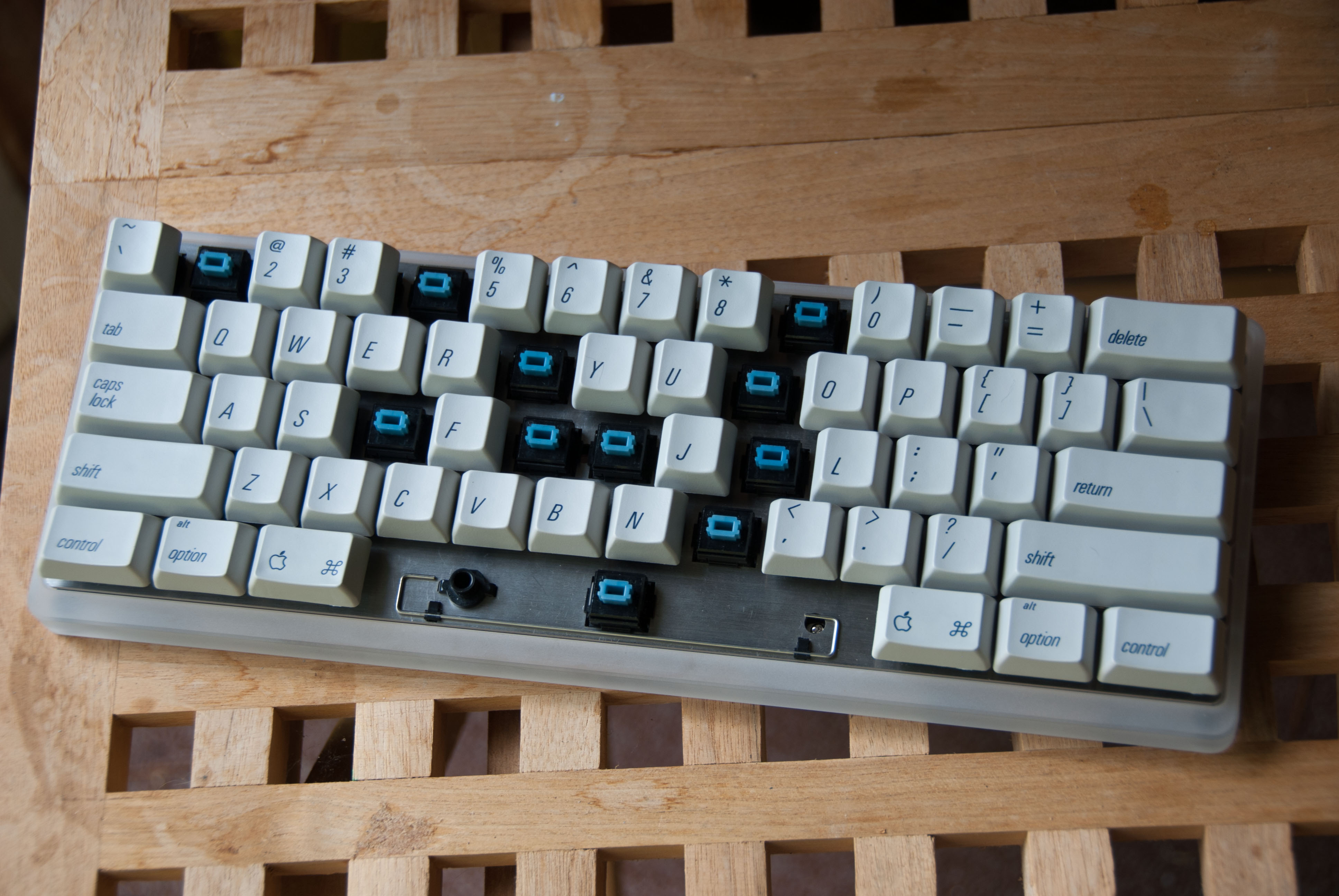

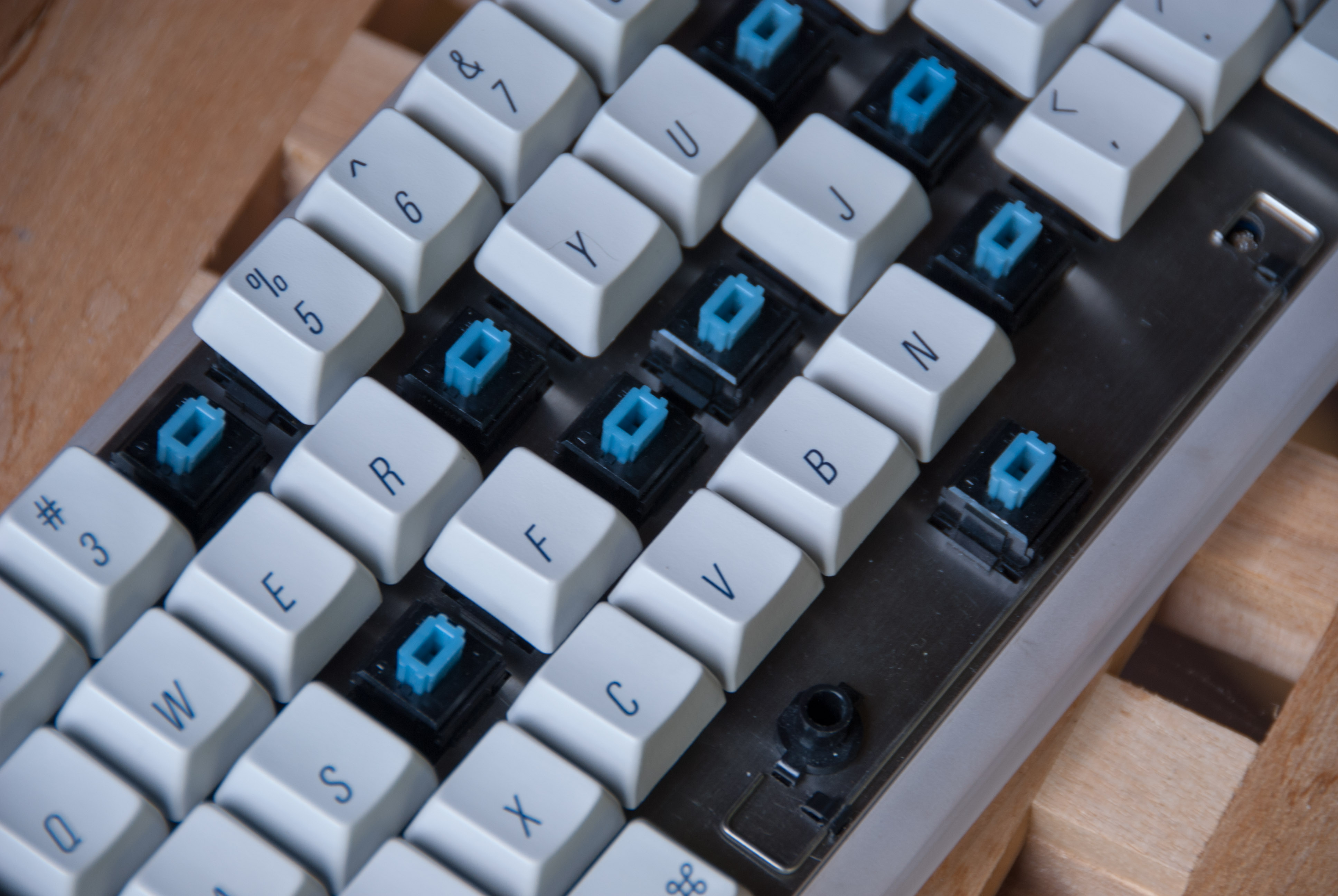

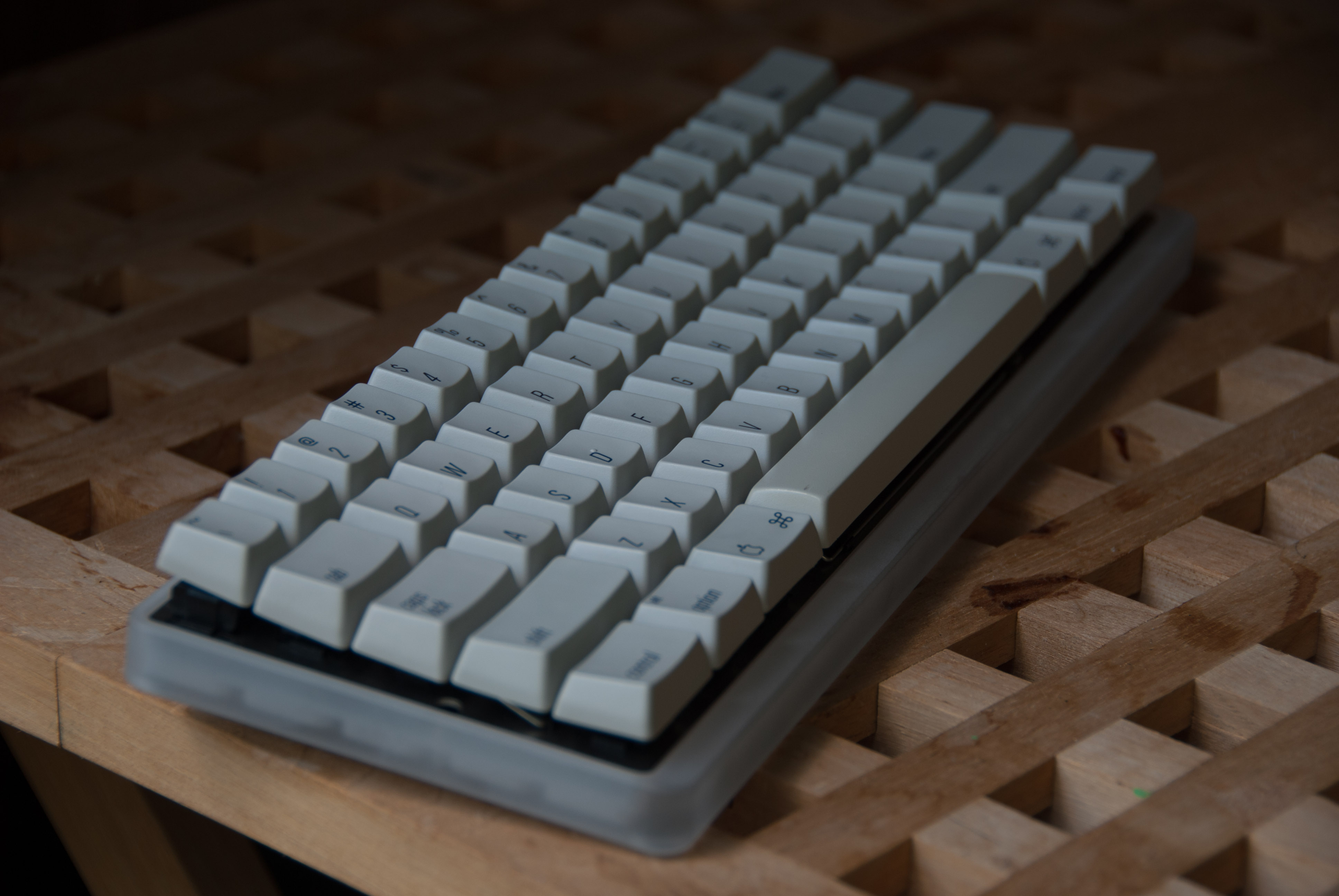

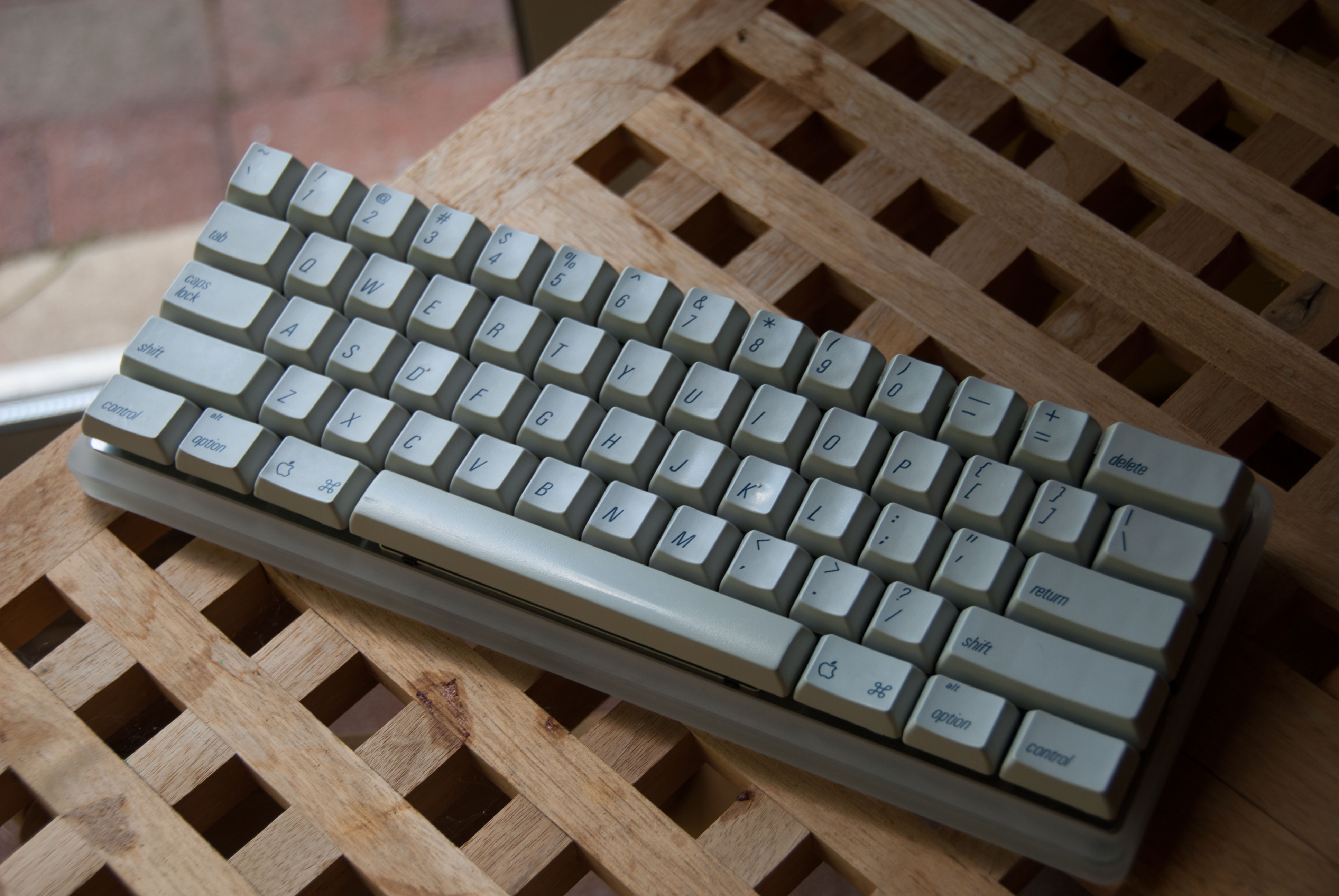

After a long time of staring at this collection of parts, I finally got the time to put everything together. I couldn't be happier with the results, and I took a few pictures to share with everyone here. My Blue Alps 60%:

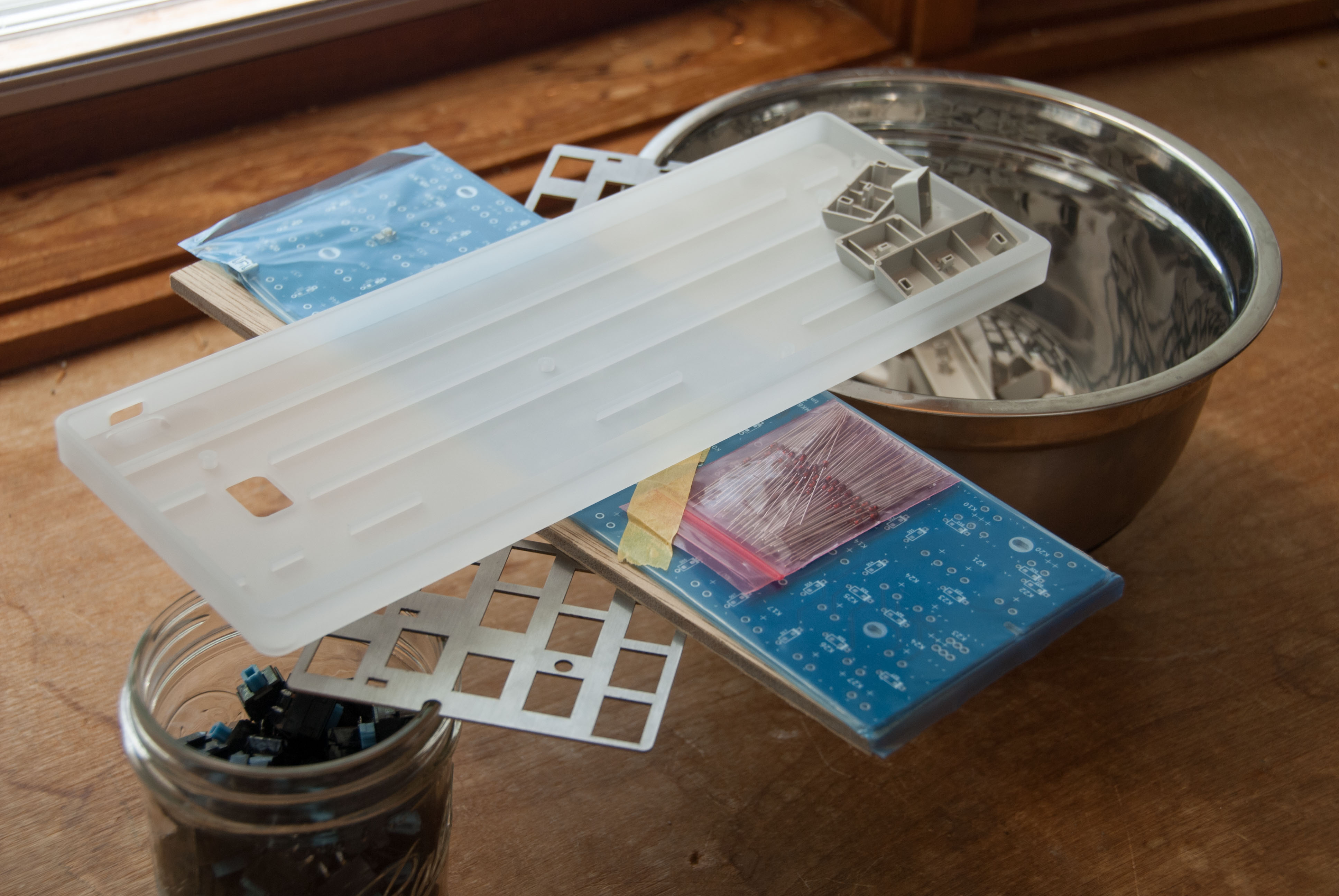

I got parts from all around.
Specifically the PCB is Hasu's 60% Alps PCB

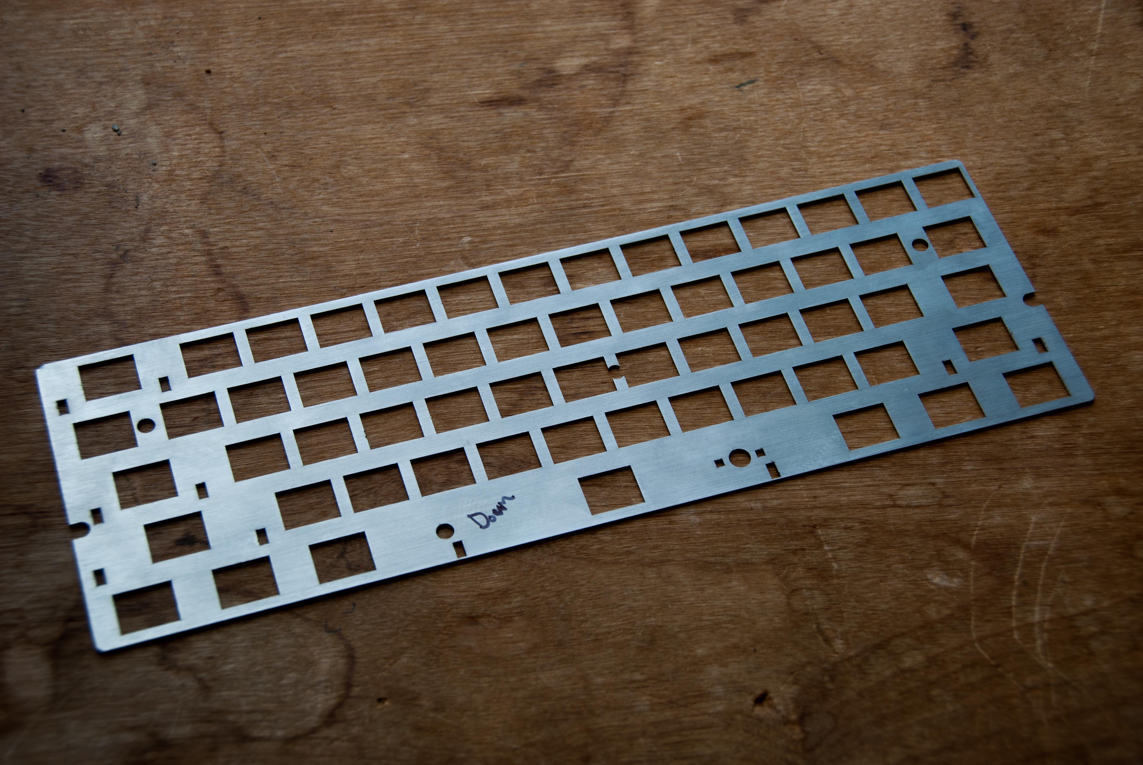

The plate is an AEKII plate, cut by Nubbinator

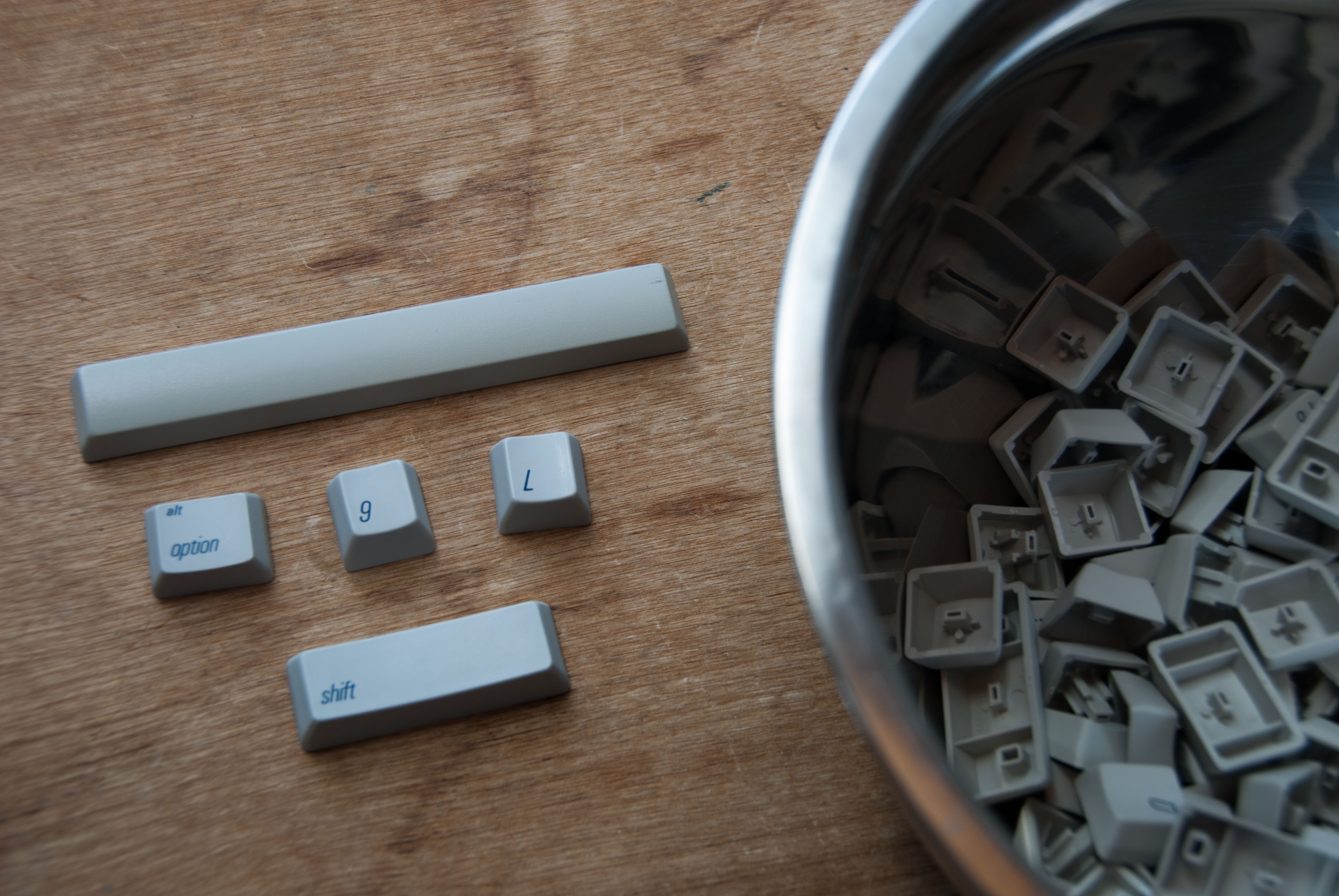

The Keycaps are from an AEKII bought from XMIT

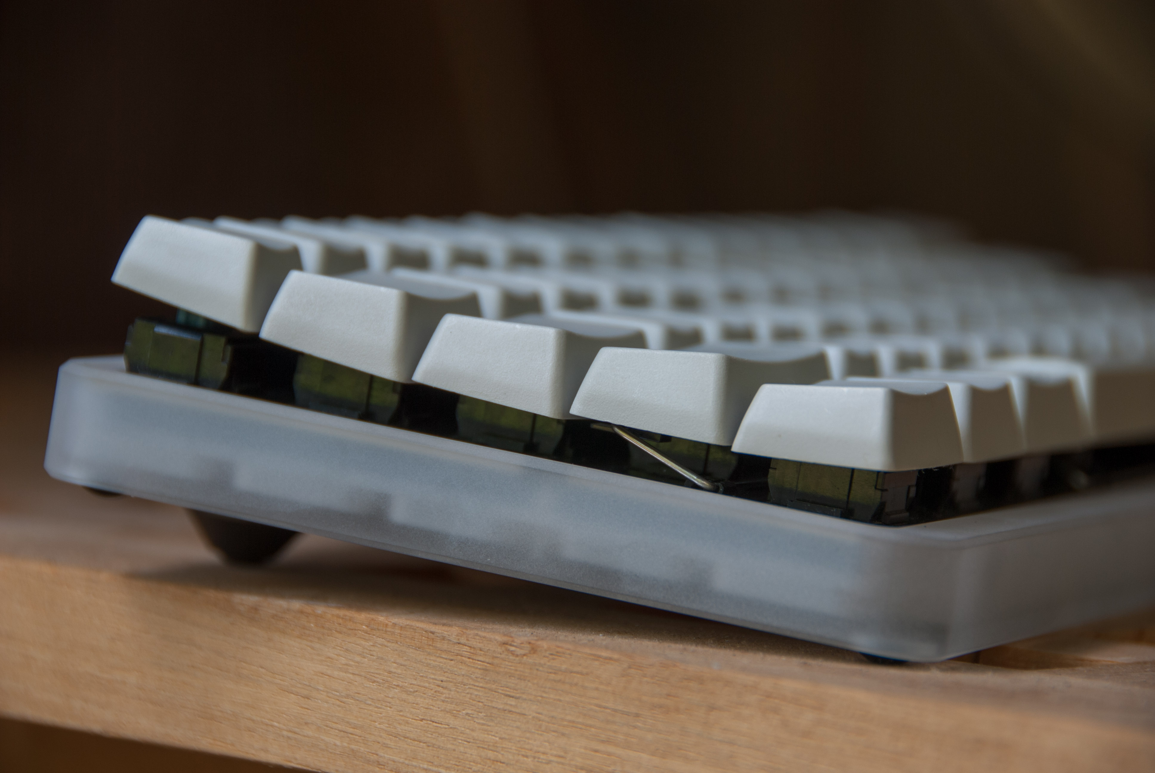

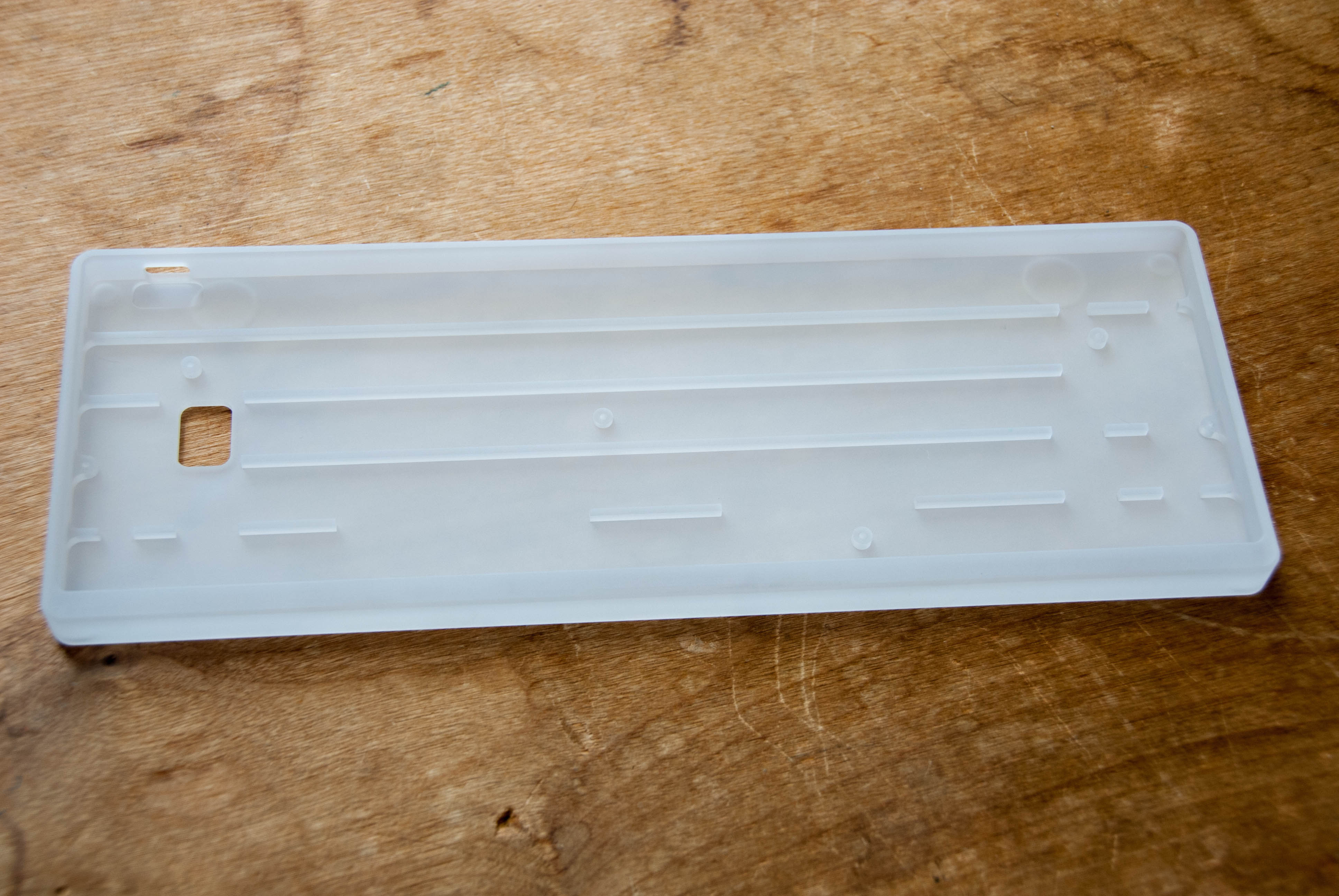

The case is a TEX Acrylic I bought from *cough*Massdrop*cough*

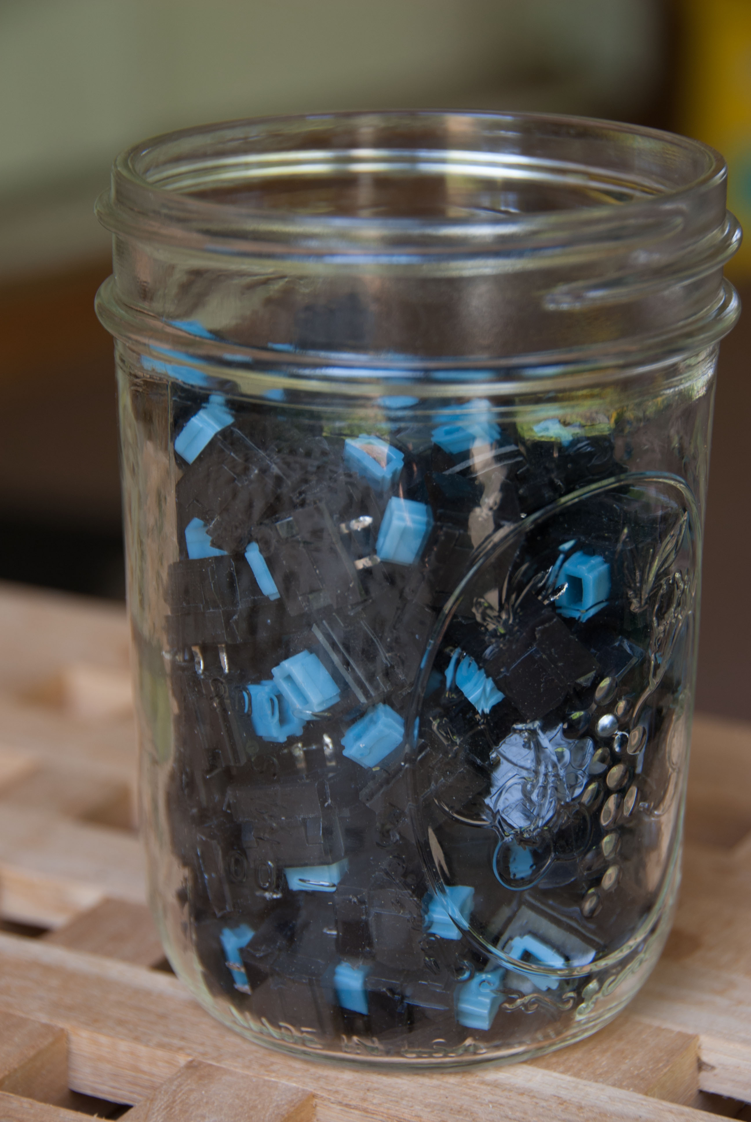

And finally the switches are Blue SKCM also bought from XMIT
I am incredibly happy with the board. The Blue Alps are fantastic to type on. They have no comparison to a lowly Blue MX switch. The click is perfectly aligned with the actuation, they are smooth, and the sound is incredible. I am currently just running the stock flashed TMK firmware on the keyboard, so I still need to adjust the board for FN layers and my preferred layout. I have yet to tinker with TMK firmware, so I imagine it will be a little while before I can take the time to get to it.

28 Aug 2015, 20:50
Wow really nice board! Congrats.
photekq
Cherry Picker
28 Aug 2015, 20:57
What a beauty!
HzFaq
28 Aug 2015, 21:05
Super nice, looks really good in that case. I have like 2/3rds of the bits to make mine, just waiting on the final few pieces...

I can understand you, the font isn't that nice, but the thing that drives me crazy on Apple (AEK) keycaps are the homing bumps at the D and K key. Very irritating current writing and gaming with WASD is just annoying with the homing bump on D.

Thanks guys. I am not the biggest fan of the Apple font, but when it comes to the most readily available, PBT (non yellowed), mostly normal layout, Alps keys, the AEK2 wins. I have already gone and switched the nibbled keys around, as that throws me off like crazy, when used to them the other way.

Looks incredible, pyrelink. I'm partway through doing a similar build, just in ISO using a Dell AT102W plate as that's all I had to hand. Unfortunately my plate's gotten a bit too bent from my rabid hacksawing so I'm back to square one!

Sawing plates: eew. I might need to do that for a space invader TKL sometime. If so, powertools! But I'd rather laser cut something new so I don't destroy original kit.
29 Aug 2015, 12:50
Yeah, I'd strongly recommend NOT attempting to saw a stainless steel plate! It was an ordeal. Took me several hours too. Hopefully I'll just have someone make me one from scratch instead.

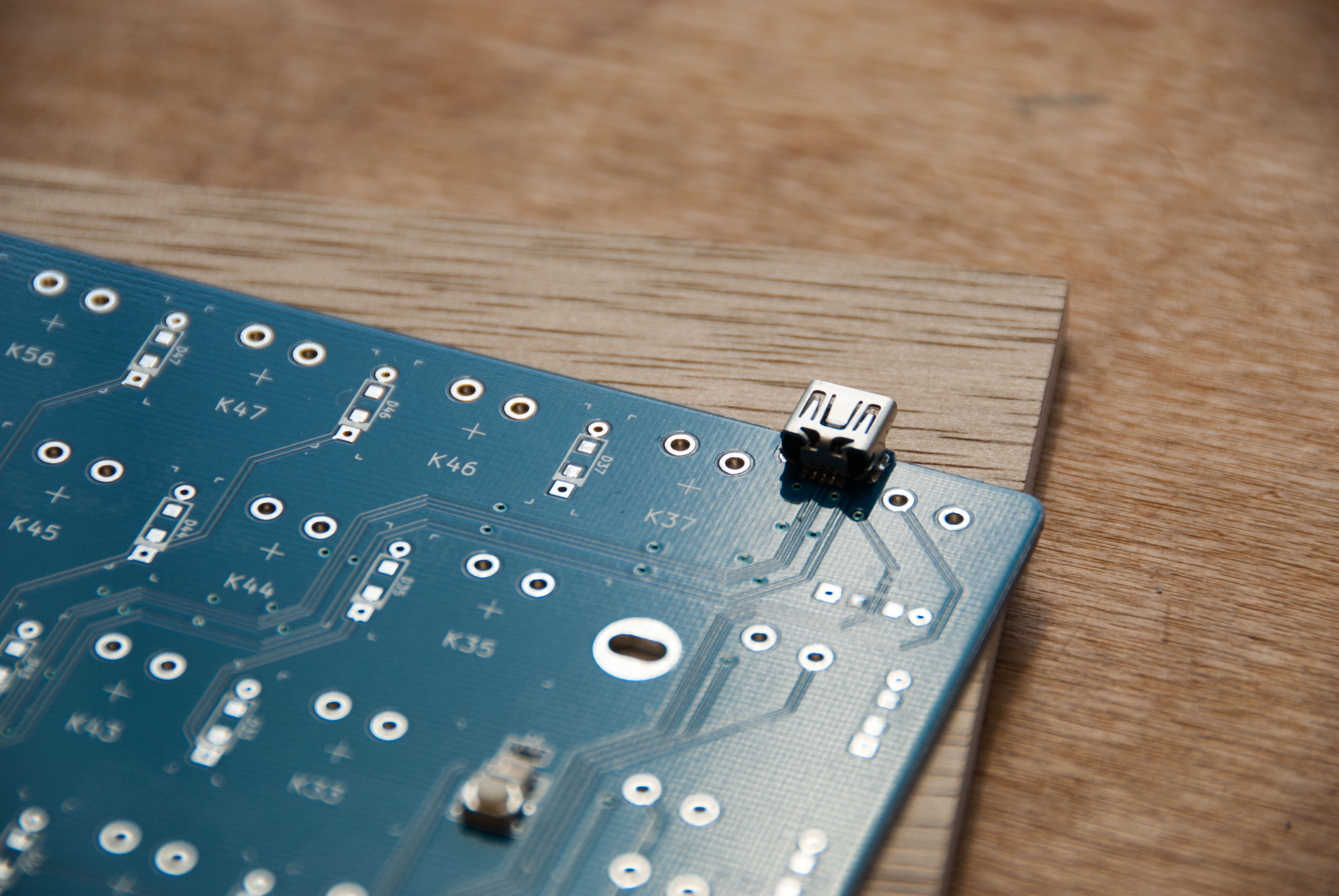

I'd ask your feedback so that I can revise PCB design in next batch.
Don't soldered diodes interfere with cross bars and standoffs of the case?
Or did you have any other problem on the PCB with the TEX Acrylic case and plate?

It was this reason that I waited as long as I did for the case to arrive before starting to put everything together. I test fit it in a couple times and everything looked like it would fit just fine, so I tried a couple on each row, and nothing touched. PCB still sat flush in the case. The USB connector is also in the right spot, and all the standings align correctly. So I would say it is perfectly compatible with the Tex Acrylic Case. The only things I would like to see changed on the PCB would be possibly using Micro USB over Mini (just personal preference), and Bluetooth compatibility, otherwise it's a fantastic PCB and I am super happy with it!
