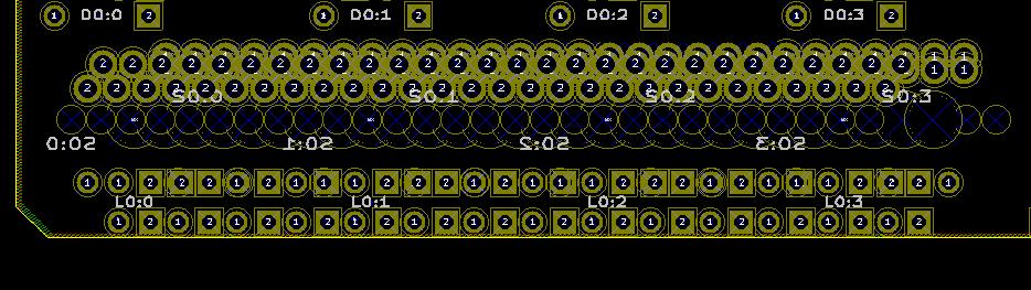

This would be no problem for Alps switches. But Cherry MX have those big holes in the center, which make sure that the PCB will be very labile.
:cry:
Maybe, some switch positions can be left out, to make it a little more stable.

Are you saying that Cherry keyswitches need a big middle hole to seat into because they have a protrusion at the bottom?
I'm not sure what the image is that you are showing. Is that an existing board example?
Because it doesn't look like a perfboard.
If Cherries do need a larger middle hole (larger than the perf holes), it may not be terrible to drill a hole
once you figure out your layout.
Maybe one of the perf holes would be the location of where the bigger hole would need to be?
So you could basically use it as a positioner for the drill?

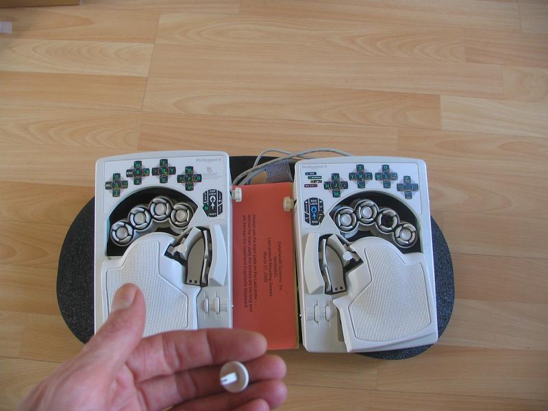

18 Jun 2022, 13:53
Glove, you say?
DataHand. I suspect it's not what you mean—and it's surely not my cup of tea, either, as a "floating hands" style typist—but it certainly fits the fingers.

Muirium wrote: 18 Jun 2022, 13:53 Glove, you say?
:) Thanks for sharing. Added to my list.
I did not literally mean globe but more so, "a surface" on which we can keep changing and trying layouts for the keys to gauge what works best for one - without wasting new PCBs for every iteration.
