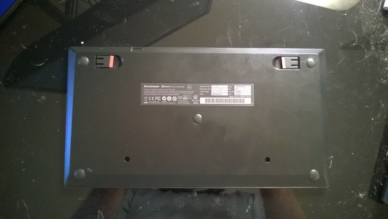

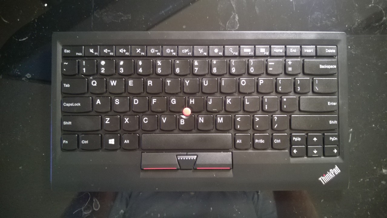

And here's what it looks like: And the back for good measure: Quick specs
Scissor-stabilized rubber dome, measured ~2.5 mm travel, measured ~53 g force (at 3 nickels (5.000 g), 6 quarters (5.670 g), and 2 dimes (2.268 g), for a total of 53.556 g, it buckled repeatedly, removing 1 dime stopped it from buckling)
19 mm key pitch for most keys (except for function row and arrows), cylindrical island-style keycaps, pad-printed
TrackPoint IV - a real one, with real buttons
84 keys for ANSI layout (not including TrackPoint buttons) in a 15 x ~6 U form factor, although the keyboard is bigger than that to allow for a rudimentary palmrest and space for the TrackPoint buttons

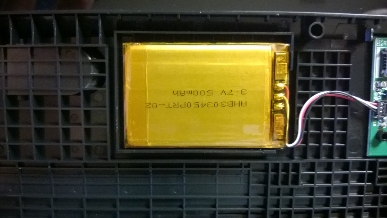

3.7 V 500 mAh battery. That's... not that much battery.

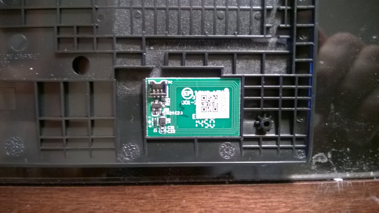

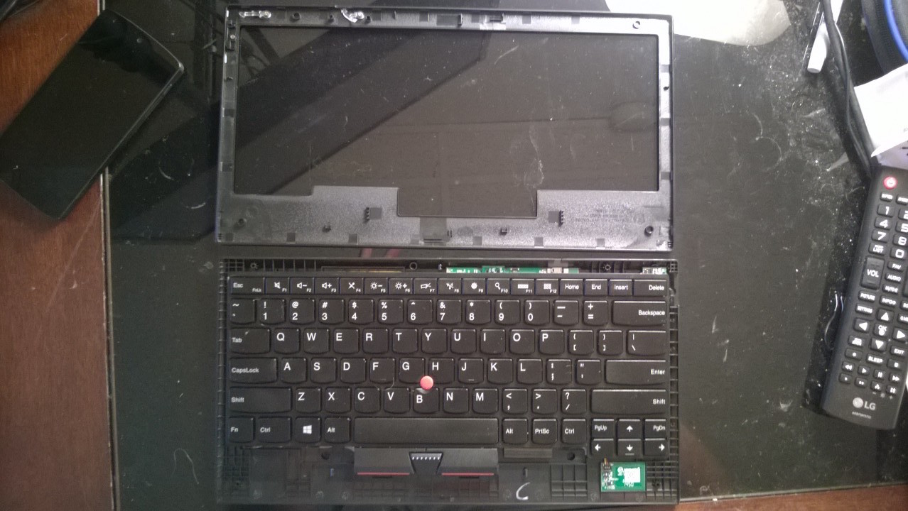

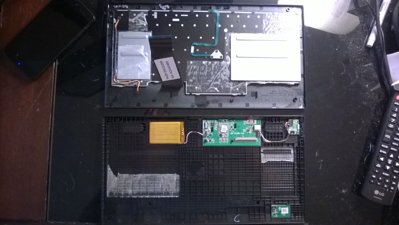

Construction Fully plastic case, of course. There's a top part that snaps on (screwless construction), the internal keyboard part is then taped to the bottom part (with, funnily enough, a couple thick steel plates glued/taped to the bottom - they don't appear to be structural or containing anything, it's just to make it feel heavier I believe), and all the PCBs and battery mounted to the bottom.

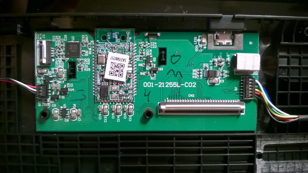

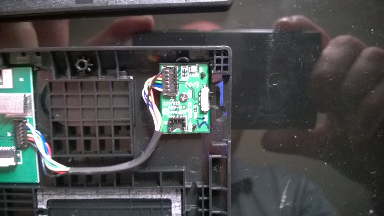

While I'm at it, let's describe the PCBs, along with photos.
Main PCB holds the Bluetooth controller, the TrackPoint microcontroller, and the power circuitry (including USB charging). Interestingly, that's a departure from how ThinkPads have worked since, oh, 1998 or so - typically, the TrackPoint would have its microcontroller mounted up against the stick, and then it'd speak PS/2 directly to the motherboard. This is reverting to the old way of doing things, with a dedicated analog cable to the controller. Daughterboard right next to the main PCB has the power switch and LED. There's a third board in the lower right corner that has the NFC hardware. Finally, the little battery, that the weight makes you think is much bigger. It doesn't feel that sturdy, and occasionally you can hear the adhesive on the tape that holds the main keyboard separating when you push on the case in certain places and release. Not the most impressive build quality. Don't get me wrong, it doesn't look like crap like a Unicomp or something, but it's certainly not great quality.

I found your post while I'm trying to open the case of Thinkpad compact keyboard to repair it.
However, Its hard to figure out how you released the snap of the plastic part and open the case.
The gap between top and bottom cases is so narrow to insert thin ruler or something to transmit the opening force.
Do you have some tips to open it?
Thanks..
Thanks..
bhtooefr wrote: Construction
