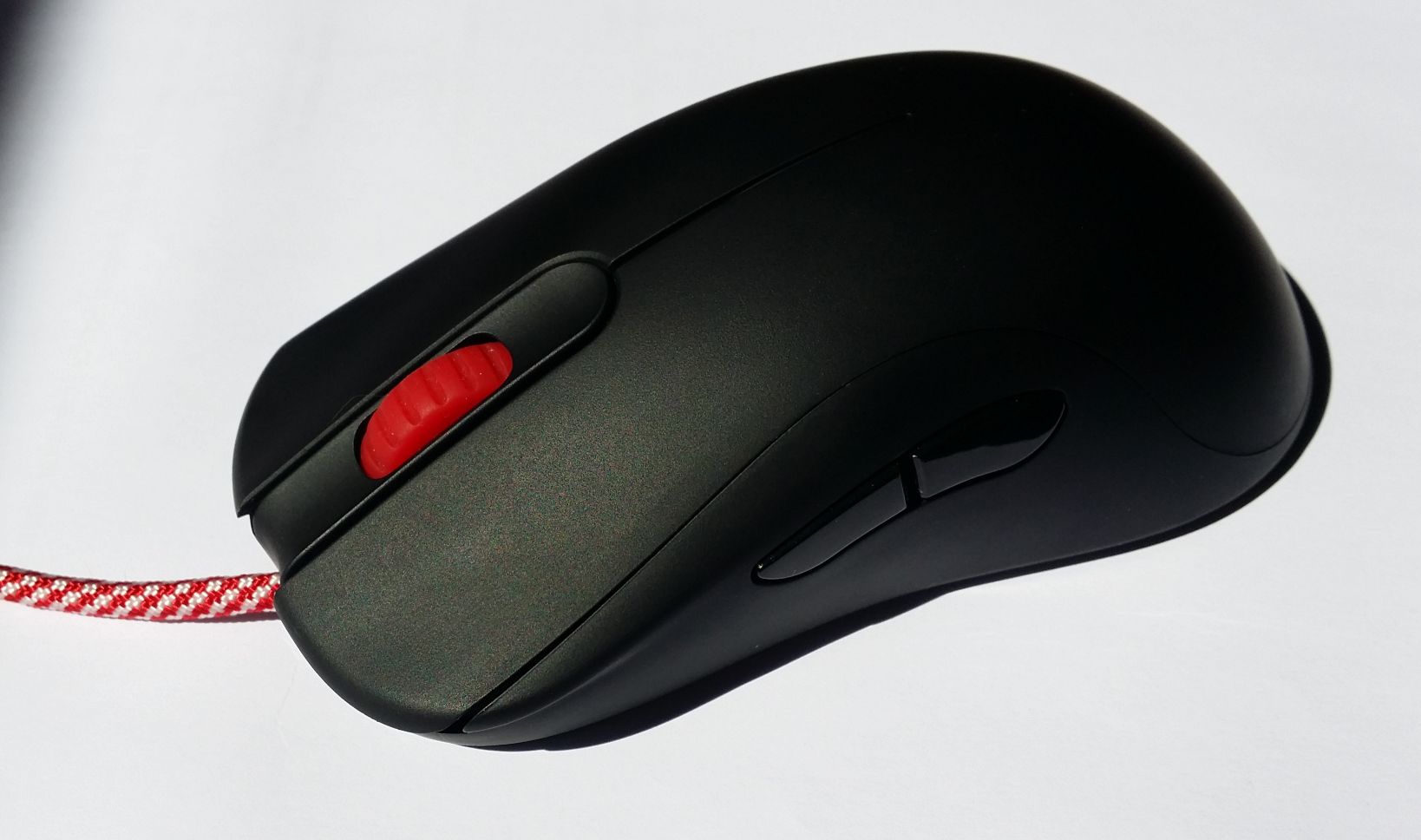

Zowie ZA11 modded
CeeSA
23 Jun 2015, 09:49
Zowie ZA11 modded.jpg (118.1 KiB) Viewed 3456 times
- remove some internal shell in the back for the overall weight of 85 gr. (cable connected)
- using the red rubber wheel ring from a AM
- mouse cable as usual
- wheel is free wheel (removed the internals that made the resistances/clicks)
- wheel switch is now omron D2F-01F (original is really much to hard for me)
- the thumb button front right is now my dpi button ( I am righthanded and click it with my right ringfinger, so the thumbbutton left side I could use normal)
I like the shell very much. A little bit wider would be even better.
MB1+MB2 feels lighter than in the FK1. Therefore I did not exchange them.
I would love a white glossy ZA11 for even better grip (for my hands).

Nice cable replacement :mrgreen:.
It's literally become another mouse by your addition of a Red scroller and cable. Good to see someone customizing their mouse to their own specs.
Please post more modifications in the future because this is worth knowing about and should be applauded here.
