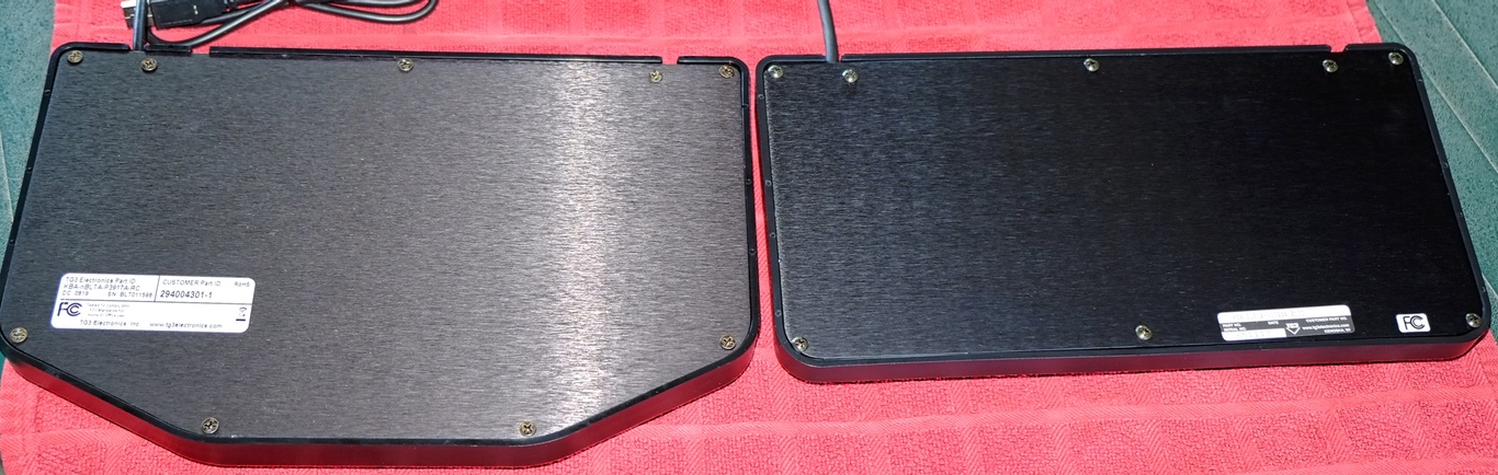

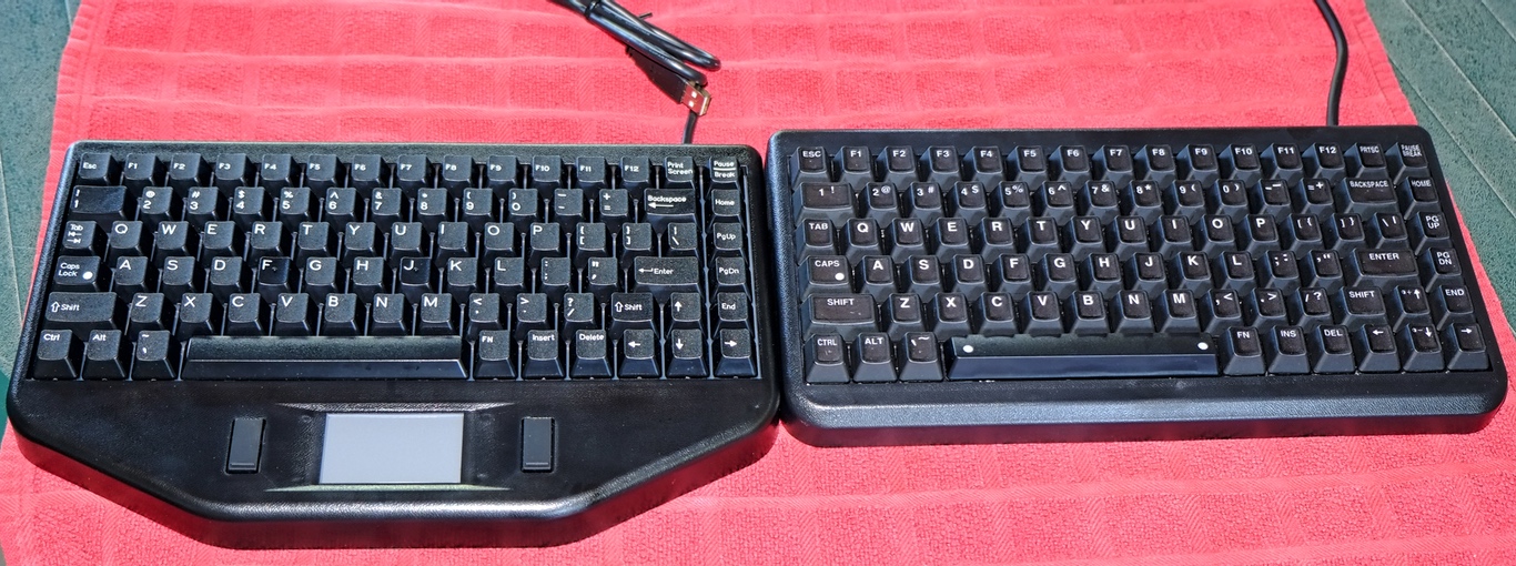

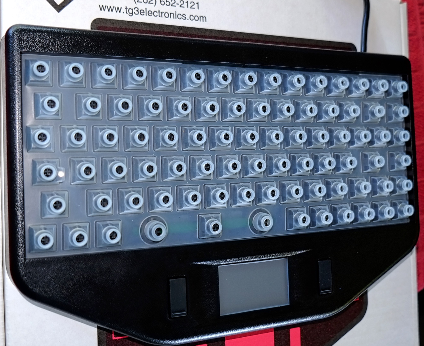

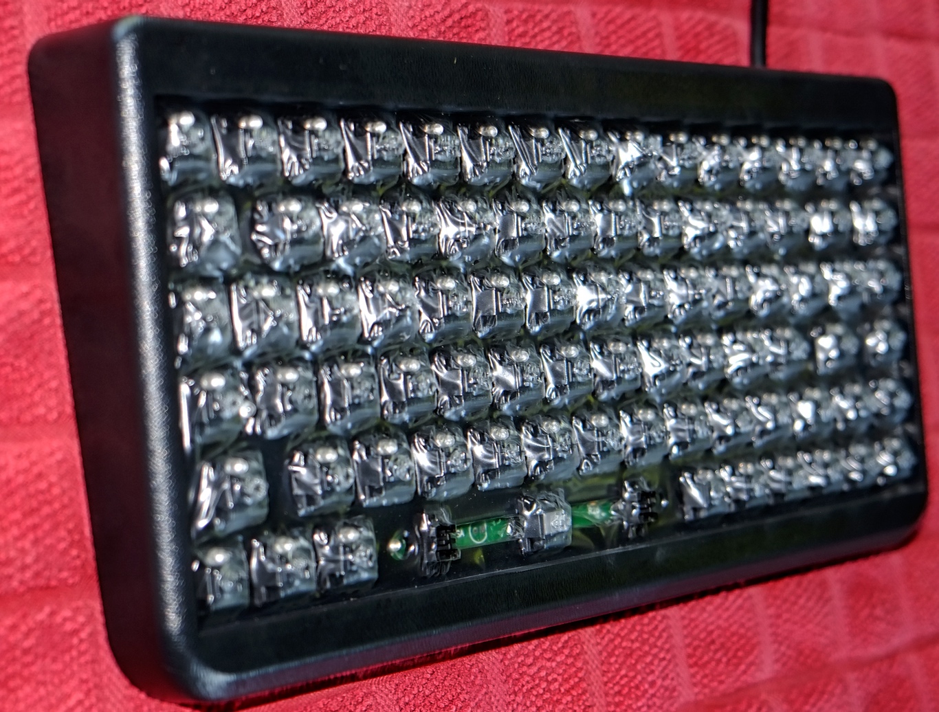

Front and (rudimentary) back:

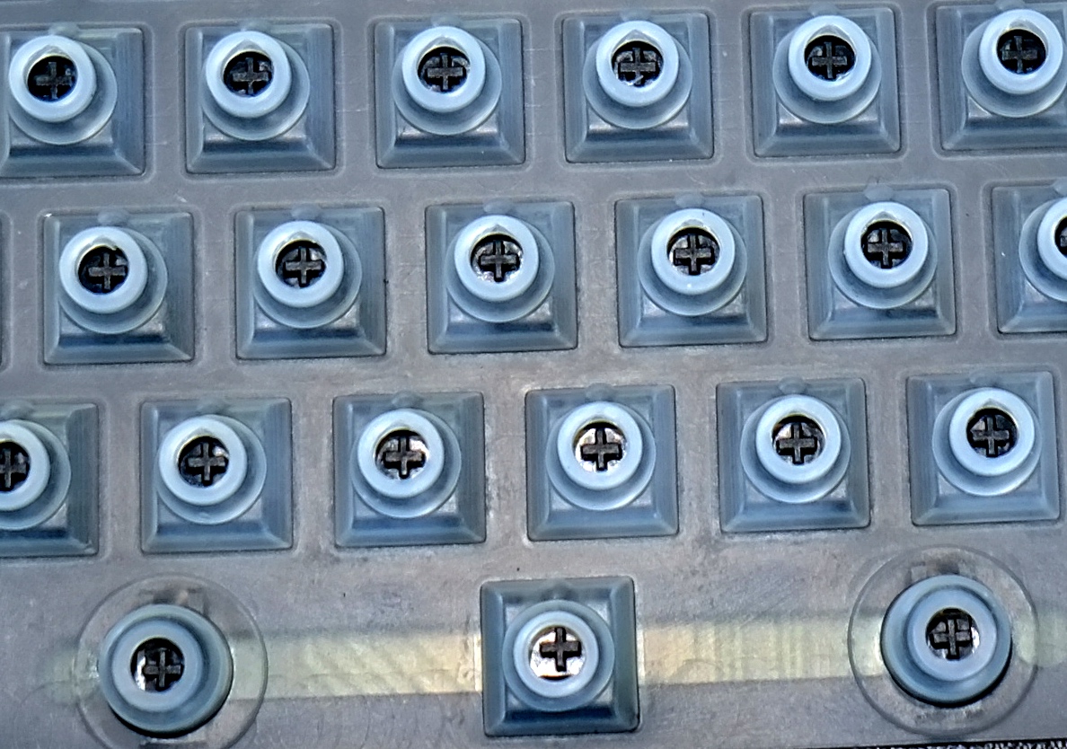

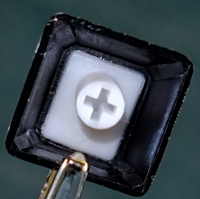

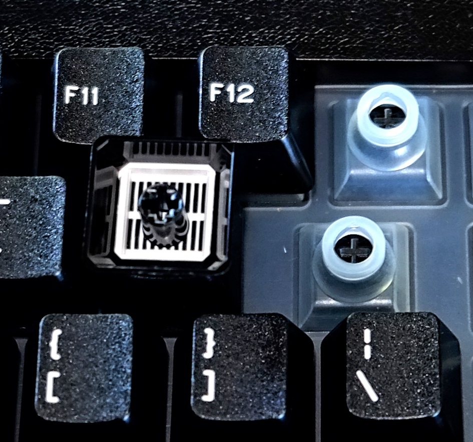

Once the keycaps are removed, the rubberized protection is visible (it also dampens sound and it's harder to actuate):

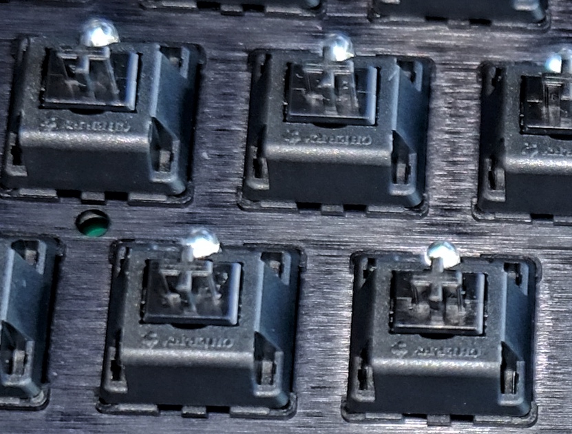

Lifting the protective layer reveals Cherry MX black switches:

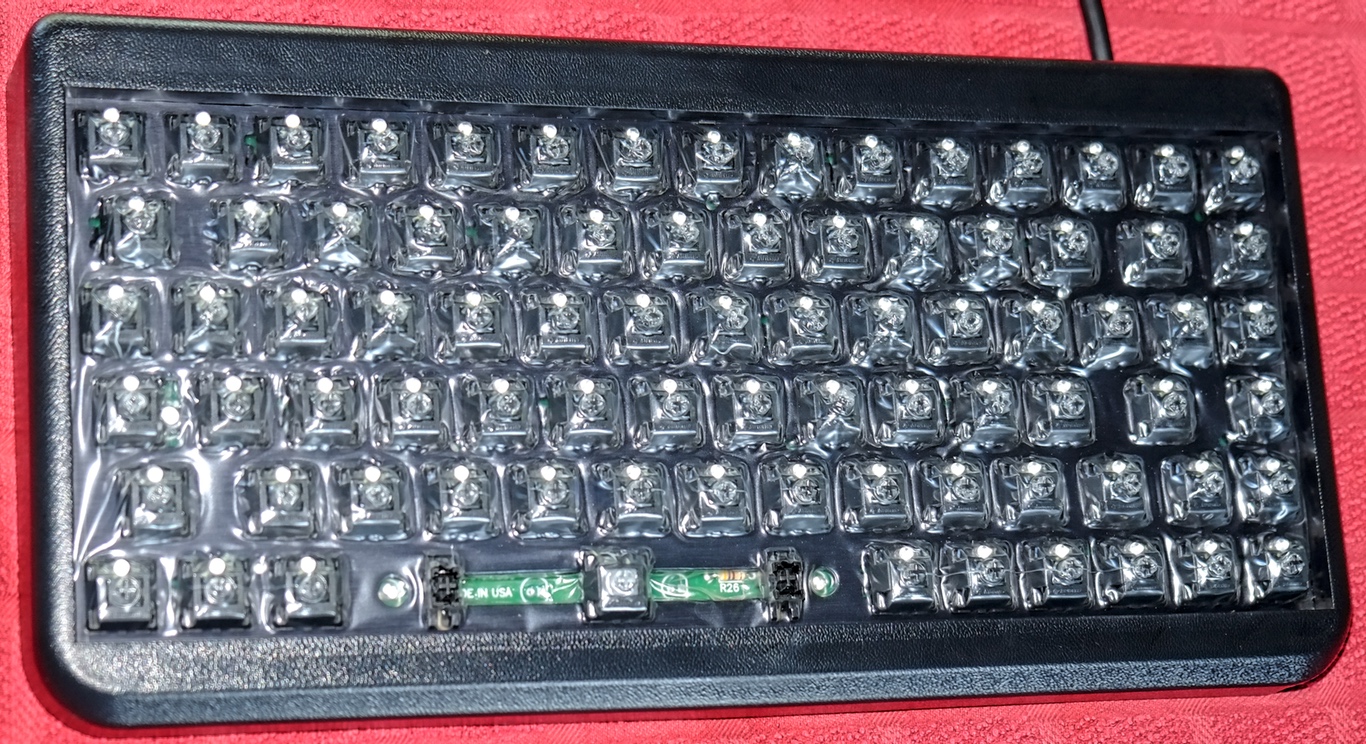

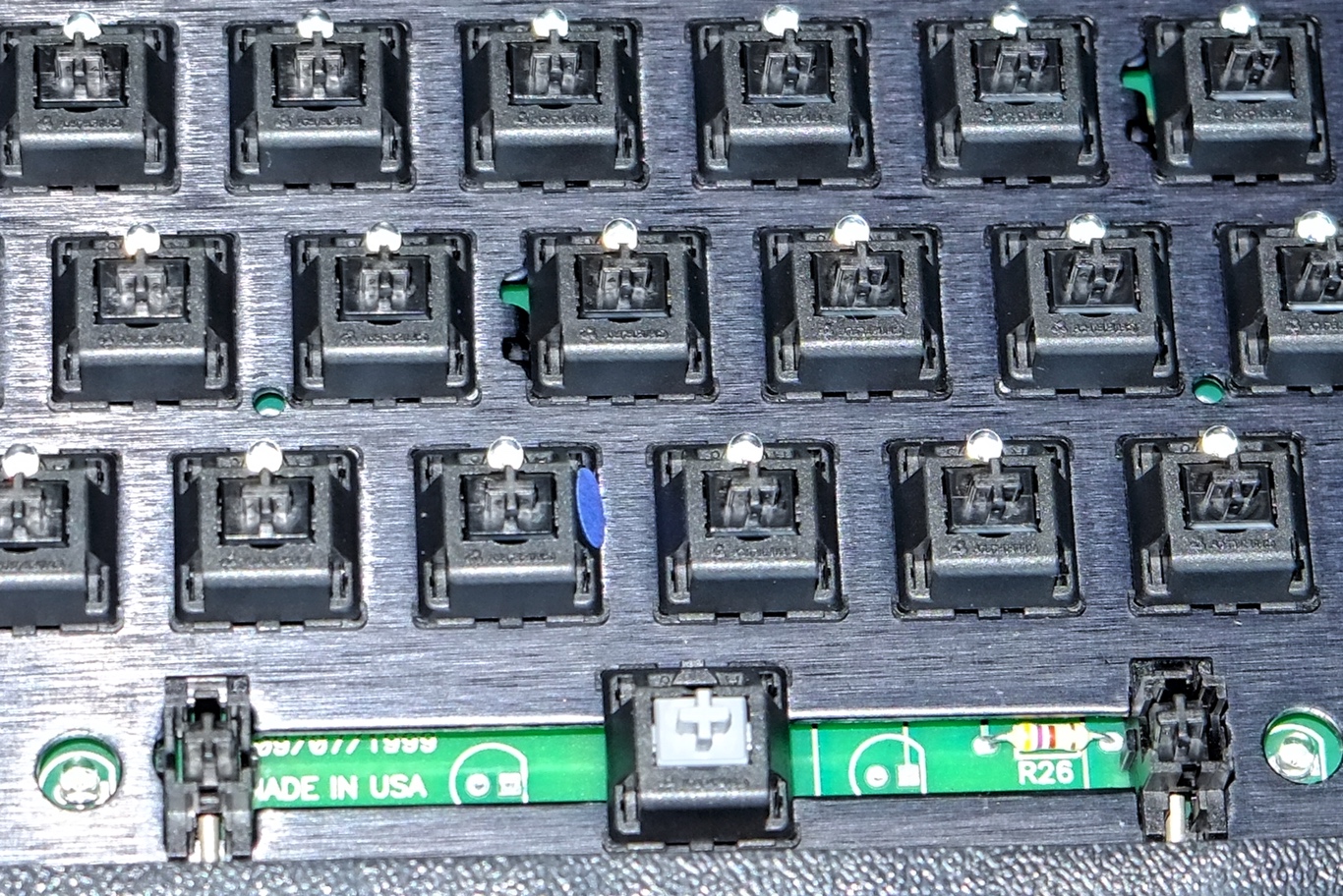

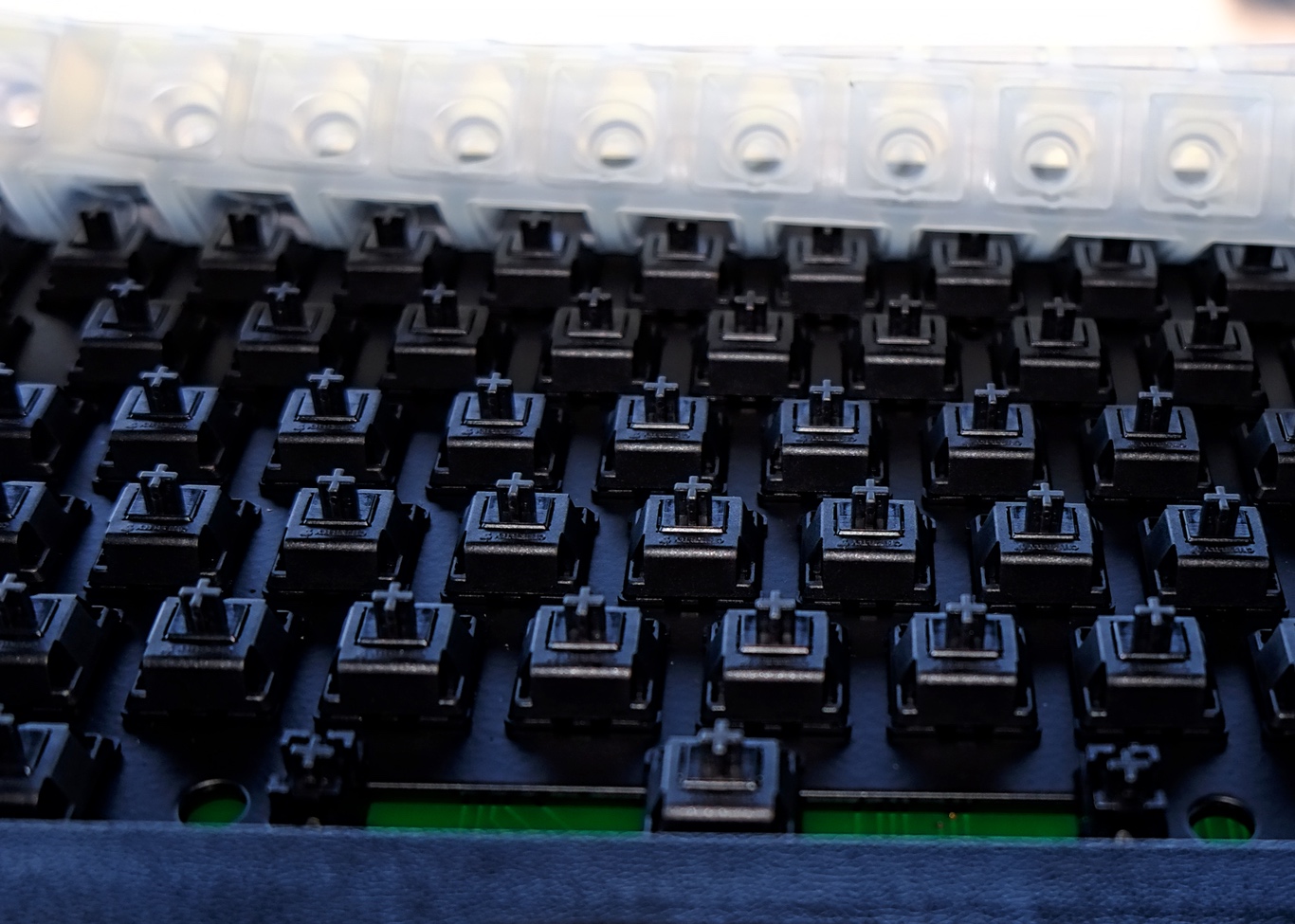

The non-touchpad backlit version (TG3 KBA-BL82) has a different type of protective layer -- it pretty much feels like typical Saran wrap and keycaps are just pressed over it:

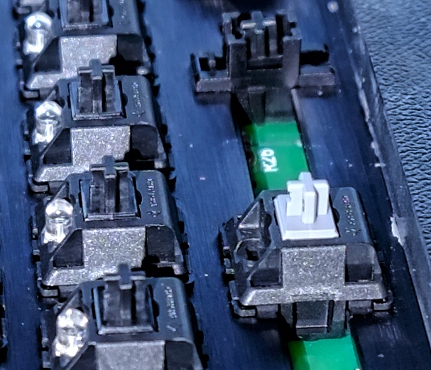

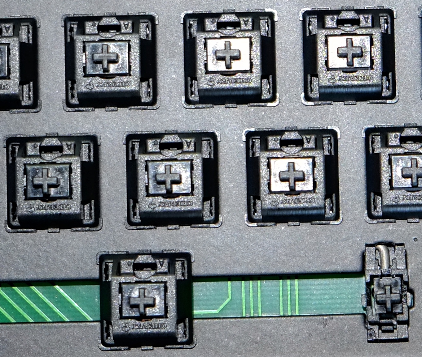

Removing the protective layer from TG3 KBA-BL82, again reveals Cherry MX black switches with LEDs (notice Cherry MX grey under the spacebar ... and nowadays rarely seen "Made in USA" on the board below):

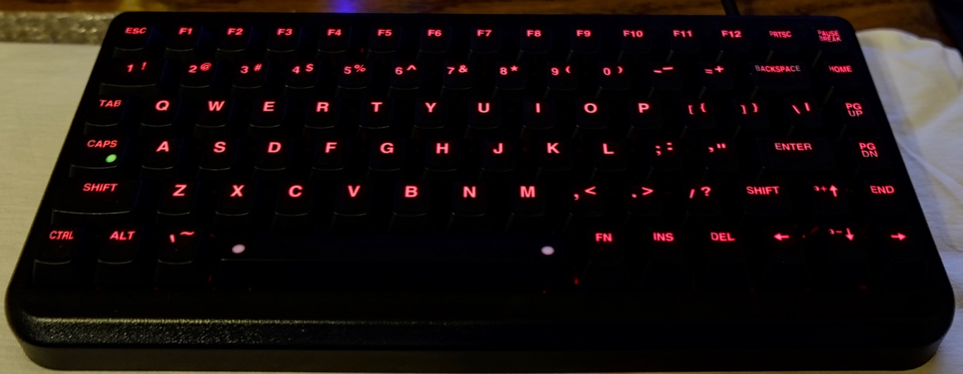

Backlight at approx. half strength in moderately lit room (no flash):
Anyways, these are immensely sturdy compacts and protected to the extent that it's hard to feel their mechanical nature. Remove the protective layer to get a typical Cherrry MX black feel and performance. Obsessed with esthetics -- you'll skip these KBs or just harvest the switches and keycaps (if you plan to harvest, IMO, the non-backlit versions have somewhat nicer keycaps).

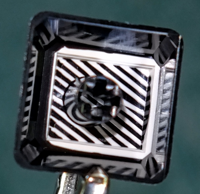

scottc wrote: Are they ABS? PBT? I remember reading about some early PBT doubleshot Deck keycaps but might be mistaken. You should update the wiki also: http://deskthority.net/wiki/Deck_82 :)
Yes, many Decks come with PBT+POM keycaps -- great quality, BTW, and most of Deck KBs beat very well built KULs in terms of sturdiness. The only questionable thing about Deck is the non-mainstream font/lettering on them.

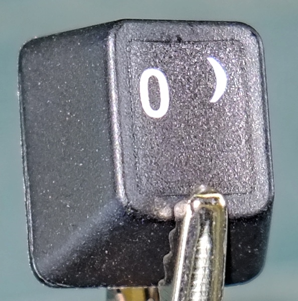

This one with no touchpad, but backlit, very nice quality but looks more like a doubleshot ABS to me with some rough-the-top-surface coat (to prevent slips):
The other with touchpad, could be a doubleshot PBT (need to find those pics). I think one of the best bets to get PBT is to look to the non-USB (older PS/2) versions.

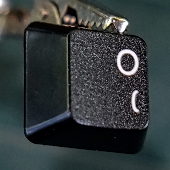

15 Jun 2015, 02:26
Redmaus wrote: mmmm
Need close up on those keys.
Here they are ...
Non-backlit:
Backlit:
