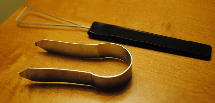

Posted: 09 Jun 2015, 15:07
by XMIT
seebart wrote: now that you mention it the caps sit fairly tight on those sliders. It took some pulling to get them off. But how are you going to "roll them off" ?
Alright, I just tried this. Here is the procedure:
1. Grab both sides of the key with a Topre style key cap puller. The key cap puller should be vertical, perpendicular to the keyboard.
2. Rotate the key cap puller to the right about the centerline of the key cap. The left edge of the key cap will rise and the right edge of the key cap will either stay in place or drop.
I successfully removed about five keys this way with no drama, no scratches and no broken switches. The key caps roll right off.
The Topre style key cap puller is the forward one in this (stolen) photo:
This should work equally well with a wire key cap puller but engaging the side of the key cap - and not just a corner - is key. I have not tried with a ring style key puller but the nubs may not provide enough engagement.
