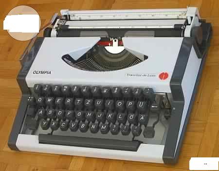

I wouldn't call myself a typewriter enthusiast but I have a couple of them around. I think the Smith Corona Memory Correct 300 is a nice machine. The key caps are very nice and the whole machine is very solid. I also have a newer Sharp or Brother (can't remember) it feels about like your typical laptop.

elecplus wrote: Brother [typewriters are] not expensive, easy to type on, easy maintenance, and a wide range of fonts.
All the Brother typewriters I ever tried were a pretty uninspiring typing experience though.

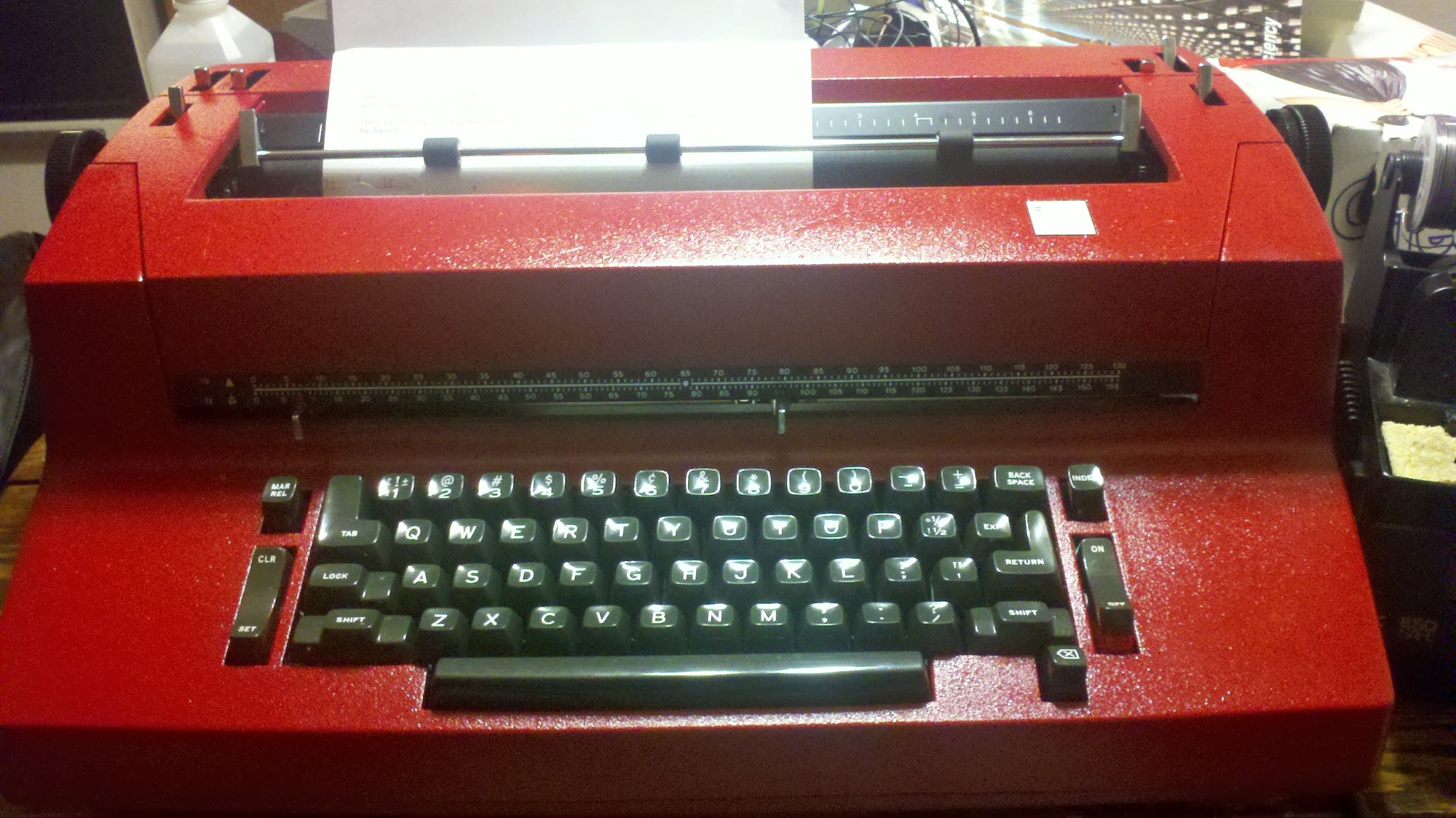

Mine, while we're at it:
(It was originally beige, but when I sent it to this guy for an overhaul, he included painting for free, so I figured I might as well.)
If you want to go daisywheel, I'd say to at least go for something with good switches. Brother loves their rubber domes. AFAIK, everything daisywheel that IBM/Lexmark made was membrane buckling spring (and based on release dates, the original Model Ms were likely the original Wheelwriter 3, Wheelwriter 5, and Quietwriter 7 (Quietwriters were, IIRC, thermal transfer printers instead of daisywheel), several months before the first known standalone Model Ms). That means Wheelwriter and Actionwriter (the Actionwriter began as a TA Adler-Royal machine, but IBM customized it to an extreme extent). There's plenty of other mechanical (albeit typically linear) switches found in other manufacturers' typewriters, though.
