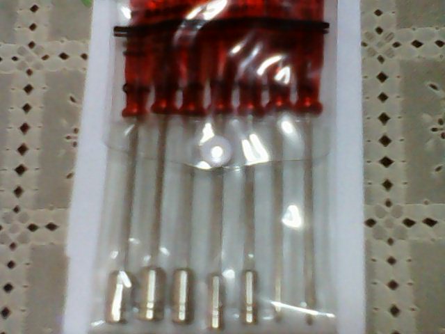

I would lend mine if not for the distance...My brother has 2 more sets available...
5.5 mm or even 6 mm for opening the cover
4mm (for bolt mod - for the nut (I guess?)
- nut driver sizes
- 2.jpg (38.92 KiB) Viewed 4644 times
- nut driver
- 1.jpg (30.93 KiB) Viewed 4644 times
