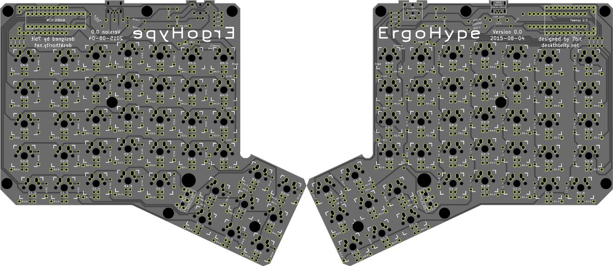

by 7bit
I'm working on an improved version of the ErgoDox design, that fits into existing cases.
I've added support for Alps switches, a trackpoint hole and a mouse button.
It is possible to add LEDs to every switch. to be wired to a dedicated LED controller. But there are also some LED-pads that can be connected to the Teensy.
Now my question:
Is it possible to connect LEDs to that MCP23018-thing?
Here is how it looks like:
- ErgoHype_PCB_00.png (464.97 KiB) Viewed 12215 times
Posted: 11 Aug 2015, 01:29
by litster
If you do want to change the layout that would require a new case design, I would be happy to make modification to my original ErgoDox case design.
Posted: 11 Aug 2015, 07:57
by macmakkara
HMM.. I believe that only difference at the moment is that trackpoint hole there? And PCB is only for 80key layout.
