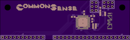

While we're waiting for lot_lizard to surface.. Got that bright idea that I should minimize the changes and go with the existing form-factor. The resulting PCB is a bit barren :)
Getting the hang of that immersion gold printing :)
Unfortunately, MF logo was too hard to convert to DXF diptrace would understand (I suspect diptrace cannot into arcs in patterns - need to approximate by polylines). Also mounting holes are wrong - I'll make special components for those, with large shiny square pads.
PS: Also it looks to me the size is a bit off - 150 mil too narrow, to be exact. Will fix along with the mounting holes.

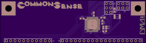

Here it is, the mini-xwhatsit drop-in replacement version. 3.39x1.00 inches, $17 for 3 at oshpark.
I even managed to make the "CommonSense MF" decal - the MF logo was between C and S, 0.55" high - but oshpark throws internal error when I try to import those gerbers. So shown without.
I secretly hope someone will tell me why it threw the error - and I can order the prototypes in their full glory.
Also, since there's free PCB space - I wonder what other art to put there..
Posted: 28 Apr 2017, 22:56
by ekeppel
Thanks for the update - Looking good!
DMA wrote: I wonder what other art to put there..
Looks like there is plenty of room still to mount one (or preferably more) 'mandolin' crystals on there somewhere. :lol:

by DMA
ekeppel wrote: Looks like there is plenty of room still to mount one (or preferably more) 'mandolin' crystals on there somewhere. :lol:
TIL "mandolin crystal". This shit is _weird_. Who even cares!
But if there will be no ideas I swear I'll put "SPARCO" and "A'PEXi" there.

Posted: 29 Apr 2017, 00:14
by Techno Trousers
You should put a URL to the GitHub repo where the CommonSense software project will live. Might as well use the space for something truly useful! :D
Posted: 29 Apr 2017, 04:03
by DMA
Techno Trousers wrote: You should put a URL to the GitHub repo where the CommonSense software project will live. Might as well use the space for something truly useful! :D
In gold letters, no less. Might as well..
