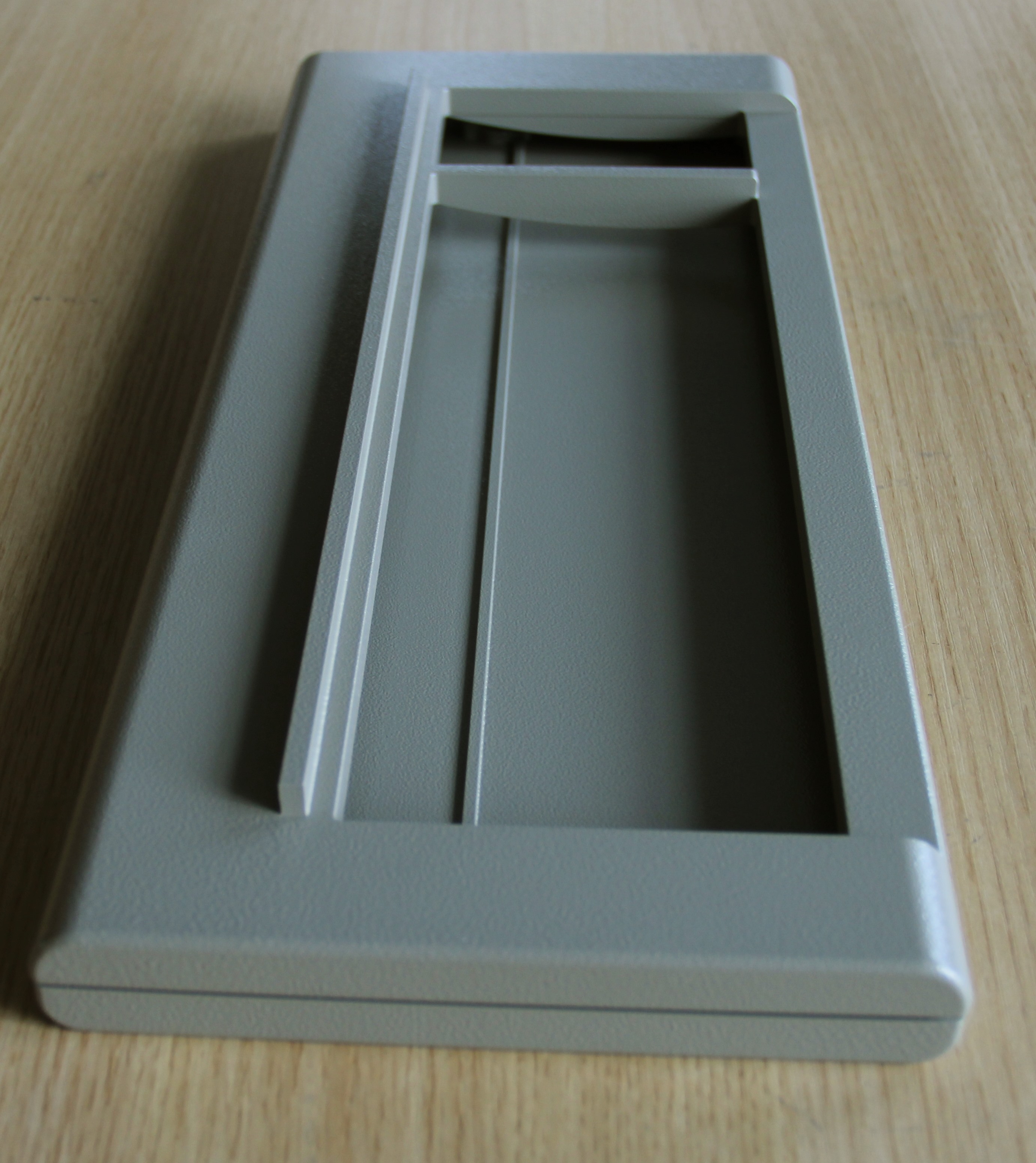

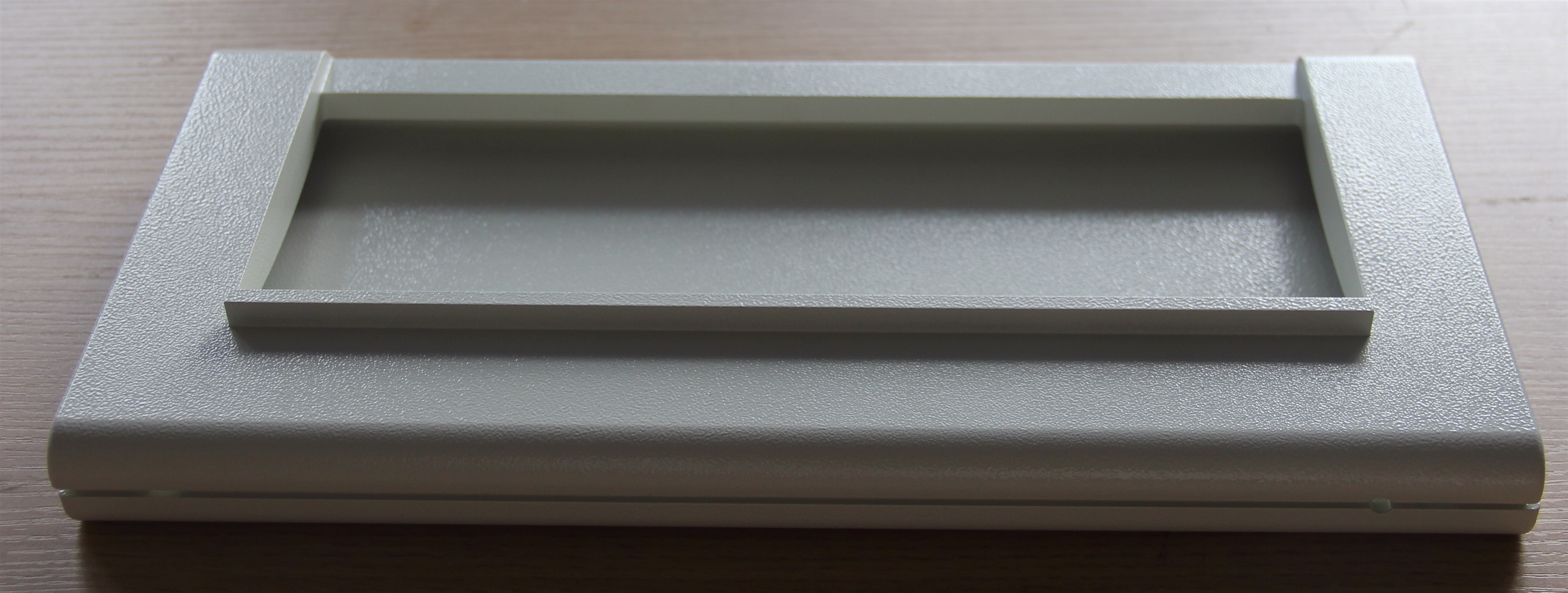

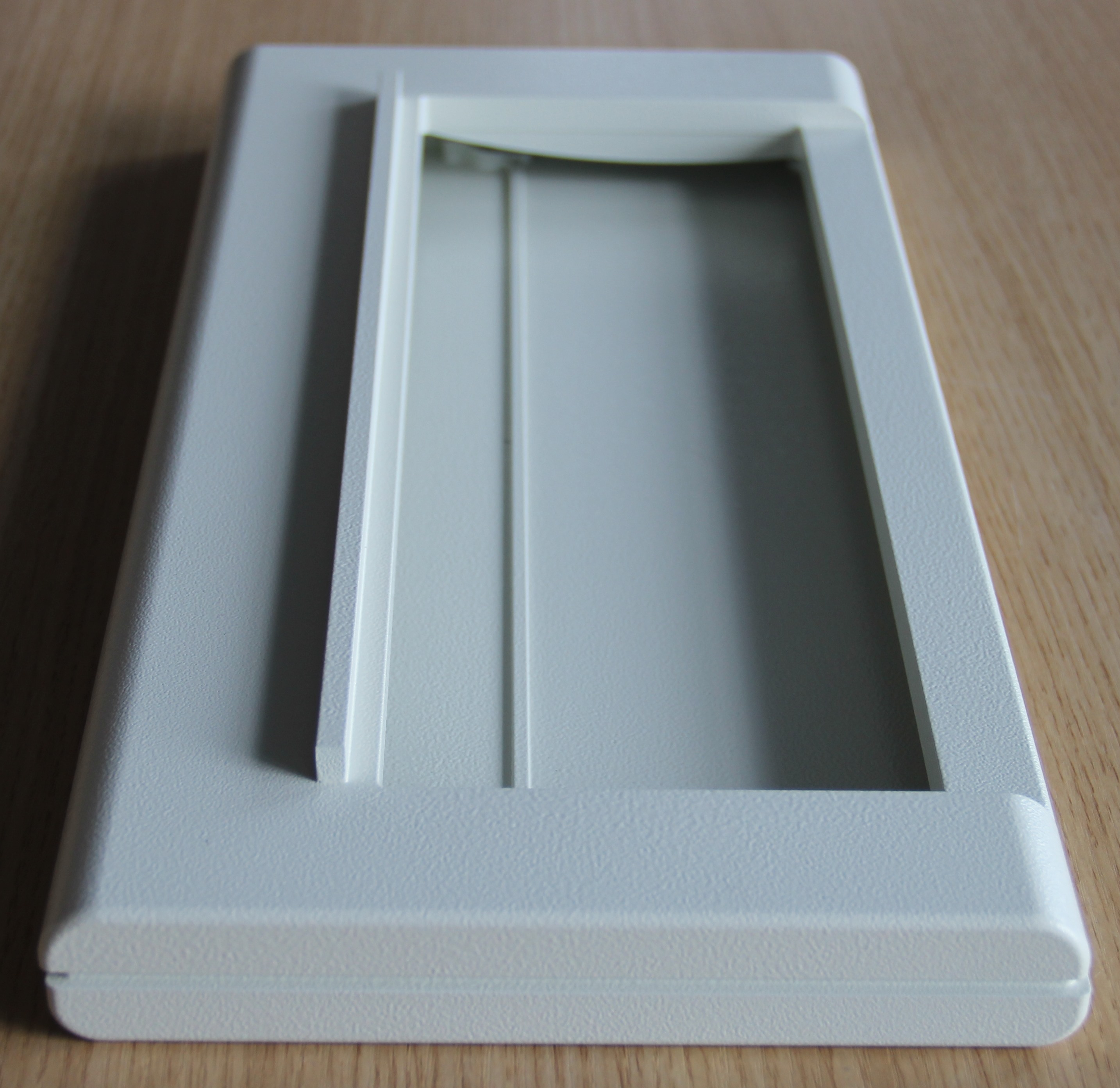

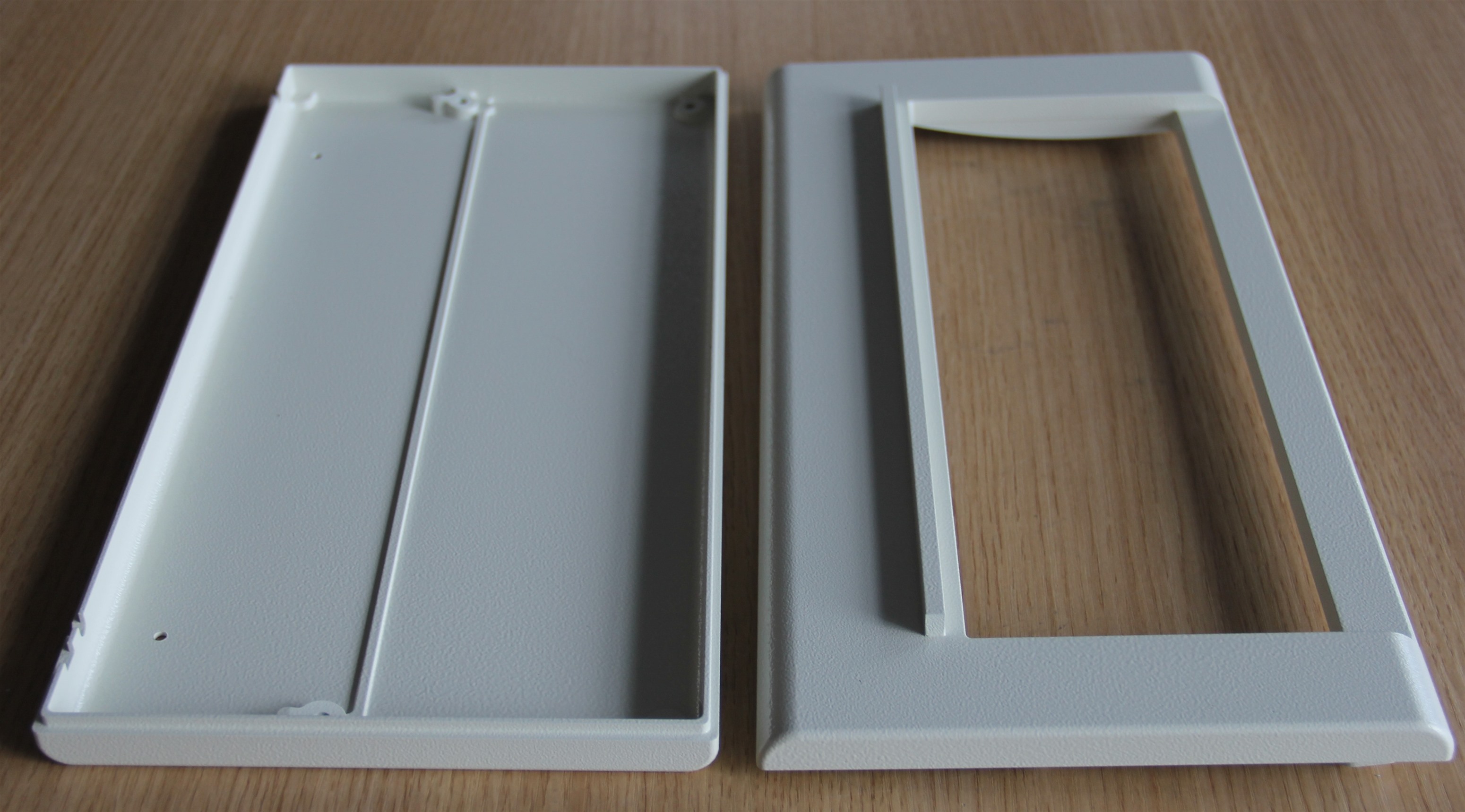

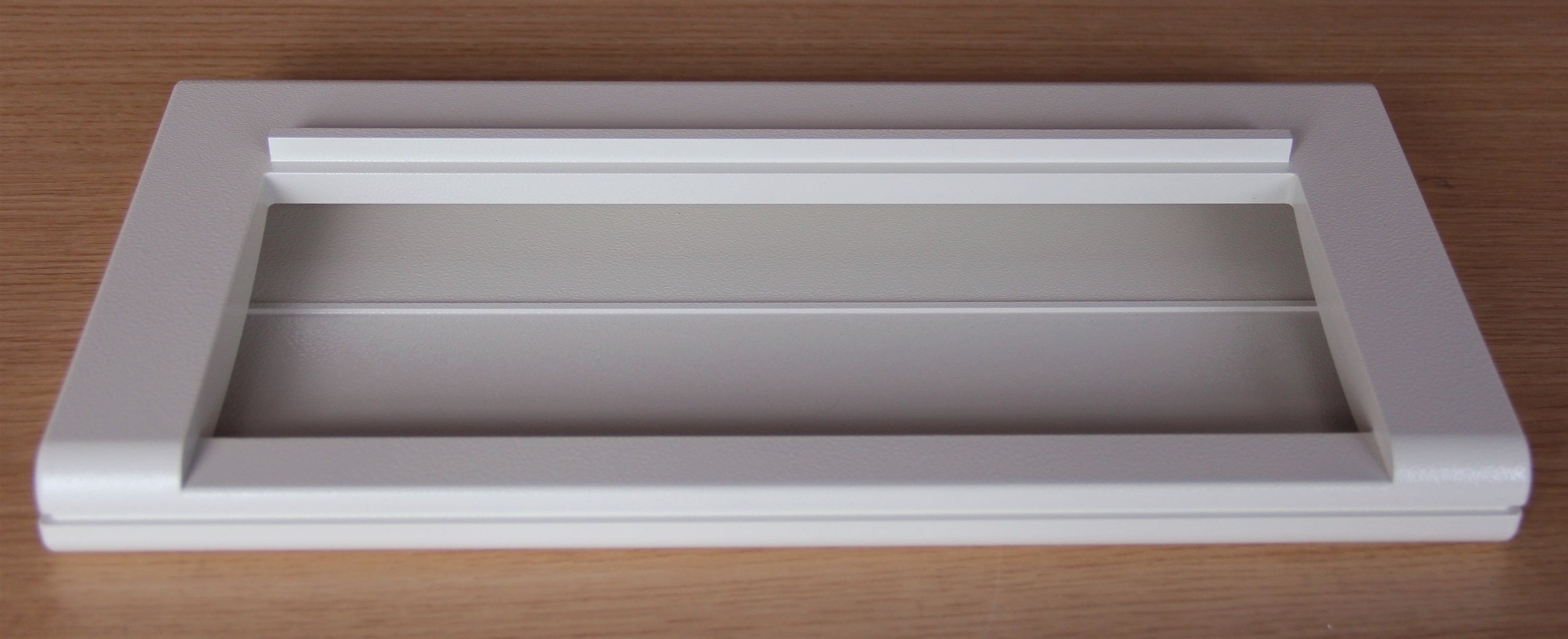

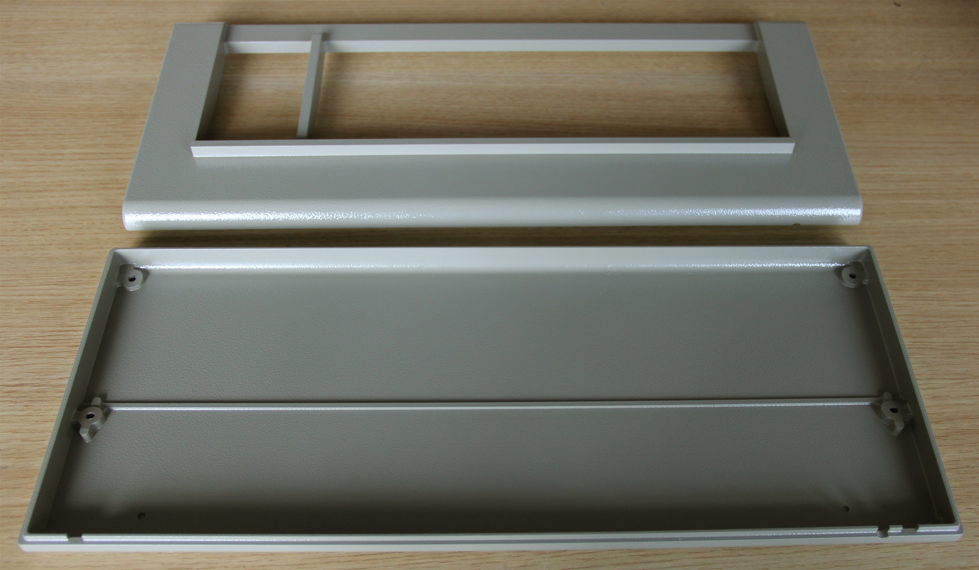

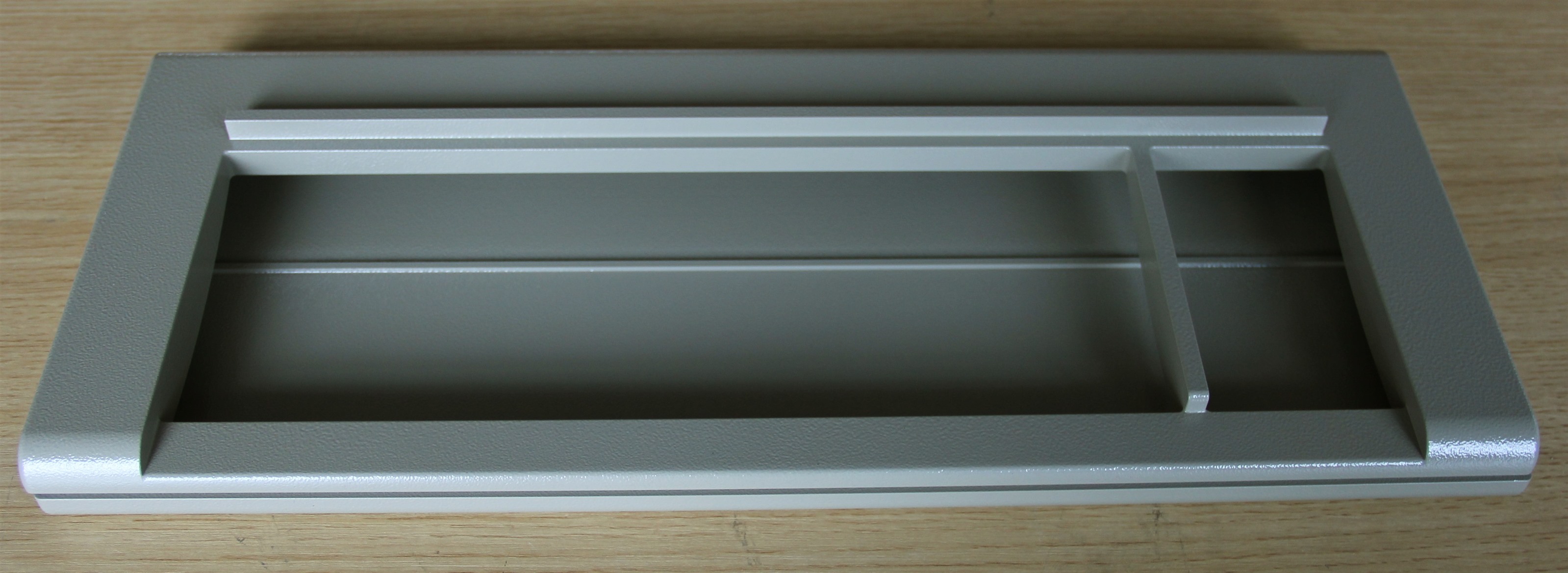

The case prototypes have finally been completed!
The good news is that they seem to have gotten the "extra bumpy" powdercoating texture close to the originals - especially if you look at the first photo below:
**Please disregard the colors in the photos; they are not at all what you will get.
The colors and white balance are way off in these photos, so please take the photos with a grain of salt. The prototypes should get here in the next week or two and I will take many photos too and hopefully open up orders then :)

They look AMAZING! need to round off the edges of the top bar a little but still AMAZING!

Not bad at all.

Looking good!

That's one beautiful prototype! The ridge does need quite a bit of radius on the edges, and either seems a bit taller than it should, or the bare case confuses me!

That looks ace! I hope! The photo stinks!

Everyone's right about the over-sharp squareness of the ridge, but other than that it looks very true to the original, externally.

Need internal case pictures, to see the plate assembly mounting holes, cable strain relief / grounding and cable hole.

0100010 - The cable strain will be like the original - with a P clip. They also drilled two holes on the "far side" of the bottom case for bumpers at the bottom. I will take better photos when the prototypes arrive, including inside photos.

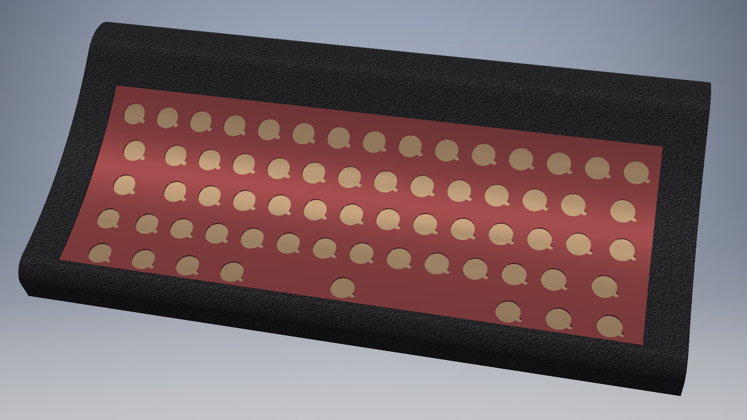

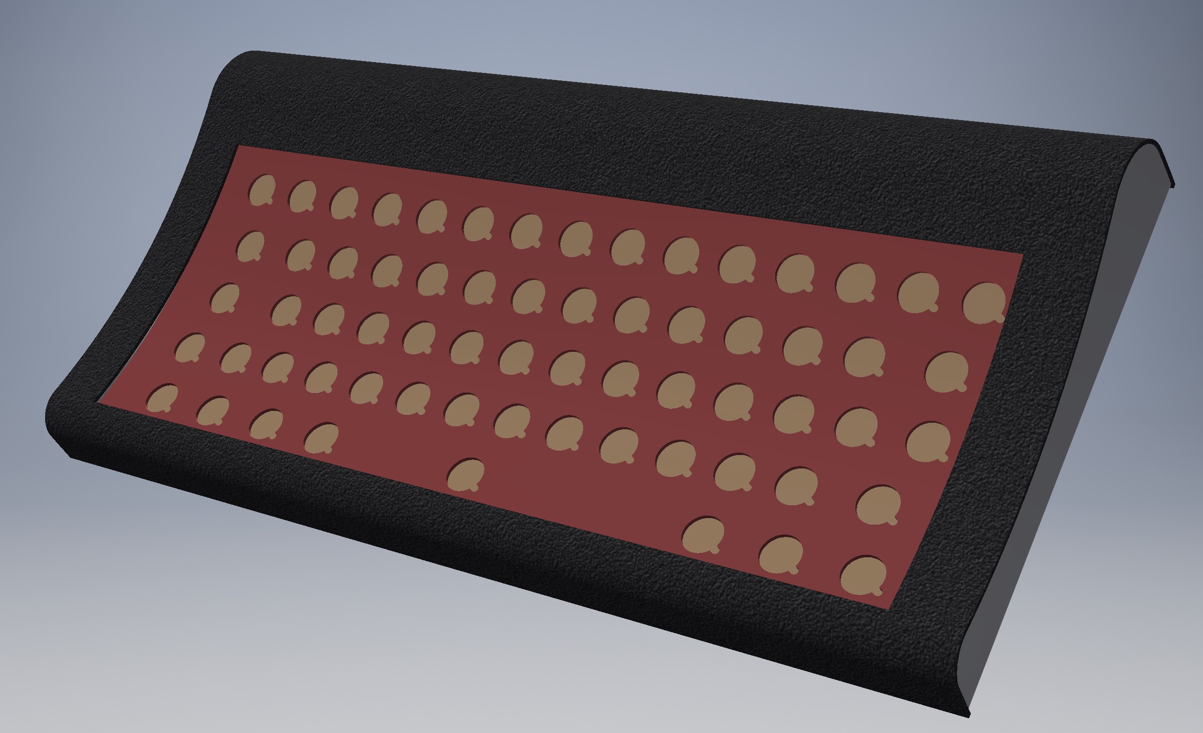

Yes ramnes I posted earlier about a small demand for a smaller style case that is less wide. There is a lot of empty space in the original cases.
Here is a rough prototype of the alternative case. No one will get this case unless they request it!
The bottom case is reminiscent of the stamped metal bottom case of the F122, while the top case is a curved design like that of the top of a Model M case. The bottom case includes the left and right side "walls" while the top case includes the top and bottom walls. The cases will be attached with four removable screws, like the original.
Please note that this alternative case will not be the one offered primarily for this project, but just a low volume alternative version for those who want a smaller form factor case. It will be powdercoated off-white or gray like the originals, or any other Pantone color you specify and if you pay for tooling (could be $100 or so, not sure yet).
Personally I prefer the CNC milled original style case as they are bigger, heavier, and more classic looking.
Due to the lower quantities expected for the smaller case, I do not have the minimum quantities to make them with CNC milling, so unfortunately the case had to be redesigned from scratch and simplified.
No need to say you will stay with the original case - I will assume everyone wants the original unless they specify otherwise in the order form. I do welcome feedback though on this design - if you can volunteer another design that does not need to be CNC milled please do post it.

I can dig that smaller case! Looking good

woooo, very excited! It looks rather very good. And want to see the smaller one also.

I prefer the original Kishsaver style. The compact design strikes me as… Victorian, oddly enough! The Kishsaver case could definitely be improved (all designs can) but I'd go for something more SSK.

If we get the smaller case as an add-on item, I assume we can easily move the innards of the keyboard to the smaller case if desired. Is this the case, as it were?
