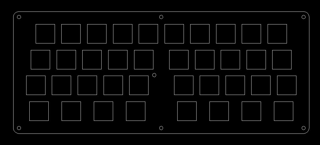

by matt3o
This might be oneproduct's keyboard.
Please review the DWG. I did it in quite a hurry.

by matt3o
llovro wrote:Image
here it is
a bit wierd but ... :D
wow... that is something :) but I have to design my board first :P

Posted: 12 Jul 2013, 10:01
by matt3o
oh okay, as a rule of thumb the minimum gap should be >= than the sheet thickness, but I actually cut holes way smaller than that (eg: 2mm out of 5mm thickness).

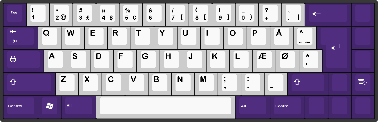

by Broadmonkey
I finally got home to my computer to make some fiddle with the layout and I ultimately ended up with just an ISO version of Brown Fox.
I know I am pretty late, but I would be grateful if anyone could help me drawing this:
+V6 65p 2.png (17.02 KiB) Viewed 8088 times
Caps lock and spacebar should have the same switch position as cherry keyboards ;)
Posted: 13 Jul 2013, 02:04
by Muirium
Looks perfectly sensible to me, for what that's worth.
What did you use to draw the picture?
Posted: 13 Jul 2013, 02:16
by damorgue
Broadmonkey wrote:I finally got home to my computer to make some fiddle with the layout and I ultimately ended up with just an ISO version of Brown Fox.
You are aware that layout looks more like US international than ISO? Just a reminder in case you forgot about the key next to left shift. Perhaps that was your intention, just figure I should mention it in case you forgot it and actually wanted ISO.
Posted: 13 Jul 2013, 07:47
by matt3o
the spacebar is 6u. It's pretty hard to find. Is that fine?
Posted: 13 Jul 2013, 09:01
by Broadmonkey
Muirium wrote:Looks perfectly sensible to me, for what that's worth.
I use paint.net as it's free and darn easy to use, albeit a bit more tedious than photoshop. The pic I have made from scratch.
damorgue wrote: You are aware that layout looks more like US international than ISO? Just a reminder in case you forgot about the key next to left shift. Perhaps that was your intention, just figure I should mention it in case you forgot it and actually wanted ISO.
Yes, as that is what I like about ANSI and misses with ISO keyboards. The key that I loose with it, I have assigned to alt gr + z/x/c and I actually like it better that way. But thanks for mentioning it, it could easily have been a mistake.
matt3o wrote: the spacebar is 6u. It's pretty hard to find. Is that fine?
You just touched my biggest concern. I have a few 6 unit cherry spacebars from 1851 / MY 7000 boards, but unless I have black or hellgrau alpha keys, it will be pretty hard to match the colors.
I am at a bit of a loss of what else to do. Either go Kmac mini or 7u and 1u right alt and control?
Posted: 13 Jul 2013, 09:06
by matt3o
I would go 6.25u just for easiness of finding caps, not that a 7u is that hard to find but still...

Posted: 13 Jul 2013, 11:35
by Jmneuv
I like the 'monkey'.. feeling the same way about left shift and iso enter. Think i'd make the sacrifice and opt for only a 1.25 left ALT + 6.25 spacebar.
Posted: 13 Jul 2013, 12:17
by Muirium
Indeed, that extra key to the left of Z is one of my gripes with ISO. Every once in a while I hit it while going for shift or even undo, when I'm off home row and concentrating on my mouse.

Posted: 13 Jul 2013, 16:27
by damorgue
The caps always become the problem in the end. My ideal layout is fairly similar, but with ISO left shift since I would otherwise need both an ISO and an ANSI set. The larger problem I have is that my ideal space bar would be 4.5u because I only hit it between the C and M keys. The closest thing I have found are those on the japanese layout boards.
Posted: 13 Jul 2013, 23:52
by Broadmonkey
Muirium wrote:Indeed, that extra key to the left of Z is one of my gripes with ISO. Every once in a while I hit it while going for shift or even undo, when I'm off home row and concentrating on my mouse.
My only problem with the standard left shift is that I have to make a stretch with my pinky in order to reach it, especially since I never use the right shift. My little fingers is quite fucked up as I can't really stretch them too well, so I guess you can see my problem ;) But it's mostly because I think it's more comfortable with a long left shift.
damorgue wrote:The caps always become the problem in the end. My ideal layout is fairly similar, but with ISO left shift since I would otherwise need both an ISO and an ANSI set. The larger problem I have is that my ideal space bar would be 4.5u because I only hit it between the C and M keys. The closest thing I have found are those on the japanese layout boards.
I did think of that, but I find it equally hard to find a 1.75 right shift, so it doesn't really matter if the left shift is different as well, you'd still have to mix different sets.
Regarding the space bars, It really annoys me that the standard is the unfriendly 6.25u that you can more or less ONLY use with 1.25 mods. So if you are planning to use any old cherry set you have to get a moogle set for the whole bottom row instead of just the space bar. That is why a bottom row like on the realforce with a 6u space bar should be the de facto, especially among custom builds. I am glad the 7u has got some recognition, but I find can't help but feel that it is somewhat a waste of space on smaller keyboards.
btw, I am still in doubt about the spacebar on my plate, maybe I should remove the left win key as to make space for a more friendly 7u spacebar. hmm.. decisions, decisions...
